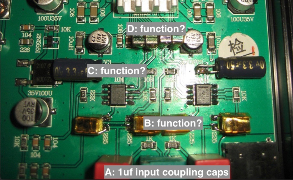

Finished the input mods. ....
What do these do? 🙂 Please refer to A-D in your picture I used...
That isn't the final version of my mods, so ignore it. B and D are stacked 1uF 16V acrylic caps. B are not there in the final mod. C is just added supply bypassing for the op-amps.

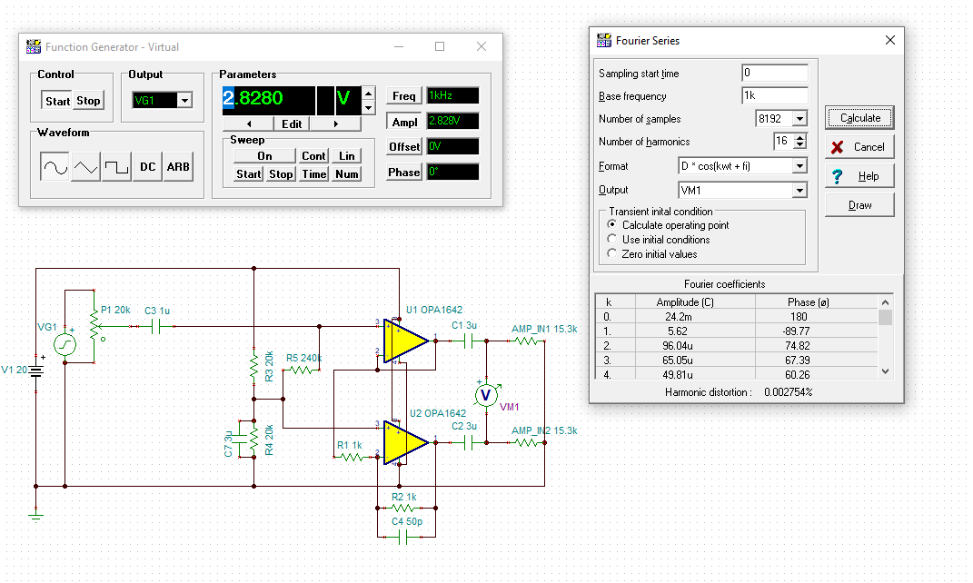

The attached pic is the final schematic. The original 50k linear pot was replaced with a 20k log.
