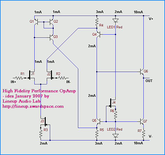

In this context, it might be worth having a look at my suggestion from 18th January 2007.
New JFET Hifi Op-Amp, by Lineup
My original design uses 2SK117 JFET input pair.
Has got the advantage of take 50 V drain-source, compared to 2SK170 40 volt D-S.
But really any reasonable matched input N-JFET pair would work.
The Output buffer transistor may be any good TO-126 or SOT-223, SOT-89,
like for example BD139, MJE340, BCP56-16 etc.
The main difference of my very good data pre amplifier is the workaround
to avoid the 'problem' of finding a good complementary P-JFET pair.
this is an issue we could wish and hope for will be solved in future devices ....
2SK389 + 2SJ109 has been a way to try, in past.
Best Regards 🙂
And thanks for publish your great amplifier, jonusgrumby
It is an excellent discrete 'op-amp' which will perform equal or better
than most modern IC Op-amps, like for example OPA627!!!!
/lineup of Sweden

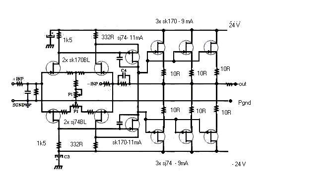

dodo said:May I ask, what kind of advantages has the preamp proposed by Tom in this thread comparing to the line amp based on Borbely design ( schematic attached ) except lower input capacitance ?
Hi dodo
I am not an expert at all but lets see how I go ...
The Borbely design differs as follows
- Allows for Balanced and unBalanced input
- has complementary VAS stages which incorporates a Miller cap.
- requires output resistors which means that the output impedance will be higher
- Global NFB is completely coupled to the differential Jfet pair. (not sure if that is good? Maybe ok if the path is really short???).
Hi Tom
Can your design accept Balanced input like the Borbely design, without affecting its performance?
I followed most of Mr. Borbelys work in Audio Amateur and in Audio Express but had not seen this particular circuit. Like all of his work, I find this circuit very impressive.
His has a source follower output stage so the output impedance will be lower than mine and it will be less susceptable to output loading. That would be a concern if you are building a line amplifier or driving a load below 2200 ohms or so. The open loop gain of my circuit, and any of it's type (those with a non follower output stage) is determined by the load on the output. The performance will suffer if it is driving too heavy of a load (2200 ohms is the lowest I'd recommend). Mr. Borbleys is not nearly as sensative to the load with that source follower output.
He tends to run his fets at a higher id (close to idss) than I do, which is really not an issue, just an observation.
I agree with mlloyd1 that his will be more expensive too, which is complicated by also needing to match the parts, so you are using more expensive parts and more of them. But again, that's the beauty of DIY.
I have never tried mine balanced, but it should work fine provided you don't get crazy with the input and feedback values. It is a balanced topology. The input level control gets a little more interesting with a balanced input. You'll likely need a dual pot.
