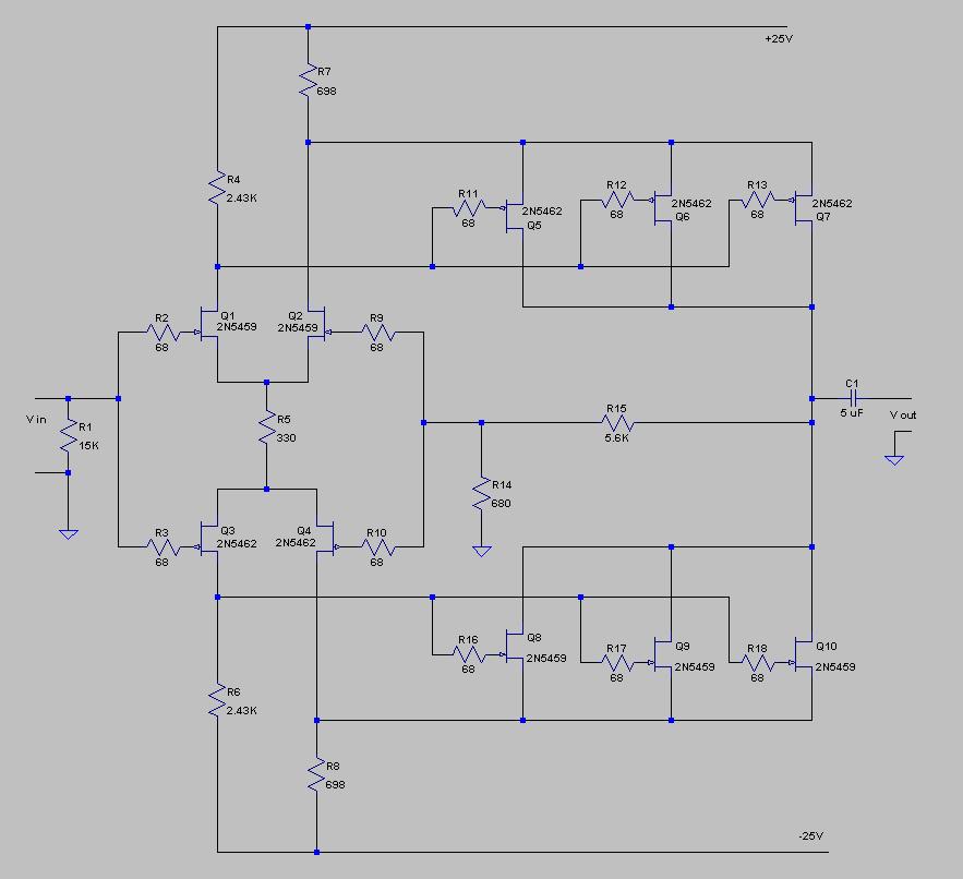

Here's a JFET preamplifier I designed and built many years ago, and still use today. The JFETS are 2N5459 and 2N5462 which are still available and are inexpensive.
The input devices need to be matched to within 0.1 mA on idss. The other devices do not need to matched as closely, but try to keep them within 0.5 mA on idss. I bought 25 of each part and was able to come up with the devices I needed for a stereo preamplifier.
Even with careful matching, I would include C1. There is a little DCoffset present (50 mV or so).
If you need more or less gain alter the value of R15. In my preamp, I replaced R1 with a 25K potentiometer.
THD is less than .01% at 5 V RMS output, and .005% or less at 1 V RMS from 20 Hz to 25 KHz.
IMD measured .005% @ 5K/60Hz.
I've built several of these circuits on vector boards. I never laid out a pc board.
The even order harmonics dominate the distortion spectra. I am very pleased with how it sounds and its' performance overall.
Have fun.

I admit there is some similarity, but I developed this myself. I only became of the JC-2 when I ordered back issues of Audio Amateur magazine.
Actually, I came up with this approach when I was reading about the circuit that Erno Borbley described in his 60 Watt MOSFET amplifier. Paralleling the output FET's and running their operating current through the drain resistor of the differential amplifier allowed me to direct couple and not reduce the gain of the 2nd stage too much. It is not exactly the same as the approach Borbley attributed to Lender, but it sparked my idea.
I used this topology in a power amplifier I designed in the late 1980's as well.

which input devices need matching.jonusgrumby said:The input devices need to be matched to within 0.1 mA on idss. The other devices do not need to matched as closely, but try to keep them within 0.5 mA on idss.
The N to N channel and the P to P channel?
or
The non-inverting N to non-inverting P? to minimise input offset current/voltage.
or
all 4 input FETs?
Thanks for your interest.
Q1 and Q2 should be matched to 0.1 mA
Q3 and Q4 should be matched to 0.1 mA
The idss of Q1/Q2 should match Q3/Q4 as close as possible, but a difference of 0.5 mA is perfectly acceptable.
The idss of Q5, Q6, and Q7 should be within 1 mA of each other. Their total idss should be as close as possible to the idss total of Q8, Q9, and Q10.
Hopefully this answers your question. If not please let me know.
Also, you may reduce the gain of this circuit with no problems. I would not drop the R15 value too low, but I have used 2.2 K but would not go any lower. I'd raise R14 before I went any lower than 2.2 K.

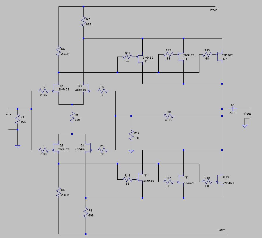

Hi Tomjonusgrumby said:... Also, you may reduce the gain of this circuit with no problems. I would not drop the R15 value too low, but I have used 2.2 K but would not go any lower. I'd raise R14 before I went any lower than 2.2 K.
I was wondering if R2 and R3 can be greater than 5.6K ...
Also what would you say was the best metod of reducing the gain of the preamp ...
thanks
My apologies, R2 and R3 should be 68 ohms, not 5.6 K. I made a error on the schematic I posted originally. I included a revised schematic. Sorry for the confusion.
If you use a pot on the input, it replaces R1.
If you need a lower gain, I would increase R14. The gain is equal to (R15/R14 + 1).
