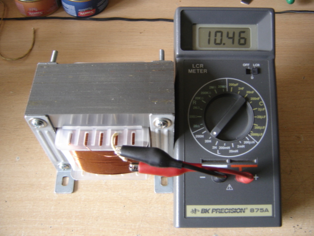

I make my own iron cored chokes, so I can write with certain criteria that measured inductance with a RLC meters always is erroneous. Most of those bridges use about 1KHz signal at a very low level and without DC premagnetization. So discard this measurements, and try it in circuit.

If we say we've measured an inductance to be such and so, without detailing exactly the measuring conditions, we haven't said anything. Iron-cored inductors vary wildly with applied AC voltage and DC current, and somewhat with frequency, as everyone has already said.
IOW, there is no single number for inductance. It's more a family of curves, like the more familiar valve "plate curves" and transconductance curves.

> Is this method completely wrong?
If I measure my blood pressure in the morning it is low; in afternoon it is high. Lots of things depend on conditions.
Let it read a little low on the meter, then put it in the supply and load it! Read DCV, DC current, and ripple voltage. These days a broken-in first filter capacitor is probably within 15% of label, or you could measure that also. (E-caps don't vary much with voltage; high-K ceramics do.) Since you already(?) computed the predicted ripple with the *assumed* choke value, any difference tells you if the choke is a little off or a lot off.
And of course if the choke is +high+, ripple is low, then that is even better. (Unless you will make a million for profit, then you want to cheapen the plan to just-meet your spec.)
So, my conclusion is that when choosing a choke, the most helpful specs are physical dimensions and DC resistance.

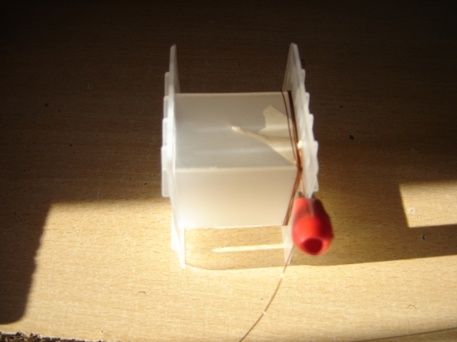

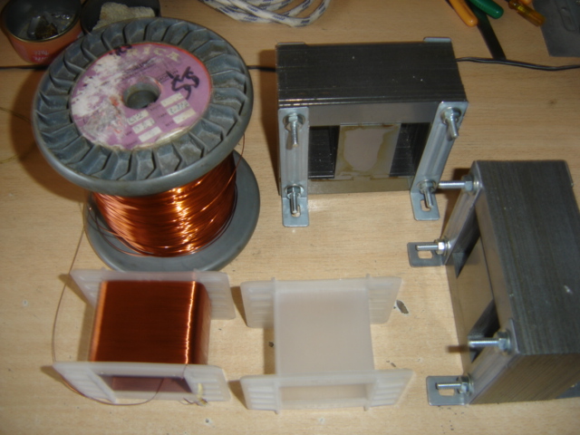

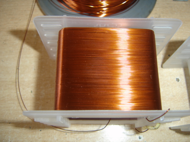

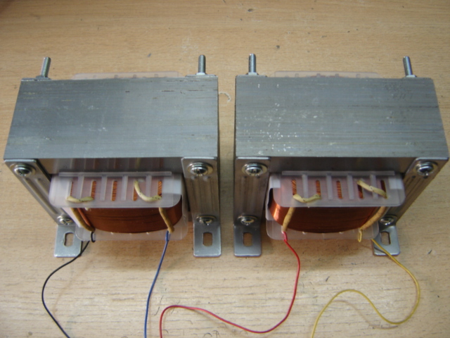

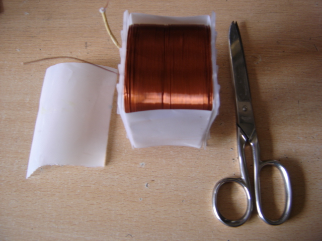

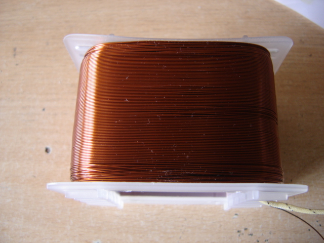

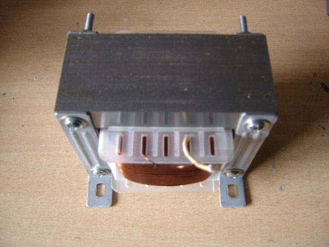

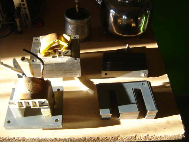

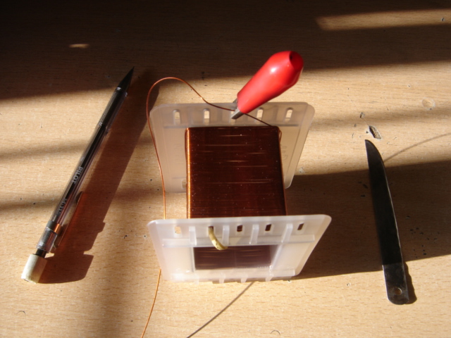

To take the biggest advantage from a choke filter, it MUST be designed for the task. Off the shelf inductors are a poor solution. I'm talking with knowledge from a guy who make my own chokes from scrapped transformers or chokes. It's easy and ready to make.
As others have indicated, the inductance presented in an operating power supply depends on the AC and DC conditions imposed on the inductor (choke).I bought a 10H inductor for a power supply tube amplifier.
I test the inductor and have 6H.
There are diy testing ways to measure that operating inductance value, if you are so inclined, such as shown in the link:
https://www.dalmura.com.au/static/Choke%20measurement.pdf
