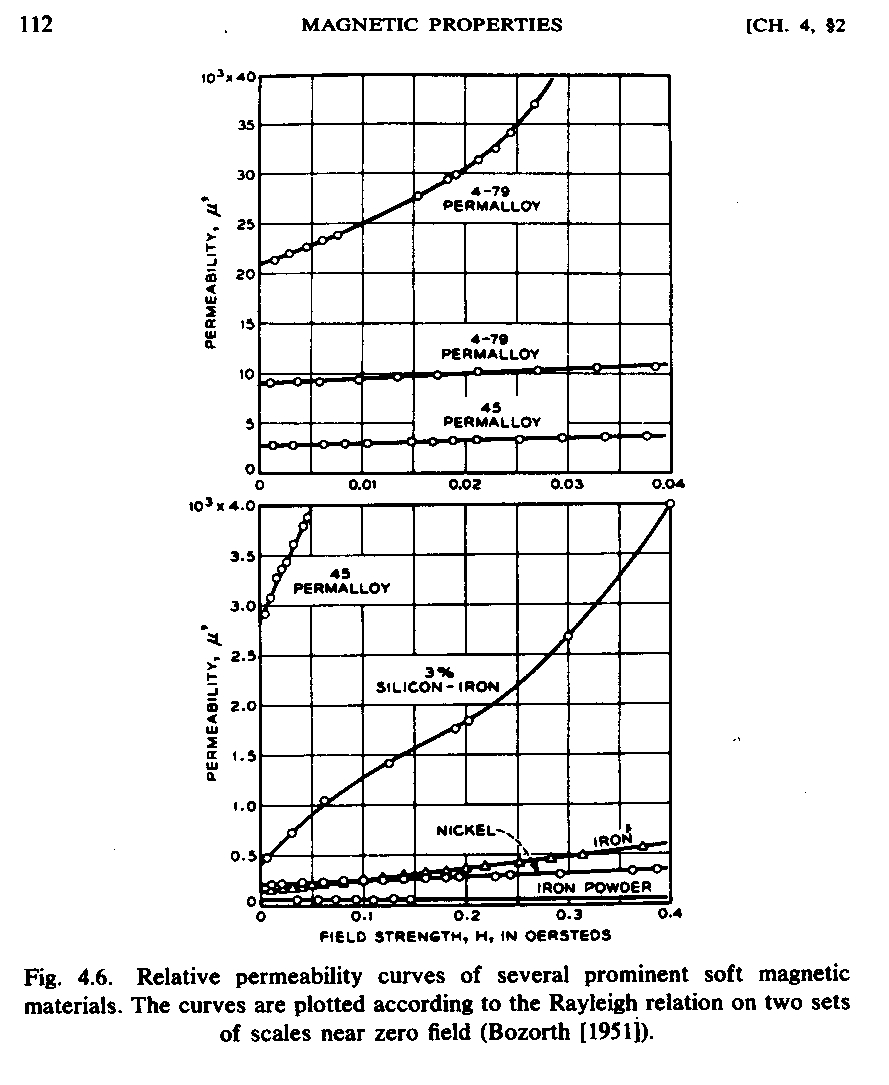

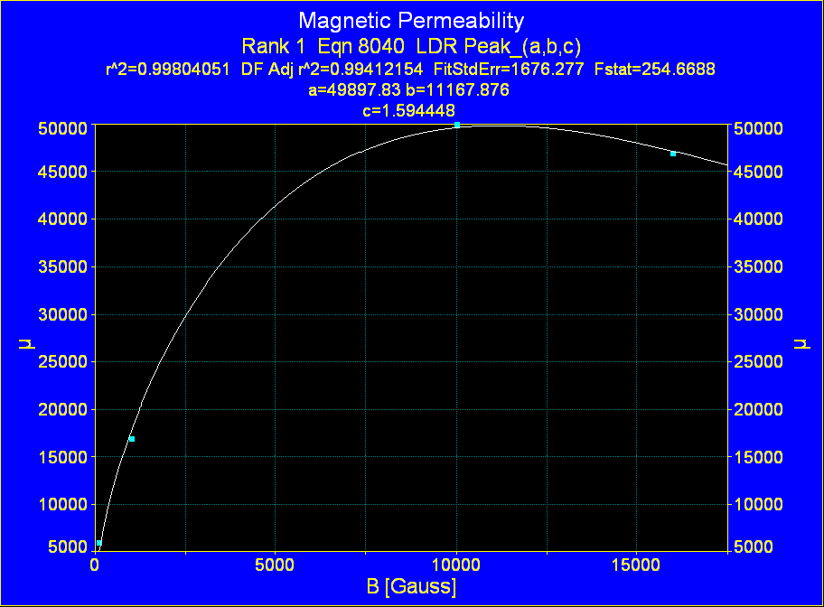

If we say we've measured an inductance to be such and so, without detailing exactly the measuring conditions, we haven't said anything. Iron-cored inductors vary wildly with applied AC voltage and DC current, and somewhat with frequency, as everyone has already said.
IOW, there is no single number for inductance. It's more a family of curves, like the more familiar valve "plate curves" and transconductance curves.
