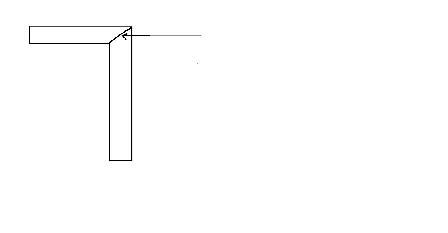

Wanted to know how the 45 degree cuts were given to the cabnet. Did the carpenter cut the wood manualy or you have it done from somewhere e.g. a saw operating place.

Which 45-deg cuts?kamal6767 said:Wanted to know how the 45 degree cuts were given to the cabnet. Did the carpenter cut the wood manualy or you have it done from somewhere e.g. a saw operating place.
I don't see why anyone would do such a thing, when you can just join them face to face without any complex cuts. I definitely did not use 45-deg joints. I even made a simple drawing to show you what a 90-deg joint is like, but the posting screen is reporting an error with my PNG file, without telling me the nature of the error. I tried thrice. Now you'll just have to figure it out without a figure.kamal6767 said:The sides and top bottom panels that are cut to 45 deg to join them

I think Butt joint is the best and simplest option as mentioned by Tarunda

Yes, a straight butt joint, even without the wood strip, would do just fine. You'll need the strip of wood if you're butt-joining two sheets of ply, because ply tends to split if you drive nails/screws into it edgewise. But since most speakers are assembled with MDF, this problem doesn't show up. (The Asawari was assembled entirely out of marine ply, and screws were driven into those sheets edgewise, but with some care and lots of Araldite, we avoided any split ends.)
Well Tarunda many of the speakers i have seen have that kind of cut and joint even my small speakers that i bought from the local market and are china made have the cabnets pannels cut and glued like that

Thanks for the reply, yes thats the way i use to join the panels the simplest way,i thought something speacial was there in those speacialy cut and joint panels, thought may be some more regidity than the simple way. But thanks for clearing that for me. Previously wheneven i used to make the boxes they went offline somewhere, may be the cutting of the wood was not ok or not in a straight line.

I have a deficulty, now that i have planned to use a 3/4 inch of MDF and added another layer of 1/2 inch of MDF that will make 1.25 inch of MDF and i think will make a strong cabnet. After that i plan to glue the 1/4 inch of HDF plank on the top, which has a nive vaneer finish on one side and some shiny stuff on the other side that will be taken off by sand paper. Now making the edges come to meet each other correctly and evenly is a tough job and to realy join good. I met a couple of carpenters today and saw their work. Non had any inspiring work.
If you abandon your ideas of a 45-deg joint, then it's a very easy job of making edges meet, even if you have this multi-layer construction as described. This is the reason that the Asawari looks the way it does... it may not look very appealing or elegant, but it is a very practical design to construct, and addresses all the challenges of building a dead cabinet using carpentry skills commonly found here.kamal6767 said:Now making the edges come to meet each other correctly and evenly is a tough job and to realy join good. I met a couple of carpenters today and saw their work. Non had any inspiring work.

I really appreciate on you giving me advices. I will surely leave the idea of the 45 deg. I have been thinking hard how to have the job done cus i am a man who goes in details i want a nice perfect finish on my speakers and if that wants that i leave the 45 deg idea i am happy to leave it. And tarunda Asawaris are really a very appealing speaker cabinet, i have not seen anyone giving that much of importance to cabinet building, i have seen on net many projects and ppl just put some bracings and done with the cabnets, but you have given a lot of thinking and i realy admire your working hard on that area of speaker building. If your Asawaris were not there i would have never ever would have thought that my dream of building a nice speaker system come true. Well today my sis in law came from the USA and she surprisingly was able to carry the 8 drivers that I had won on the bid on ebay. These are sony SS MH600 speakers. 4 8inchers, 2 midrange and 2 tweeters, someone broke the cabinet of the speakers and sold all the drivers on ebay. Luckily I won, the drivers are kinda ABS basket and nice poly cones. As for crossover just one cap for midrange and one cap for tweeter and drivers have straight connection 🙁 , was3thinking of a nice cross over but was disappointed to see just two caps. After so many years (20 years or so) I have had my hands on some good speakers. I am lucky didn’t had to pay any duties or shipping charges just 70 $ for the set.
