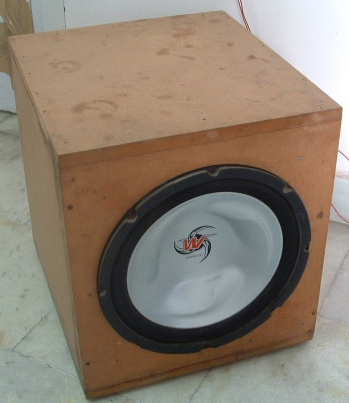

Attached is a picture of my sub woofer yet to be completed. I started it in 2006 it is a kenwood twister 12 in sub in a MDF box . I went on line and found a software to calculate the size of the speaker box according to the speaker size and lts one wanted . hope I finish it soon

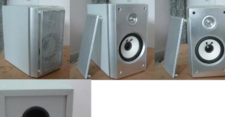

This is a image of a small speaker set that I bought from my local market using it as surround the speakers are 8 inch tall and 9 inch in depth. They use a 3.5 inch driver and a tweeter. Opened it up and saw no XO just a capacitor attached to the tweeter. Look nice they have a aluminum face place and nice finish
This is a image of a small speaker set that I bought from my local market using it as surround the speakers are 8 inch tall and 9 inch in depth. They use a 3.5 inch driver and a tweeter. Opened it up and saw no XO just a capacitor attached to the tweeter. Look nice they have a aluminum face plate and nice finish
