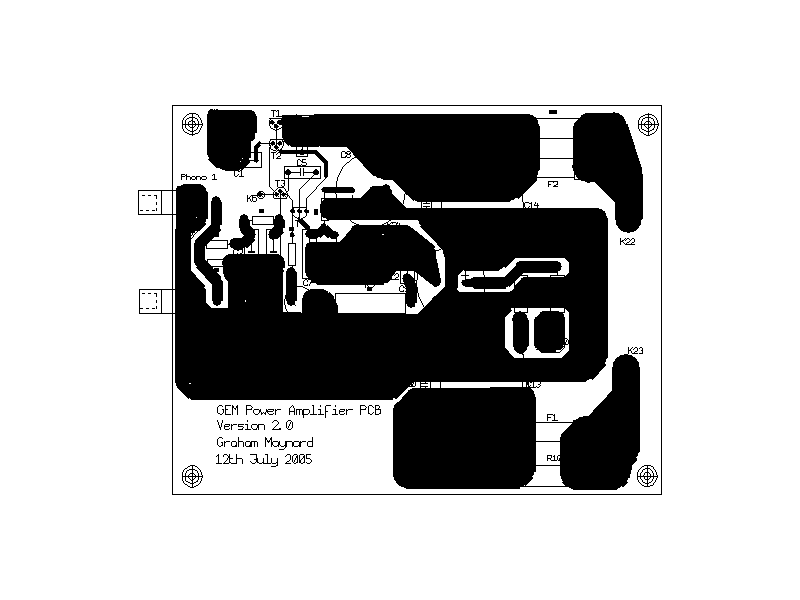

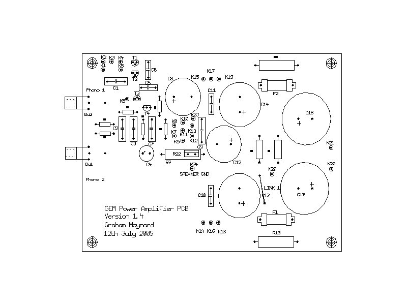

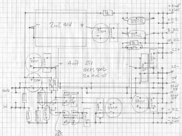

I just completed a PCB layout for Graham's GEM amplifier and while on the job, I realised that 'noisy' and 'quiet' grounds can be separated by a 10 ohms 1 or 2 watt resistor. I wonder why Graham has suggested 'star ground' instead of a typically cleaner ground? Any comments?

Re: Graham and Barry are studying some good board, and they will test them

Remember to place a Miller capacitor from base to colector... 33 to 68 picofarads capacitor, can be ceramic or Silver Mica....place it if you perceive that the zobel output filter (2,2 ohms in series with 47n) are overheating.... those components overheating are strong signs that you are having oscilations.... run to place the capacitor if needed.
BQ40403, those board are not checked in real life.... they were not assembled, sometimes problems appear...better to wait some days to have those boards checked.... very nice avatar, you may be a very interesting person....just because your choice related the image....because you apreciate that image, this means a lot (some positive things)...good to have you here.

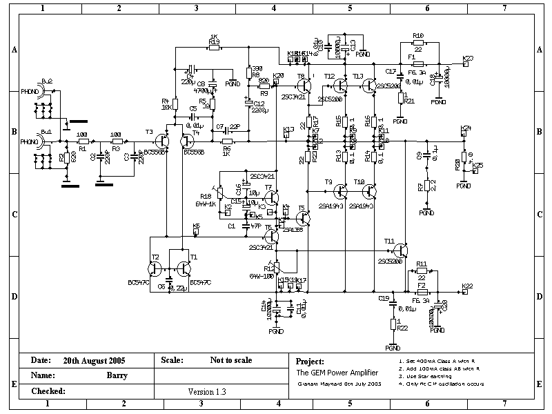

Mr. Barry Husbands, a very nice guy, has been working with Graham Maynard
And some schematic and board was already shown...and i told you before that was not constructed yet.
I continue to say the same, as i was not informed by Graham or by Barry that the board was constructed, circuit assembled and tested over this board was not made till today.
So, this will be next step.... and i will be waiting, understanding the both have not conditions to make those things too much fast.
Mr. Barry informed that as soon as he can find time, he will inform us the complements, alike part lists...very organized and very cooperative Mr. Barry, you always welcome with that sense of cooperation.
Here is the Barry's produced schematic.

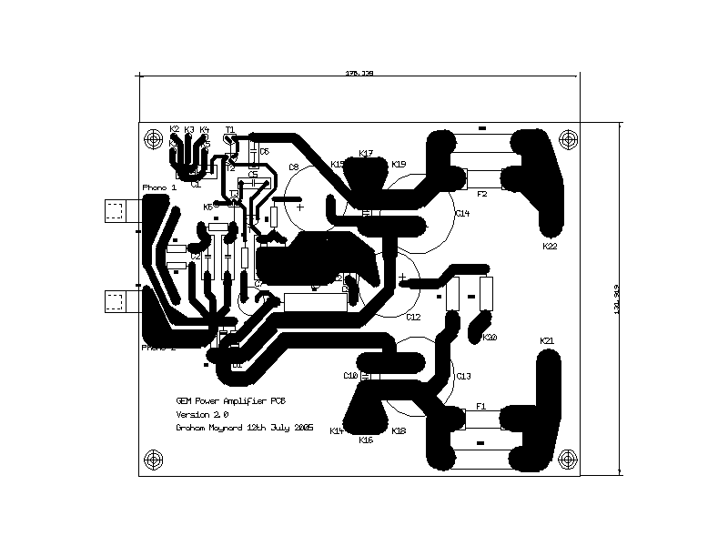

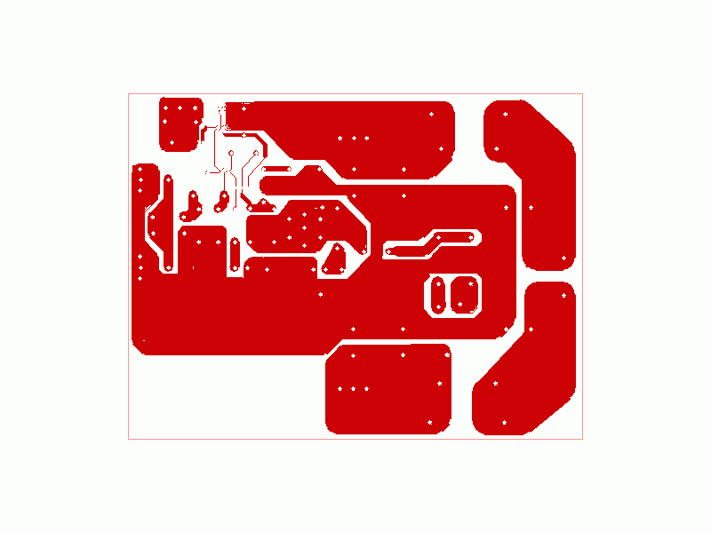

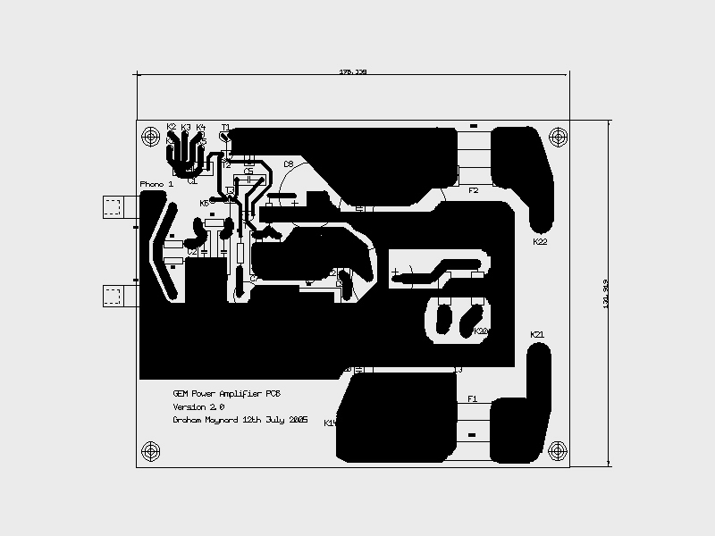

Here is the board, it has a lot of copper material producing some ground plane...so,
You can have another board, without those black copper ground planes, the other one, already published in this thread, will turn easier to see all the parts positioned.
Remember to check everything, as we are humans, and it is not impossible, for humans, to produce mistakes.
Observing and studying Universal Human Hystory, you will see that we made an enormous sequence of errors...so... this is something very expected.... some mistake can happen, reason why i am telling you that was not constructed.... and during construction, some error may appear.
