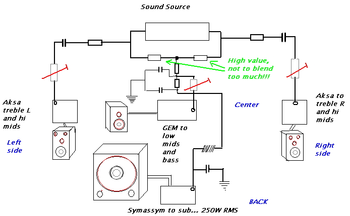

Will construct a bass mids and treble center... will put one GEM and 2 brand new AKSAs that is arriving next days, a Nirvana Plus Upgraded Kits....ahahaha!...was not easy to make Hugh reduce 5 percent the price..but we did the business....i am afraid i was the only one that could make him reduce..hehe.

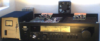

I will put inside this Sansui equipment that i have "cleaned" the insides to put enormous GEM heatsinks and under those heat blocks i will fix my boards.
I am thinking to make some kind of step control for volume, as i have many switches.
Aksa is great for high trebles...hi end is wonderfull...yes, i know the Miller cap may triangulated some sinusoidal signal above 60 Kilohertz.... i do not care, as i cannot hear this frequency...and i think a dog cannot too.
The Graham's GEM is perfect for bass and subwoofer too..... all those amplifier are beautifull for full range reproduction, but Symassym is already doing good job using slow speed transistors to drive a sub woofer....i am using passive filtering.... 330N to ground, 1K5 in series and another 330N to ground.... a greek "P" letter.
The supply will be outside, a 1Kilowatt supply and will use fan...one pushing and other pulling air, crossing from rigth to left sides.
I think this system will be unbeatable.... but i know, with better speaker than mine units, our forum friends can reproduce a better sound than mine...i am limited by the speakers.
So, two Aksas producing pretty brigth wonderfull trebles, volume adjusted in steps.... aksas also will reproduce part of hi mids spectrum to show me the wonderfull sound stage.
For voices, i will be hearing the GEM and for bass too.
And Symassym for subwoffer, as it is beeing used now a days.

Are you tri-amplified with the Aksa in the high, the GM in the medium end in the bass for each channels? With Symassim for the subwoofer?
There is a lot of heat...
What kind of speakers do you have?

My intention is to have only stereo system...two channels only, as i have only two ears and those Surroundings seems too much fake to me.... a back left channel and rigth channel can be nice too, when volume there is reduced.... we can make with two channels.
The way i made some tests work fine, as my home is not a perfect environment for sound.... floor is made of Ceramics, the walls with cement, and the ceiling is made with the same material we use to encapsulate broken arms, or broken legs....those ceiling panels, squared with 60 centimeters sides, are fixed one with other result of male to female attachment mode, and also have some vegetable fibers and steel wire suspending those plates related to the concrete ceiling, that corresponds to the upper stage floor...those panels vibrates a lot, and in my case have around 18 Hertz ressonances.... i have also glasses to create reflections....not a good environment, so, making comparison tests, i prefer not to do here, and if i do them here, i check the result with headphones, to avoid all those reflections.
The symassym will amplify sub bass, using passive filters, and big resistor joining channel left and rigth, values tested not to blend too much those channels, avoiding to create a monaural system shorting left to rigth....that signal will go to Mid and low mids to be amplified by graham amplifier.....and this same signal before the filter will go to a second filter to send sub bass to Symassym.... a third and fouth filter will send to Aksa front left and front rigth..
So, it is a stereo, using 4 different amplifiers, the best i could find till those days, related BJT units, and classes A and AB, ... front and center for voices and low mids too (some blend rigth and left signals).... rigth and left with one Aksa to each one...and sub woofer will be behing me downfiring subwoffer, 15 inches 200 watts unit.
The speakers to voices and treble will be used good Bravox drivers that are installed inside some System's Speaker i have here....One is JVC and the other is Philco (yeah, still alive in Brazil).
I will adjust those passive filter during the tests and adjustments, during the installation, to have different adjustments because of different reflexions i will have...and no absortion in my main room...of course i will reduce treble, and voices and will give to bass and low mids more power.... because of my environment, cannot be flat, as will be awfull in my place.
Will be custom filters... adjusting and checking with headphones...and repeating and checking, till have the adequate response, as i have the audiometric waveshape of my ears....i have losses in the rigth ear.... so i have to increase treble rigth side.... all them RLC and series and parallell filter...when ready i will show you diagram.... as i have only some starting idea about it.... a really diy filter, burning fingers and try and error system.

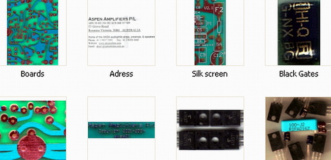

Yessss!... my kits arrived, and a separated package to upgrades N plus
Now i will construct my system with brand new kits.
The Silk screen is bigger and easier to read, also the components holes are more precise.
The board colors change a little, and i think they turn more pretty.
I am crazy to assemble and wait some hours running to start listening them.
Oh my God!...those fresh brand news circuits, together GEM will be something hard to describe...not forgeting Symassym 4 pumping strongly the low deep bass, as it is already doing now.
