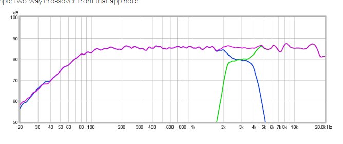

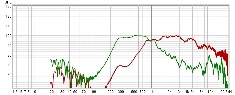

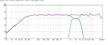

I was looking at the raw response of my mid / tweet combo on my project and it reminded me of the linear phase slopes on the miniDSP website.
Could the original synergies use a similar slope ? It fulfils the 'non constant' roll off slope in the patent. I remember a post from Tom D about the phase being at zero well above the low knee on the higher driver, which was why he chose the BMS CD.

I've developed many MEH crossovers over the last twenty years and on many occasions noticed an interesting effect. I used to use CALSOD for my crossover development and occasionally the optimizer would snap to a solution like the one above and would have a very flat phase response. For a while I considered it an anomaly but once I worked out this behavior was beneficial I found it difficult to replicate. I am now of the belief that some of the Synergy crossovers sum through a plateau that is one or more octaves wide. I've not measured the acoustic response of a Danley Synergy horn to confirm this but at the moment I believe it to be correct.
Also to add to the discussion, many of my crossovers end up with no LP on the mids but will always have one or two notch filters often with one out of band, for the mids. A compression driver HP crossover and eq are usually quite a bit more complex but a MEH crossover for a system using a small dome tweeter can have quite a low parts count.
