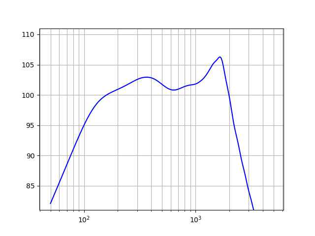

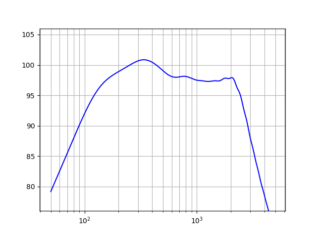

So I ran a little simulation of the concept. The picture is the 2.00 V (1W on 4 ohm nominal load) power response in 4 pi at 1 meter on axis (same as default in hornresp) with the setup as described below. The results of my code matched up to hornresp in other situations, but as I understand, it can't handle this situation.
The result is really encouraging, however, I remain a bit sceptical as efficiency seems way too high. I model the ports as lumped mass elements as their length is like 1/16 of the highest frequency of concern. Also, the mass loading is modelled as simply using the port input impedance as the mouth impedance. It should work in principle.
If those results can be trusted, then the initial idea seems very worthwhile! The standing waves do not seem to cause problem indeed! 4.3 cm is 1/4 wavelength at 2kHz and thus a delay of only 90 degree: the tweeter can even be "delayed" around the crossover with a simple passive all-pass when no dsp is used.

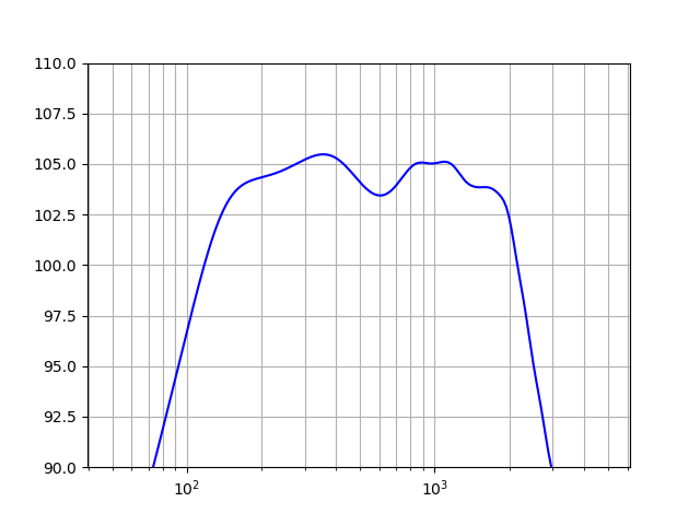

Here is a detailed description of the simulation. Two 6" drivers (Dayton's PA165 in parallel) are each fitted with a 2 liters back chamber and a front chamber of 70mL and a 1/2" long slot port of area 12 x 2.54 cm (4.7" x 1"), followed by a short 4.3 cm conical horn segment flaring to a final area of 24 x 8 cm (9.4" x 3.1"). In turn, these short horns are each mass loaded by 1/2" long slot port of area 12 x 2.54 cm tapping in the main astigmatic conical horn at area 0.011 m^2 that flares over 21.5 cm to a mouth area of 0.21 m^2.

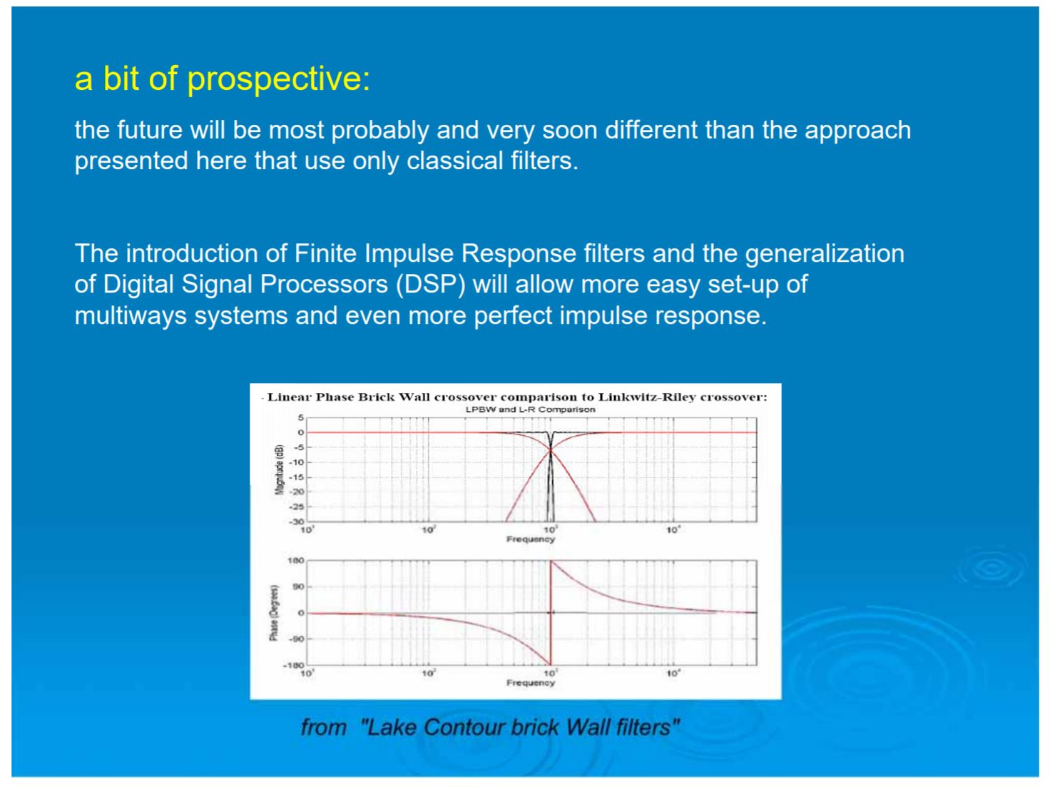

Check out "Crossovers, a Step Further" by LeCleach

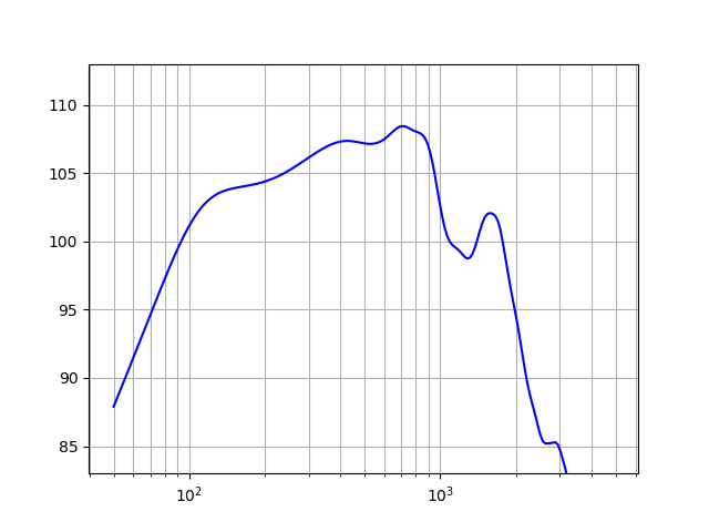

It turns out something was wrong with my simulations. I was putting the "pre-horn" throat impedance in series with the main horn impedance... When I properly put the horn itself in series (that is, connect the bandpass port impedance to the throat impedance of the pre-horn and its mouth impedance to the main horn throat impedance), I still get the same increase in loading at lower frequencies. However, the mass loading causes major resonances that vary according to the length of this first horn. The more I increase the mass loading, the worst it gets. Without substantial mass-loading, I get mild peaks such as the following (pre-horn length is 1/2 wavelength at 2 kHz)
If this length is sufficiently short, those can be made to occur outside the pass band, but HF extension is sacrificed. In the following the pre-horn is 1/4 wavelength at 2 kHz:
It seems that the main conical horn throat does not resistively load the port sufficiently to avoid reflections. Simply using the bandpass chambers, everything seems alright, except I loose all the gain advantage:
Moreover, the horn above cannot really be physically built... I can recover some driver loading by increasing the mass loading of the port at the cost of a somewhat peaky response. This is the direction I'm considering with some EQ to reign in the peaks. In the following, the port is twice as long:
In conclusion, the suggested approach seems to work if one restricts the bandwidth of the driver. I am sceptical of its usability in a two-way synergy where the driver has to get in the 2 kHz range...

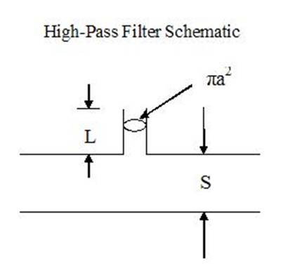

Hi all,
So, fiddling more with simulations, the big problem seems to be the impedance/flaring discontinuity at the point where the pre-horn enters the main horn. At low frequency, this is irrelevant as this discontinuity happens over too short of a length to cause much of anything. However, at the higher end of the bandwidth, where the wavelength is much shorter, the propagation is seriously affected and causes reflections. This is really a big challenge! I see several ways forward, but they are starting to push the limits of simulations.
One way is to ditch the pre-horn loading, avoiding the discontinuity problem entirely, but sacrificing the gain.
The only other way I see is to somehow avoid the discontinuity, at least at the frequencies that are problematic. To do so, one could make use of an "acoustic crossover" and inject the high frequencies directly in the main horn while making the low frequency take a longer route through a pre-horn (or even an entirely different tap point!). This could be achieved using a combination of the following:

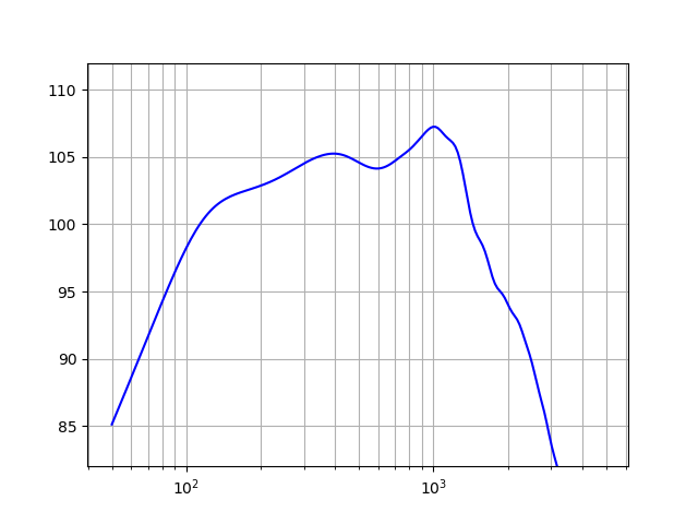

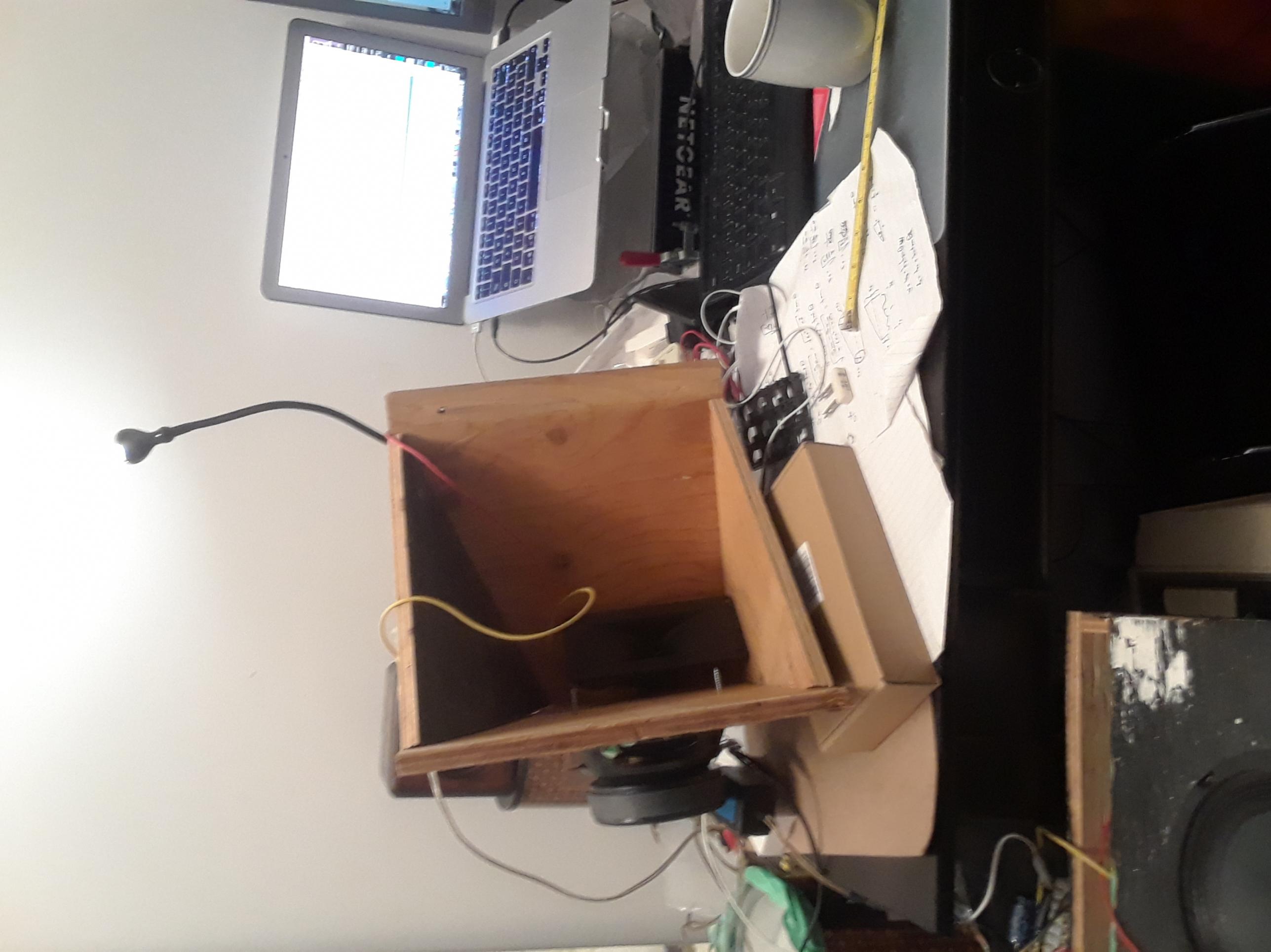

Here is the test setup, it now has a simple tap:
P.S.: I forgot to mention it: Even with the cheap piezo tweeter not properly placed, no phase alignement and a smidge of EQ, it already sounds surprisingly good and can be quite loud! Having the drivers close together really makes a difference! I just received my minidsp, but do not really have the time to play with it now...
After a lot more simulations, I arrived at the conclusion that it can be done if the bandwidth of the woofer is not extended too much. The approach I am using is to add a cavity with some stuffing between the "pre-horn" and the port to the main horn.

I always enjoy reading that paper ......'Crossovers, a step further'
And i must admit, i particularly like how he concludes his circa 2004 paper on the last page .....'more easy' and 'more perfect' .... true for synergies too 😉

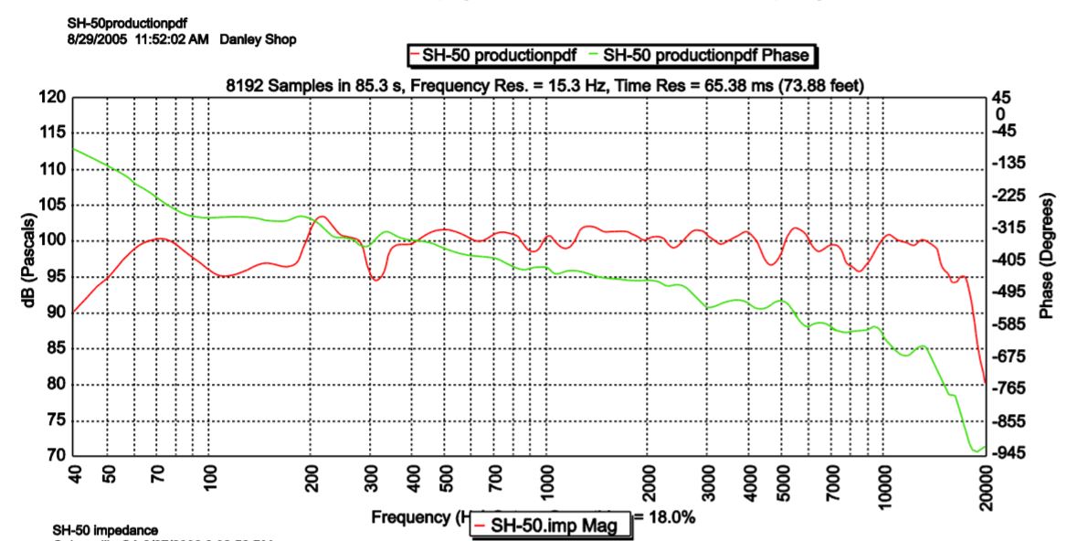

I don't think you're missing anything Rob.
I re-skimmed this thread and saw back last year, that i was thinking that an acoustic first order was the goal....but that was just from trying to dissect the patents...(which frankly i now think are a bit of a smokescreen).
And before i started trying to build any synergies on my own...
Anyway, here's the phase trace of the SH50 from the Danley site..
...note the phase scale on the right 😀
