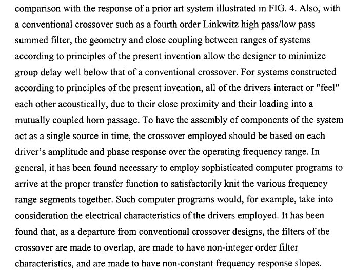

Directly from the patent. Ideally, you'd want the bandpass to be higher in frequency than the crossover, while having the HF rolloff to be lower. The point is that to counteract the time delay given by the path length difference between the HF and the mids, you necessarily need to have at the crossover point 90 degree of phase difference (if they are 1/4 wavelength appart at the crossover frequency). Of course, this does not account for any remaining reactance from the drivers themselves.
I'm starting to lean towards mark100's opinion in that this part of the patent is a bit of a smokescreen.
The goal is to have linear phase across the whole bandwidth. Pragmatically speaking, you have to account for the remaining reactance of the drivers. Also, you might want to put the first cancellation notch a bit above the crossover point, so there now is less than 90 degree of phase to correct for. Then there is the remaining reactance of the acoustic bandpass filter. You see where this is going... At the end of the day, you'll need to measure the responses of each drivers and tweak the crossover of you want somewhat linear phase. Of this, I'm aware of. And it becomes certainly doable with any orders if you allow for time delays.
My initial point was mostly concerned with attaining somewhat linear phase with only passive crossovers. Danley does it on some model. But in this case think about this: the bandpass, the rolloff and the lowpass in the crossover all delay the phase of the mids output. On the other hand, the LF rolloff and the highpass advance the phase on the highs and the only delay on the phase is given by the path delay, with respect to the mids. By tweaking crossovers, you can arrive at summation at the crossover point. However, it seems almost impossible to escape the phase shift at the crossover. This is because midband, the phase will have a given slope for each drivers, but then a much sharper slope at the crossover point if the acoustic crossover high order.
The only ways out I can see in that situation is to use time delays with DSP, to use first order crossovers with well behaved, wide bandwidth drivers or to have a complicated crossover that mess around with the phase midband, like I suggested earlier (e.g. using delay network, "detuned" crossover filters, etc.)

It seems that the patent suggesting low order crossovers, specifically first order electrical, so that the resulting phase shift is countered by the path difference, is a bit of a red herring. Thus, it seems the real point being made here is that one needs to take into account this path difference when doing the crossover to maintain summation. Approaching it this way would simplify my build!

Well I've just read the patent( for about the 10th time ) and I still couldn't find any reference to 1st order slopes.
I found references to non integer slopes and roll offs that were 'non constant' slopes.
I'm still running round in circles here :D
Rob.
