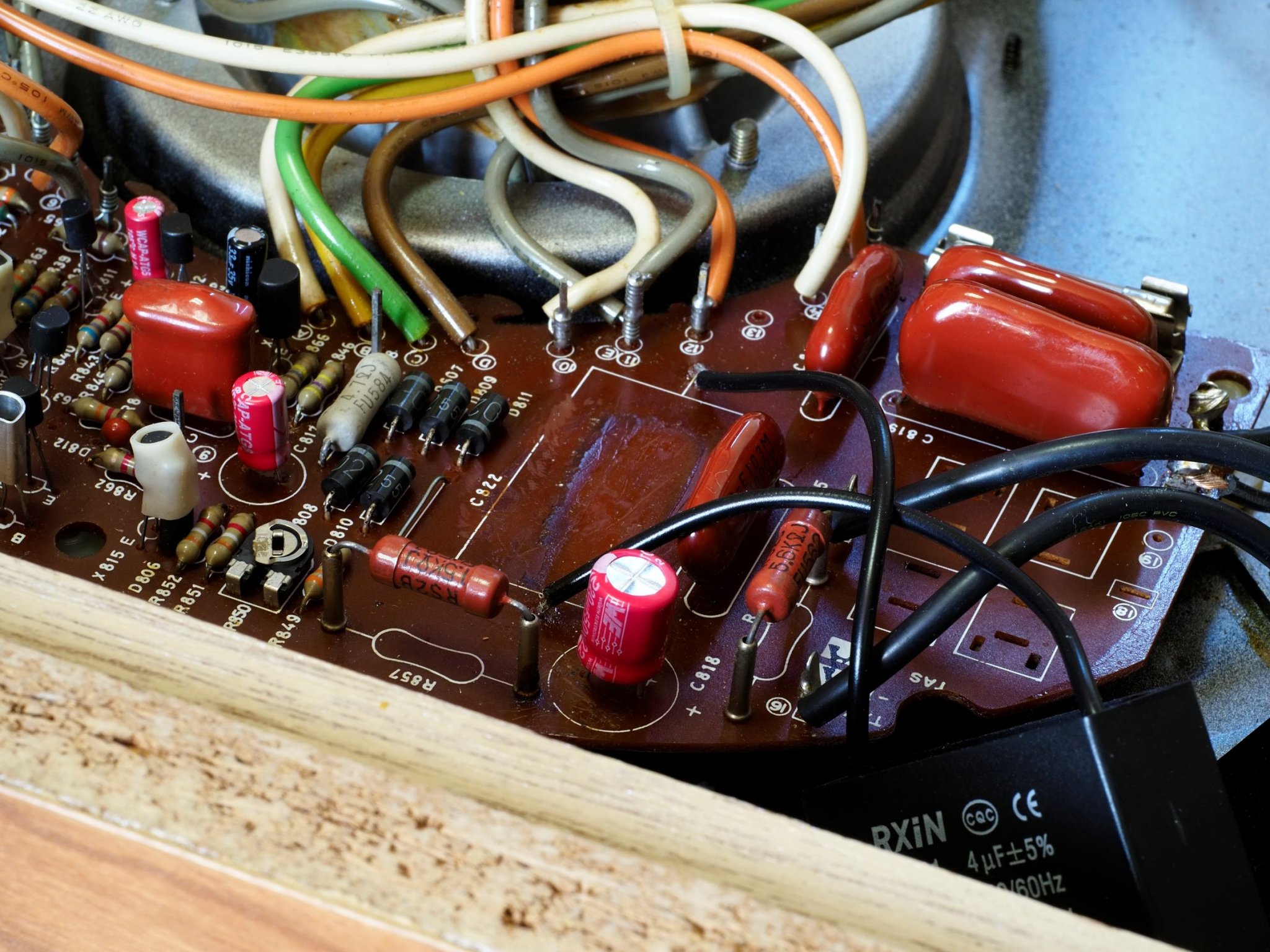

Something else worth checking would be the VD-1121 diodes. Some sources say these are 'double diodes' and others say 'single'. This series of diode does give trouble in many amplifiers where it is used for biasing and temperature compensation..
Measure the voltage across them. If they are a double diode you should see about 1.2 to 1.3 volts vs 0.6 volts for a single. If the voltage is wrong or unsteady then worth a try replacing with 1N4148's (two in series if its a double)

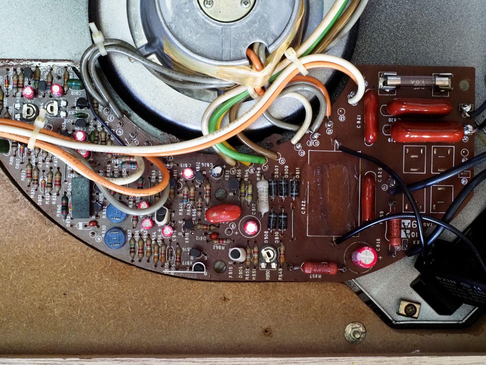

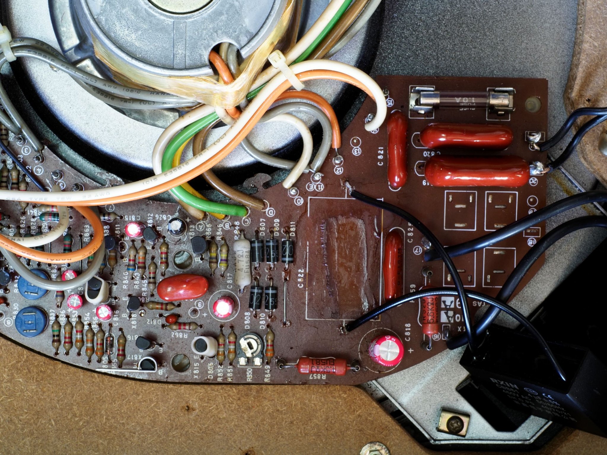

I ran a quick check on the diodes (in circuit, power off). All were about 0.57 in one direction, OL in the other, except for D801 and D802. These read 0.57 forward biased, 0.69 in the other direction. Not sure what that means, but perhaps the identical reading for both suggests that they're working as intended?

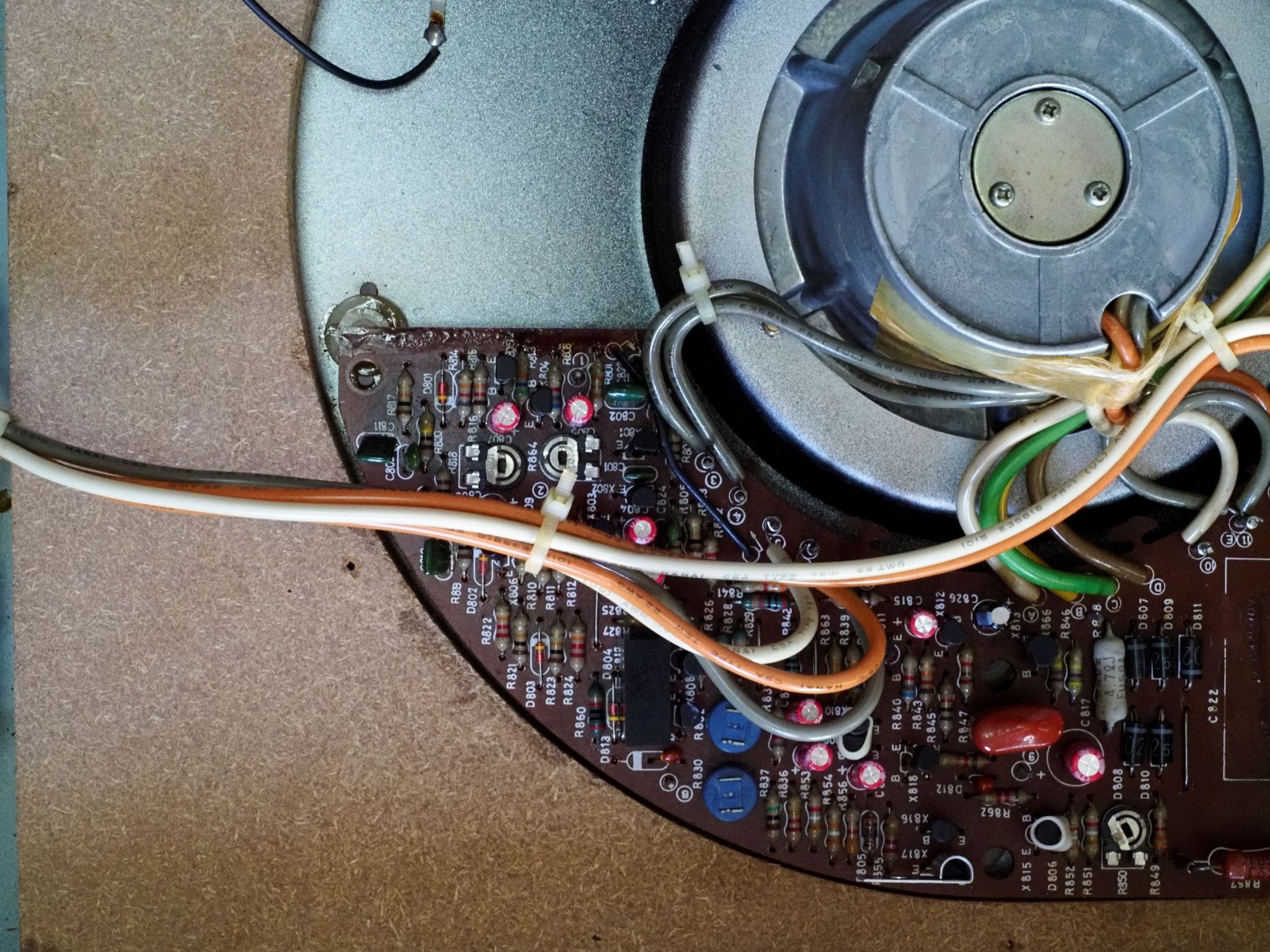

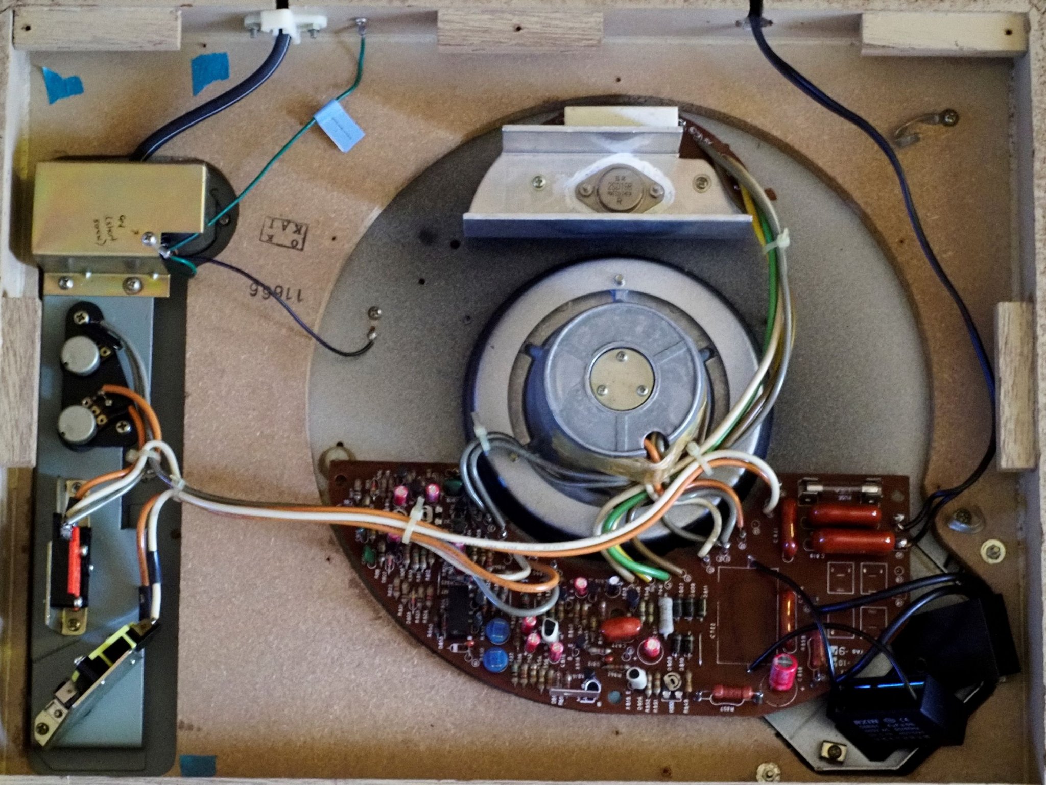

For a general idea of the physical circuit layout, I'll put some photos of the underside of the tt in the post below.

The diode result is to be expected. Look at the circuit These diodes are across a base/emitter junction that will appear as an inverse parallel diode to the one you are measuring. So all normal at a basic level of testing in circuit.
