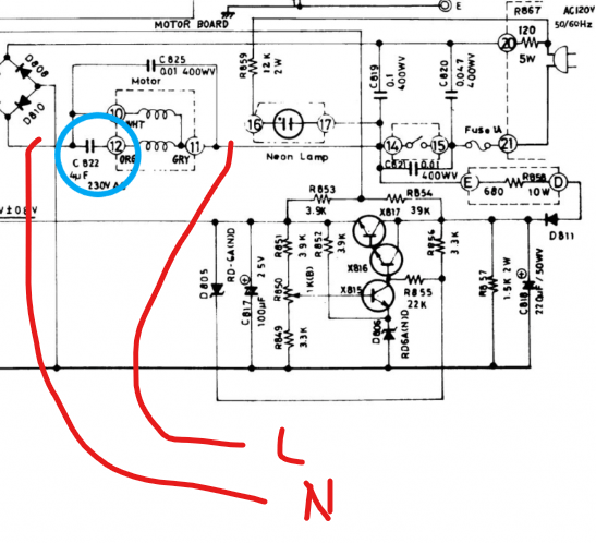

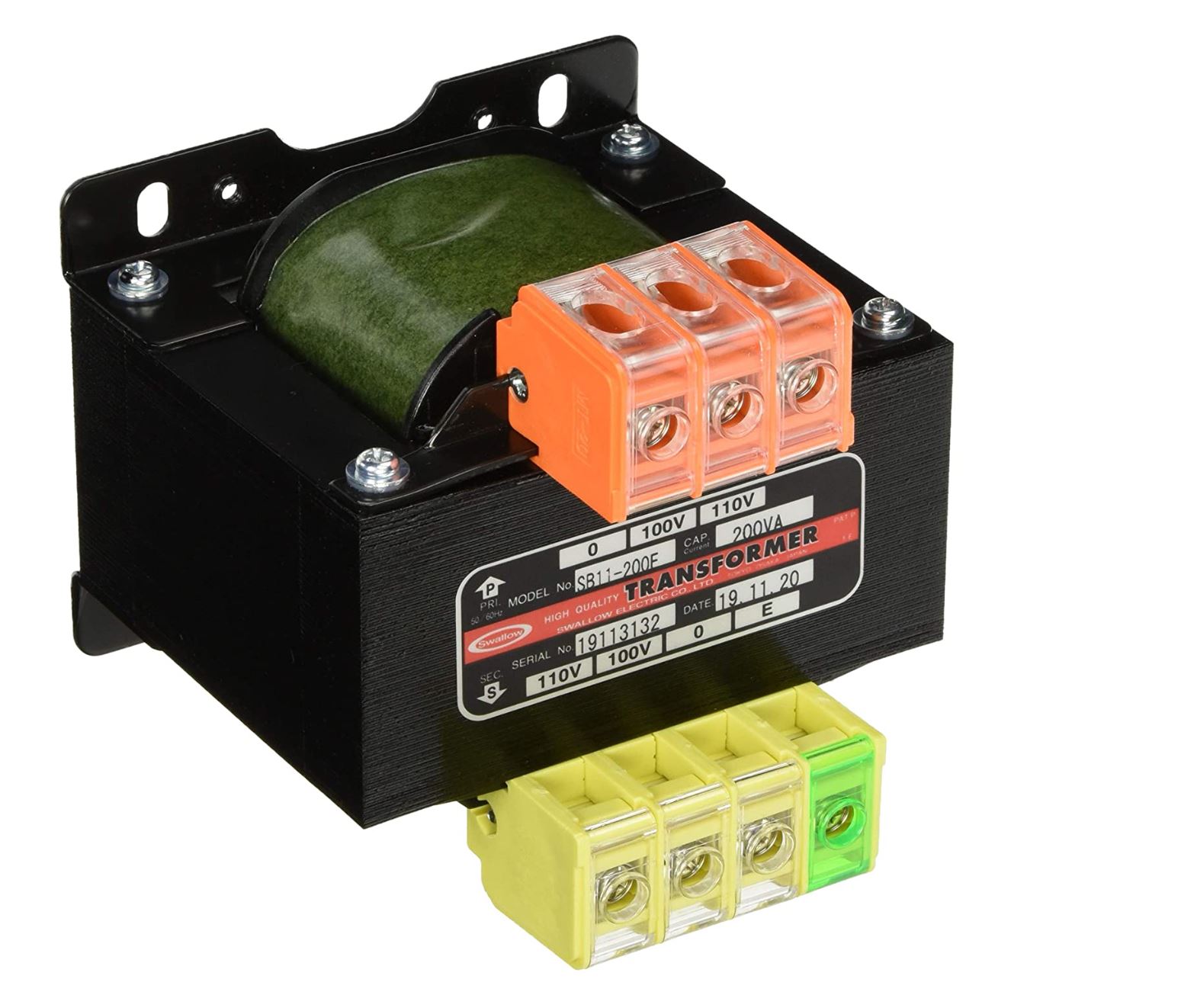

For tests with a scope etc, if I want to connect the DUT to a 100V-100V isolation transformer, is this getting close to what I would need?
This is Swallow SBE series, and the manufacturer has another series, SA, without the earth terminal, but it looks like all of the models in that line only do step-up or step-down.
I only have access to ungrounded electrical outlets for 2-prong plugs, so the earth terminal on this would be unused anyway.
Sorry, I posted right after Osvaldo's comment, but actually I was looping back, in my own mind anyway, to a comment over a week back about the need for an isolation transformer. Something I have left too long, and have to take care of, for the various projects I've been doing and new ones that I will be doing.

After reading up on safe use of oscilloscopes I have lost my nerve on using one to test equipment for the moment. The best move might be to get some differential probes when I have scraped together a little money. I have no direct way to ground the scope. I only have access to a ground wire connected to a buried rod that I put in a few years ago in case I needed it. I guess I can check it by connecting the wire to the pigtail on a powerstrip. If it tests out, I can ground from the back of the scope to that. The other part of the test setup would be the turntable connected to an isolation transformer. The transformer would be connected to an ungrounded outlet. If it's worth anything in terms of safety, I can use a two prong GFCI plug either on the mains and plug the transformer into that, or on the secondary side of the transformer, but I asume it adds nothing useful.

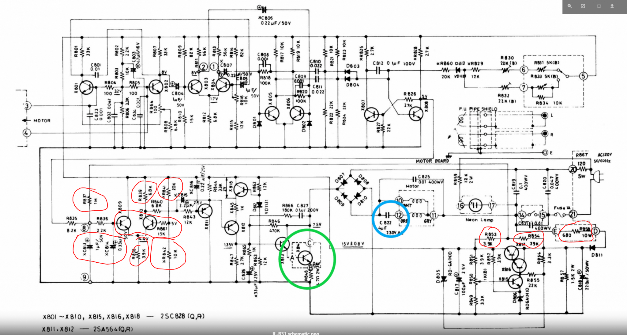

I had a bit of a look.... The flutter could be caused by a slight drift in the values of the components that I circled.
The differential input pair compares the 5V (the +15V DC rail must be stable + the R842 & R841 must not drift) with the mains supply voltage, whose representation is present at point No 8 (check: all other values I circled in red; that R837 in particular). I think it is normal to see the variations in voltage drop across R839 - the problem is that these variations are either too large, or not large enough.
I'd use a can of freeze spray as well and do very short bursts of focused freeze air... there might be some cold solder joints (hot spots developing), as well. You could check for the cold joints if you look very closely at the soldering points with a magnifying glass while bending the PCB ever so slightly.

Also, because it is an analog circuit, the root cause could be oscillations that vary in amplitude (like parasitic oscillations)... You'll need to look for these with an oscilloscope. Due to the nature of this circuit, you must use either an isolation transformer to power it, or a differential probe on your oscilloscope.
Setting the oscilloscope across R847 you surely can see the sine wave that the speed is modulated. So mooving the tip back in the signal path you will found it with variations in the shape and amplitude. Its like as kind of motorboating, in place of offending a speaker, in this case, a motor. As already mentioned, I would start replacing caps but with values close to the originals: don't put 10uF where was a 1uF. This will cause future complexity of the issue.
Thanks for the suggestions. For the resistors and caps, are you saying I should check their resistance and capacitance, respectively, against the specs? Or do you mean taking measurements during operation?
Resistors are easy to measure. Any resistor out of tolerance or suspicious (cracked, overheated, etc), should be replaced. IMO all lytics would be changed with no doubt prior to start any failure tracing. After replacing all, keep the motor running say, half an hour to let lytics "accomodate" into your circuit.
