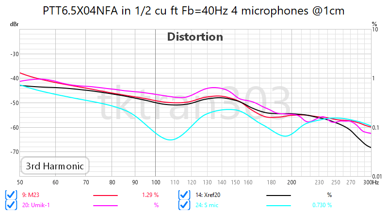

What are you talking about? All the measurements here show that microphones mainly have H2 and all higher harmonics are magnitudes lower.Obviously the D3 harmonic of common measurement microphones is very high
@Hörnli
I’m glad you encouraged me to push forward with testing via dynamic microphones. Their high SPL handling capability means that their own self distortion are closer to being able to match the classically powered B&K and G.R.A.S. capsules with external polarisation.
As we can see, there’s variation in both H2 and H3. How much depends on how close the mic is to its limit, but also peculiar differences in the mic. Is it the mic capsule or the electronics?

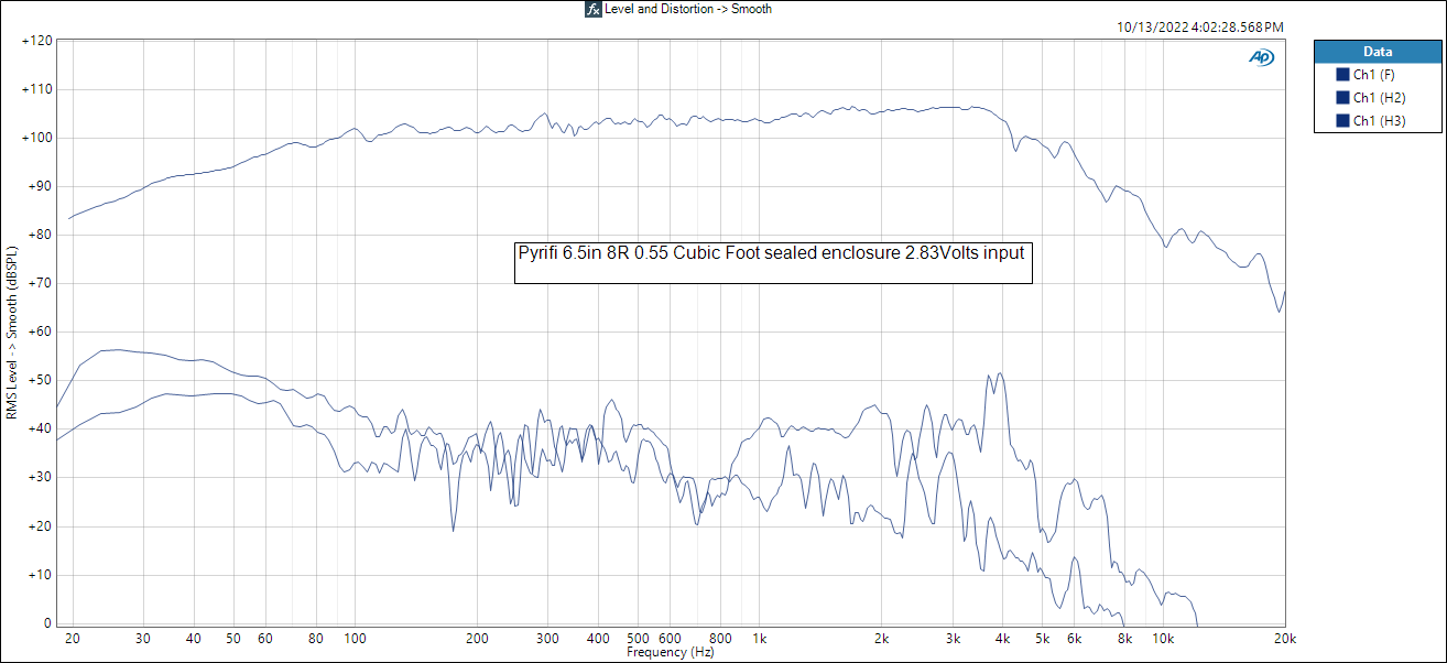

"Three microphones were compared: an inexpensive model (MM-1 T-Bone, costing around € 35), a mid-range model (Audix TM1, around € 300), and a class 1 reference microphone (NTI M2210, cost around € 1100)"
I was suspicious that €€€€ could be the only factor, so went to look at the mic specs a bit closer and…
MM-1 has max SPL of 110dB (1% THD)
TM1 has max SPL of 130 (1% THD)
NTI M2210 has max SPL of 144dB (3% THD)
( ?134dB @1% THD)

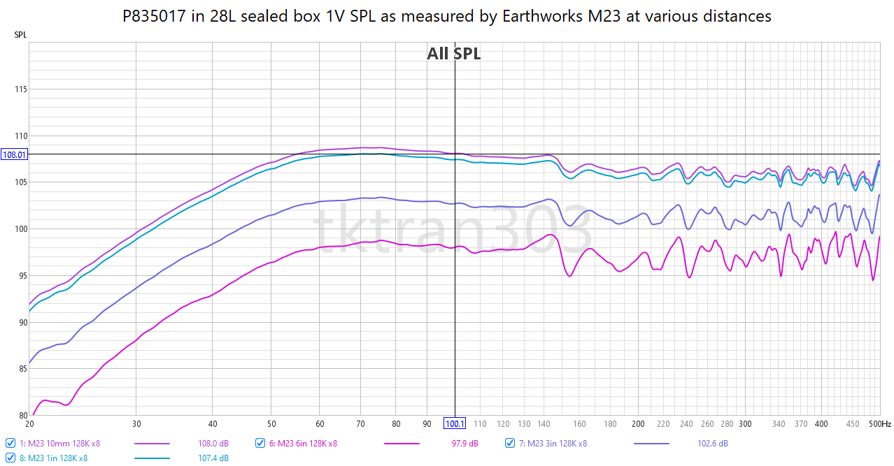

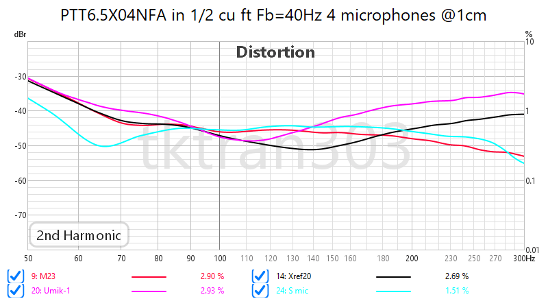

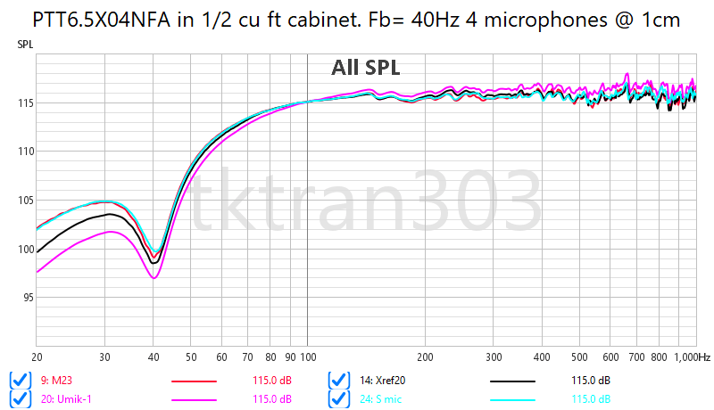

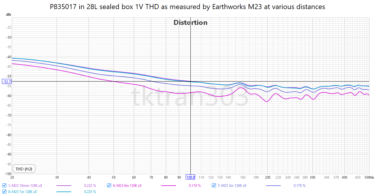

Next we measure a 12" woofer in a 1cu ft sealed box.
With a drive level of just 1V- this should be easy work for any 12" woofer!
We measure with a (Farina) log sine sweep, 128K samples x 8. Multiple measurements average the coherent noise, with improves the measurement.
Then I move the microphone from 6"/15cm, 3"/7.5cm, 1"/2.5cm, 1cm:
Since the speaker is just driven with 1V, any increase in distortion at closer observation distance must be coming from the microphone:
So the Earthworks M23 should not be used in the nearfield to measure distortion- it contributes significant distortion of it's own.

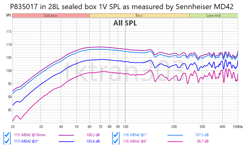

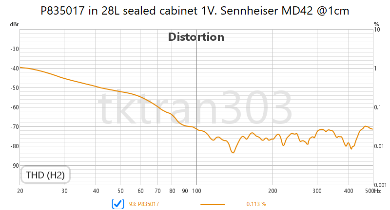

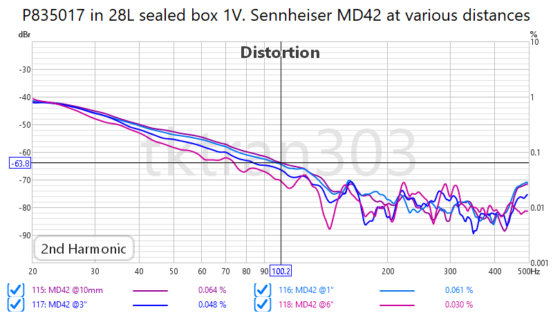

Let bring back the omnidirectional dynamic microphone, and see what happens when it's placed in the nearfield to measure the bass response:
As we can see, it observes lower H2 than the small electret condenser microphone like the Earthworks (and Sonarworks Xref20/Umik-1)

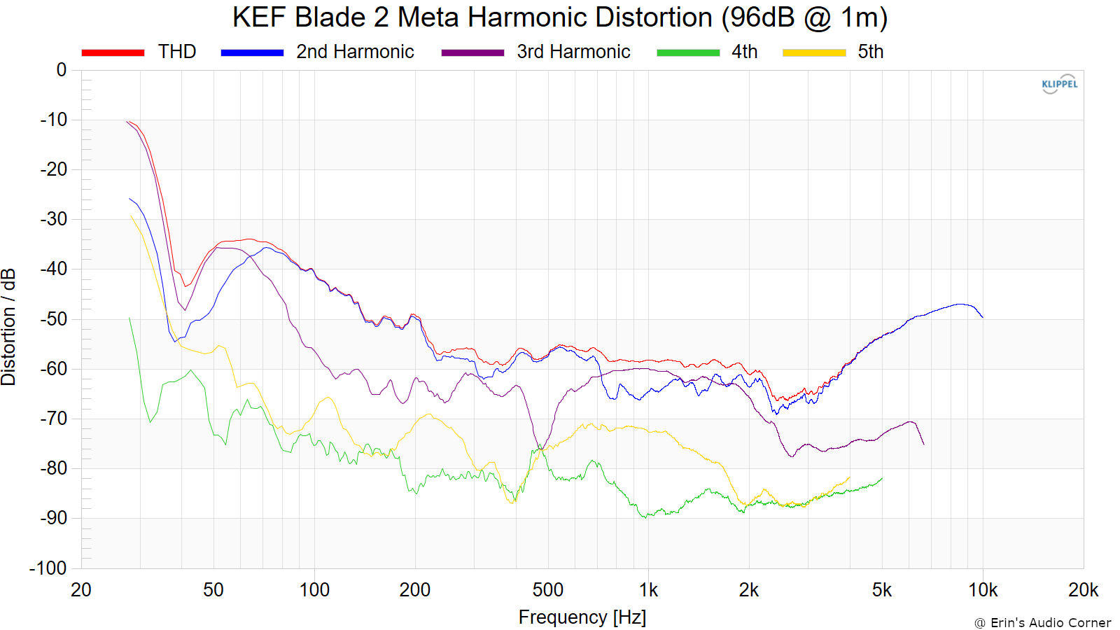

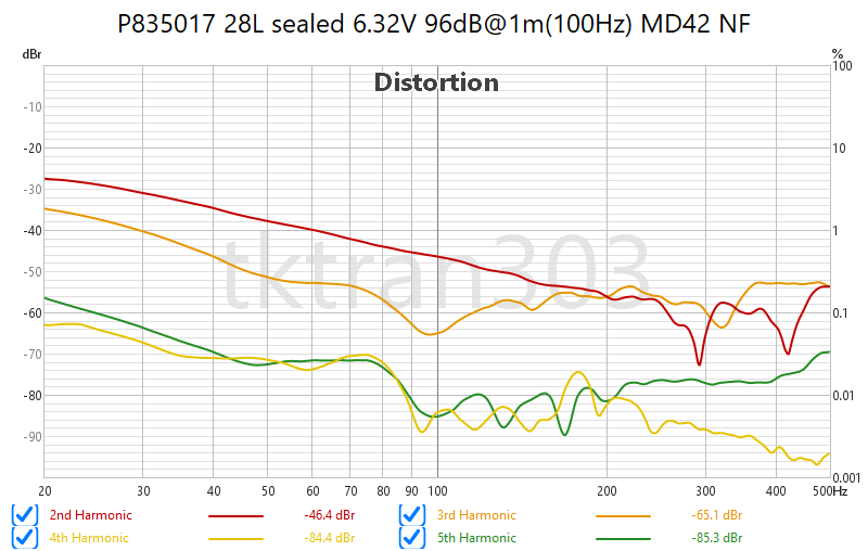

Let's proceed with our harmonic measurements:
A comparison point:
Reference:
https://www.erinsaudiocorner.com/loudspeakers/kef_blade2_meta/

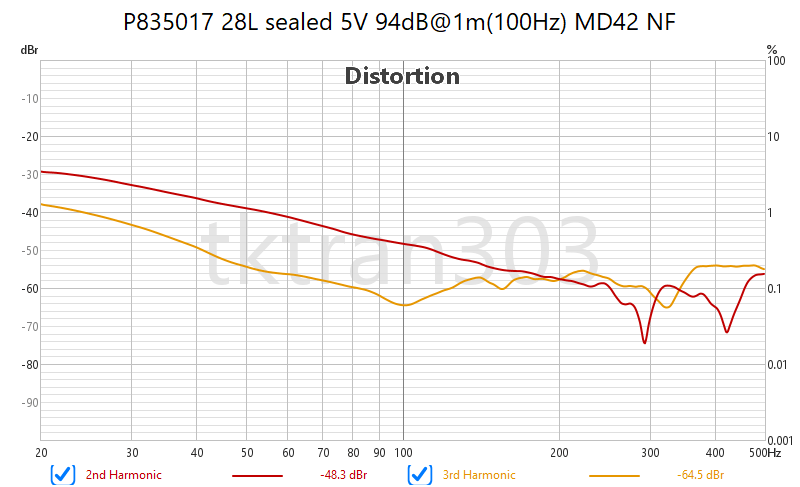

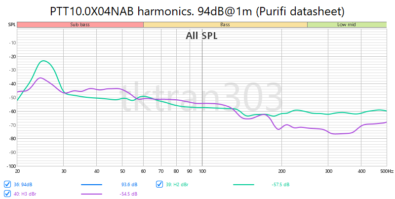

BONUS data:
Reference:
https://ptt.purifi-audio.com/document/share/10/7958f847-3d8c-4fc5-8a68-cb8298539ef4
Figure 6- Frequency Response @1m, 94dB- Fundamental, 2nd and 3rd harmonics:
@lrisbo
The 10" PTT is better than the 12" XXLS.👍

Did you repeat the different distance measurements with the dynamic mic? It would be a GREAT help in comparing graphs when you just repeat EXACTLY the same procedure and scaling of the graphs.Let bring back the omnidirectional dynamic microphone, and see what happens when it's placed in the nearfield to measure the bass response:
There are still a few strange effects going on. The dynamic mic records more THD at 20Hz as the Earthworks in close distance. My Earthworks M50 has about -70dB THD at 250Hz and 110dBSpl. It would not have any influence to your measurements! Not sure what causes these results - don't be to quick that it is from the microphone!
Yessir of course I did measure at different distances with the dynamic mic:
I agree that it can appear that the dynamic mic has slightly more H2 at 20Hz @1cm (-42dB) than the Earthworks M23 @1cm (-43dB). I would not take it as significant- a repeat test at quieter conditions show slightly different tests. I would say within the margin of error.

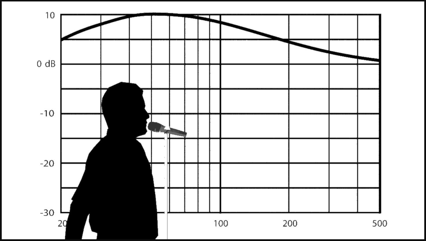

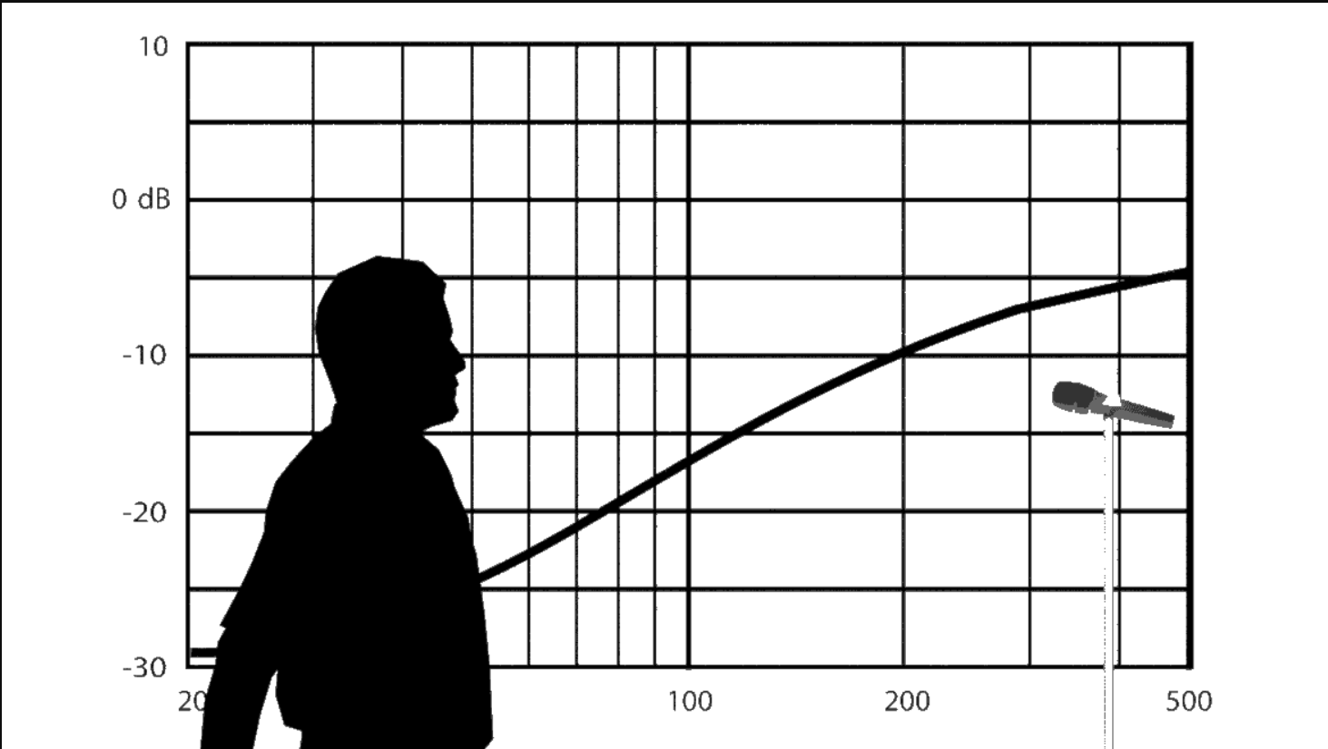

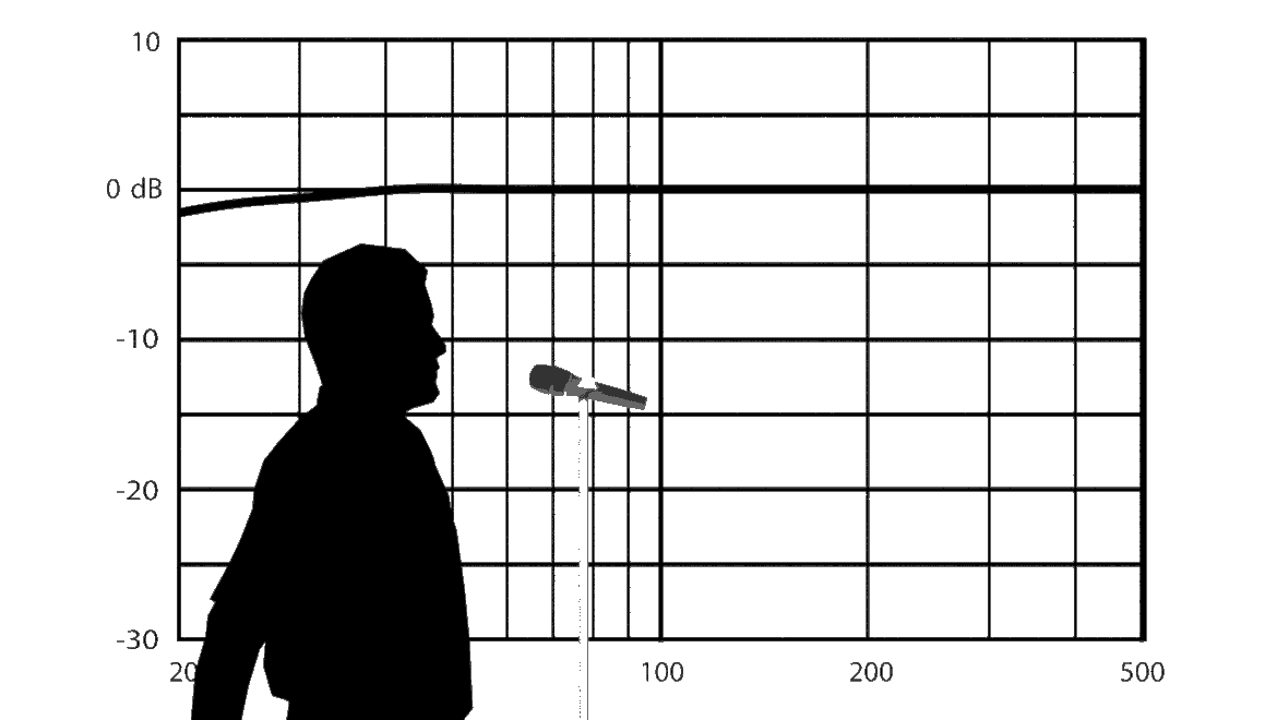

Glad you asked.
In short, we can measure at various distances without having a gain or loss in the bass response.
Omnidirectional microphones do not exhibit proximity. This is because the sound has only admittance to the front of the diaphragm. A pressure microphone is basically a diaphragm in front of a closed chamber.
Proximity effect:
Reference:
https://www.dpamicrophones.com/mic-university/source-dependent-proximity-effect-in-microphones
Proximity effect:
Reference:
