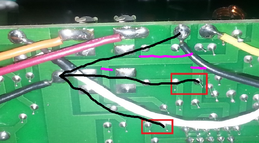

Schematic of amplifier:
How are the Cs (from pins 1,4 & 5) routed at their 0V end? IME these are problem components as if they go direct to the 0V end of Ci or R2 there'll be grittiness in the sound.
Cuts and straps to implement star grounding (of a sort)
The cuts to make in the copper I've shown in magenta. Wires to add are shown in black. You'll still have a loop (because the signal cable running left-right has its shield in parallel with a PCB track) but I'm hoping there's no nearby field....😛
