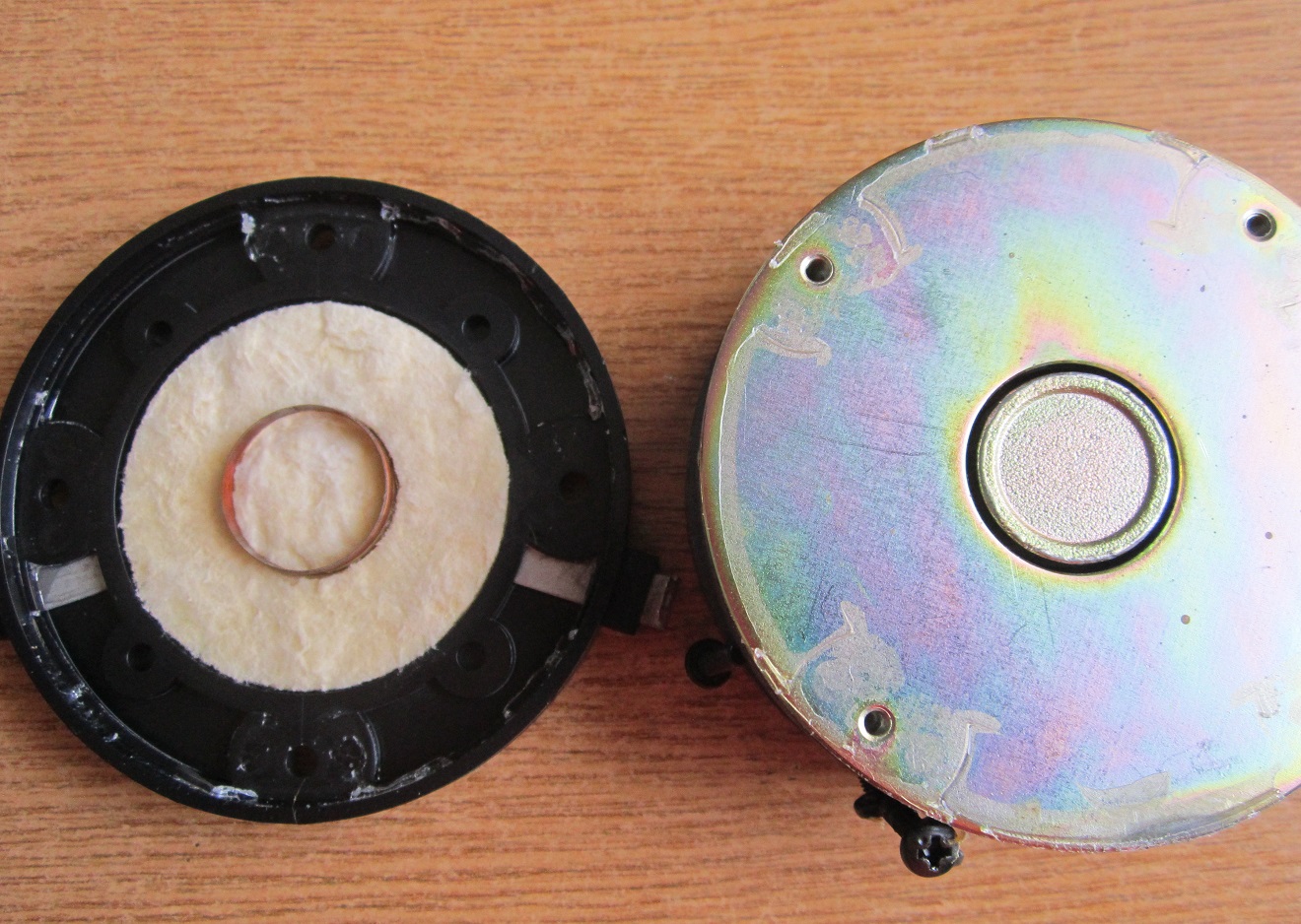

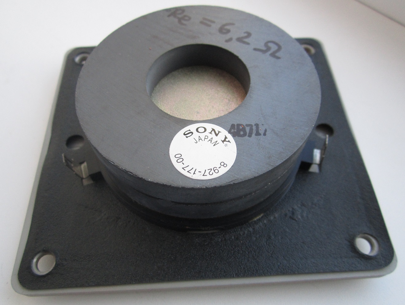

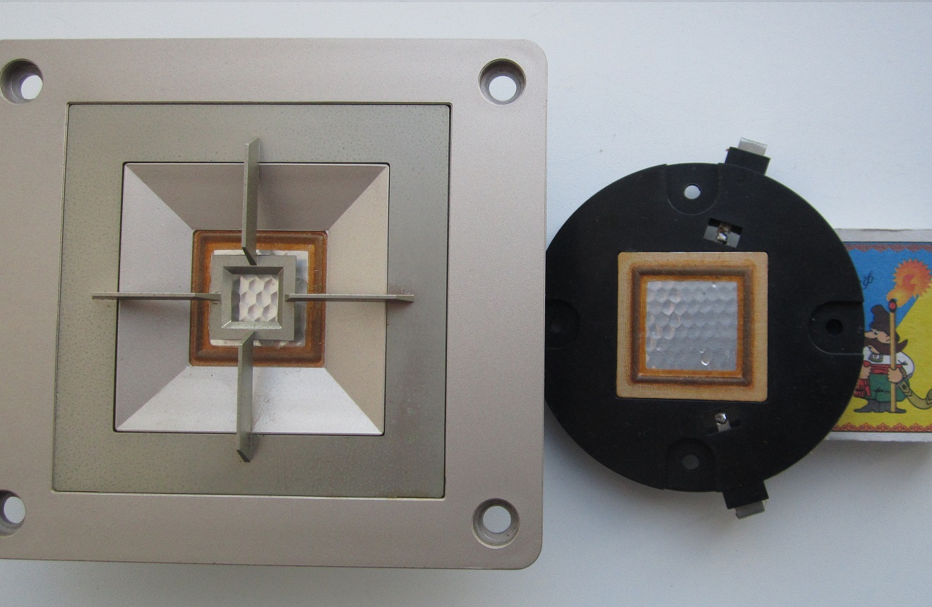

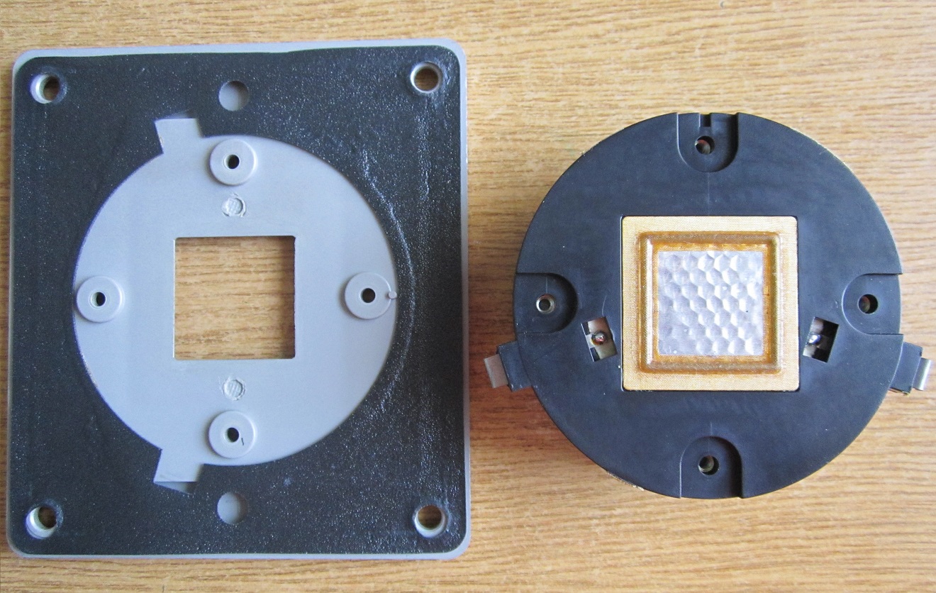

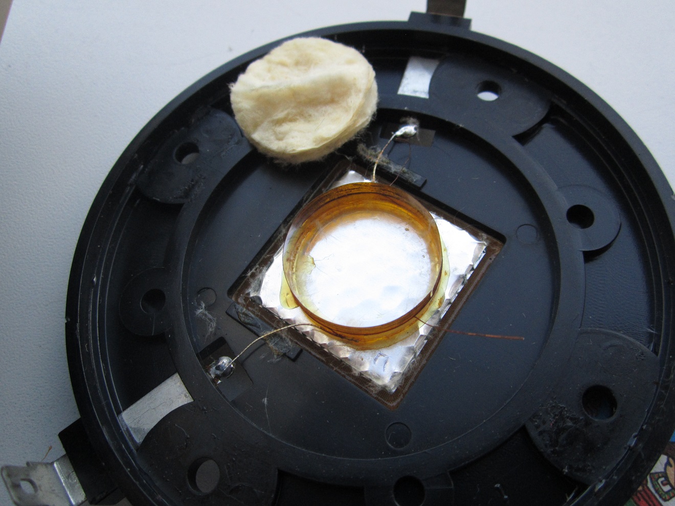

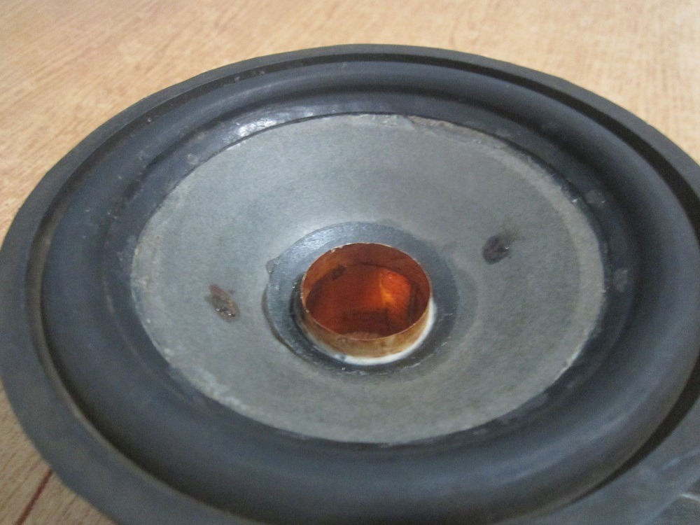

Thank you! Now the full picture.
I have repaired these several times.
And a photo of the structure.

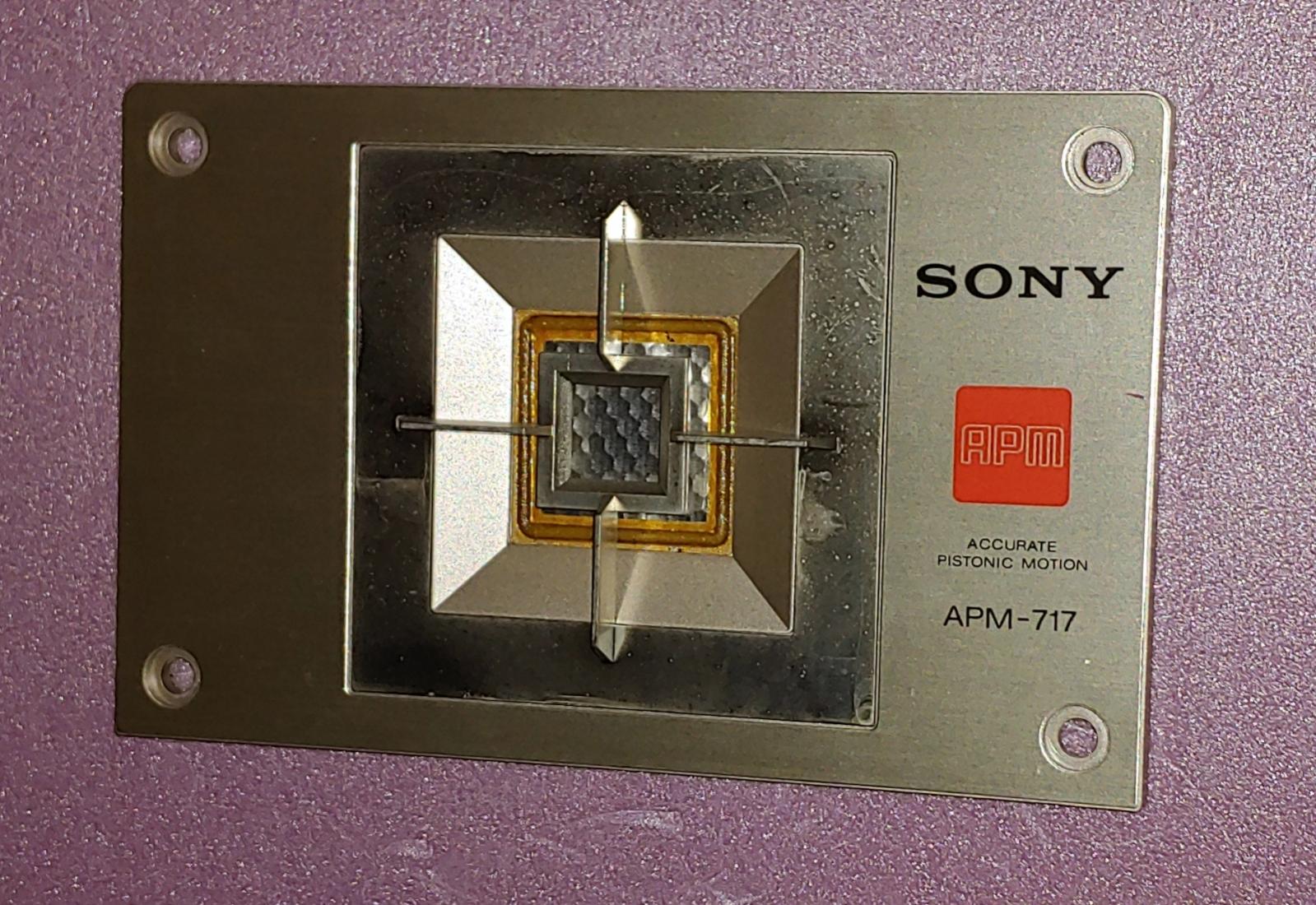

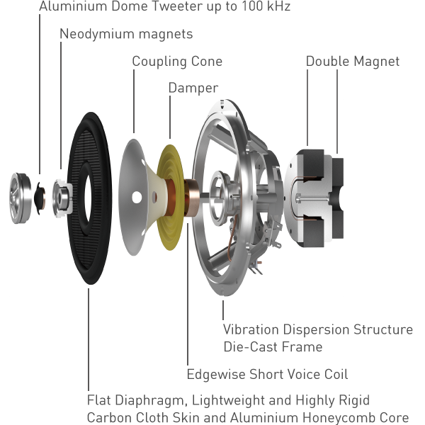

This loudspeaker by Technics might be in the same technological family.
What do you think?
Speaker System SB-C700 | Premium Class C700 Series | Technics US
What do you think?
The flat coaxial two-way speaker drive unit is an original Technics development, designed for the faithful reproduction of mid-range and high-frequency sound. The flat woofer diaphragm has a sandwich-structure using lightweight, high-rigidity carbon fibre skins and a honeycomb core, and is designed for a highly accurate pistonic motion over a frequency range extending beyond the crossover frequency with the tweeter, thus ensuring smooth integration.
The flat design eliminates the frequency anomalies due to the cavity effect caused by conventional cone diaphragms, while the magnetic circuit employs a large magnet, copper cap and shorting ring, and a short voice coil with concentrated edgewise winding for high power with low distortion. The drive unit chassis is in highly rigid die-cast aluminium, with the chassis ‘legs’ having a resonance dispersing structure to eliminate even the smallest unwanted vibration, to help the drive unit deliver accurate and powerful bass.......

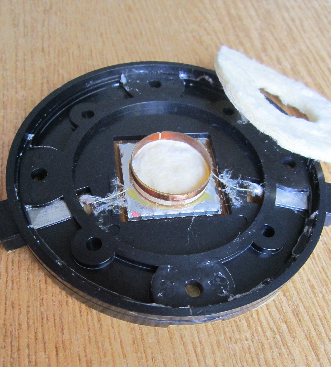

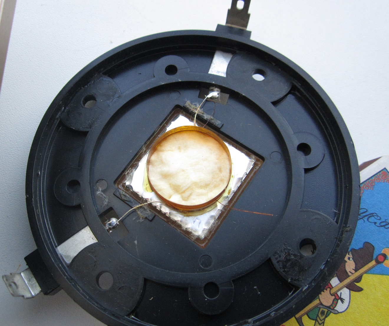

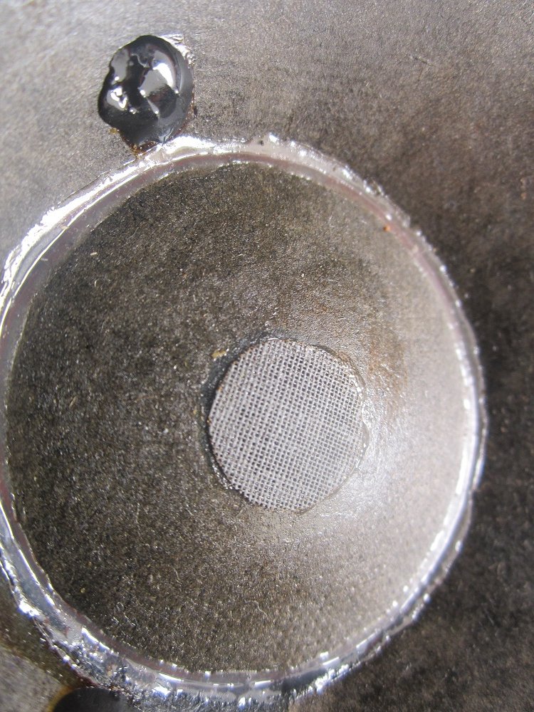

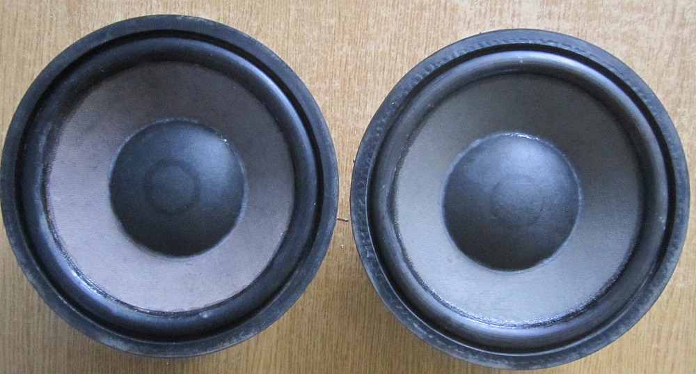

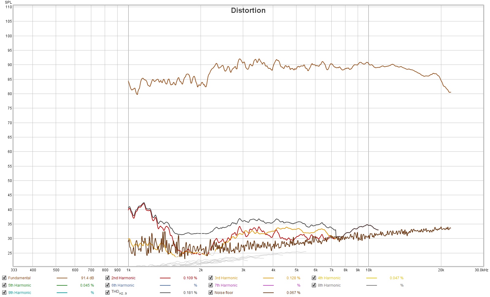

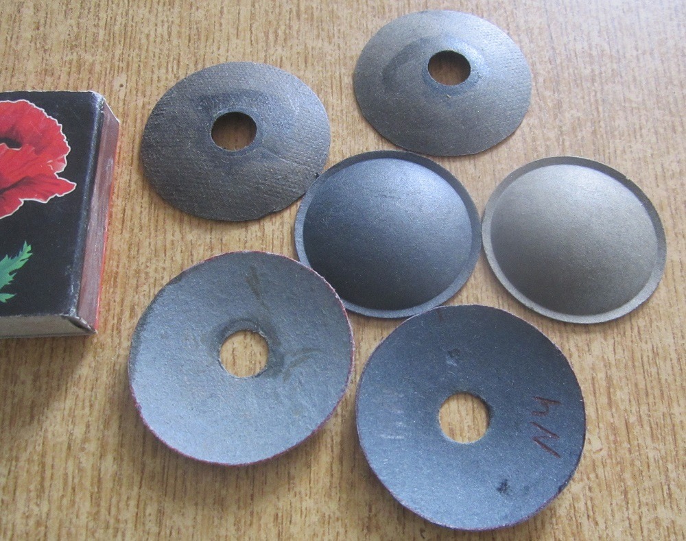

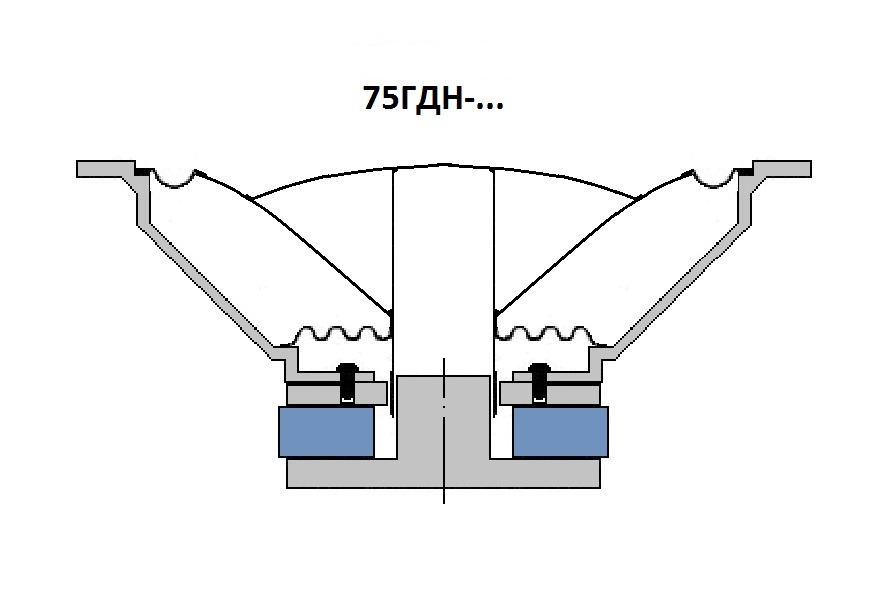

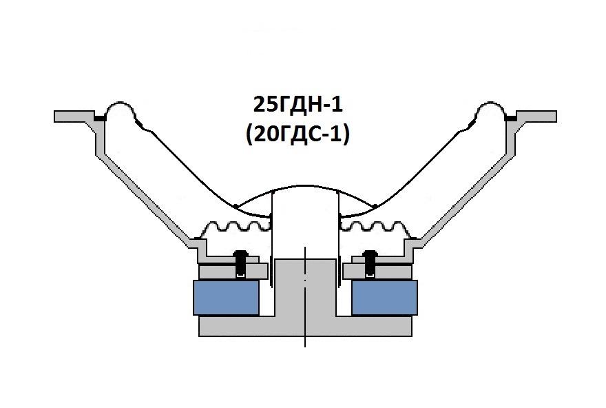

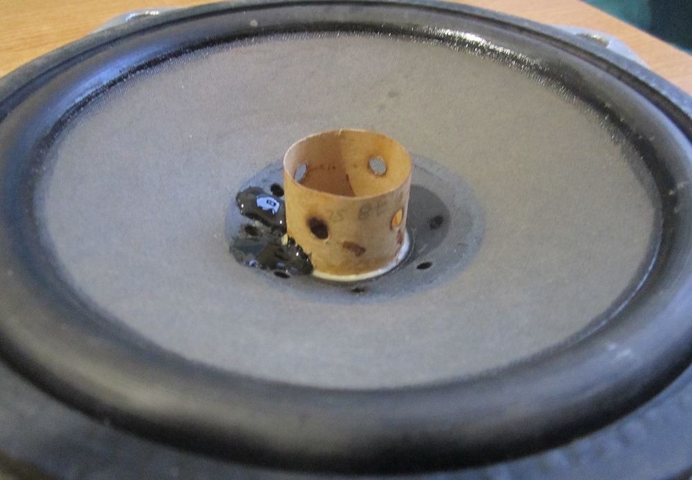

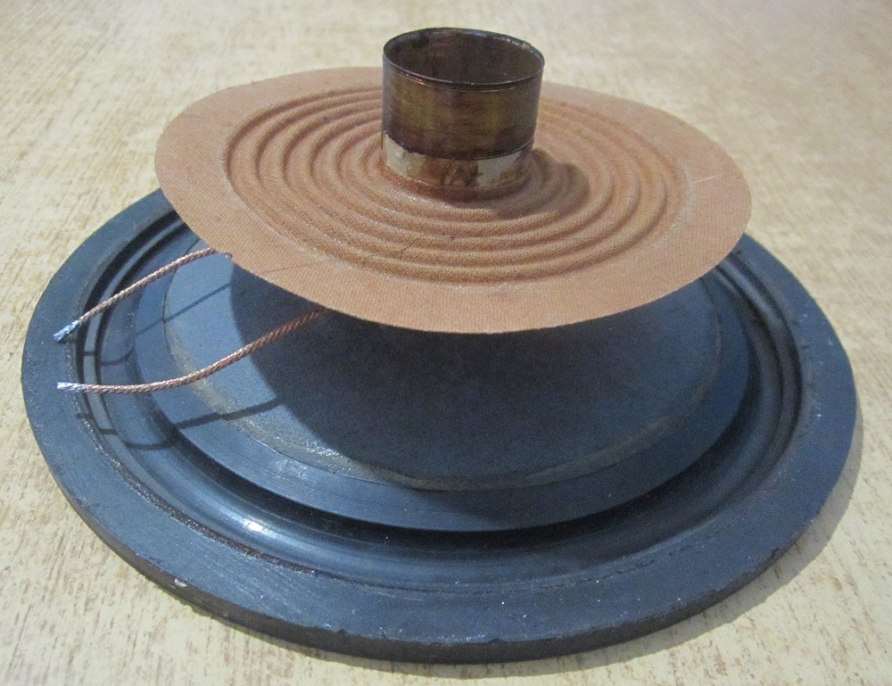

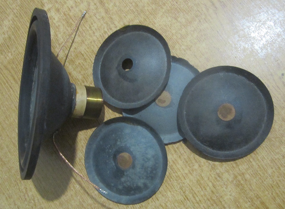

Hello Boden,
I don't make spiders myself, I take them ready.
The photo shows the upgrade process.
Taken from different columns. Relevant parts.

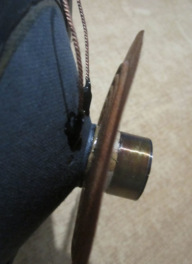

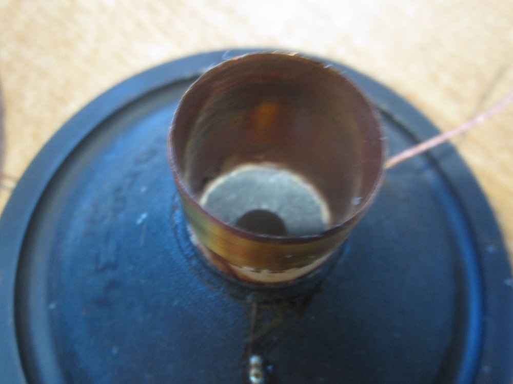

Photo of the next work.
The photo of the assembled moving parts shows traces of gluing the cap to the frame of the sound coil.
At the end of the assembly, the cone became solid in the radial direction.
It turns out that the extension of the voice coil is advantageous for ordinary speakers. Not just for flat "honeycombs".

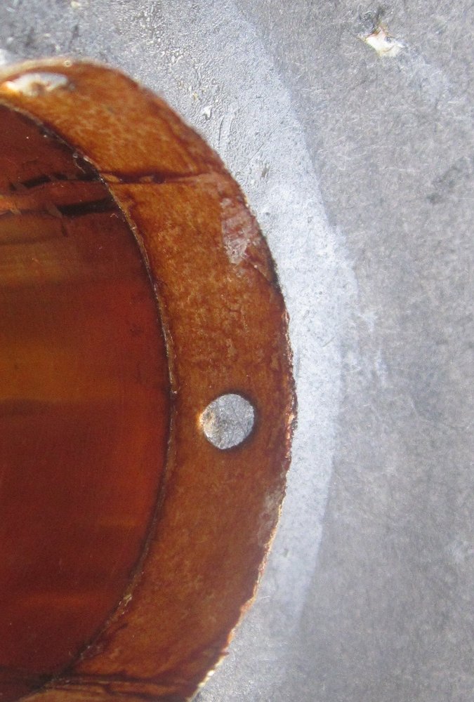

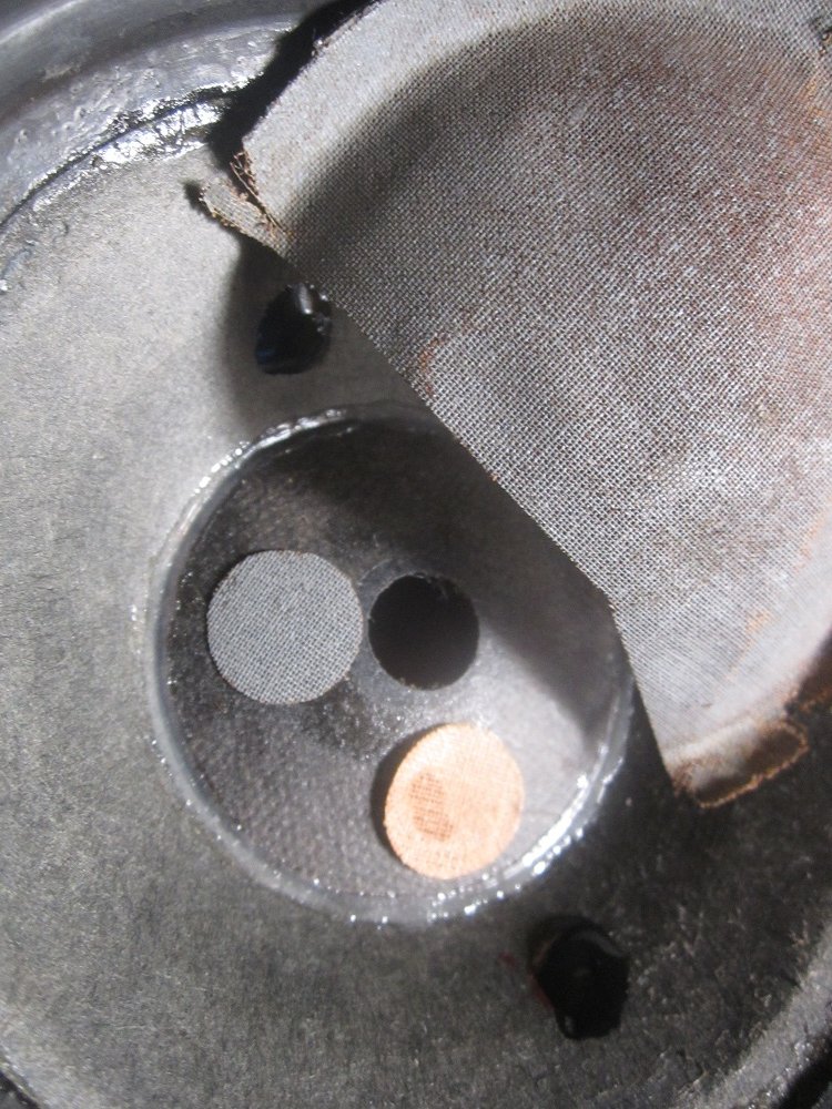

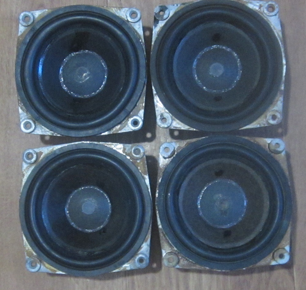

It was possible to take the family out of the occupation at the beginning of April. And now there is good news. The army chases the enemy, liberates the territories. So I can be here again. Friends, thank you for your support!
Even bought a couple of donor cellular loudspeakers for future work.
https://photos.app.goo.gl/WBCggRi3ZTfv5r1XA
https://photos.app.goo.gl/qvfLVrfXjkwf2G367

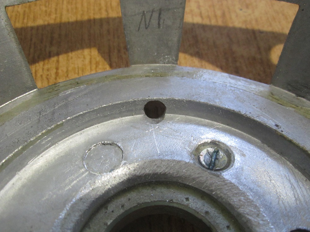

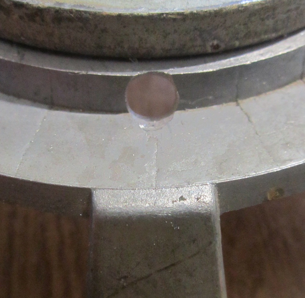

Domestic ferrite magnetic systems of loudspeakers are disassembled easily, purely mechanically. The glue is weak there. All others must be heated to 80-100 degrees Celsius.Дуже мило. Мені також подобається такий тип гри в динаміках.
Чи можу я запитати: чи є у вас спеціальний трюк, щоб розібрати магніт і полюсні наконечники? Виглядає як цільні литі рамки для глосників..
Then a strong blade at an angle to the place of gluing. And a hammer blow. in most cases, the magnet is disassembled without damage.
