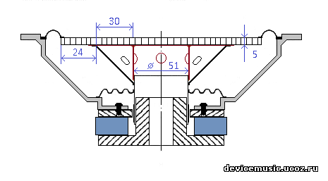

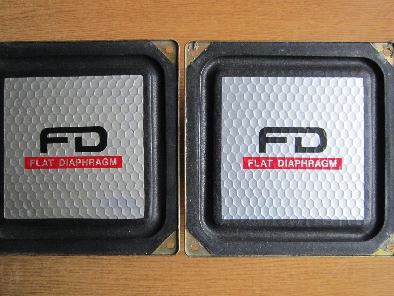

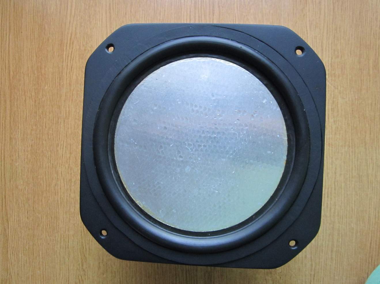

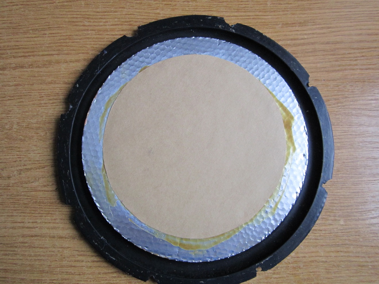

Improvement the speaker with flat sandwich diaphragm.
Noticed that a large part of the flat inner diaphragm is large. More than the edges. What triggers a significant resonans.
It is easy to detect finger impacts. This will sound.
Extended voice coil element, which increases rigidity. Using a thick paper, Kevlar and carbon fiber.
Adding a slight weight.
Even better is obtained when instead of a paper rings using a paper circle.

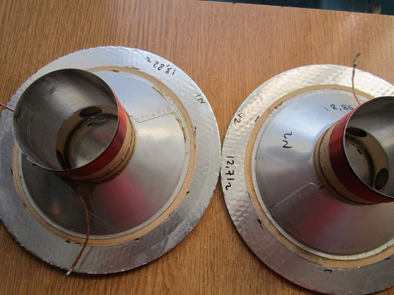

Photography upgrade next pair of 50GDN-1.
Old glue trimmed to the level of the foil. Completely remove is required.
In the second photo donor for a couple, of future cells speakers diameter of 5 "-5.5"
Initially, speakers be of not the workers.
Regained, with the upgrade.
Features one of them 8,5", after recovery :
......... Re, Ohm; ..... Fs, Hz; .... Qa; .... Qe; ...... Qt ...... Vas, l
№1 .... 6,7 .......... 31,8 ...... 2,88 ... 0,385 ... 0,34 .. ... 48
Most importantly, the sound improved. In the midrange.

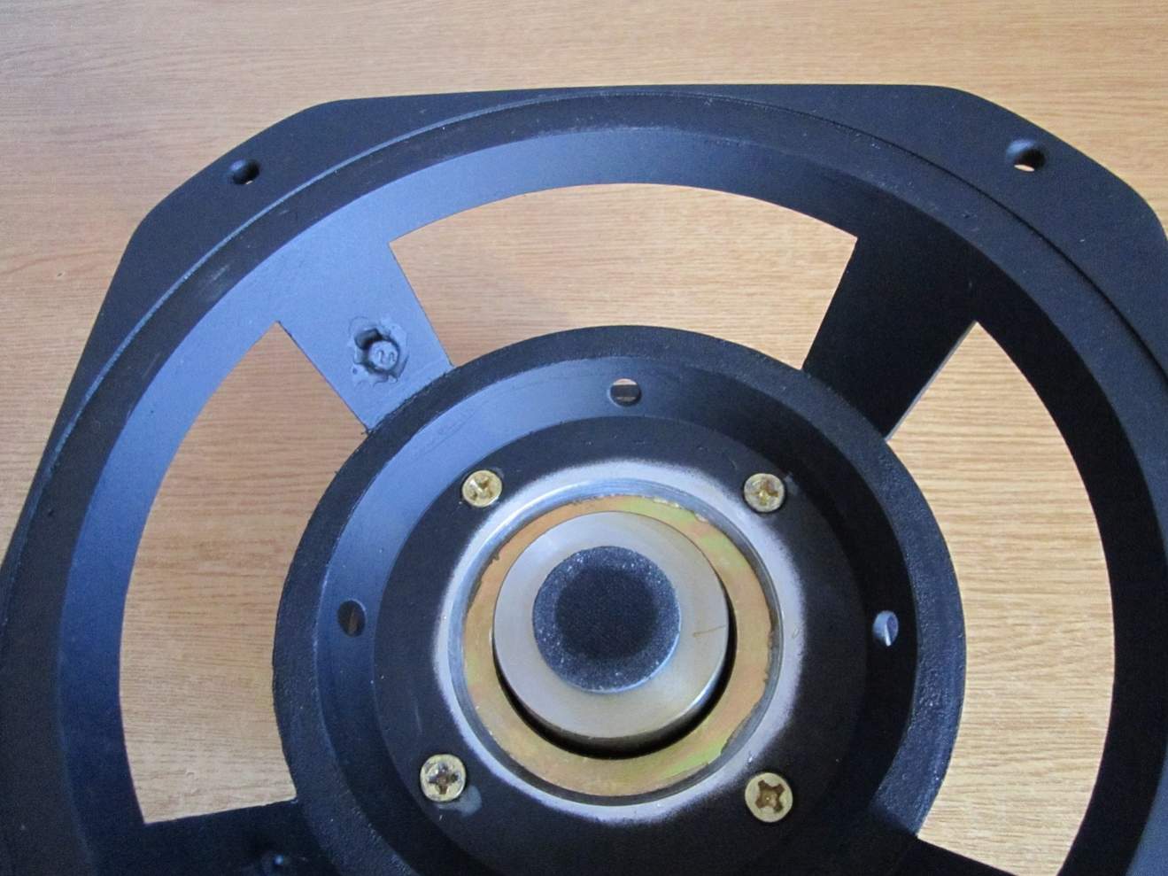

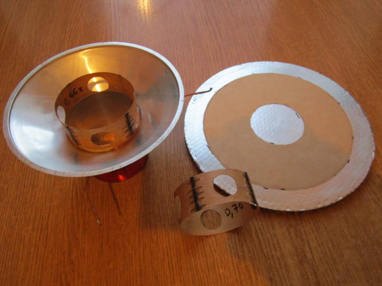

Svjatoslav:
That is a very cool construction! (And one I've had in my mind to attempt for a long time.) To my knowledge, this type of cone assembly is either built on a jig (fixture) or built up in the speaker basket & magnet assembly in order to align the parts. In either method, the voice coil is shimmed around the magnet centre pole for proper gap while the spider and surround are glued to the frame. The shims are then withdrawn, and the dust cap is glued on. Since you have no accessible opening to fit & remove the shims, how do you achieve the required clearance in that very precise gap for the voice coil? I wonder if you would kindly share your secret?
Thanks,
Wilf
Thanks,
Wilf
There is no secret. Centering on external backlash.
Set to the whole mobile system. In assembly.
In a magnetic gap is set 8 cuts of copper wire. Symmetrically. A little less backlash. Wires are vented outside the frame outward. And there are fixed so as not were shifted.
Lower suspension ("spider ") is pasted on them. After partial drying glue, wire must be pulled out smoothly.

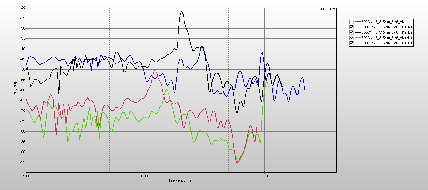

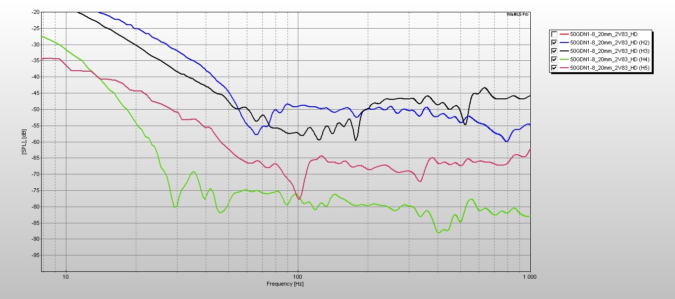

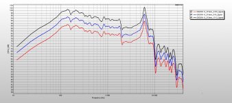

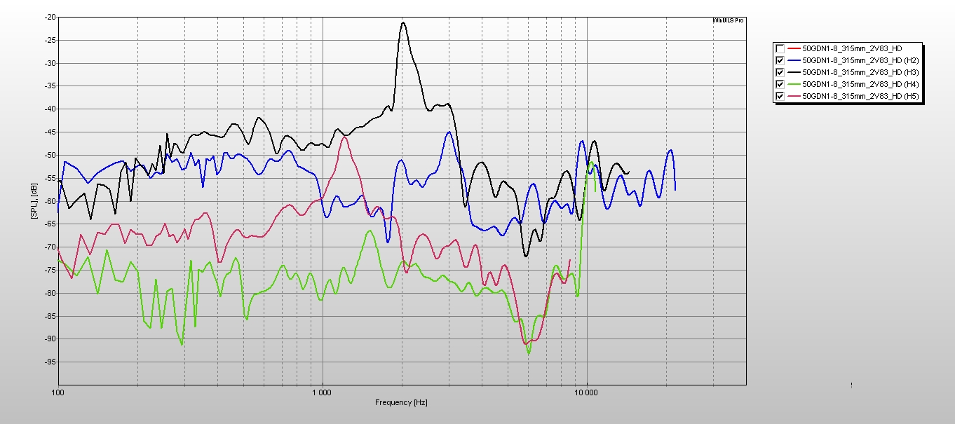

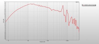

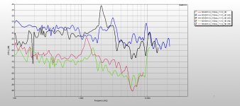

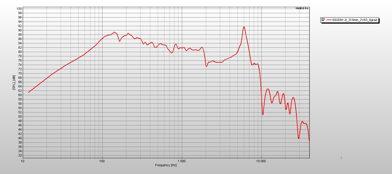

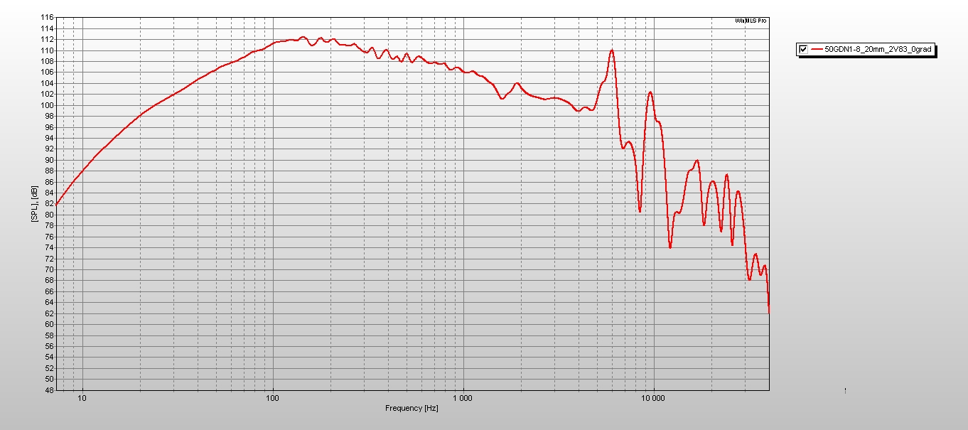

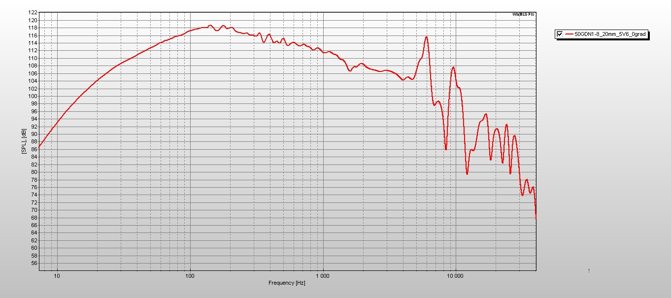

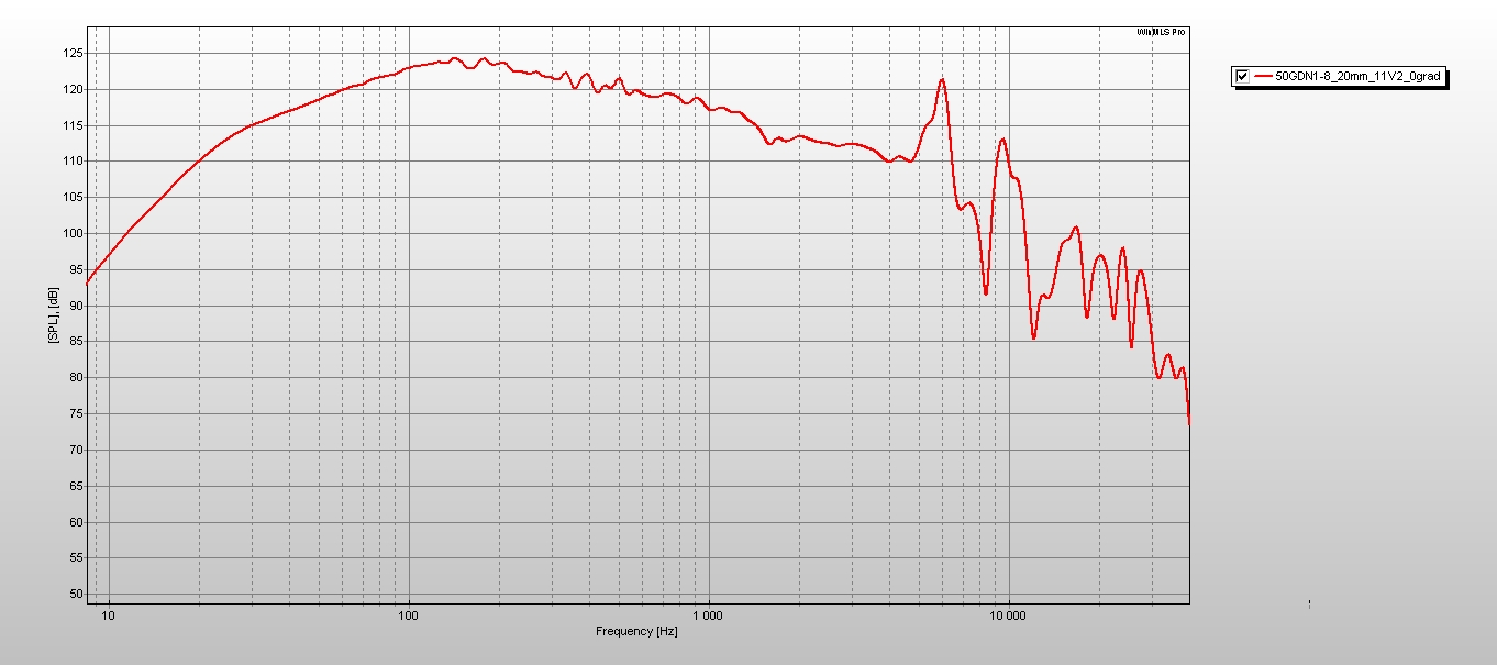

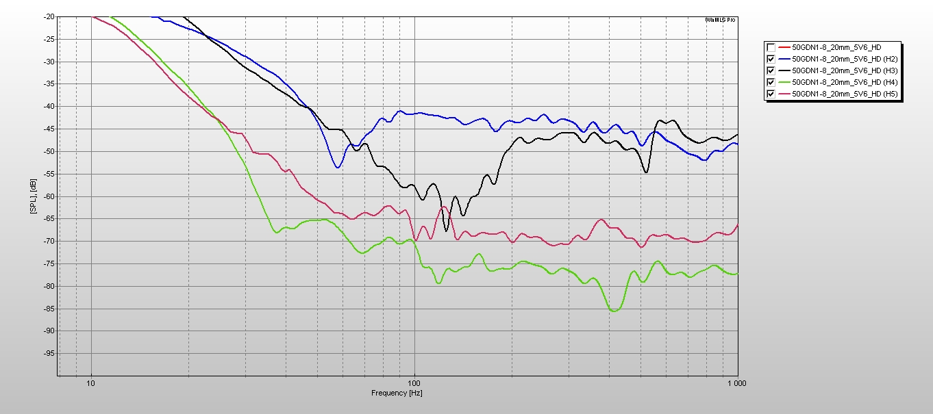

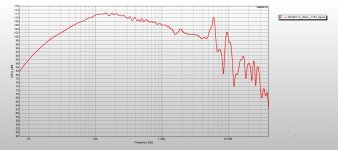

The measured characteristics of the speaker (post 1).
It seems that the mode of the piston up to 5 kHz. At 2 kHz resonance, allegedly, suspension.

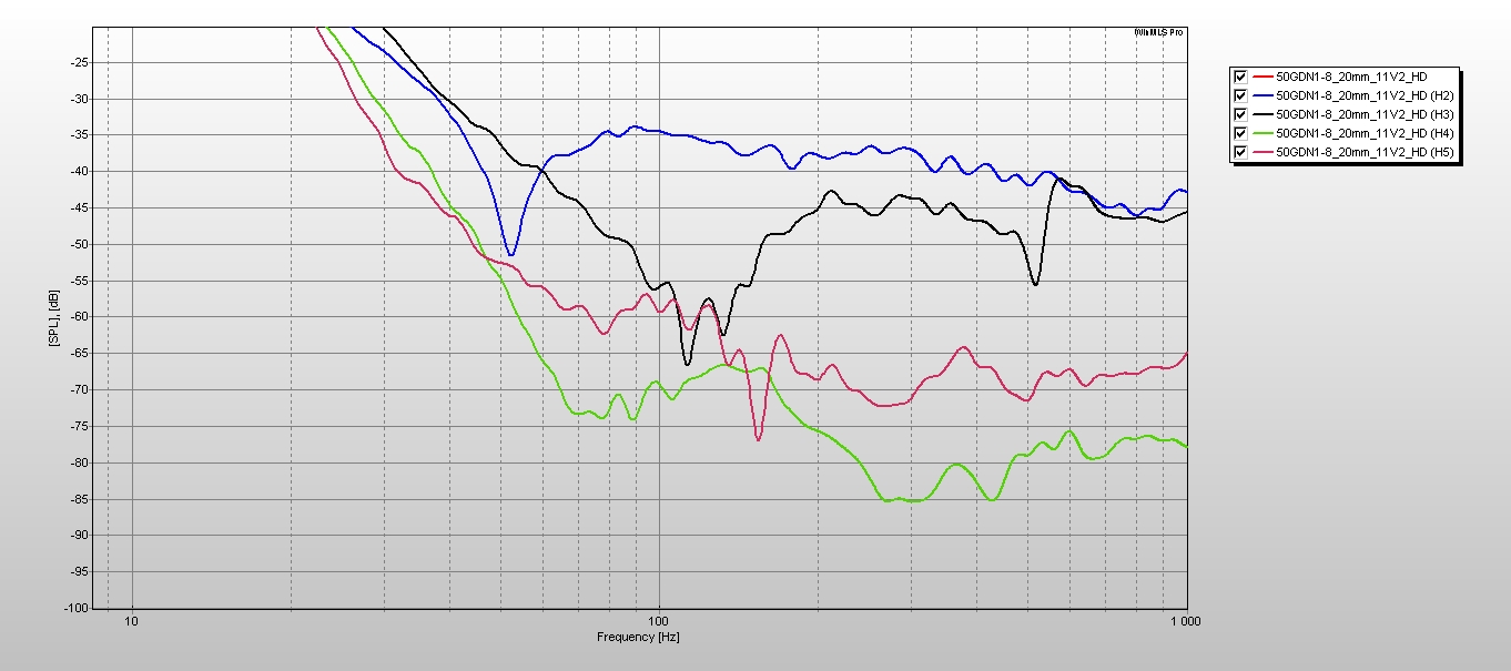

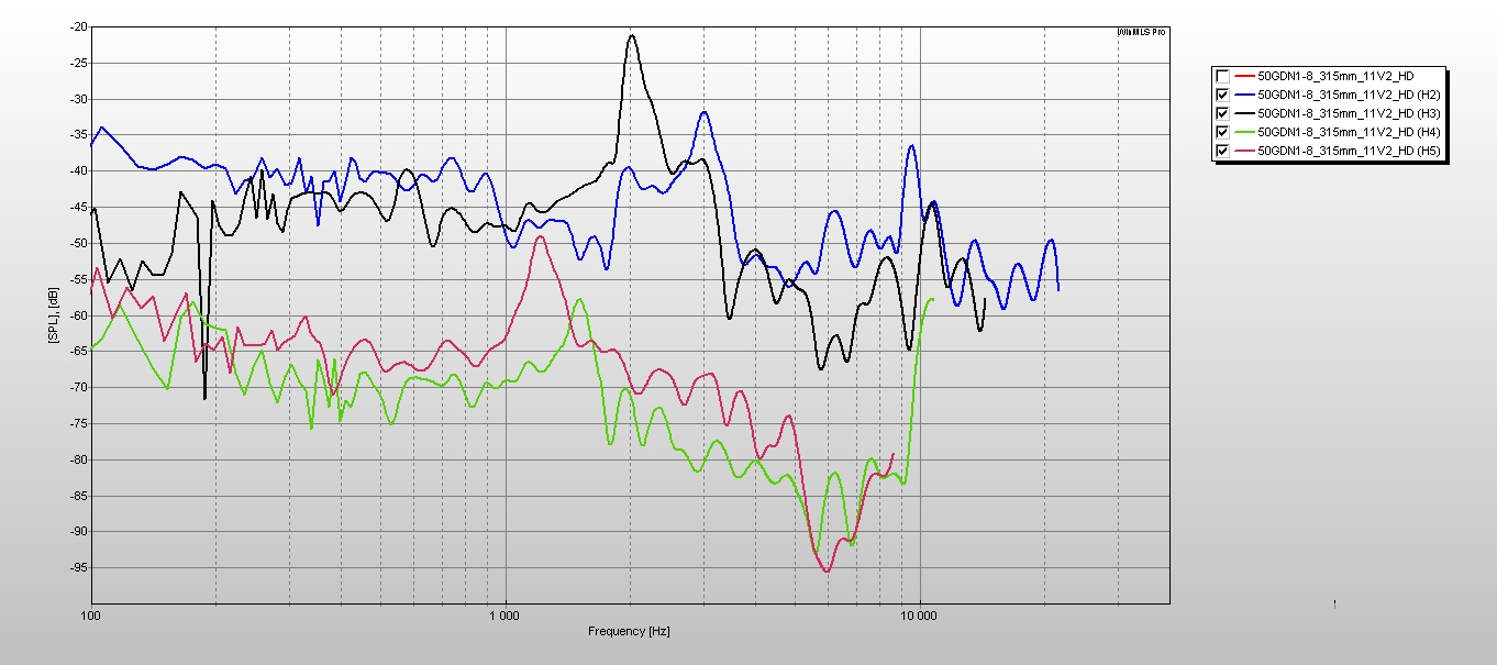

Measurements at different distances from the center of the disc. At different levels of applied voltage.
The equipment and methods of measurement are similar to those reported 47 this topic:

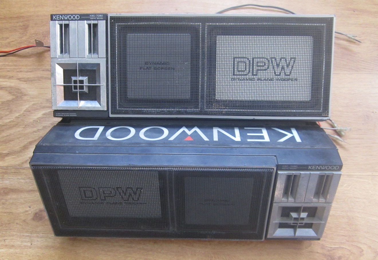

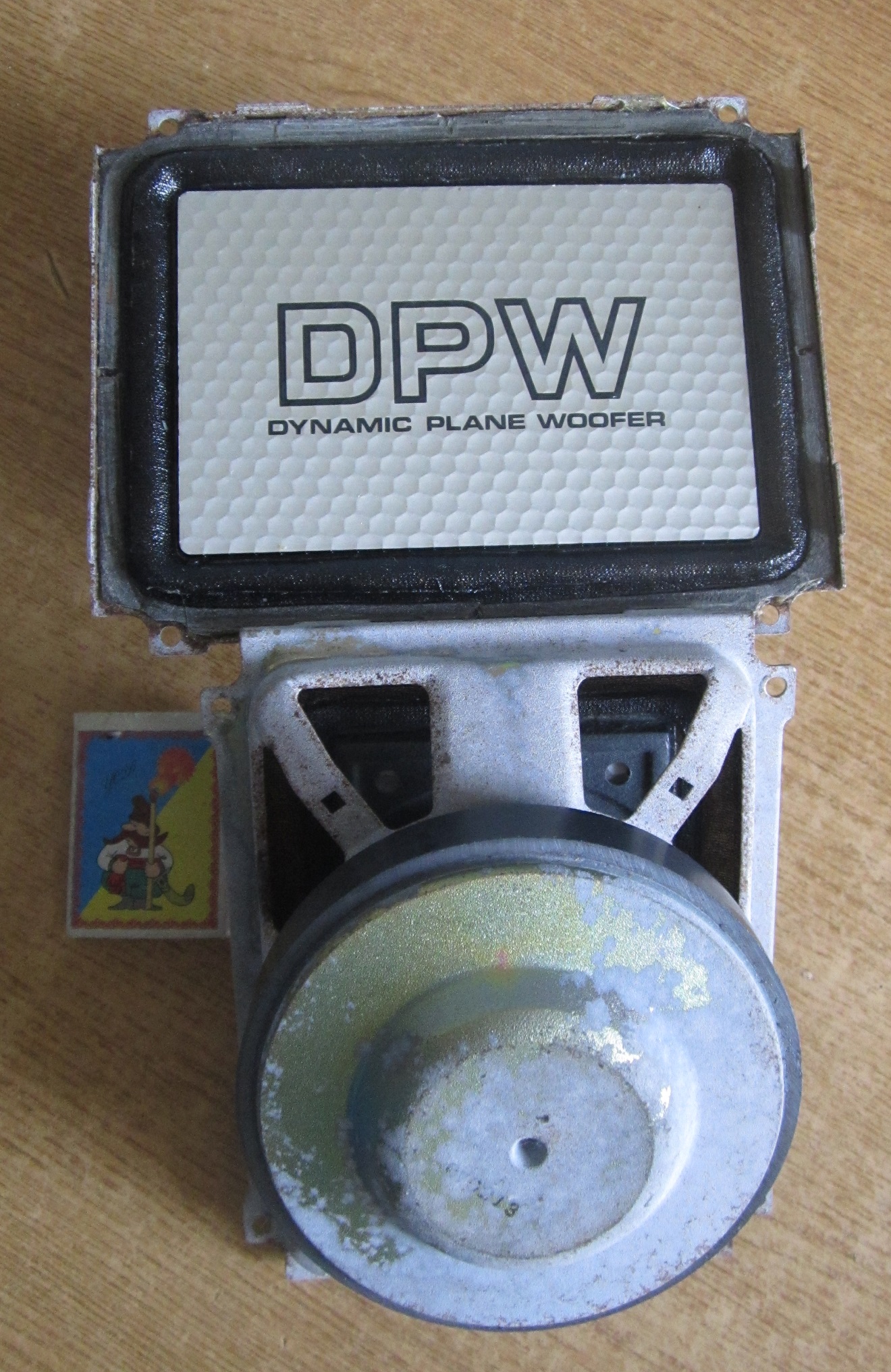

Into the theme collection. Recovered KENWOOD loudspeakers with rectangular cell membrane. Constructively made with two centering washers. One of which is ... inside a magnetic system!)))
