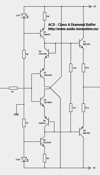

Below I have attach ACD (from Denmark )
version of his Diamond Buffer.
It is used within op-amp loop, to provide a Class A current output.
As can be seen, he uses the drop of one 2SC2240 and one 2SA970
to set the voltage across the output emitter Resistors.
And so bias into true Class A.
He also sells his PCB (without components) for a fair price.
I judge this as a very good circuit when we need a powerful line level buffer with hi-Fi quality.

Hi lineup,
Odd output devices he uses. Those are high voltage transistors and I would think that BD139 and BD140 would be better suited. There are some wonderful Japanese transistors that would work well there too.

What is the purpose of R10/11 resistors? If they are there for protection of output BJTs, I can't see how that would work? Also, is it a good idea to put diode connected Q3/4 for biasing output BJTs as this is another nonlinear element in circuit, so should we stick to simple resistors instead?
You want temperature tracking for a stable bias. The resistor can't achieve that.
Have fun, Hannes
Have fun, Hannes
aparatusonitus said:What is the purpose of R10/11 resistors? If they are there for protection of output BJTs, I can't see how that would work? Also, is it a good idea to put diode connected Q3/4 for biasing output BJTs as this is another nonlinear element in circuit, so should we stick to simple resistors instead?
The diode-transistor is current operated. Current operated diodes are linear (Iin = Iout).
Jan Didden
h_a said:You want temperature tracking for a stable bias. The resistor can't achieve that.
janneman said:The diode-transistor is current operated. Current operated diodes are linear (Iin = Iout).
Ah, I see, thanks...but what about R10/11?
About R10/R11.
I really not know. I haven't even simed to see if those change anything.
Personally I have not used such resistors for diamond.
I do not think Walt Jung used them.
Maybe he just put them in, because they are usually found in power follower stages.
Often with a capacitor in parallell.

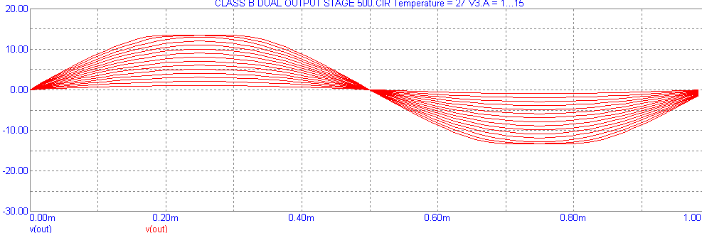

The warm sound comes from even harmonics and it sounds hardly good when the amp is driven into clipping. Since there are BJT's involved you'll have most likely odd harmonics.TimS said:I simulated the ACD design and it is pretty good, it has a nice soft clipping near the rails. It will probably have a nice warm sound.
I agree Peranders,
the sudden onset of hard clipping can be very bad for your speakers, but with moderately loud music there will be transients that will briefly clip an amplifier.
But I believe the clipping performance of an amplifier (especially power amplifiers) is a important criteria for it to sound good:
Very Good:
Soft Clipping
Good:
Hard Clipping - Until it clips then it sounds bad.
Bad:
Signal Inversion when clipping
Very Bad:
Unstable when clipping
I was comparing the clipping performance of the ACP circuit to a balanced valve circuit. (The attached waveforms)
Valve amplifiers tend to sound louder than what they really are because of the soft clipping but nobody complains about, what must be, the large amounts of distortion.
So I believe the ACP amplifier will sound good while clipping too.
