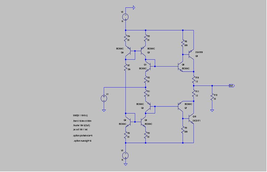

Improved Diamond Buffer Design
Hallo Mr. TimS,
Some questions for You...
- I don't understand if Your last version of the buffer is a pratical realization or is on the paper( or simulator) Yet
- Is possible to use up to +/- 22V supply voltage and if yes,this need some modifications?
-What transistors should be matched and what should be in thermal contact?
-I think this improved buffer should be perfect in combination with a high performance opamp like LME49870 in Yung multiloop(or traditonal)configuration to achive an impressive headphone amplifier for low impedance type.
If this idea can be intriguing for You and the community,if You like,can You simulate the circuit and share the results maybe in a new thread?
Thank You very much in advance and best compliments for Your
very interesting circuit.
Semola
Hi Semola
The circuit has just been simulated. I fully intend to build it but i have been waiting for parts, which will arrive next week.
The circuit will work fine at 22V, the bias current will increase slightly to fix this increase R3 from 4k to 6k.
Ideally Q4, Q19, Q3, Q20 should be matched. The current through Q1 and Q2 will increase with temperature It could be compensated for by putting Q4 in thermal contact with Q2 and Q3 with Q1, but this is not ideal since it will ruin the matching between the Q4 and Q19 etc. A better option would be to add thermistors across R4 and R5 which will turn the bias down if Q1 and Q2 get too hot.
This is originally what I designed this circuit for, a buffer that I can add to a high performance opamp so it can drive some headphones. But I found that this circuit has superb performance all by itself.
Some of its specs:
3dB Bandwidth = 70MHz
Gain = 0.997
Input Impedance = 6M
Output Impedance = 0.065R
If R4 and R5 are 300R the bias is set to a high 220mA
total dissipation = 6.4W but
Distortion = 0.001% for +- 13V @ 1kHz into 500R
Distortion = 0.001% for +- 13V @ 1kHz into 100R
Distortion = 0.006% for +- 13V @ 1kHz into 32R
Distortion = 0.004% for +- 13V @ 10kHz into 100R
Distortion = 0.007% for +- 13V @ 10kHz into 32R
Distortion = 0.1% for +- 12V @ 1kHz into 8R
But if R4 and R5 are 150R then the bias is a lower 48mA
total dissipation = 1.4W
Distortion = 0.01% for +- 13V @ 1kHz into 100R
Distortion = 0.045% for +- 13V @ 1kHz into 32R
Distortion = 0.004% for +- 13V @ 10kHz into 500R
Distortion = 0.01% for +- 13V @ 10kHz into 100R
Distortion = 0.045% for +- 13V @ 10kHz into 32R
I have done some simulation with the buffer inside a lesser opamp's feedback loop but with worse performance, but Microcap 6 is fairly old now and doesn't include the new high performance opamps.
I checked the datasheet for the LME49870 and this buffer would be a perfect match, the bandwidth is about the same and the opamp noise and distortion is very good.
Semola

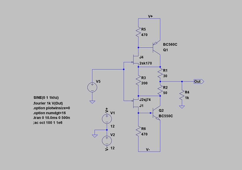

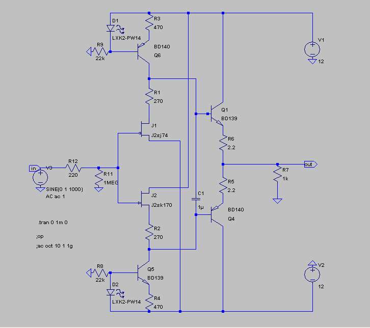

Hi Jam, it's nice looking (and even better working) circuit. Just one thing - check the J74's polarity, drain should be connected to -12V rail, although JFETs are known for their source/drain interchangeability.
I run this buffer with 5mA through JFETs (7.2 mA Idss, matched) and 7 mA through output BJTs (BC550c/BC560c) - that's enough for 1K load.
DC offset is easily adjusted with R1 or R2 and once adjusted it stays stable.
Also, I used simple CCS - two 1N4148 diodes instead of LED - it sounds great.
Best regards !
Hi juma,
Thanks for the correction....I hd pulled from the web. It is a great sounding buffer.
I have cascoded the current sources with some audiable improvement, just add another led (or two diodes) and transistor in series with the corrent source.

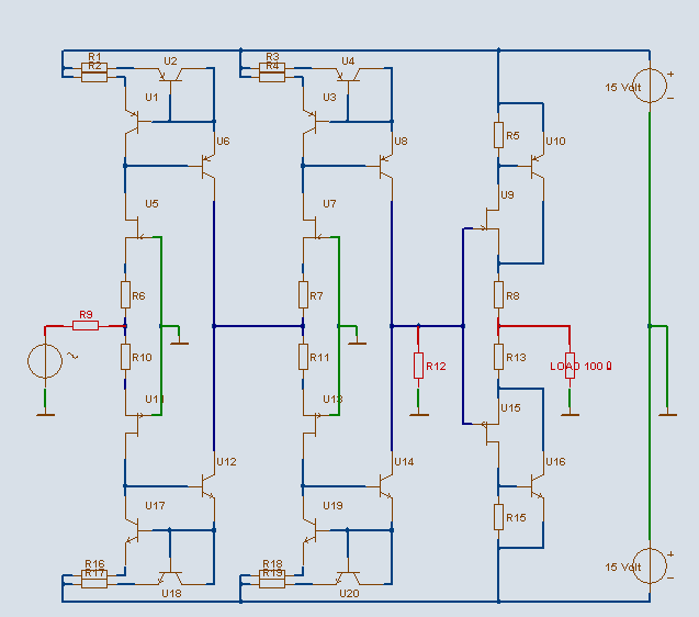

As you very well know, jam
symmetrical JFET buffers I have used many times 😉
The attached circuit is one of the basic configuration
in my
No Global Feedback symmetrical JFET module
It is based on 3 parts, blocks, where the last part
is the very high input impedance Complementary JFET/BJT 'sziklai' pair buffer.
To adjust DC-offset balance in Output Buffer, you trim R5 and/or R15.
My original test setup uses 2SK170BL, BD140 and 2SJ74BL, BD139.
No problems run at 50 mA Class A, for Heavy LOADING.
My basic testings, as can be seen, used 100 Ohm load ...........

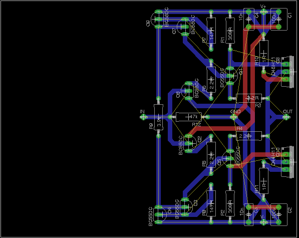

I have attached my first draft of my PCB, I hope you like it.

Tim,
The offset broblem is easily solved by making one of the current sources adjustable, which rules out current diodes.
You layout looks good, I have always liked symetrical layouts and a ground plane might help.
Jam
