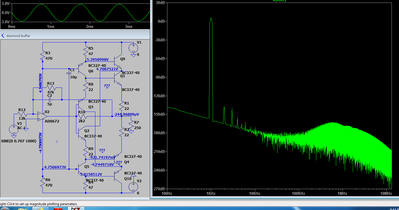

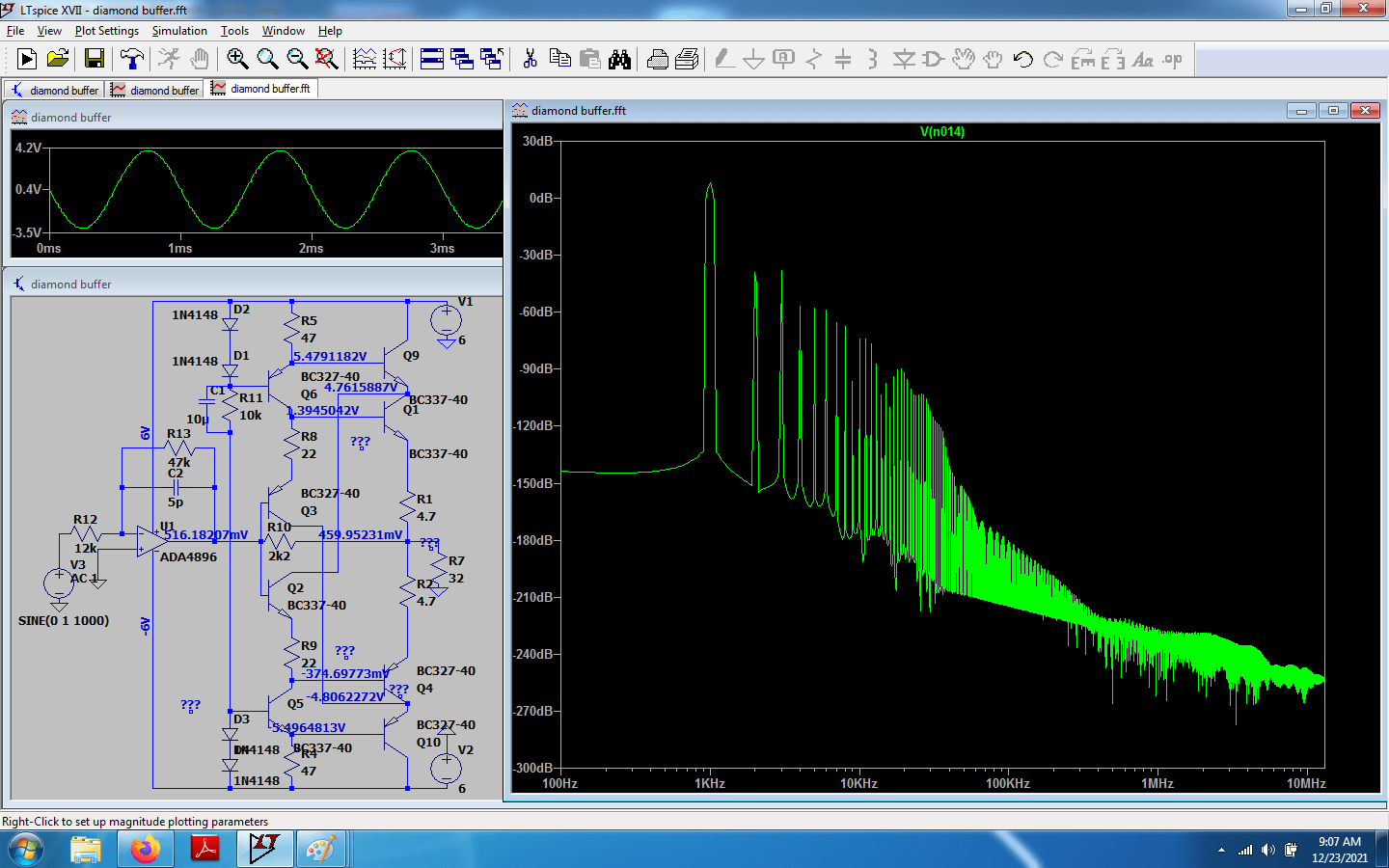

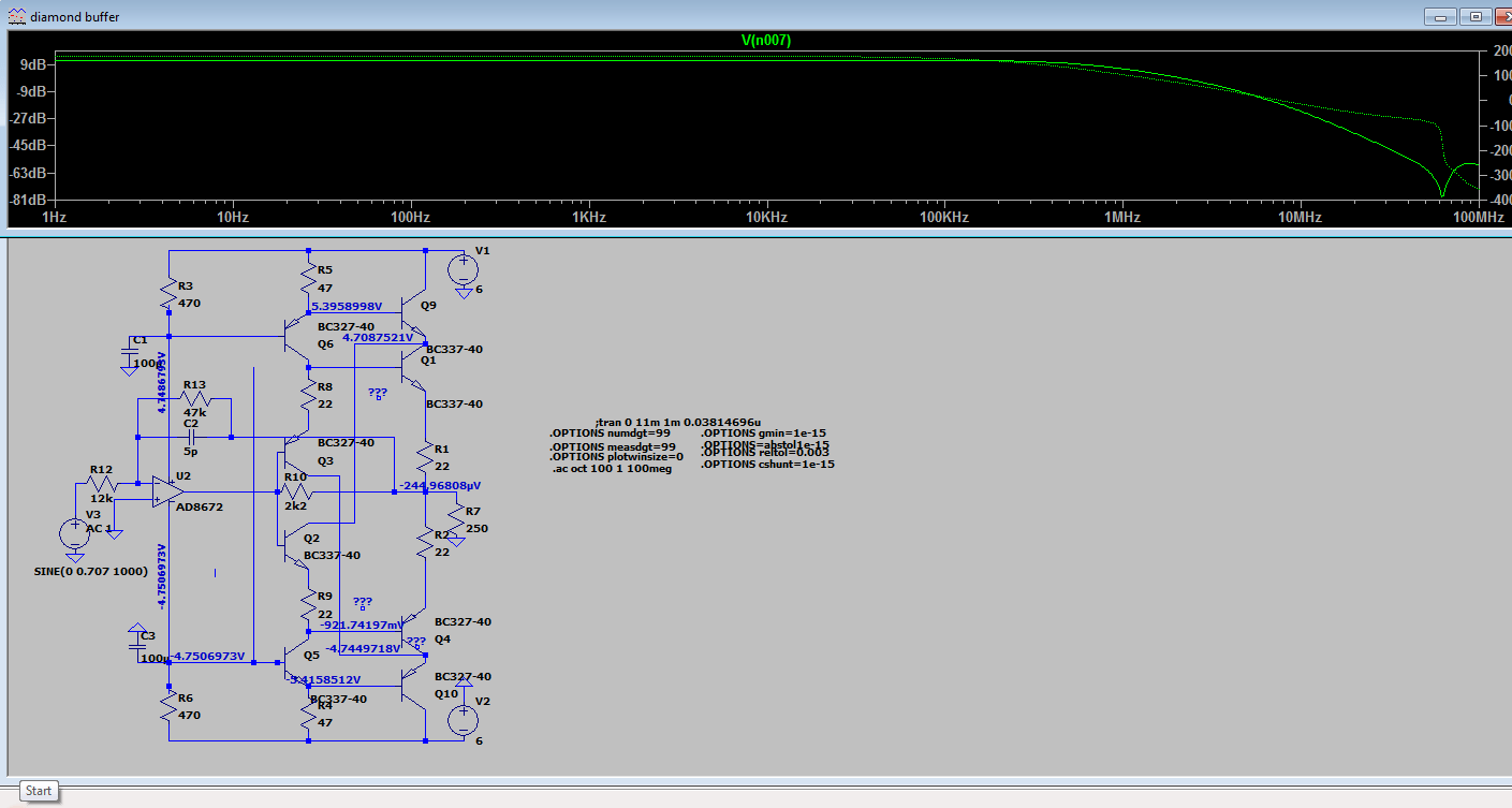

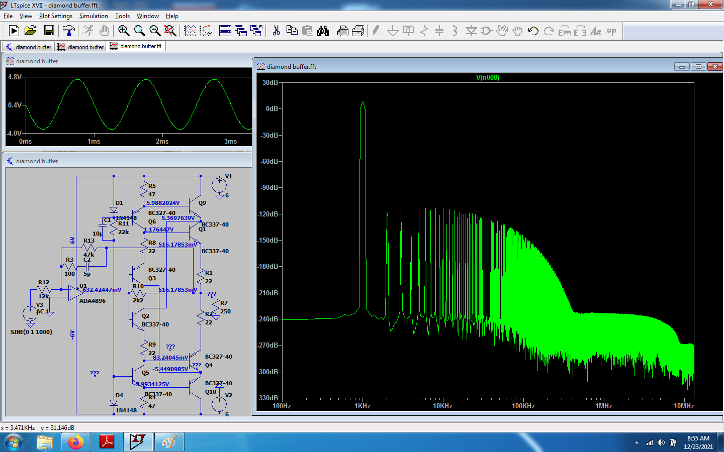

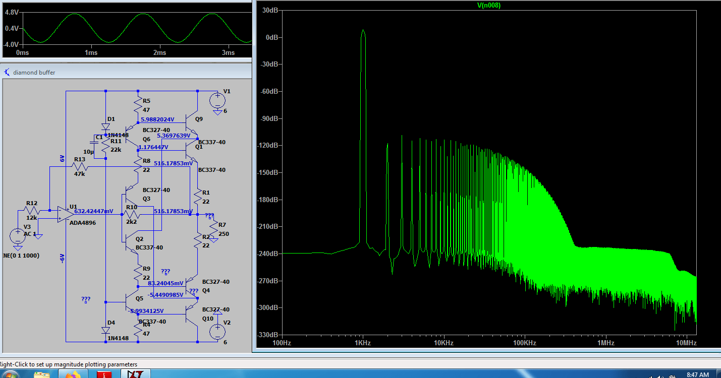

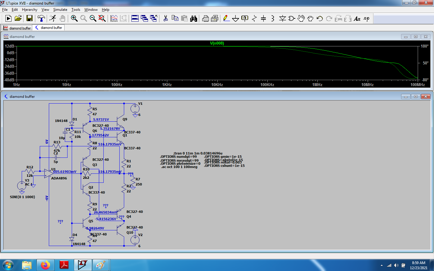

Improved Diamond Buffer Design
The simpler , the better, just closer to clipping :

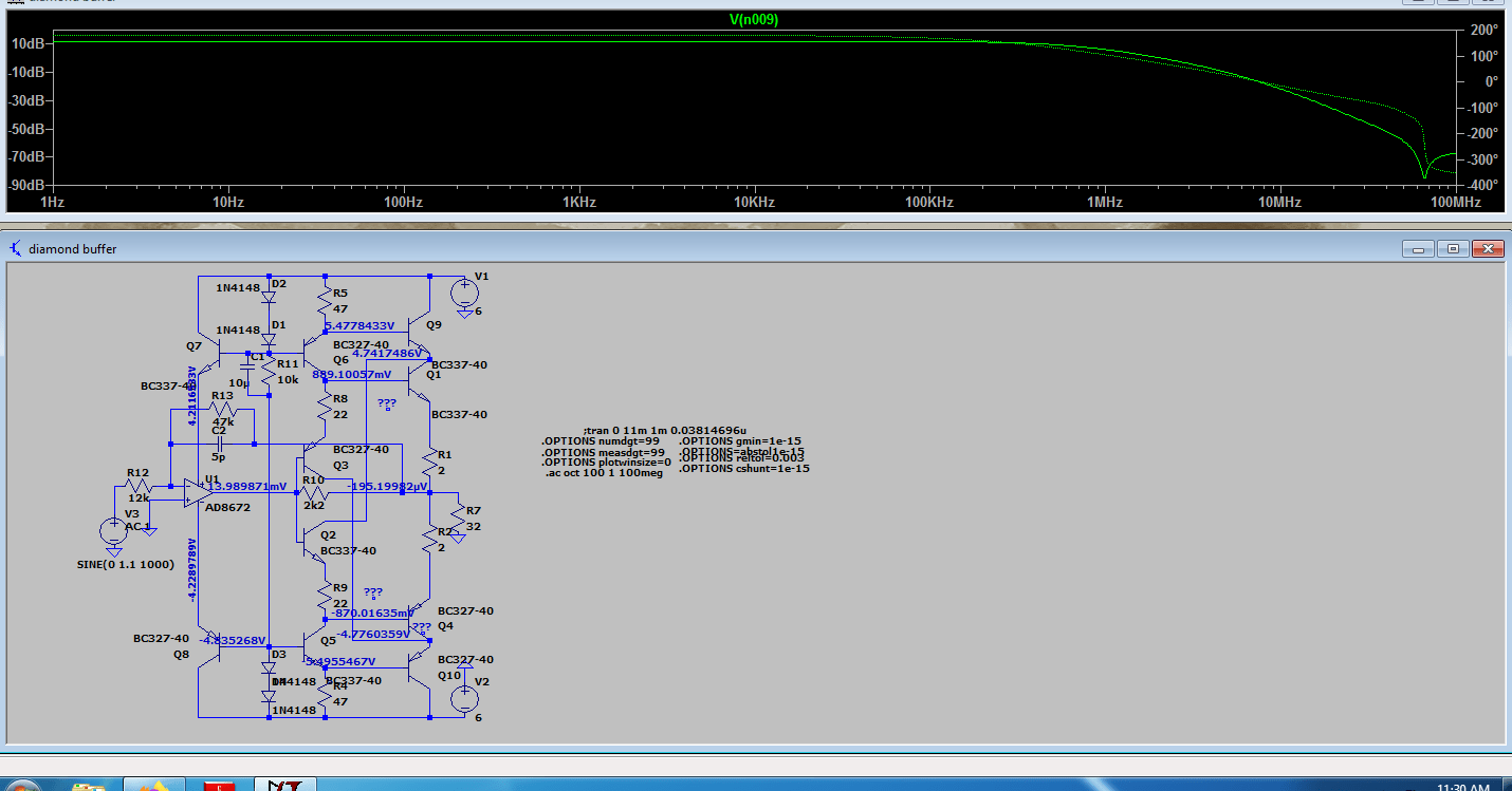

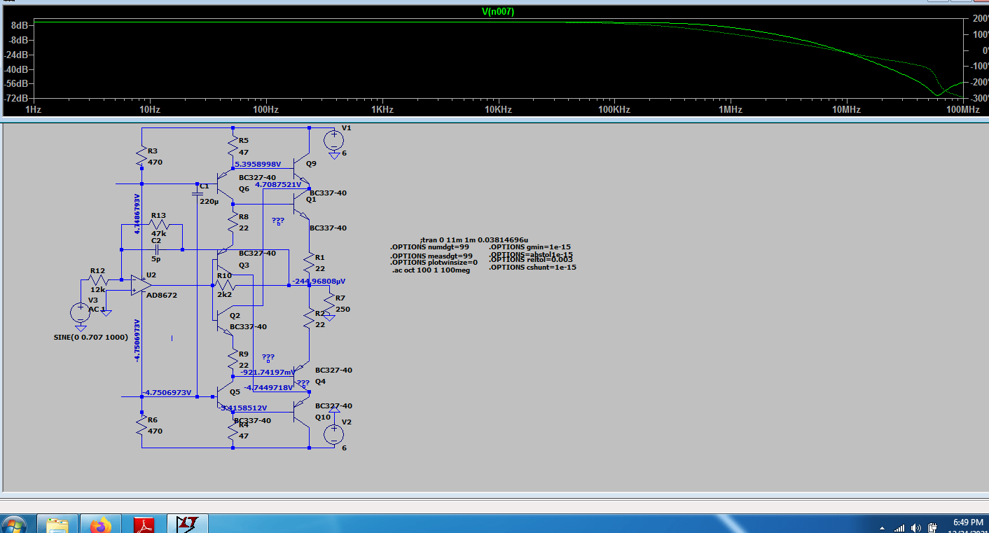

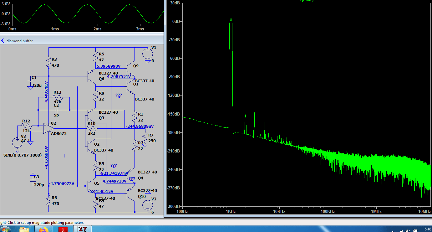

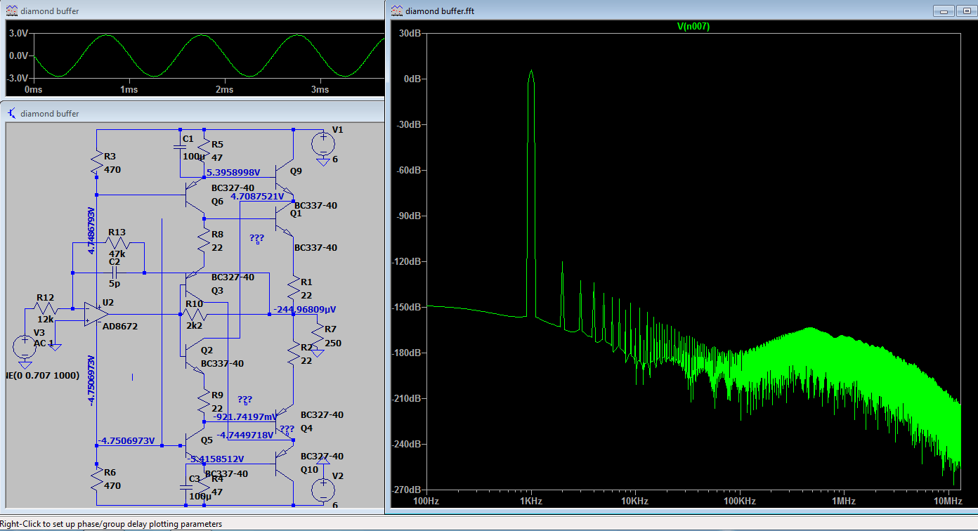

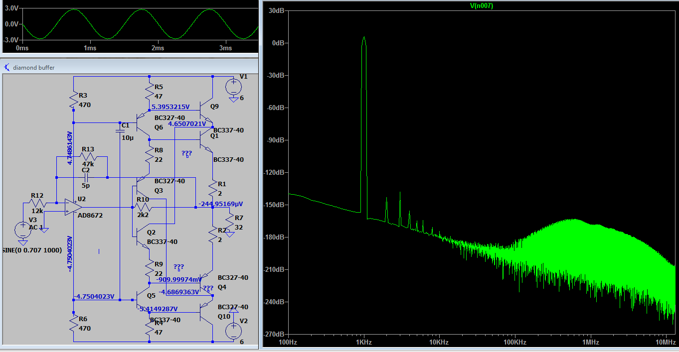

How about Ad8672? Its specifically for nested feedback duties
indeed...it looks a bit better being more simmetrical, probably due to lower input bias current, yet it's not RRO so you won't go too low with the supply rails.a bit slower so it needs a bit of compensation around 1 megHz not like the others which are ringing around 10 meg , but 5pF is more effective here as the opamp is better suited for audio.

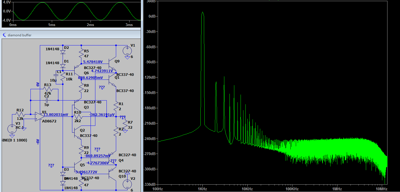

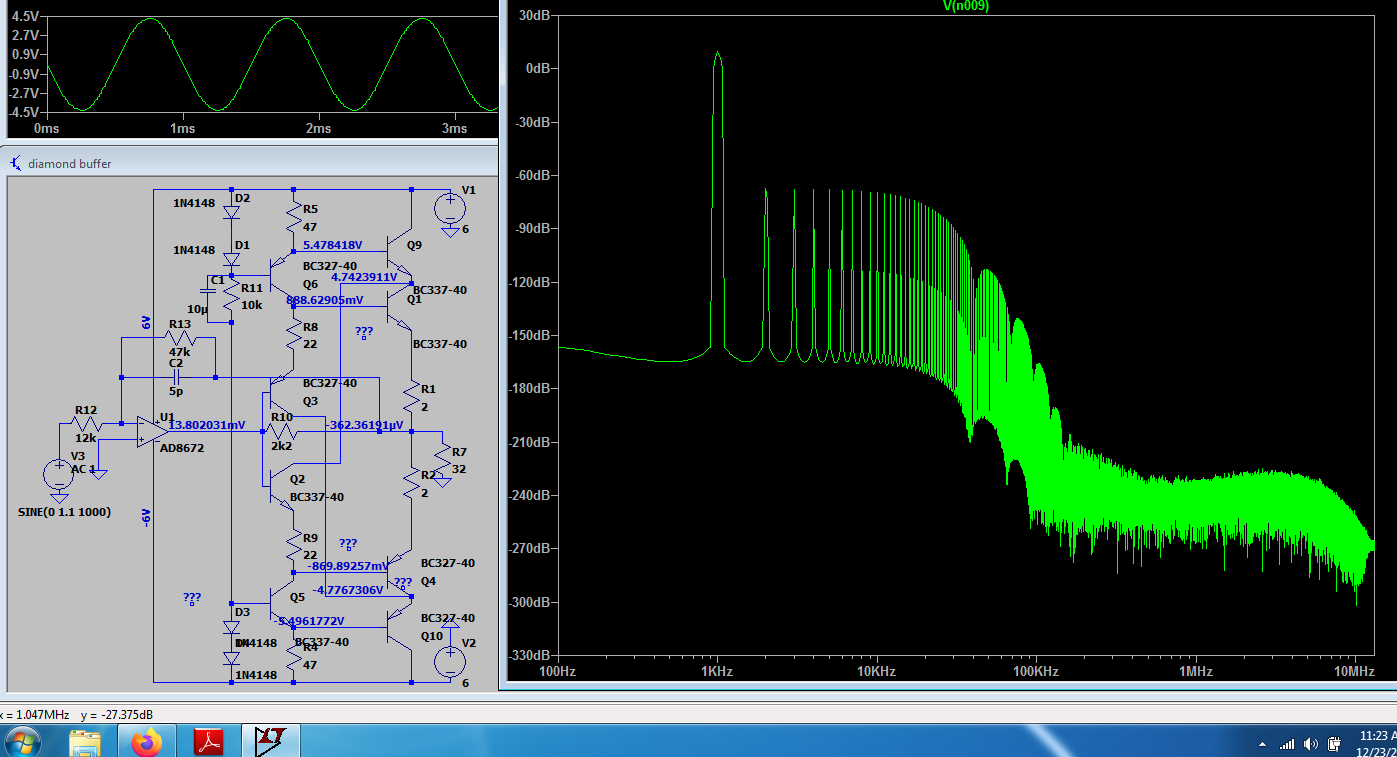

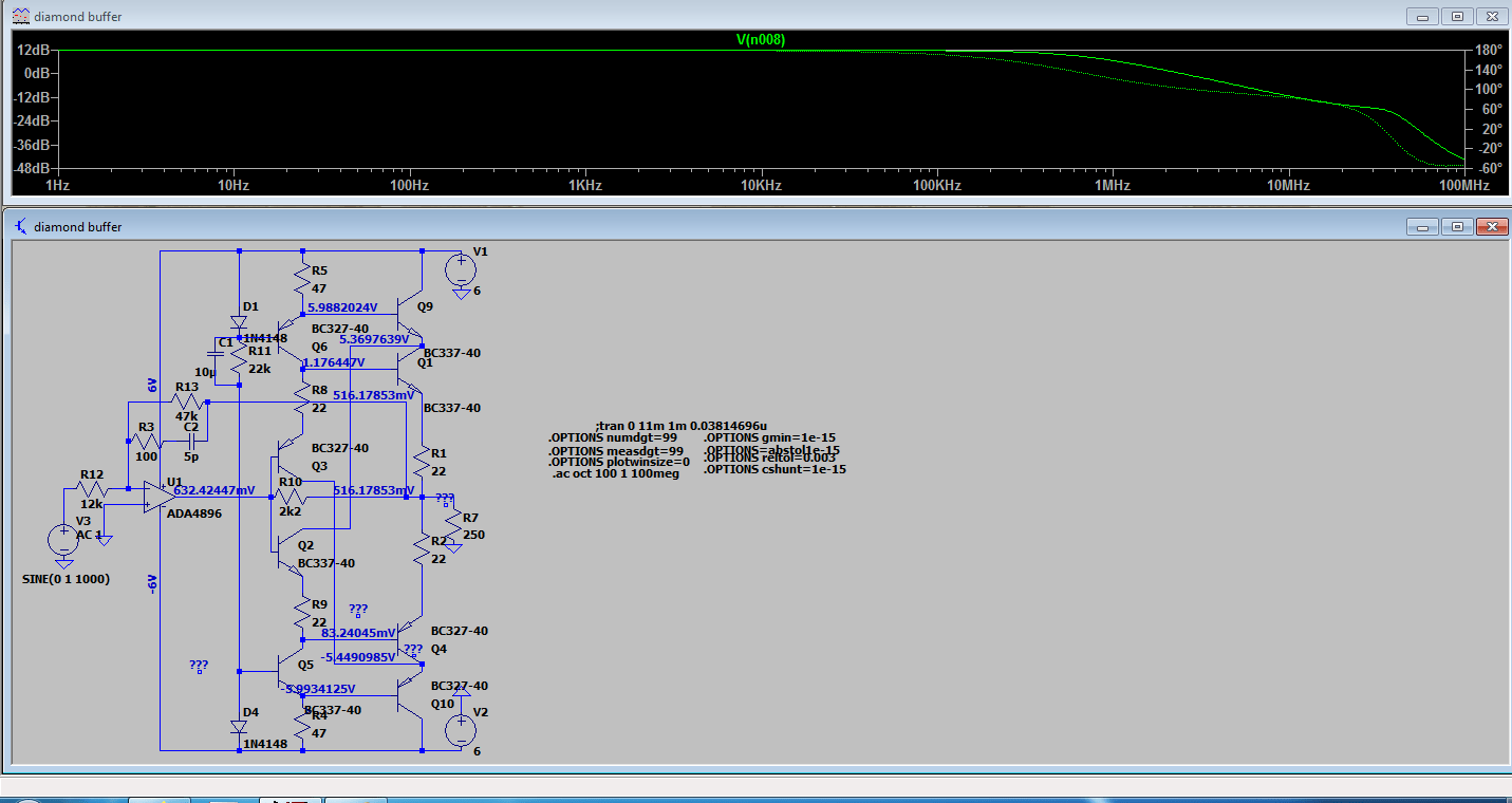

Simplified even more for useful signal using the op-amp idle current to set Q6, Q5 current and also the level of feed-forward signal with R3, R6 giving more current to the lower diamond buffer when needed.C1 could probably be 100...220 uf , but simulation takes way too much for higher values than 10uf...

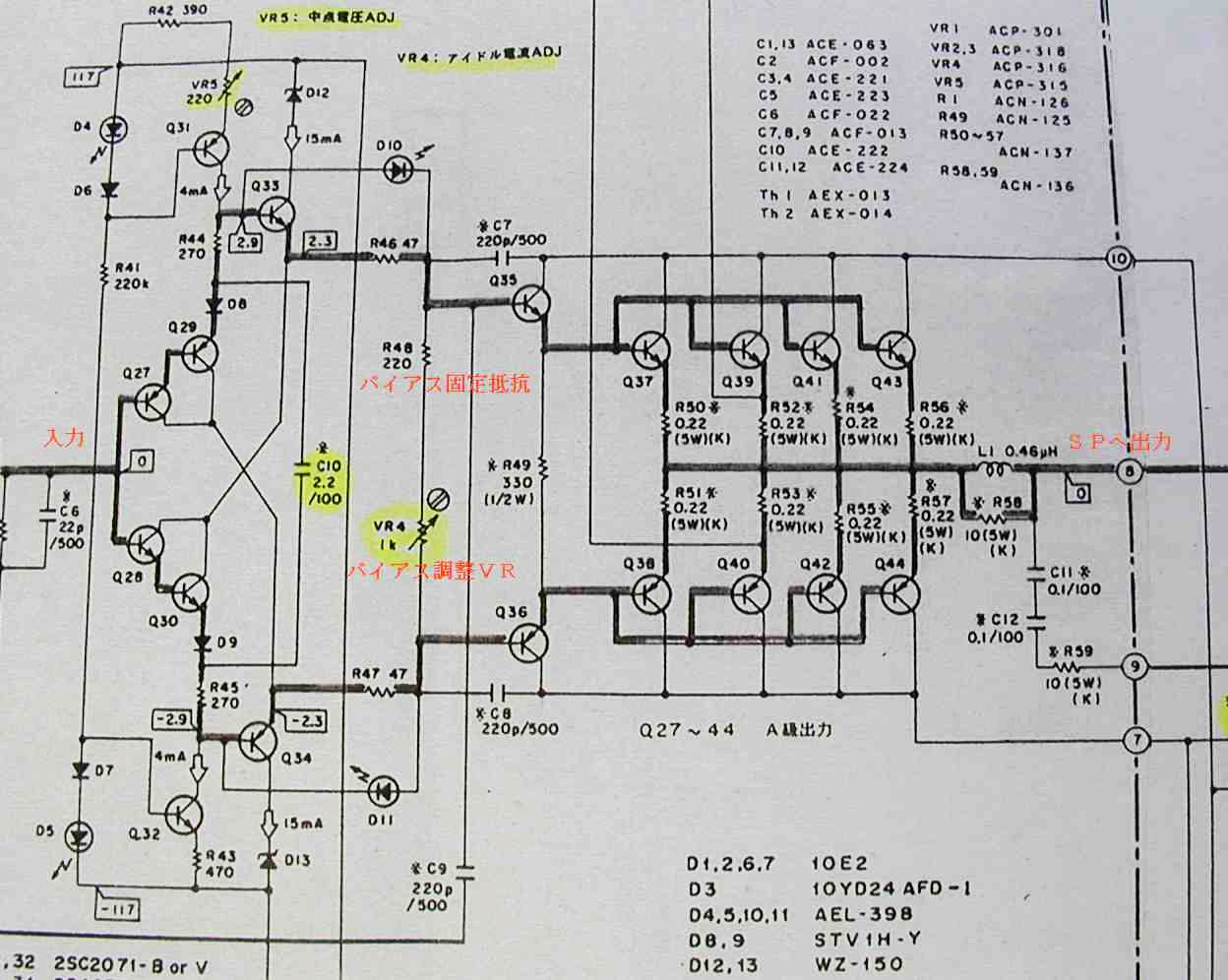

Looking back at timS' circuit i realized i have another, and probably the best option for thermal coupling which is to use to92s for the input and the output, arrange them so that the flat sides face eachother and voila, shrinkwrap coupling. Being a linestage buffer i wont need more than 1 pair of output so this is ideal.
Ofcourse being a notice i dont know whether q7 and 6 should be complimentary types to q9 and q4. If not i can use bcv61/62 for all the outer current mirrors (6 total) for best performance

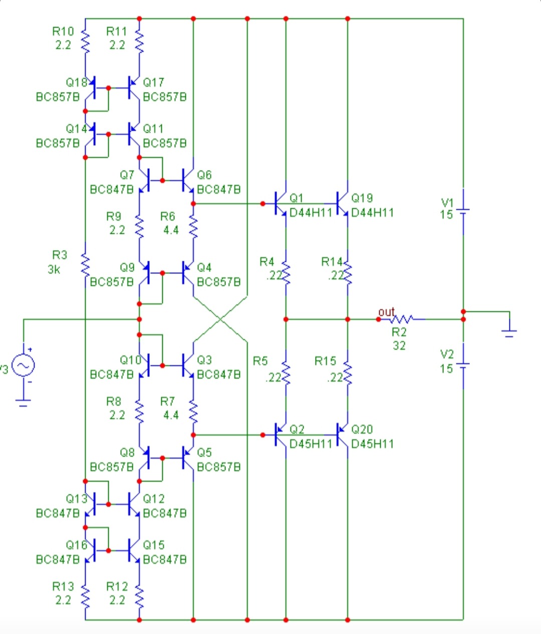

This buffer yields better distortion performance and wider bandwidth than the diamond buffer.If used with silicon transistors you need to tame it by shunting the base-collector junction of the final transistors with almost 1nF capacitance to cancel some 10 Mhz oscillations.The buffer itself is at about -100db thd so no global feedback is needed.As i used germanium transistors i didn't need any BC compensation. https://www.diyaudio.com/community/threads/germanium-foundation-chapter1.381869/#post-6910850
