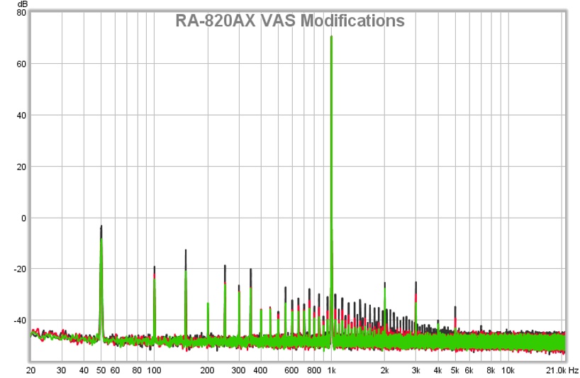

Stability tests: Completely stable with 8 Ohm // 2.2uF load. Bandwidth unchanged 3Hz - 65kHz. Tested the previous treble tone control issue - still no instability. Sweet!
And the already improved Rotel just got better, the spectrum plot below should be read as follows:
Black trace - improved (-20dB) circuit (THD 0.0028%),
Red trace - two pole Miller Cdom mod (THD 0.0017%),
Green trace - two pole Miller Cdom reversed (THD 0.0017%).
That is a further -4dB improvement and thus almost a total of -25dB better than the original 0.03% Rotel circuit. Note that while the reversed Cdom does not change the THD value, it reduces the 3rd and 5th harmonic - almost down into the noise floor.
Calls for a celebration with a glass of vintage snake oil....
There is also a slight improvement in slew rate, but more on this later.

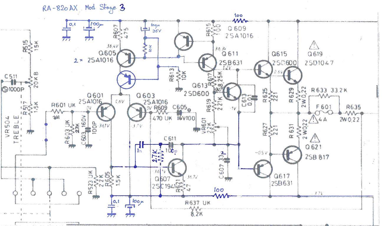

And so I did. First I put in the missing 10p Miller capacitor C611 - measured, but it had no effect whatsoever (as expected due to the dominant and rather brutal VAS transistor collector lag loading). -Chris
Then, after a deep breath and a brush-up on Pass, Self and Baxandall - out went all the heavy VAS collector loading components: R623 (33k2), C607 (330p) (both loads to ground) and C609 (150p), the Ccb on the output driver.
In their place, a new light 33p C609, and a two-pole Miller setup in place of C611 as shown below. Tried it both with the Miller capacitors reversed and not.

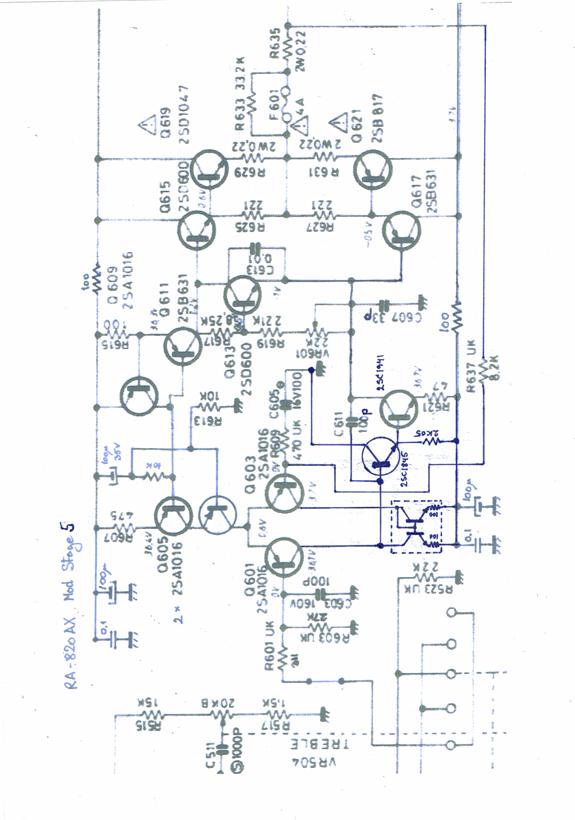

Rotel Mod Stage 5: -28dB THD reduction achieved! Can we go to -30dB??
I finally got back to the RA-820AX and undid the most recent VAS modifications. The MHz oscillation disappeared duly, never to be seen again. Bowing my head in shame, I can't rule out that it most probably may have been yours truly that had produced a late night dry solder joint somewhere on the PCB or in the airwires. Anyway, by then I had received some rare “old stock” of TL011C, TO-92 Current Mirrors (CM). This product has been discontinued by Texas for quite some time, but as it is not easy to find through-hole CM components these days, I decided to give them a go and to replace the input collector resistor R605 with the TL011C and …... it didn't work. Amp output hovering about 11Vdc, so clearly the CM didn't work properly.
I then resorted to read the the instructions (the datasheet) and realised that TL011C is a Wilson CM with an extra transistor in the mirror path, so it needs at least 1.2V across it to turn on, and the original R605 only has about 0.9V from the VAS and its emitter resistor. So I needed another diode voltage drop in the VAS stage and replaced the 2SC1941 with a ZX603 Darlington – that didn't work either. Too much current gain?
Ok, back to the trusted old 2SC1941 which I fitted with a glued-on 2SC1845 emitter follower connected as shown in the schematic. Surely, you would think that trusted solution would finally work?.....No way, Jose. I tried one of the other TL011C samples – same result. Perhaps there is a reason why these components were discontinued? I can't explain it.
So, I decided to make my own CM modules. Done on a piece of SMD stripboard holding a NXP BCM61B and two 100E 0.1% emitter resistors, it fits nicely in the place of the R605. And, finally: YES!
I say “if ever” because I realise that I by now may have gone OTT on this project and may be boring the life out of other people with my marginal modification madness. For that I do sincerely apologize.
However, I always try to reach the goals I set myself – and I definitely don't like losing bets. But I do hear the choir asking “how does it sound?” so perhaps this is the point for the amp to finally leave the workbench and be embedded into the audio rack?
Per

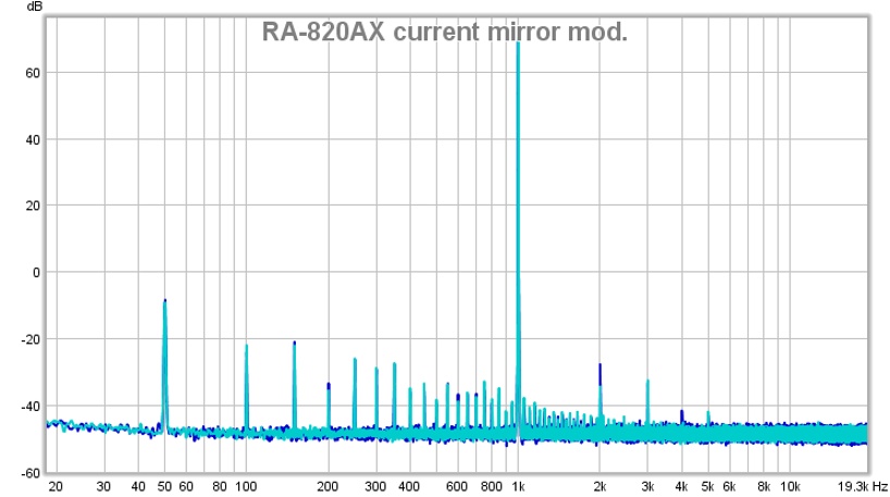

1) Amp stable, offset down to 1mV
2) Slew rate over 15 V/uS with no overshoot or ringing on a 20 kHz square wave
3) Bandwith: 3Hz to 153kHz (+0/-3dB)
4) THD now at 0.0012% - that is a massive -28dB improvement over the original spec. - or in other words the THD now down to less than 4% of the original.
The Stage 5 CM mod (light blue trace) seems to reduce the even harmonics, whereas the abandoned Mod Stage 4 (dark blue trace) T-shaped local Miller VAS feedback did its magic mainly on the odd harmonics. So, if there is ever to be a Mod Stage 6 it should probably be to combine the two.
