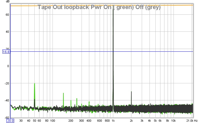

Ok, finally got back to the Rotel RA-820AX project.
I now seem to have tamed the RTA front-end asus U7 by building it into an old prototype amp box together with the 8ohm dummy load power resistors, reducing the cable clutter. (So much for a pretty “external” USB audio device!)
Anyway, I can now analyze the elusive 50Hz noise on the RTA spectra, because:
Loopback signal inside the new dummy load box - clean.
Loopback signal with cables outside that box - clean.
Loopback signal through Rotel 820AX tape out – hey presto loads of 50Hz and odd harmonics plus a second harmonic 2kHz - even with the amp power OFF (see Fig 1)! The tape-out tracks have two 1K series protection resistors which apparently act as antenna/resonator circuits of its own? Also I suspect that the U7 uses very high input impedance mosfet circuitry?
Sensitivity is a good thing until something bites you in the back.

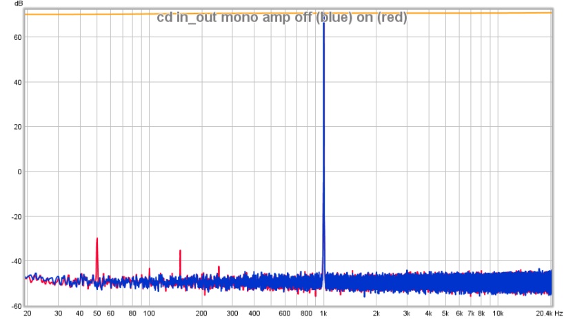

So, I devised a different way of routing a signal through the “pre- pre-amp” tracks of the amp:
Sending the test signal through the Left CD input, switching the tone control to mono – and picking up through the Right CD in(now out)put. That way it would go through all tracks, jumpers and switches and only be loaded by the volume and balance pots and preamp input components. Now:
Loopback signal with amp power OFF – clean (blue in fig 2)
Loopback signal with amp power ON – some (-100dB) 50Hz (red in fig 2)
This 50Hz signal would of course be duly amplified by the active amp circuits and could possibly explain the previous RTA results? In which case this root cause should be eliminated - or reduced.
I guess that a proper double sided PCB with a good ground plane would solve much of this problem? But, as this is not feasible, any suggestions for any obvious points of attack from you guys?

Hi AngelP,
Nice work. Now you have found out first hand how much trouble it can be to make a "simple" measurement.
I would test the way you would normally test. L channel in, L channel out. Same for the right channel. That way you can perform crosstalk tests as well.
Did you connect the case to the computer sound card common, or the DUT case? Try both and go with the lower noise option.

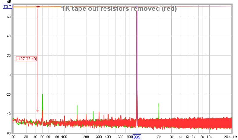

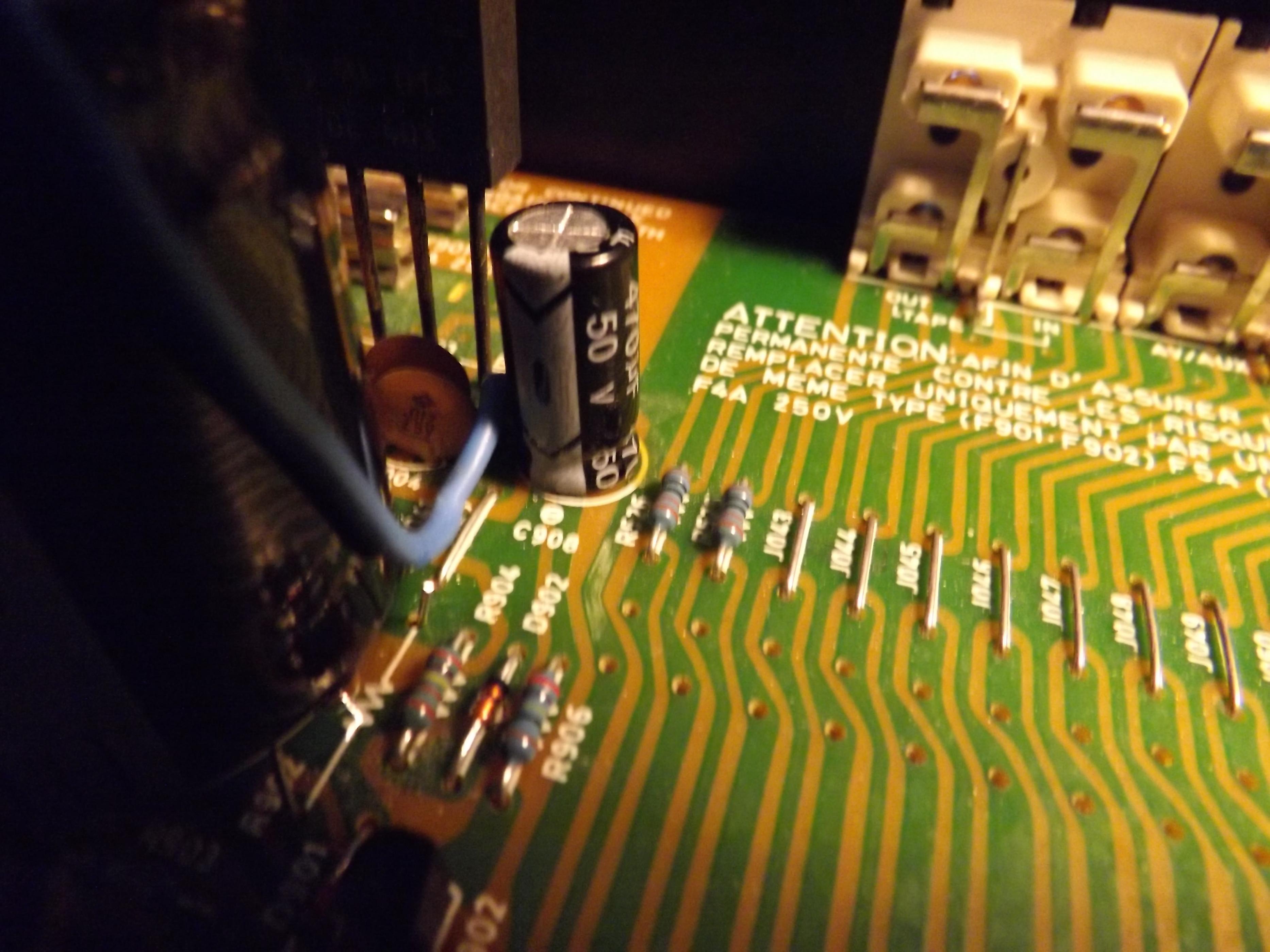

Hi Chris,
Yes, nothing is simple when you are diving below -100dB on a shoestring budget scuba equipment.
The sound card common is connected to the amp DUT's common. Grounding the box which it sits in did not change anything. Apparently it performs as a simple Faraday's cage, helping the insufficient shielding of the ASUS Xonar U7 box.
As per your suggestion, I reverted to the L_in – L_tape out and tried all sorts of grounding and shielding of the input circuitry to reduce the 50Hz noise – no luck. I finally found that the culprits were indeed the 1K tape out series resistors. Firstly, they were physically placed only a few mm away from one of the IC power supply input ripple capacitors (Fig 1) – although relocating them to a more “quiet” part of the PCB did actually not improve things that much.
However, simply shorting them did (Fig 2), also note that the strange green 2kHz peak is gone. Apparently, the 1K's were picking up the eddy currents from the transformer to the 820AX's casing as the 50Hz peak actually dropped when I removed the top cover. Now, due to the design of the 820AX there are no easy ways to break or isolate these eddy loops – nor can you easily rotate or move the mains transformer.
So, unless someone comes up with a great new idea, I guess that we are stuck with what we got.
And anyway, an old amp with all input circuitry noise peaks now below -108dB is not to be sneezed at?
How or whether this improvement will affect the amp's total output THD is – next.

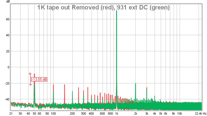

Well, shorting the tape-out resistors did not change much in the overall THD. Which is perhaps not unexpected because if these 1k resistors could pick up intra-casing noise so could most other input circuitry components. So, it seems to be merely tinkering at the edges without any real bang for the buck.
Anyway, thank you Chris for your good suggestions, but they are not easily done due to space and cabling issues.
So instead of ripping out the 820's transformer to double case or rotate it, I first employed an open RA-931 I had on the bench from which I could connect (steal) external +/-27V AC power into the RA-820AX.
Another good try, but that also gave no real change in the noise spectrum.
Then, I connected the +/- 37V DC from the 931 and bingo! (see attached fig.) Low frequency noise significantly down and in particular the 50Hz and odd harmonics. As the ripple on the 931 DC was as bad as anything, the main noise culprit must therefore be the RA-820AX's proudly towering bridge rectifier and/or its smoothing caps?
I feel a Graetz bridge and cap mod coming up
Stay tuned.

Hi AngelP,
I didn't say they would be easy changes, but simply a suggestion that you may or may not be interested in following. I think your experiments with another DC source were very effective. Good thinking on your part! I would be interested to see what you come up with.
Do you have the foil diagram for this unit in the power supply area? I'm wondering if it isn't the current spikes between the capacitors, transformer and rectifiers. The traces might be the problem if current spikes are permitted to share a trace with normal common connections. This would have been solved when you used the external power supply as well. I wish you good hunting and great success!
