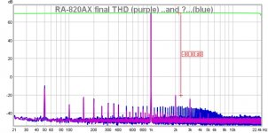

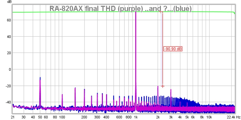

The final THD spectrum for the 820AX is the purple trace on the attached pic.
Using the exact same circuit and same RTA settings, occasionally I got the more noisy blue track response.
- What do you think could have caused this?
No first prize – and second prize is double that.

Hi AngelP,
Excellent work to a reasonable level. You kept the improvements within a decent budget and got the biggest bang for the money as well.
Your extra harmonics and noise could easily be a different ground point for a probe. You are -90 dB for the extra hash, so it isn't going to be a massive problem. I am interested in what you found as the cause.
-Chris

Ok, I guess that I might as well just reveal the noise culprit:
The blue noise signal on the enclosed RTA trace is what you get if you turn on an energy saving (CFL) lamp placed at a 45deg angle and a 1m distance from the amp circuits (amp top cover off).
This made me think a): Will the increased amount of "green" energy saving lamps and their increased total broad spectrum electrical noise which we are now surrounding ourselves with actually turn us - green?
Or b): does this merely show the impressive sensitivity of a modern RTA measurement setup?
Anyway, I can follow the comments sgrossklass put forward that a low THD is not the holy grail of good amp performance, but as Chris pointed out - the opposite is probably true. If you have a serious THD issue, you can be certain that there is a problem somewhere and other amp quality parameters are probably shot too.

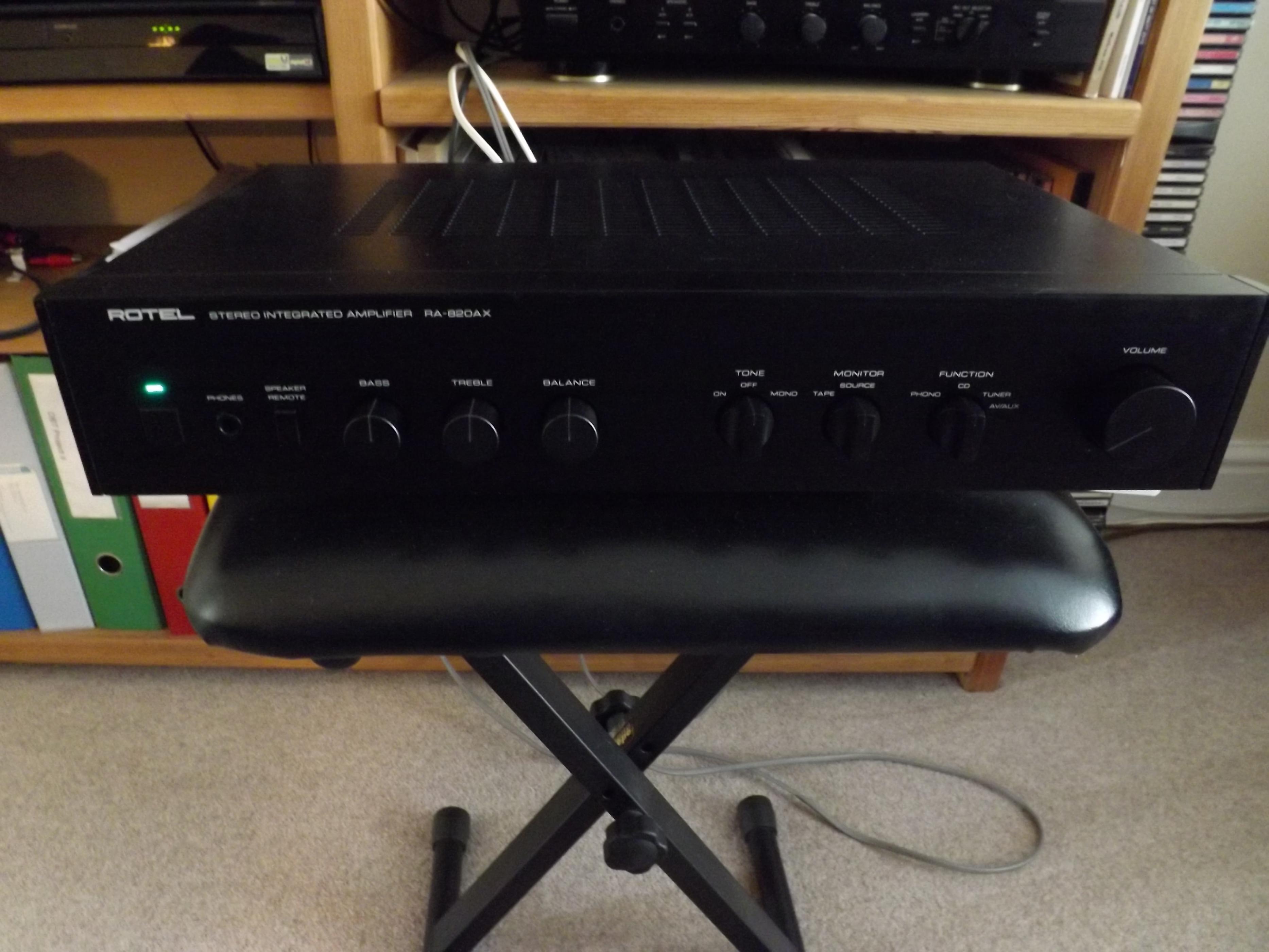

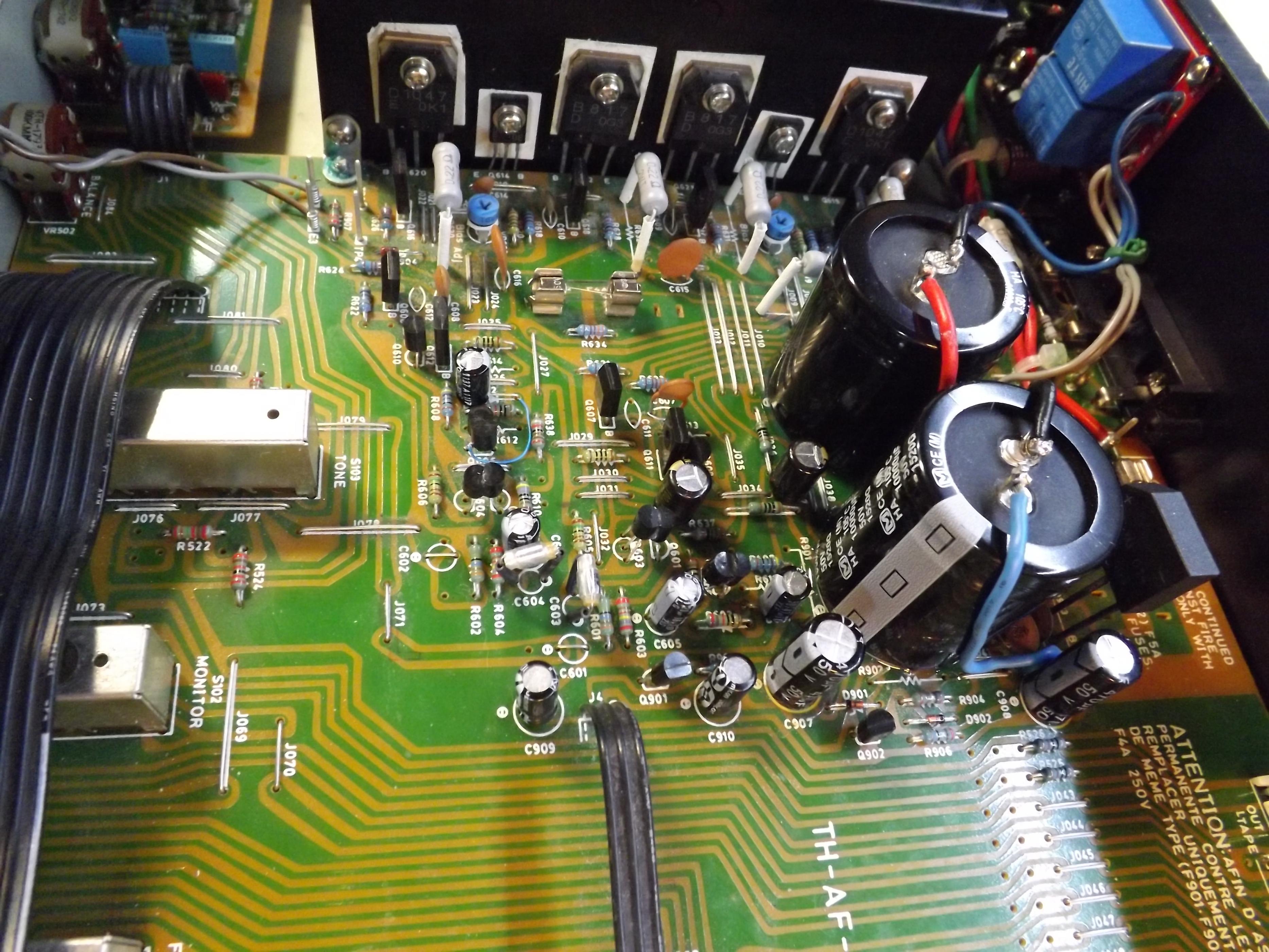

Ok, finally sorted out the full treble control setting oscillation problem. Turned out that the power amp was ok, but the OPA2134 did not like the redesigned tone control and/or dc loading. Oscillation at treble pot max was somewhere in the MHz region.
So, as a first step I replaced the old pre-amp 100uF DC stabilization E-lytes with 10uF Tantals and hey presto, I could no longer force the amp into oscillation.
To be on the safe side (and because the PCB holes were so conveniently there), I put a 10ohm/100pF pole circuit inside the feedback loop from the output to the non-inverting input - which normally hugely increases a FET opamp's tolerance of difficult loads.
Having a few pounds to spare from the original GBP 40 budget, I decided to do a couple of extra modifications. First, for my vinyl addiction, I replaced the venerable NE5532 opamp in the Phono stage with another OPA2134, Silmic capacitors in the feedback and replaced the electrolytics at the output of the stage with Wima film capacitors. Not because the now improved low-offset stage needs them, but mainly to establish a 5Hz highpass “Rumble” filter – as there is no need to amplify the movement of the pickup from any vinyl record warp or center hole offset – should such abberations ever come across my turntable.
Then I put the two 10ohm/100nF output Zobel networks back in their places on the PCB – I don't know why Rotel left out this completely sensible and inexpensive inductive load instability protection (Mind you, it may possibly have cost them in complaints and claims, as Zobels were promptly designed back in again in the RA-900 series.) Picture 1 shows the very discreetly modded PCB. It takes a trained eye to spot the modifications, but note the super-glued TO-92 input and input current stage cascode pairs.
Lastly, I inserted a speaker delay/protection relay board – mainly to stop the irritating turn-on “thump” which I admit had got more loud and sharp after the modifications.
I understand that some of these measures may be against the “Rotel philosophy”, but going back to where all this started – the 4A speaker fuses did absolutely nothing to protect the poor frying woofer coils from the standing +16Vdc on the speaker terminals – did they now?

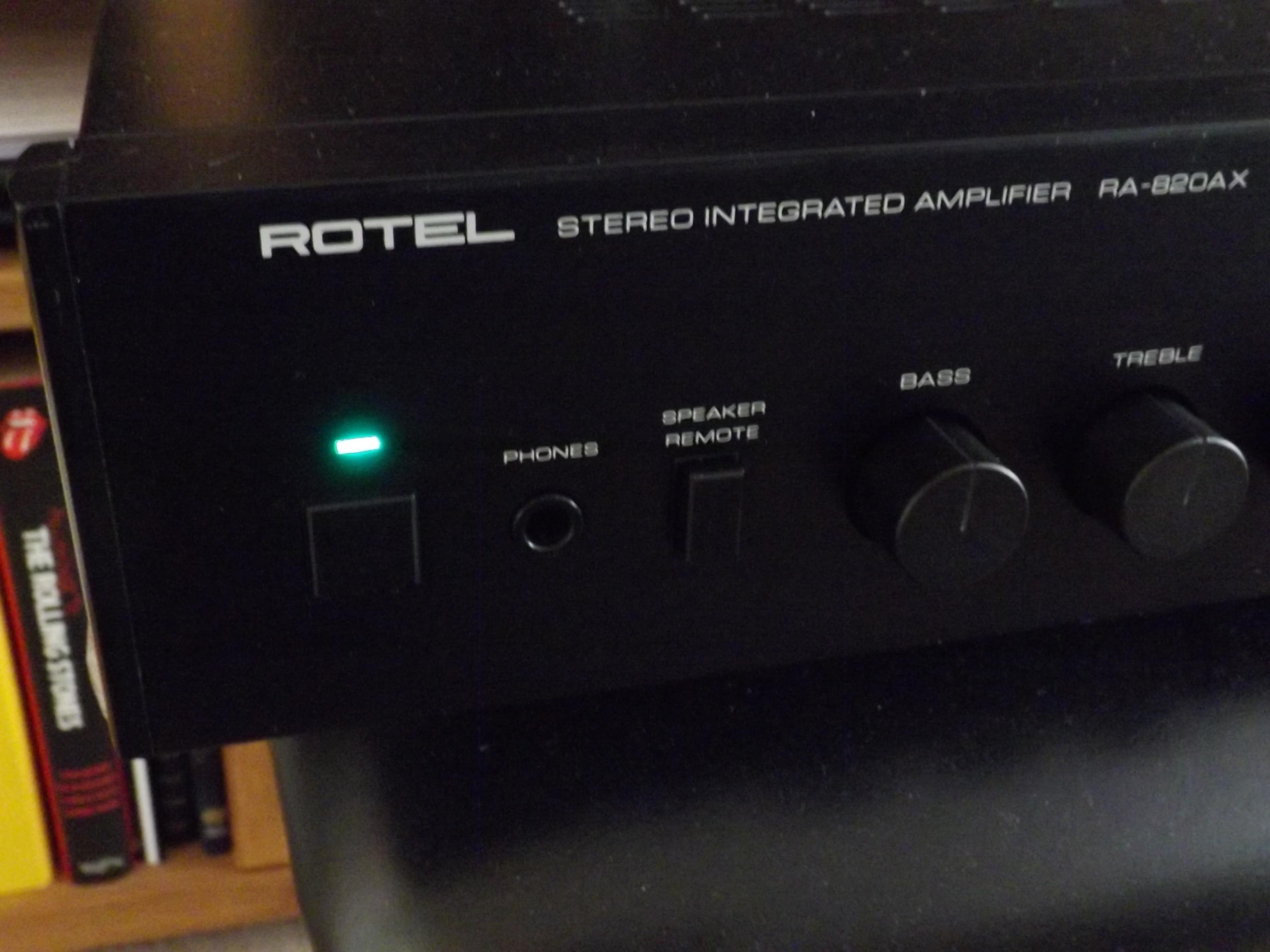

Cosmetically, I replaced the rather cheap looking red power LED with a custom made emerald green one - in keep with the old Rotel lamp colour tradition, it now looks as great as it sounds.
And sound great it does....

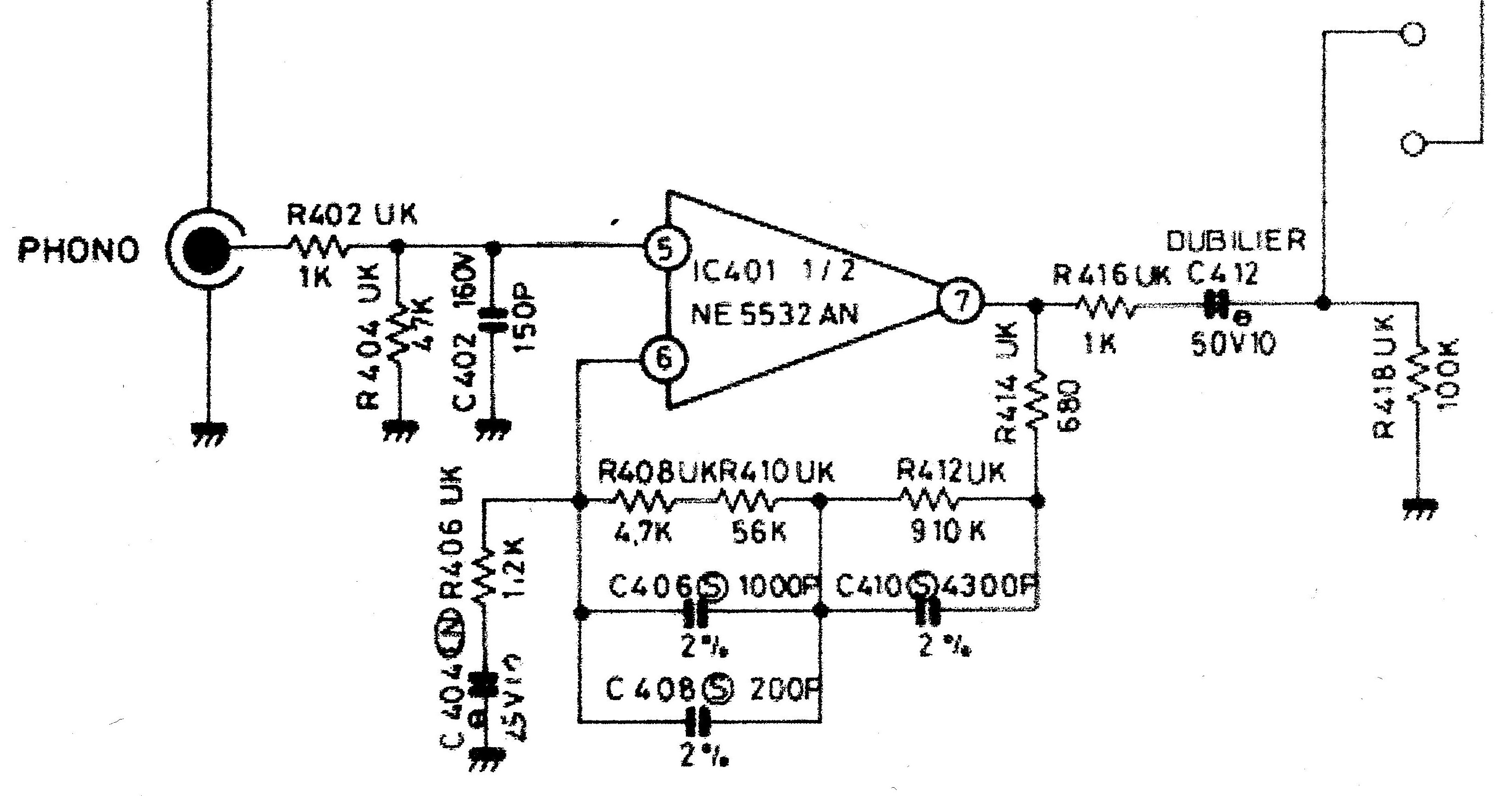

NE5532 to OPA2134 in an MM phono stage? That's a sidegrade at best, with somewhat worse noise levels. (Note that due to RIAA EQ, output noise predominantly originates from mid/low frequencies despite the rising source impedance, so ultimately low voltage noise is of more use and low current noise of less use than one may think.) HF THD may turn out marginally higher as well due to input impedance distortion (and somewhat lower GBW), though still far below vinyl/cartridge levels. NE553x have everything it takes for a good phono stage opamp, and beatiing them is not entirely trivial. LM833 and NJM2068 are lower in noise but fare worse for output driving abilities, for example.
Back in those days, a '5532 would have been a premium part. If it's a Philips/Signetics one, you are well-advised to keep it, these have been discontinued for more than a decade now and do a fair bit better in terms of common-mode distortion compared to a lowly TI job (i.e. should give less distortion in low-gain inverting circuits). Obviously an LM4562 will generally do better nowadays, but those have only been available for like 7 years.
Very interesting points. Well, I put in a good quality turned pin IC socket so I guess there's a chance to try to measure the differences. I think I may have most of the amps you mention in stock, including Signetics and TI versions of 5532. And, I believe, a couple of LME49720HA - any views on that?

Anyway, also back to the phono preamp comments above. My RIAA spec knowledge is a bit rusty so please correct me if I make a complete dodo of myself.
First, let me explain why I chose to replace the venerable NE5532 with OPA2134. The Rotel RIAA preamp circuits are direct DC coupled to the MM cartridge (i.e. no input electrolytic cap). As I remember, a MM cartridge can be generically modelled as a small inductor in series with a 1.5kohm resistor which is why it is recommended to load it with at least 47kohm. So if the opamp has any significant input currents it will mainly run through the cartridge, and the 5532 NPN input can pull up to 0.8uAdc input bias current – doesn't sound as much perhaps, but plenty for a small inductive generator and definitely not conveying for lowering the dominant vinyl/cartridge distortion. Put another way, the input resistance of the 5532 can be as low as 30kohm, effectively loading the cartridge with about 18kohm.
Which I guess is why many other quality amps of the time had a discrete JFET pair up front in the preamp input circuitry. The matched OPA2134 integrated input JFET pair outperforms such discrete solutions by a good margin, input currents are in the low pA region and input impedance is practically infinite for audio use. Voltage noise figures are comparable with the 5532, all other specs are better.
Please note that I am definitely not trying to put down the trusted old NE5532, but as impressive it was when it was launched, so are the improvements that Burr-Brown and other analogue amp designers have come up with in recent years.
But, as I said, we got the opportunity to do some measurements to check it out.

Hi Per,
Sounds like a plan.
At some point you should figure out what the total capacitance that the cartridge sees, including your phone preamp. Subtract that from the recommended capacitance and pad up or down as required. This simple step will often make the biggest change in sound quality once you are playing at the levels that you are.
I'm interested in what you find here.
