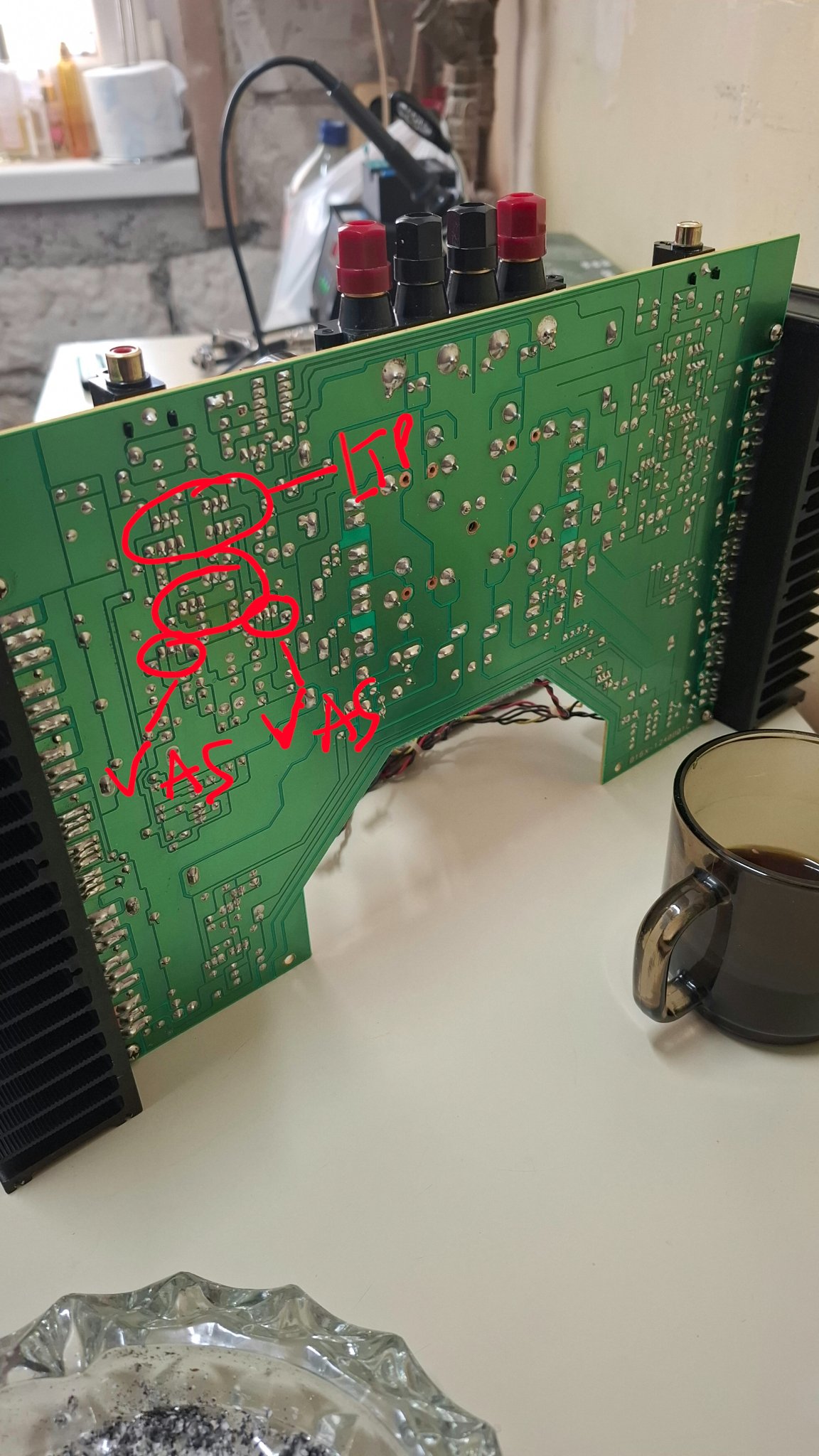

You could check the voltage across the 220E emitter resistors R619/20 and R611/12 to calculate the LTP currents, it should be around 2.7mA.
Likewise, measure across 100E emitter resistor R623/4 to get the VAS current - around 14mA.
The current through the diodes will only produce about 1mW in each, you can safely try touching them while the amp is running to check their temps.
Then, perhaps lightly(!) touch the VASs to find out what most probably has caused the darkening of the pcb.
If you are concerned you can reduce the VAS current to under 10mA by replacing all four VAS 100 ohms with say, ~150E MF.
(BTW, these DC currents run constantly - independent of amp volume or (ab)use.)
Hi Ange,
I went through your proposed modification but on a RA 840 BX 4.
I kept one channel unmodified to compare results.
Here are my findings: THD -11db compared to original channel , ie -81db versus specification and measure at -70 db…
Funny I compare it to my NAD 326 BEE … !
I had to leave the 1,8k resistors R625/627 or 626/628… to keep the full voltage swing , ie no clipping up to at least 57 watts 😊.
Same with R685 , shorting it reduced the THD advantage to only 3-4 db difference.
The 82 R is a super way to get no more overheating with those parts 😉.
Here is the link to the video with my small spectrum analyser 😊

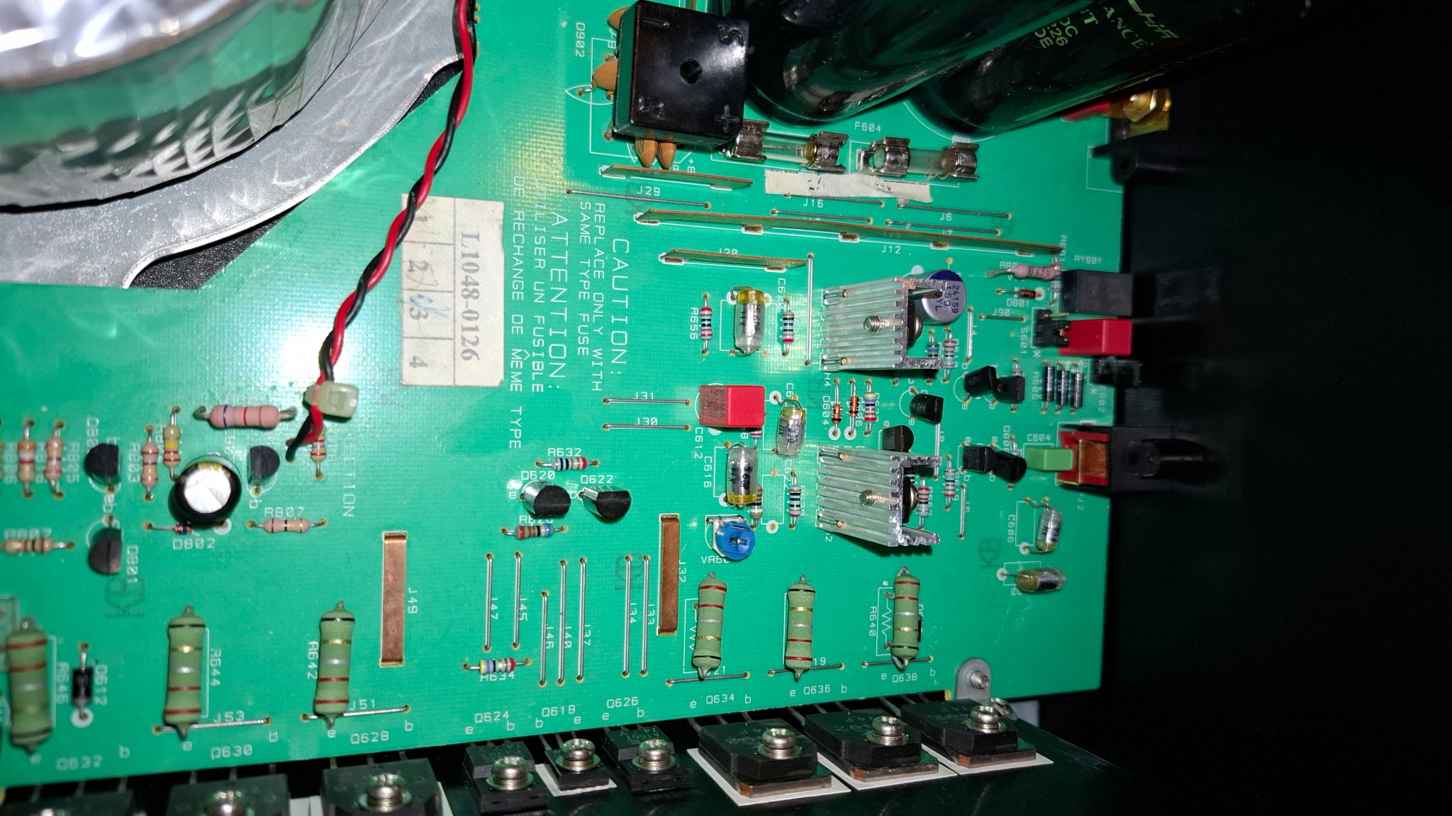

I confirm the problems with the overheating and the PCB…
My repair showed me that , after I had changed the burned 1k resistors, I had to search trough the whole preamp section to find some cold solder joint or better said cracked joint/traces on the 5532 common to both channel IC702….it looked at first like switch problems , it wasn’t it was lost solder / intermittent contacts directly on the pads…(I’ll soon release the video on the repair part)
Also when I changed resistors as per your schematic , some pads had a tendency to get off from the pcb (with little heat, I was careful)……indicating high sensitivity / aging of some of the finer traces of the pcb….
When nothing makes senses, that is where too look for, when repairing this unit 😉
