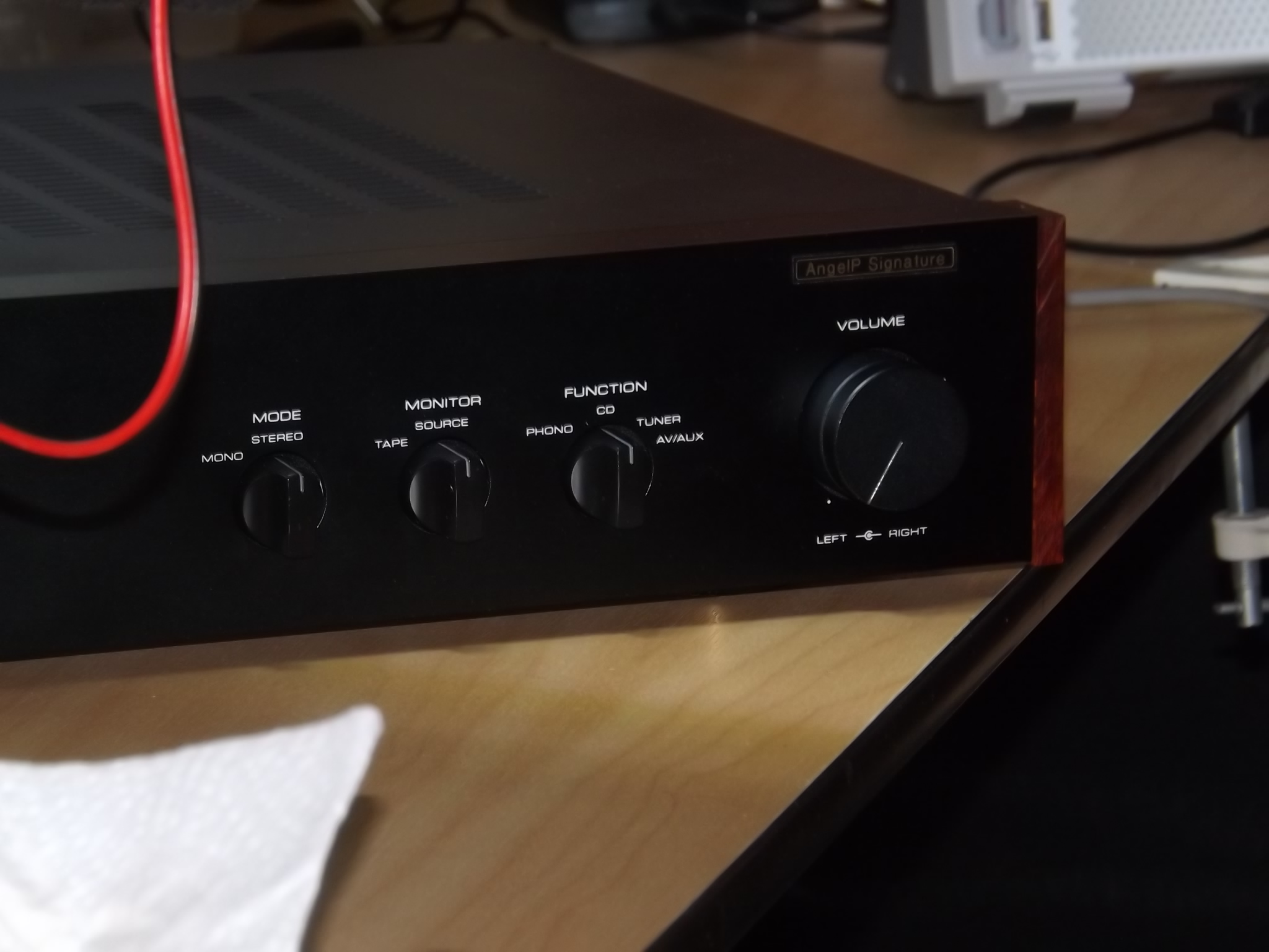

Potentiometer resistor track differences are the usual suspect.Just measured gain of all channels in rb-976MK2. For most channels imbalance is about 0.1-0.2dB but for one channel difference if closer to 1dB. Who is to blame for it? Feedback resistors?
Even when pot is on maximum? It should not be a difference as this is resistance to ground only then, but I'll check that to be 100% sure.
The potentiometer shaft and knob may be at maximum - but is the wiper inside? Is it (or other contacts) clean?
To set your mind at ease you probably have to measure the signal from the input through each stage to see what part of the amp causes the difference.
That's pretty heathern isn't it - max channel mismatch of 1.6dB worst case, probably < 1dB in practice, but who uses anything but 1% or better these days in analog? Its not like 1% costs much more and resistors are not even 1% of the cost of an amp anyway...Many units use 5% resistors for feedback as well, so there will be some variance.

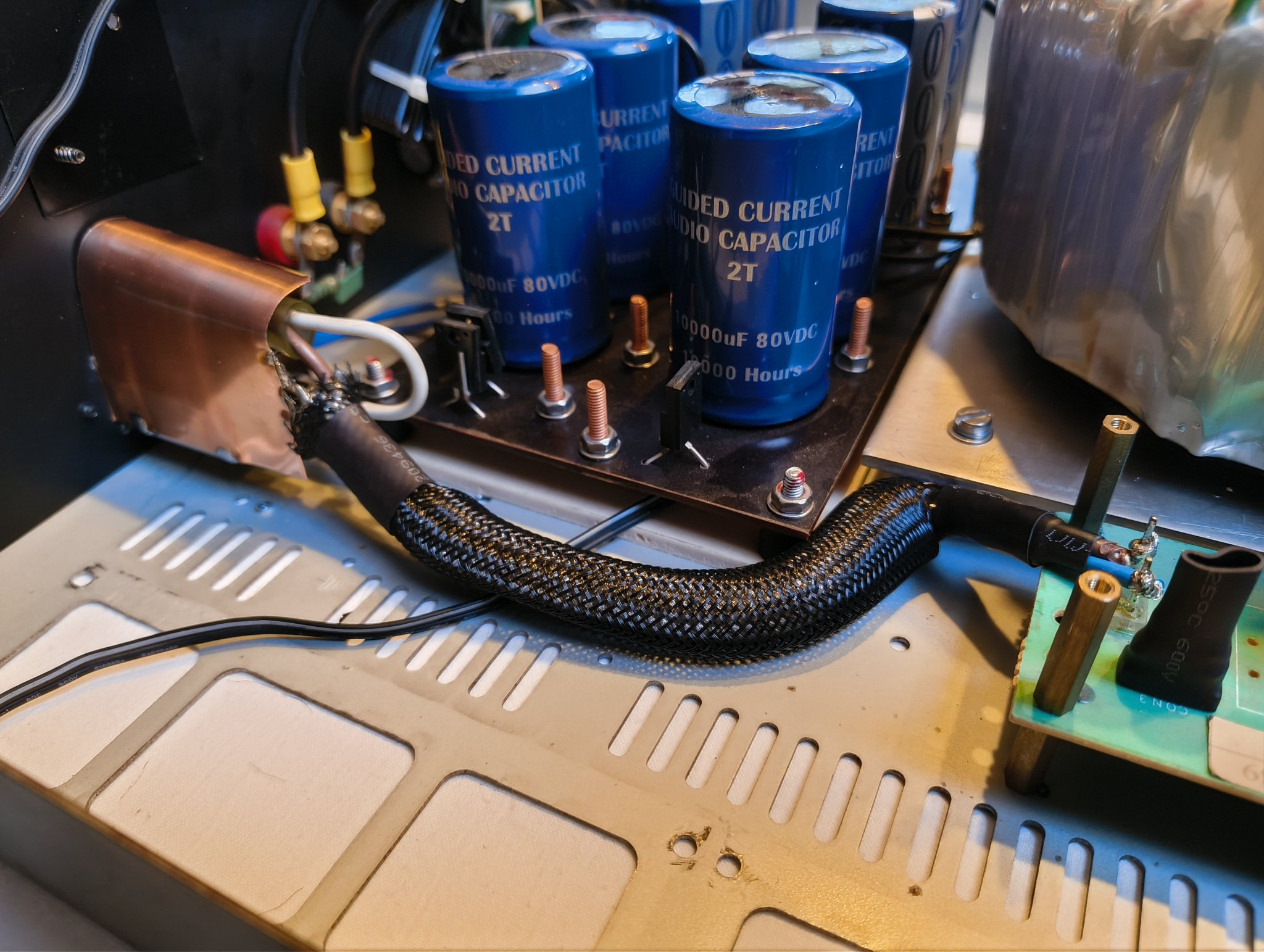

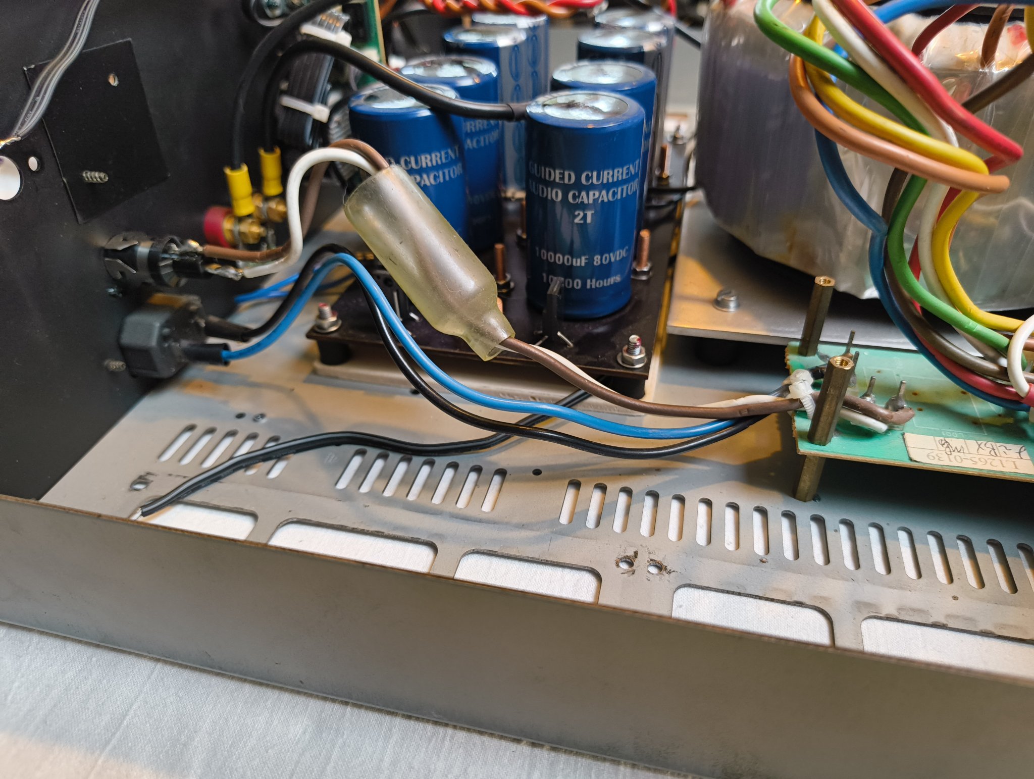

It occurred that the mains filter wasn’t there where it should be, even worse, it was totally absent.
So a new mains entry with filter was ordered and I shielded the mainswires that went from back to front.
The stock setup is puzzling to say the least.....from back to front, back again en then to the front.
All these wires (4) run very close beside the left channel....
Stock setup, mains going back and forth and over again.......powerfilter components missing on pcb on the right......
New parts for the mains setup.....missing here is a small piece of copperfoil.....
Filtered and shielded mains without the long fuse wires......

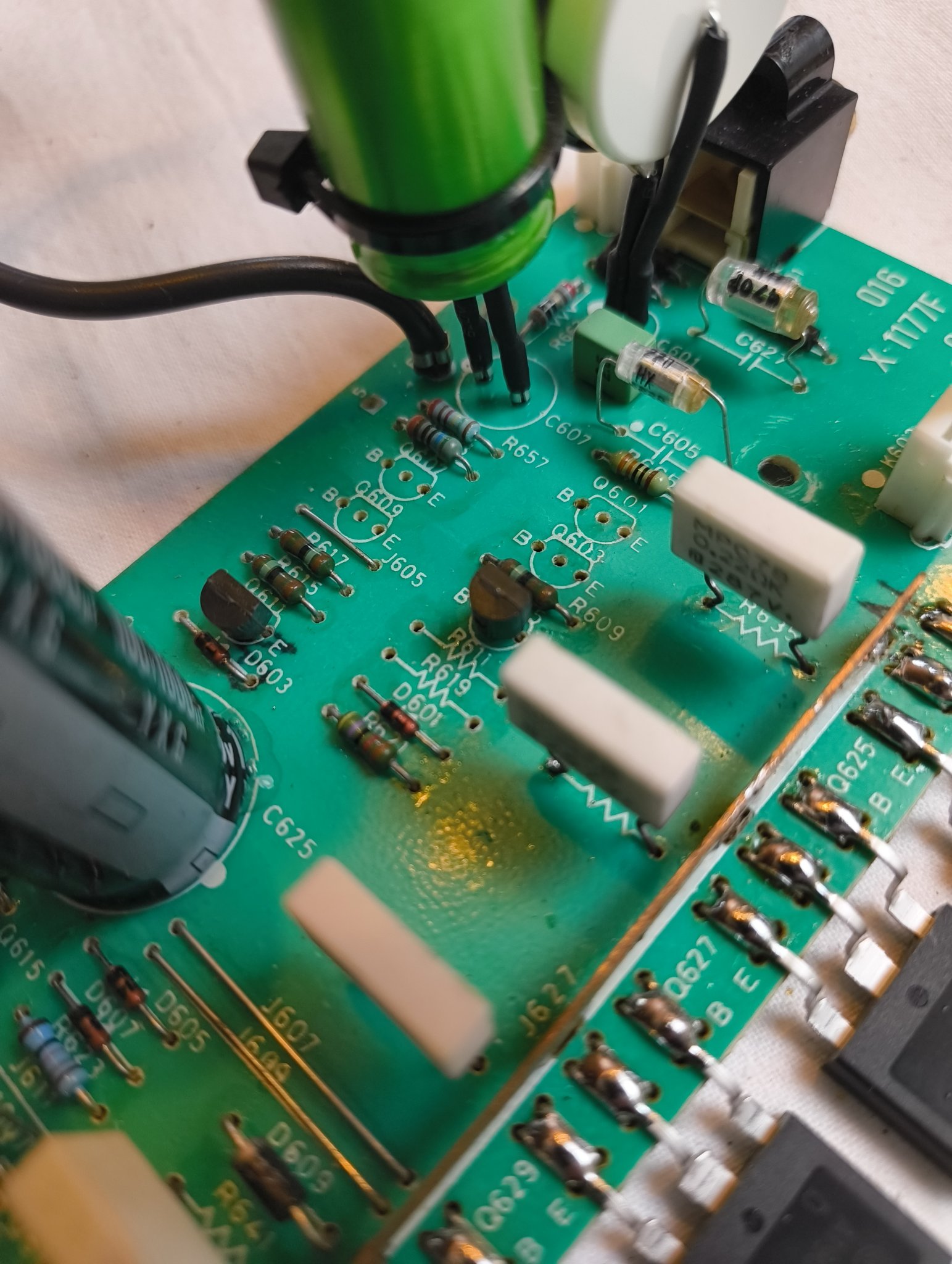

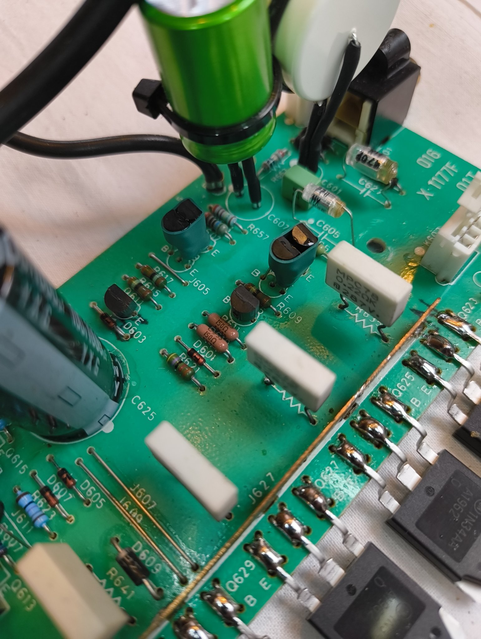

Then an upgrade from Per himself, new matched LTP’s with EDR’s and 2 resistors, this package for both amps arrived in februari ’23 so it was about time I did this.
As the amp already was taken apart the time lost was minimal.
He’d already did this upgrade on a RB-991 for a customer in the UK and was impressed what it did with the amplifier.

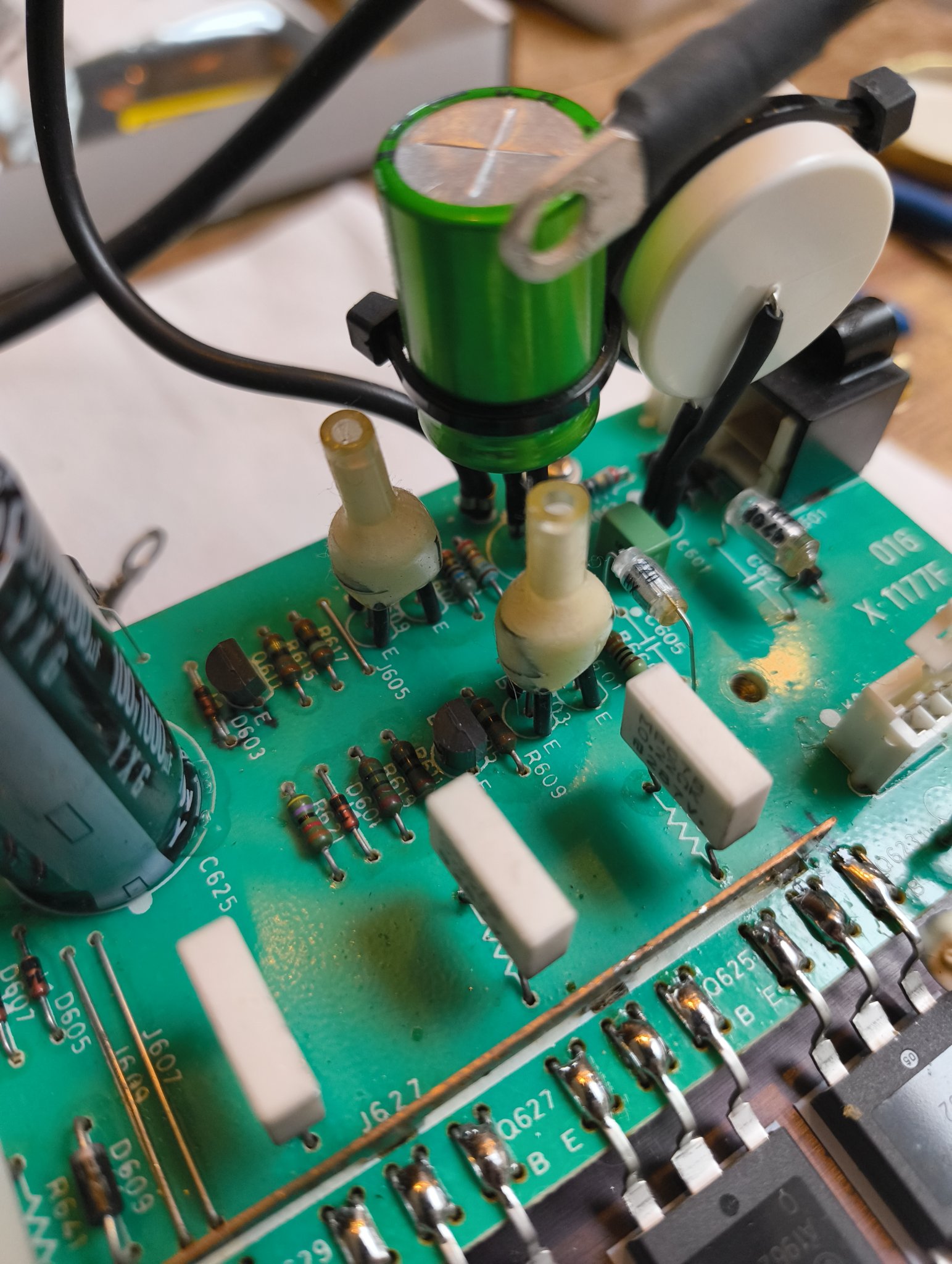

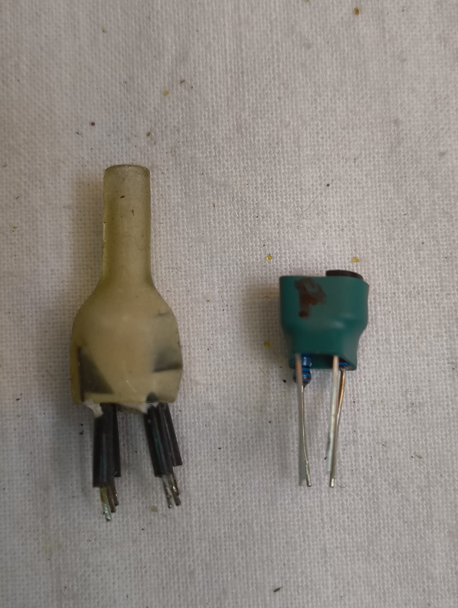

Stock LTP setup left channel......
Left stock LTP, right Per's matched LTP with EDR's.....
2 resistors and 2 pairs of the new LTP's mounted.....

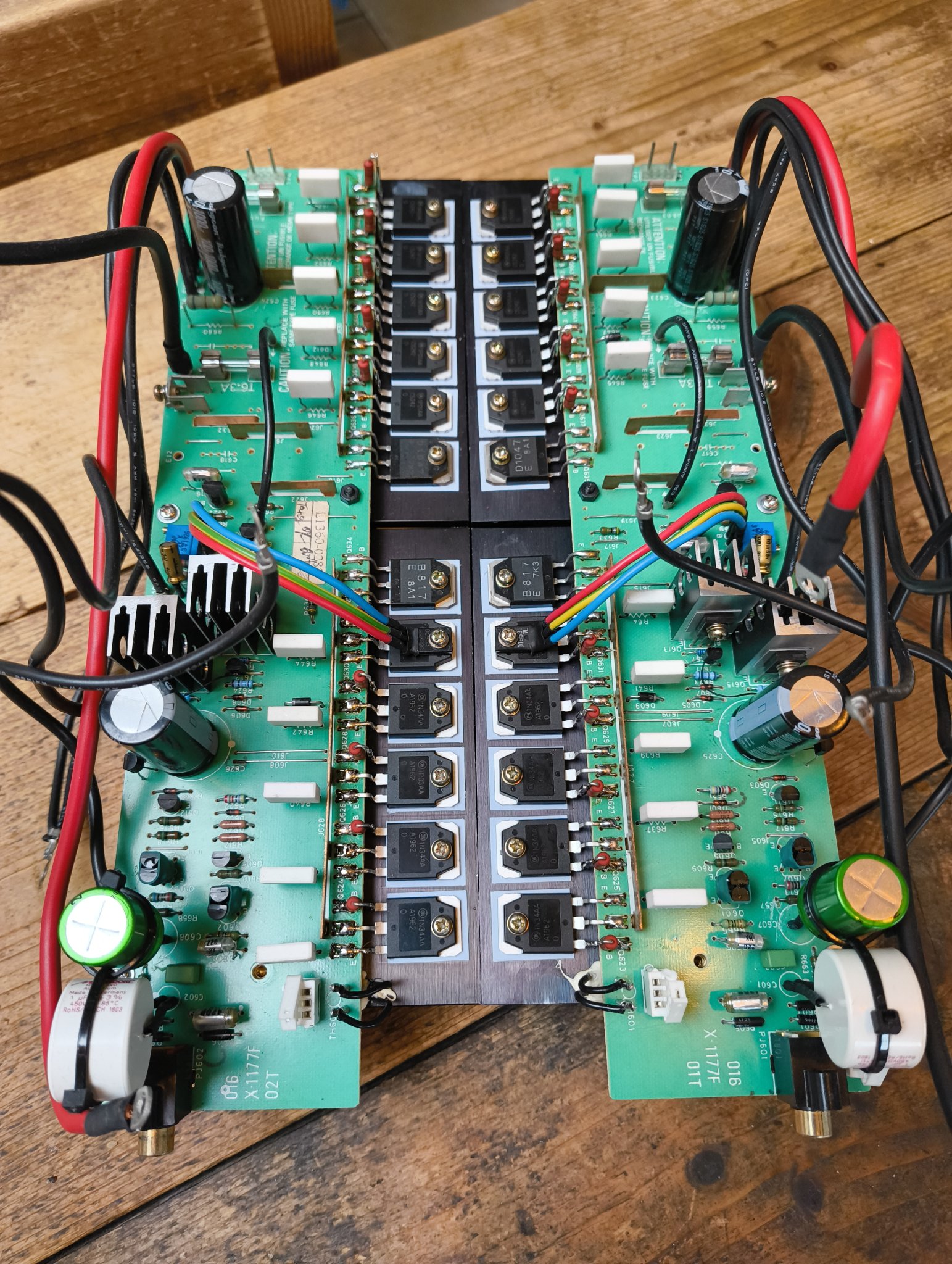

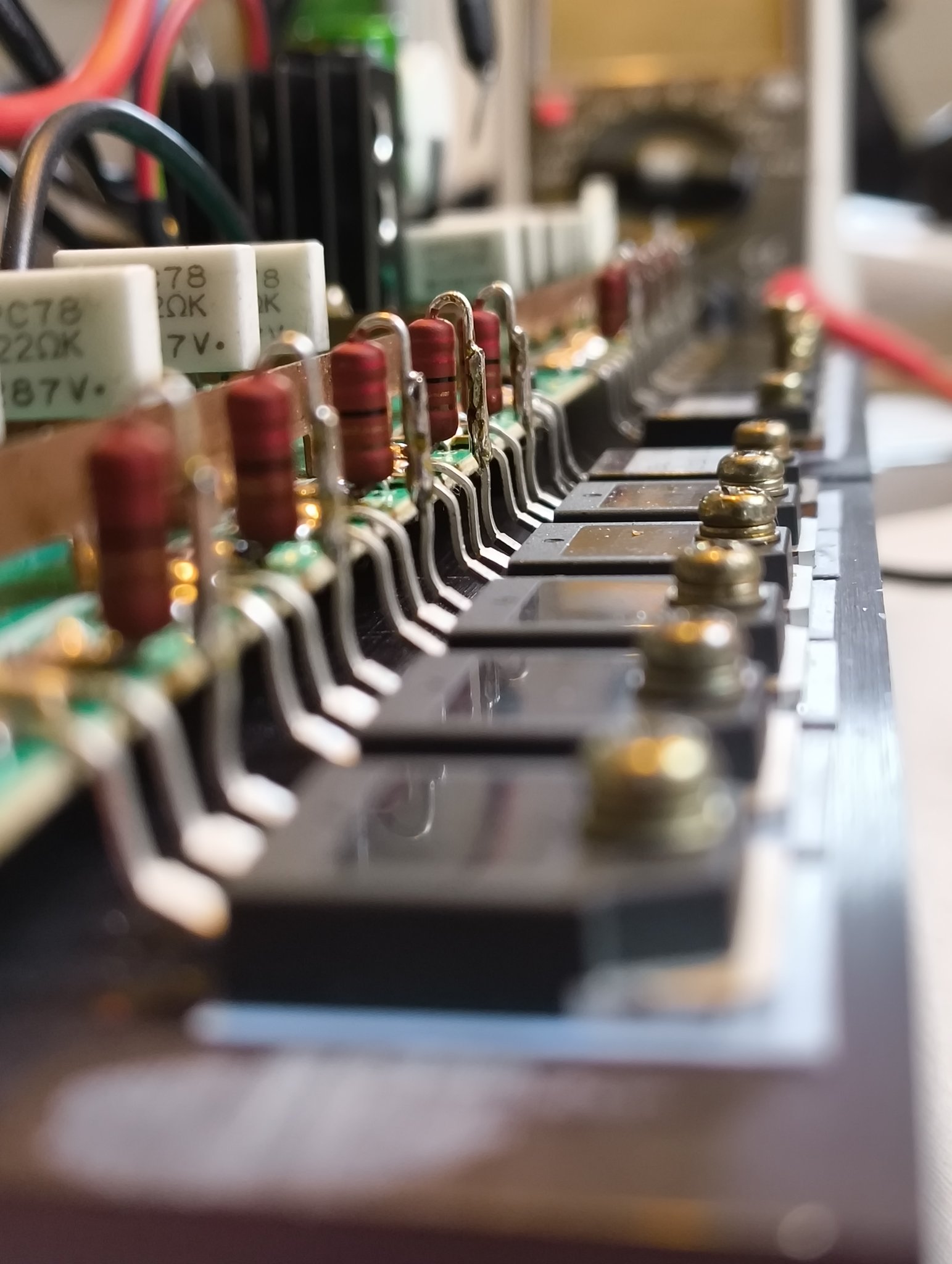

I also mounted 40 x 22r resistors on the base of the both amplifiers 40 output transistors, a fiddly job but in the end it looks like a line of soldiers
Before......
After......
Before.......
After....

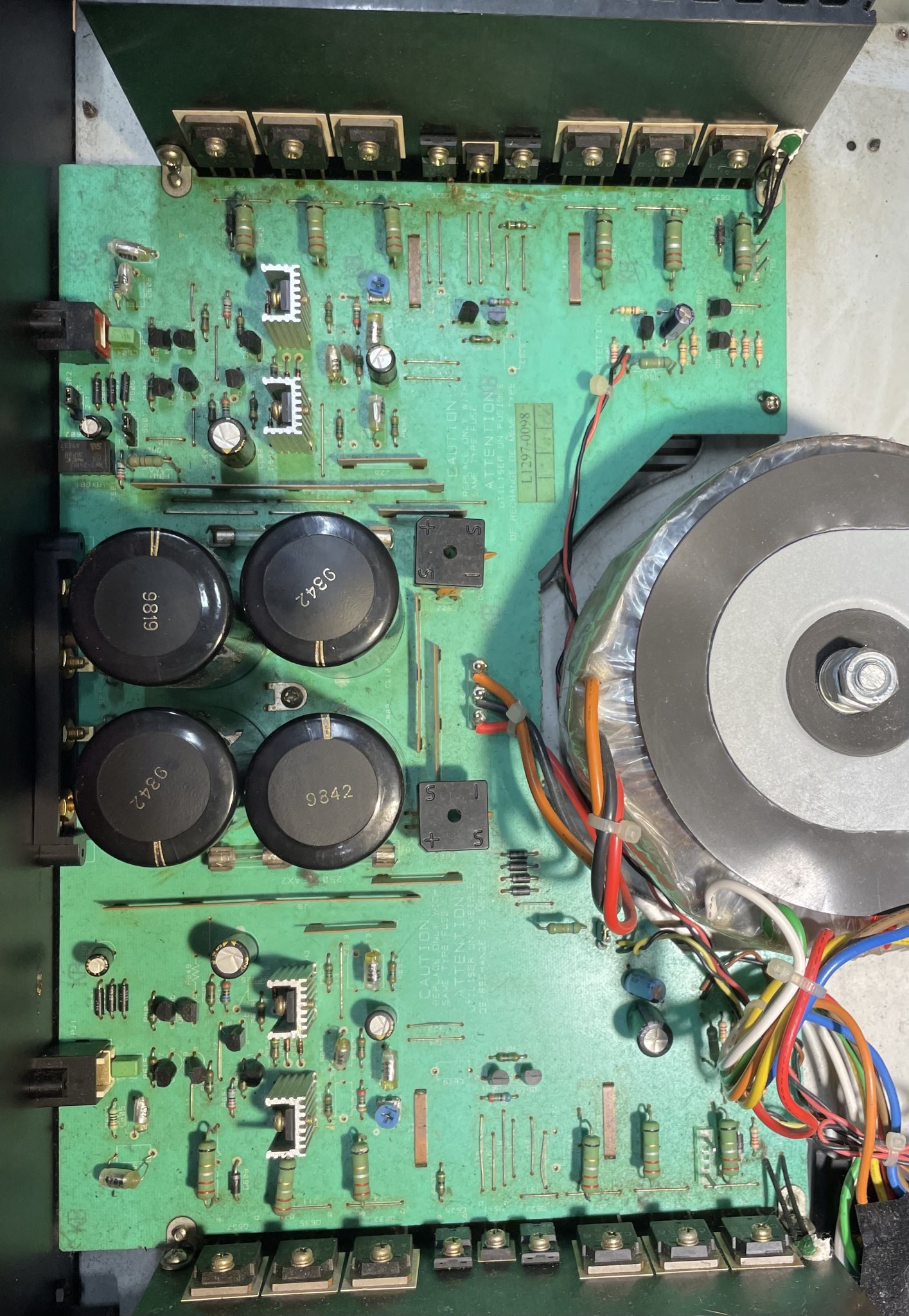

Q: Should I be concerned of a dust-attracting film coating the PCB from the unit described below? Suggestions for cleaning solution? Thanks in advance
Took a quick peek & a couple of pics from “under the hood” of a 981 purchase. One eye-catcher: one of the PS filtering caps has a different number compared to the others. I plan to replace per Smartdriver’s (SD) lead in due course anyway.
Side note 1: I plan to make this unit my first attempt to resto-mod under Per’s guidance and some of SD’s success w/his 991s.

Hi there gp4Jesus,
I use this;
Isopropyl alcohol (IPA): This is a common solvent used for cleaning PCBs. It is effective in removing flux residues and other contaminants, and it evaporates quickly without leaving residue.
When I look at the task at hand, do this in a wel vented area 😉

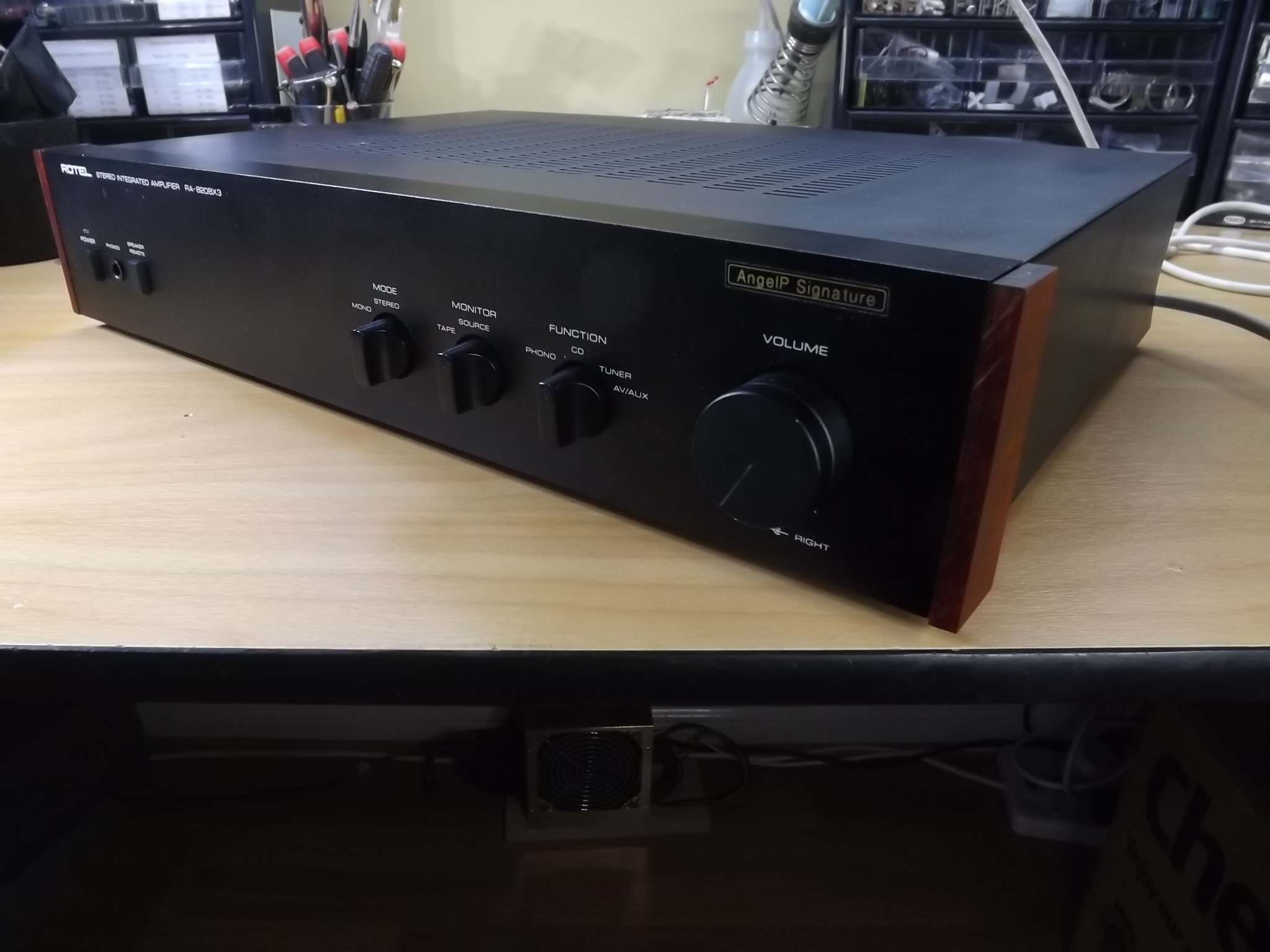

The single thing that looks 'cheap' on these amps, IMHO, are the plastic end bungs of the front plate.
So, I removed them on the RA-820BX3 and cut out pieces of dense rosewood, trying to get the look of high end amps of the 70'ies era.
(Note that these pics were taken before sanding, rounding and waxing of the end bits.)
Actually these pictures do not give full justice to the actual appearance - it really works for the amp and definitely ups the 'perceived quality' to match the audible improvements inside.
And all without breaking the bank - just a bit of time and woodworking effort.
The result isn't half bad, no?

I have often been asked why I chose Rotels for this thread and do upgrades on.🤔
Well, firstly even in stock condition they sound very nice and do actually compete way beyond their price tag compared to many upper range amps. Hence their huge popularity over the years.
Secondly, I find these relatively inexpensive entry/mid range amps very well built which makes them much easier to work on. And to enable modifications to look organised and professional without oversized component eyesores or rats-nest airwiring.
Ok, some people think that the Rotels are a bit too 'black and discrete' - which I personally like, but I admit that perhaps they could be cosmetically upgraded too. 'Blinged up' a bit if you like - or just given a more 'exclusive' appearance.
