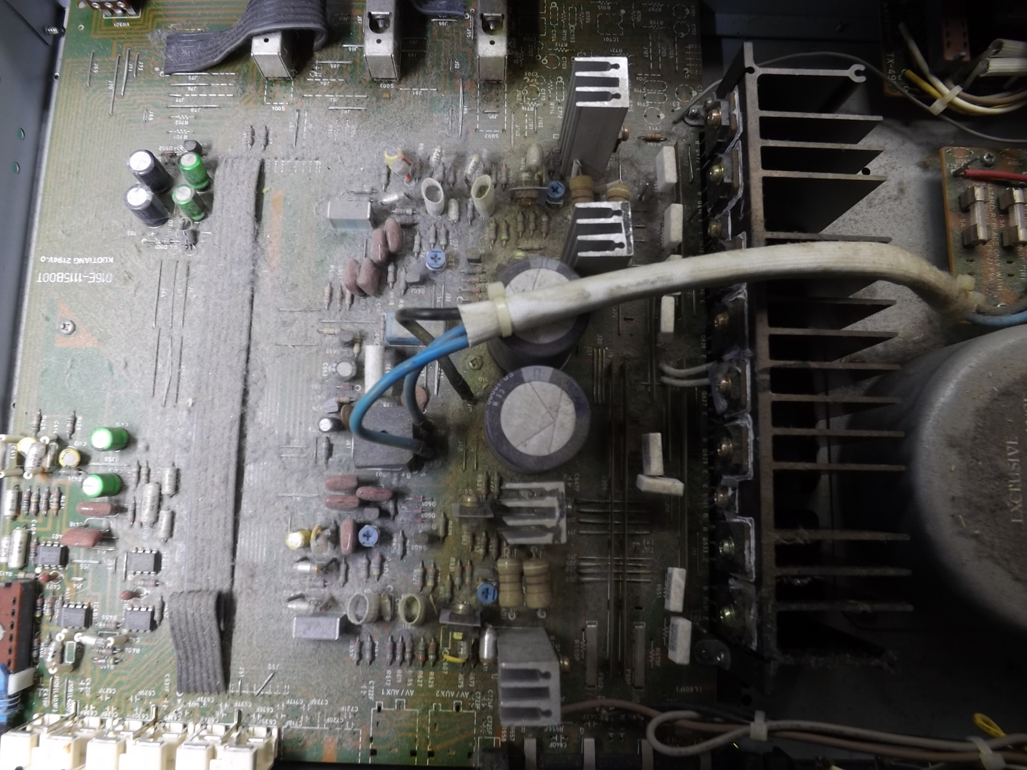

I got another RA-820 BX3 to see whether the issues I had in ‘Rotala’ #1 were unique for that particular amp or if there should be some systemic faults in these ‘non-Curtis’ designs.
The first thing of notice is that this BX3 ‘Rotala’ #2 has a completely different pcb and even some circuitry differences – without any indicative model name change, not even a “Mk.II”.

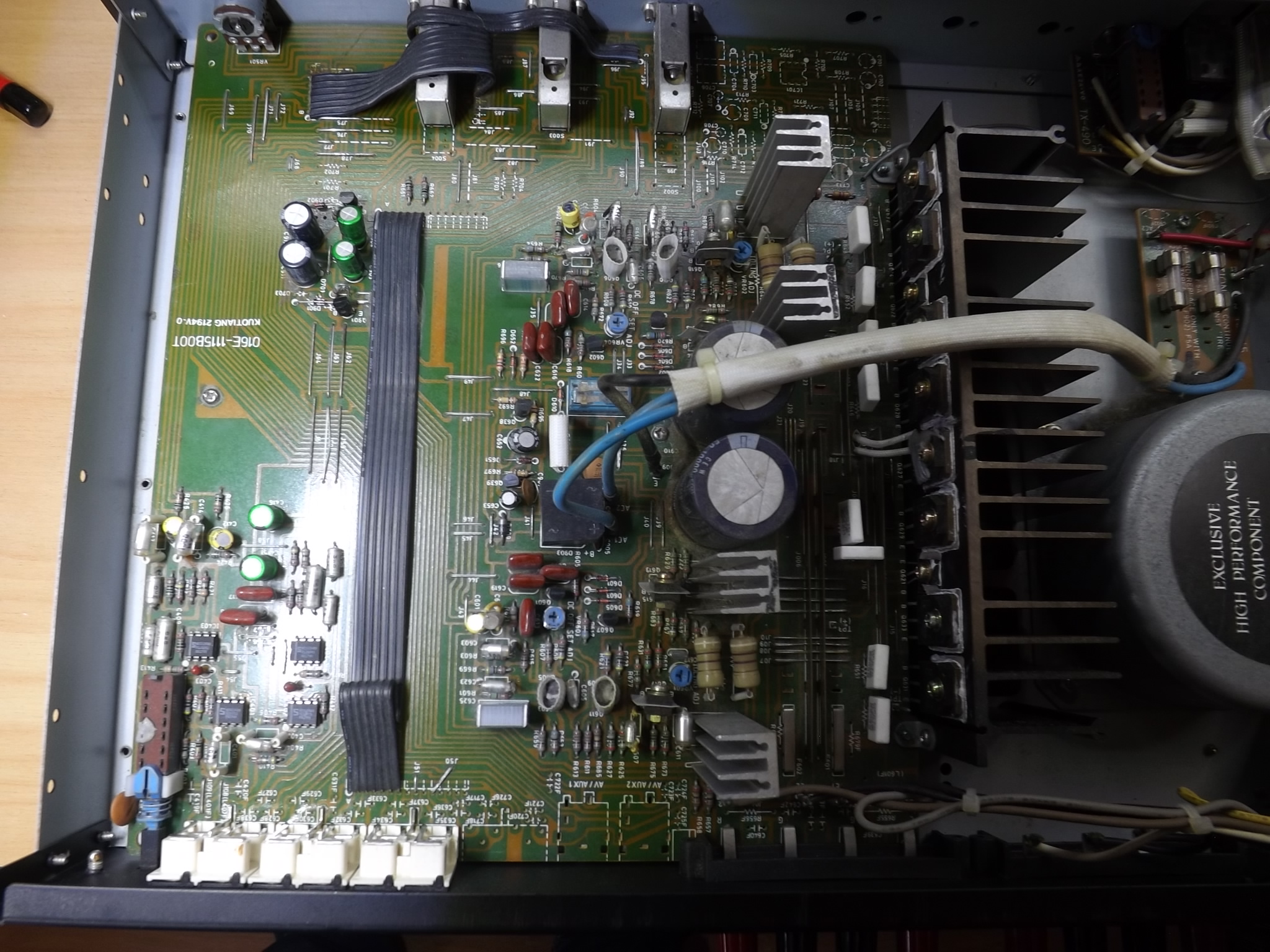

Well, that became clearer after a bit of de-dusting:🌪️
After some repairs of faults (yes, I bought it “with some problems” on ebay for £25). I turned it on and it ran just as flaming hot as Rotala #1.
The VAS to about 90 ºC and the 2W 910R driver base resistors got up to a whopping 120 ºC!.🔥
I actually found that these two resistors in the left channel had burned out (!), so the driver transistors only acted as b-e diodes.
The output offsets were -680mV and -595mV (!!) – which could not be trimmed out, but at least they seemed to be stable!
So I decided to first keep the right channel original as reference, and do the required changes to tame the temperature and offsets in the left channel.

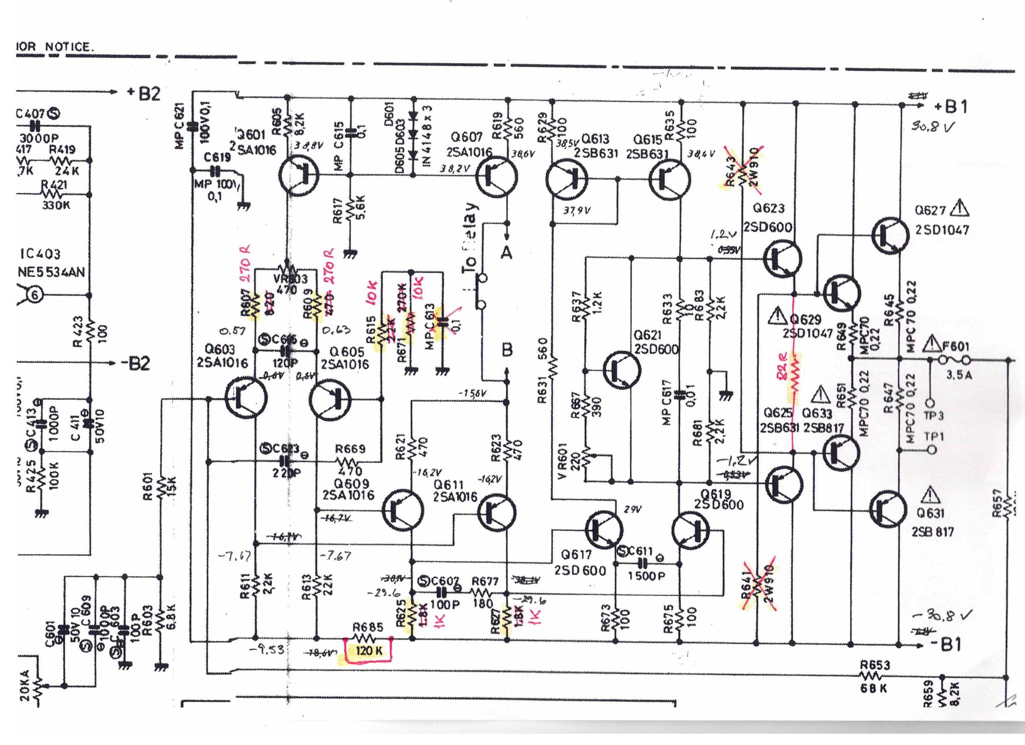

So, as an absolute minimum you should immediately heat up the old soldering iron and get 14 inexpensive resistors (all 1% MF 1/4W):
4x 270R; 4x 10k; 4x 1k and 2x 82R.
Then replace as follows:
The 270 and 10k’s will remove most of the offset by balancing the LTP (and significantly reduce THD in the process). Trimming to zero is now easy with VR603/4.
The 1k’s will reduce the VAS current and bring the VAS temperature down from over 90 ºC.
The simple 82R (replacing the two big 910Rs) eliminates the heat they produce while doing the same job.
And you could then also remove C613/4 and short out R685 – the LTP’s 2SA1016s can easily take the full rail voltage.
Then trim the bias up to 4mV to reduce crossover distortion – and ‘Robert is Your Father's Brother’ as they say.:happy1:👍

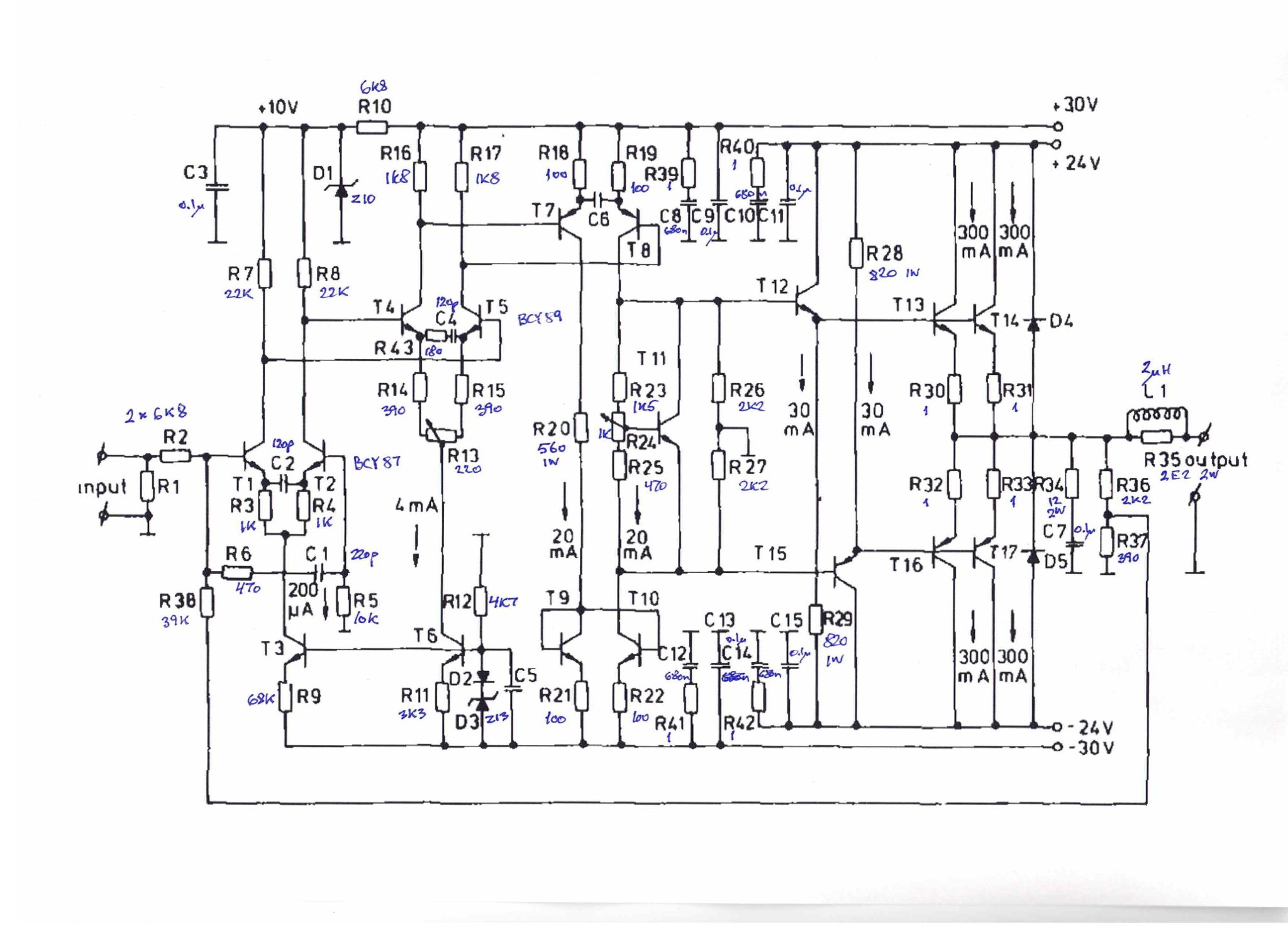

Sort on that topic, I managed to find a copy of the original Otala 1973 paper. Here is the schematic:
You will note that he used a 6k8 and a 10V zener to reduce the c-e voltage over the LTP, as the BCY87 is a max 40V device.
Rotel apparently directly copied the Otala design - inverted it, then added some inexplicably silly things and didn't fix others.
All of which my 14 resistor upgrade in post #1,121 above sorts out.
And in the end you will have a quite pleasantly sounding 'classical' Rotala amp.:happy1:

Checking the design on simulation with R625, R627, changed to 1k in value from 1K8 (to reduce heat in the VAS stage) seems to effect the overall gain/headroom of the amplifier. Figures I get are 26v peak output with a level of 365mv in - equivalent of around 42 watts into 8 ohms before any losses.
With R625, R627, changed to 1k severe clipping occurs with the same input - reducing it down to 280mv gives 17.6v output, or 19 watts into 8 ohms.
If you could check this on your modified circuit I would be very pleased.
Also, on your "basic minimum" circuit of changes, you would need to change R605 to 2K15 in value for the changes to work (according to simulation) or gross overload in the first stage occurs. Changing resistor R685 in the negative supply back to 120K would stop this and make the circuit work, but this would be a backward step I think. If you could check these things out on your modified amp and put me right, I would be very grateful!

And, upon re-opening the amps - yes, I had already changed the R605/6 to 2k15 on both. So, the 14 resistor 'bare minimum' upgrade should actually be 16 resistors.:sorry: Changing from 8k2 to 2k2 does increase the LTP current to 560uA - still a modest 280uA through each.

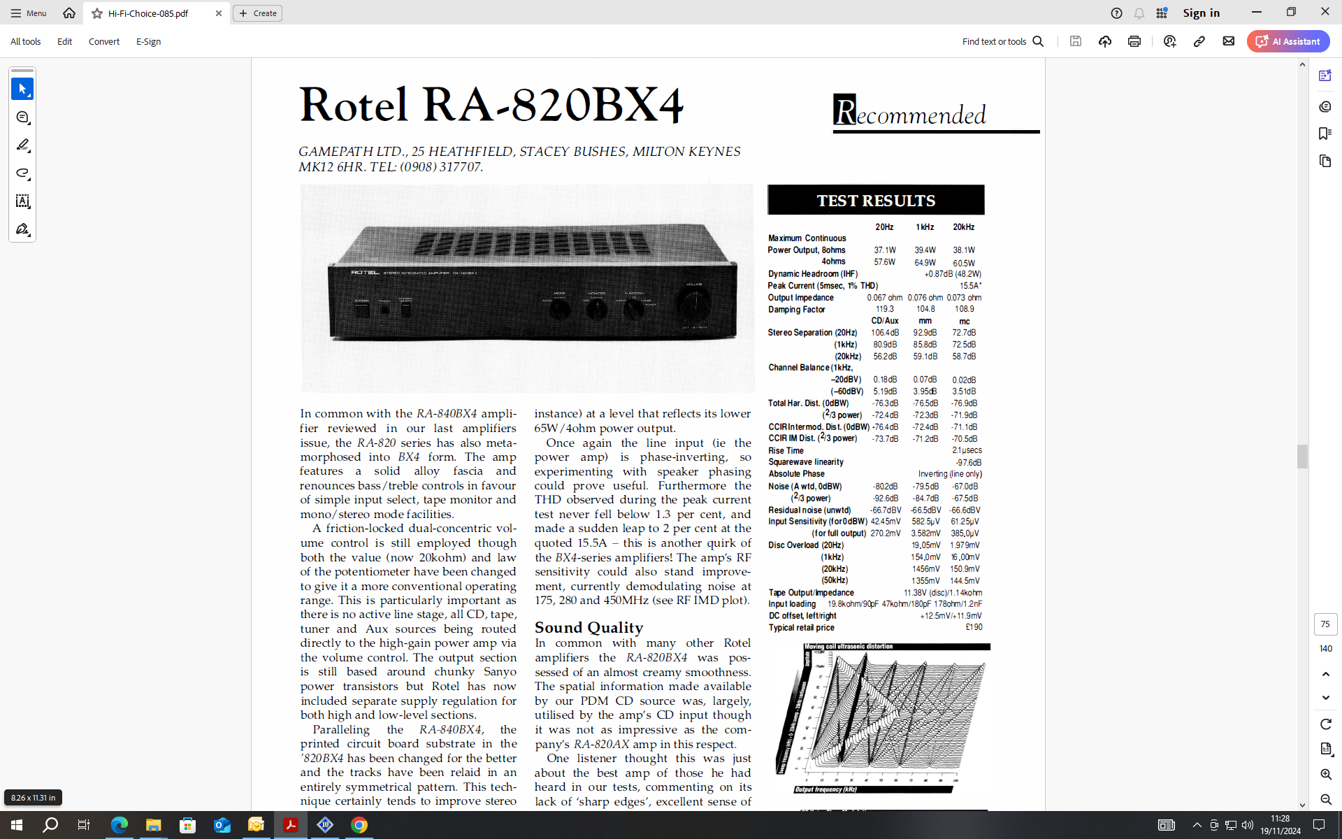

The gain of your amp seems to be different compared to a review by Paul Miller in August 1990! He managed to get 39.4 watts into 8R with a 272mv in to the CD/Aux input. Rotel are usually very conservative with their specs so 32 watts seems a little low for one channel driven into 8 ohms?
Did you replace R601, R603, back to their original positions from your first amp, as this would change the gain in the shunt feedback configuration, unless you re-scaled R653, R657, accordingly?
