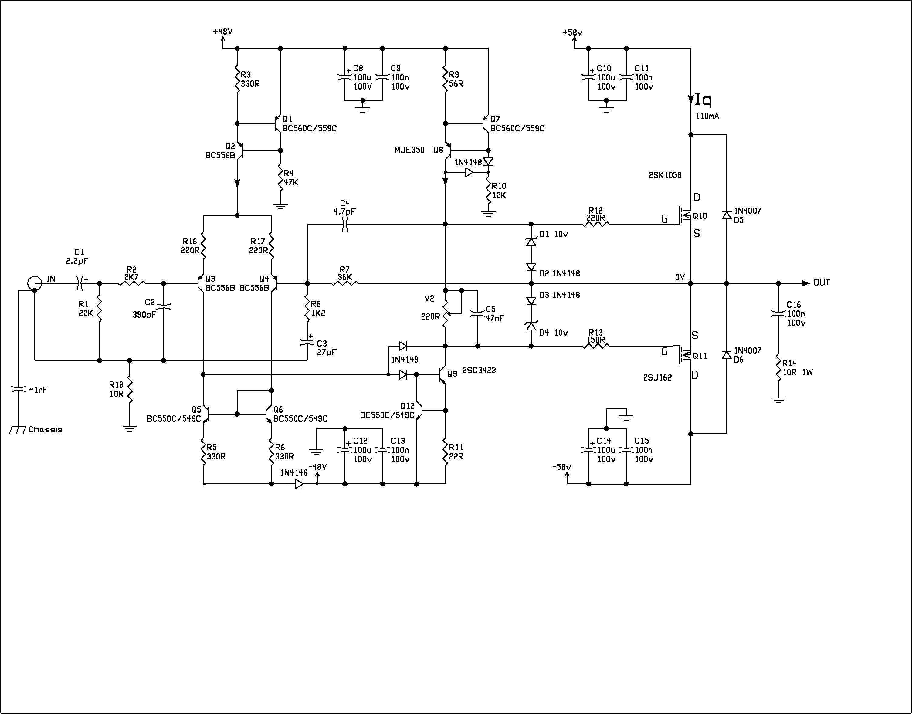

implimenting a baker clamp
Looking back at the original schematic, I realise I made a mistake.It can't be Cgs, for that the output has to have the lower voltage.But here the driver side is the lower one, so the clipping is not in the mosfet's but the driver BJT's.

Try a reverse-biased diode in parallel with the gate resistors (R12, 13), it will allow the gate charge to be sucked out faster.
i know the circuit is still stable with lower values of R12/13, so i will try out 150/100R with the diodes, as this mod is easy to try out.
Not related to the question but an observation. Shouldn't the power rails be the other way round. The MOSFETs with the lower voltage and the input stage the higher?

The transformer i am using is a 40v, giving rails of around 58v. With hindsight a 35v transformer would be more suitable, giving less dissipation in the output devices as it has been pointed out, however i am stuck with the 40v transformer.
However it does enable me to power the input/driver stages via a regulator circuit which i have set to 48v or so.
thats a 10KHz sine, at lower frequencies (3KHz) there is still some latchup effects, but no as much as at 10KHz. I think at 1KHz the clipping performance is acceptable...
( scope is set to 10v per div )

What you see in screen picture of post 1 is perfectly acceptable and is all you
can expect from an amplifier topology like this, being about 40 years old. You
may want to add a shot of the voltage made at gate drive point under the same
conditions for comparison, preferably both on the same screen pic taken with
compensated probes.

You could run the IPS from higher rails by adding a small transformer with 15V dual secondary windings and stack these on top of the OPS transformer (40V) windings. You could then regulate down a little from there.
Or a cheaper method would be to add another couple of secondary windings to your current transformer.

no luck with diodes across R12/13.....i think i will leave things as they are...
Did you allready tried it like this ?

Yes but also not the diode from base to collector but from diode before base to collector.
Your picture of the clipping shows something wrong at both peeks.One from Q9 and the other probably from saturation of Q8.

As said before what you see in screen picture of post 1 (10 kHz)
is perfectly acceptable and is all you can expect from an amplifier
topology like this. The relatively short overhang delay time seen
corresponds to a frequency of 500 kHz or so. Situation will not
change if you put diodes at random points of the schematic or
play with supply voltages.
