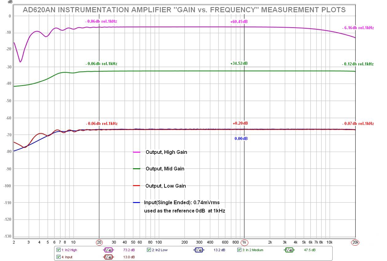

Hi George, very good results indeed!
When I was first simulating I was looking at stuff this small and optimising to eliminate, little did I know how far from that I would be able to measure with my scope (I didn't even have a scope when I started).
The disappointment was great when I connected my scope and found that with it's maximum resolution of 2mV / div that all sorts of rf and other noise pickup made my scope trace at low frequencies quite thick and impossible to distinguish the low levels I was interested in from the wideband noise.
Then I came across your CRCRC experiment thread, and your method was a revelation
I'd once again like to thank you for your efforts in doing this, it is greatly appreciated!

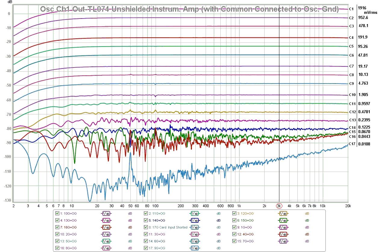

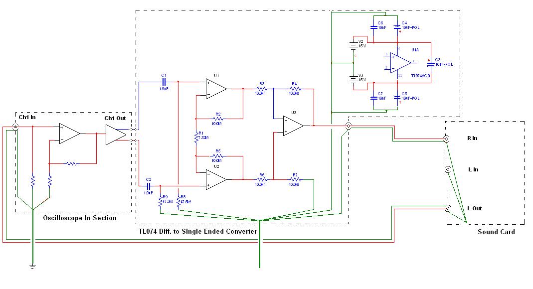

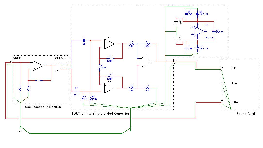

This is a revisit to the performance of the TL074 (R1=7k33).
I attach again here (att. 1) the diagram shown on post #56.
This was a representation of FR-amplitude measurements with the TL074 circuit connected as shown in block diagram on att.2.

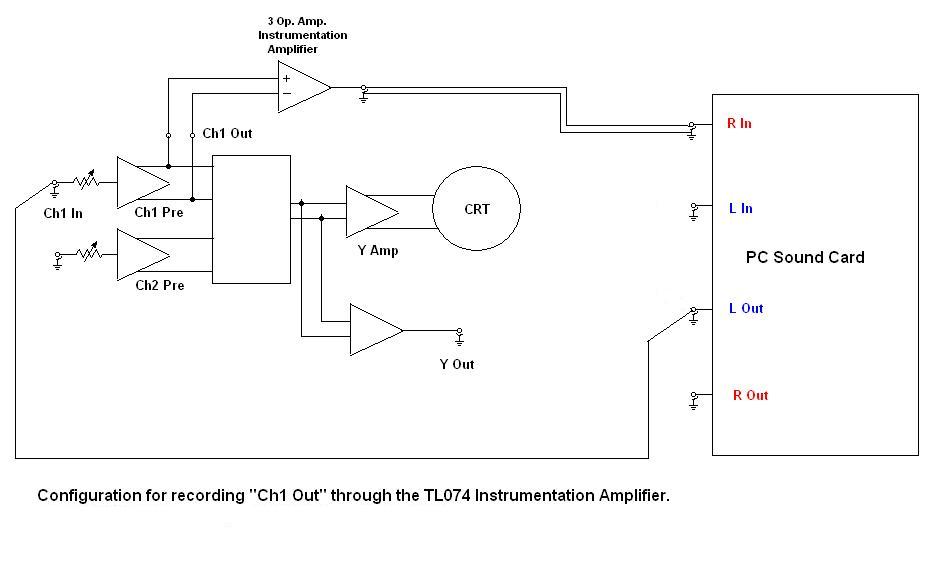

In this diagram, it is not very clear how the 3 (i.e.: 1. oscilloscope, 2. TL074 circuit, 3. sound card) circuit commons (“grounds”) are interconnected.
Therefore, I drew another diagram which shows this (att.3)
Here you can see the following:
The oscilloscope common is the only one that is connected to utility’s Earth.
The sound card inputs and output have their commons interconnected internally.
The sound card’s common is connected to the oscilloscope common and to the TL074 circuit common, through the interconnects outer screen.
The TL074 circuit’s common is not directly connected to Oscilloscope’s common (it’s +/-15Vdc PSU is floating), but it is electrically connected to it through the sound cards Input-Output interconnects.

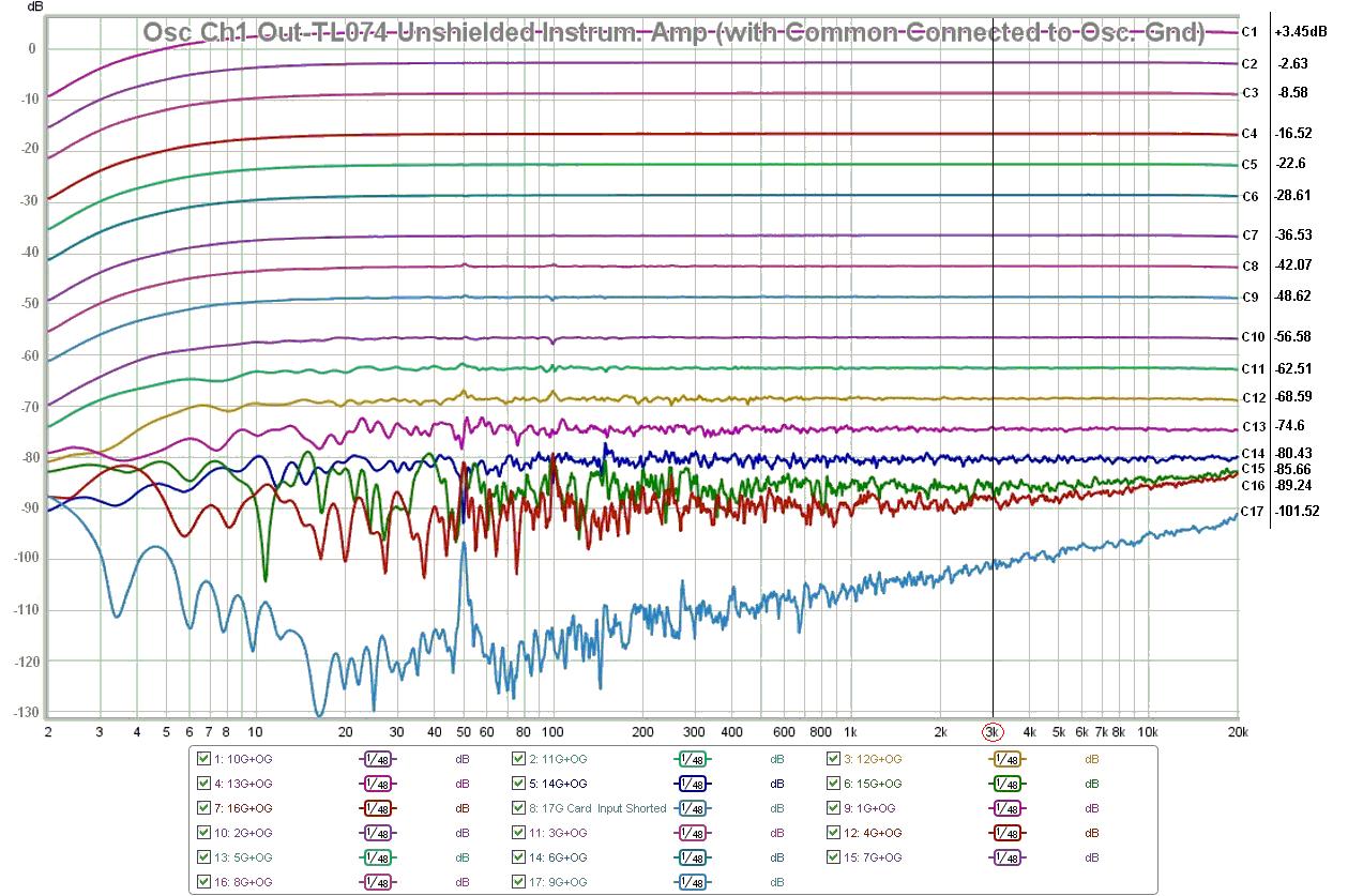

I had to see how much influence would, the direct connection of oscilloscope common and TL074 common have on measurements, because that configuration would exist ,had I supplied the TL074 from the oscilloscope’s PSU.
This configuration is shown on att. 4.
The measurements using this configuration are shown on att. 5 & 6.
As you can see, the acceptably quiet curve has shifted from curve C9 of att.1 to Curve C11 of att. 5 & 6. The quiet plateau has gone down by 12dB !
And this by merely connecting the TL074 circuit’s copper to oscilloscope steel sub frame by a thin 30cm long wire with 2 crocodile clips at it’s ends.
This is good news for now

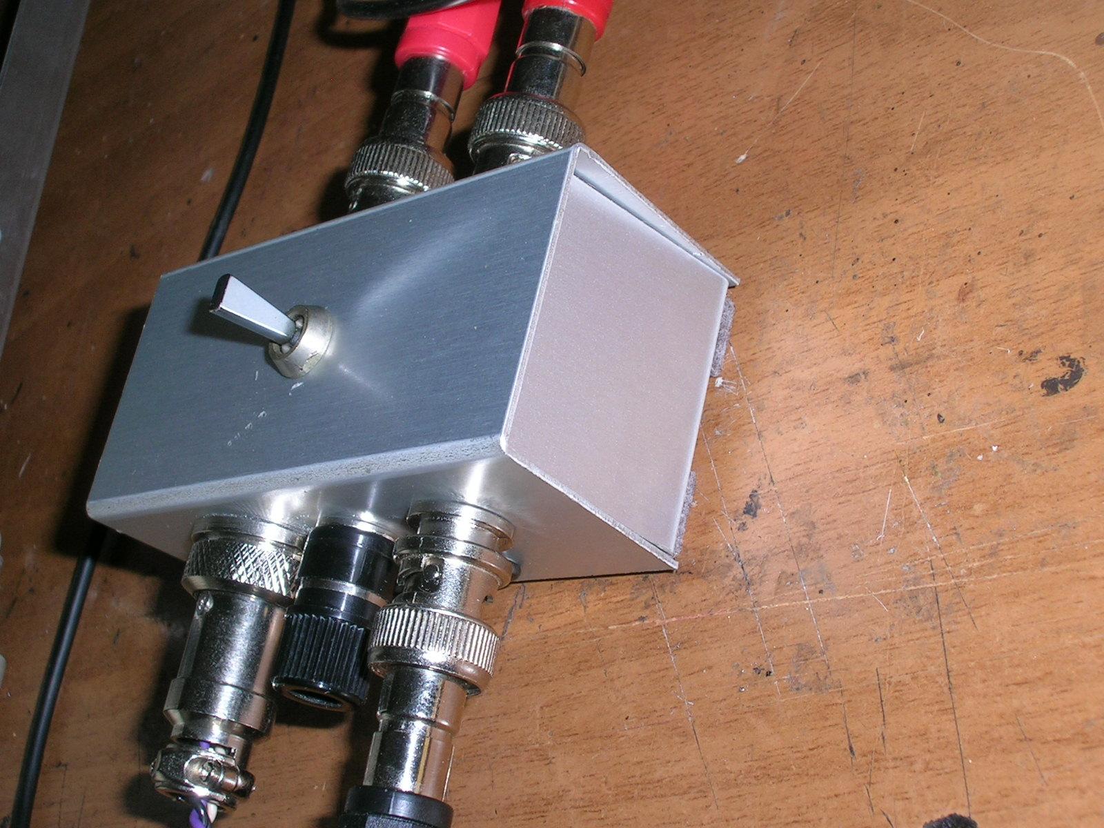

I finally put my SC preamp into a metal box. The reduction in noise was substantial

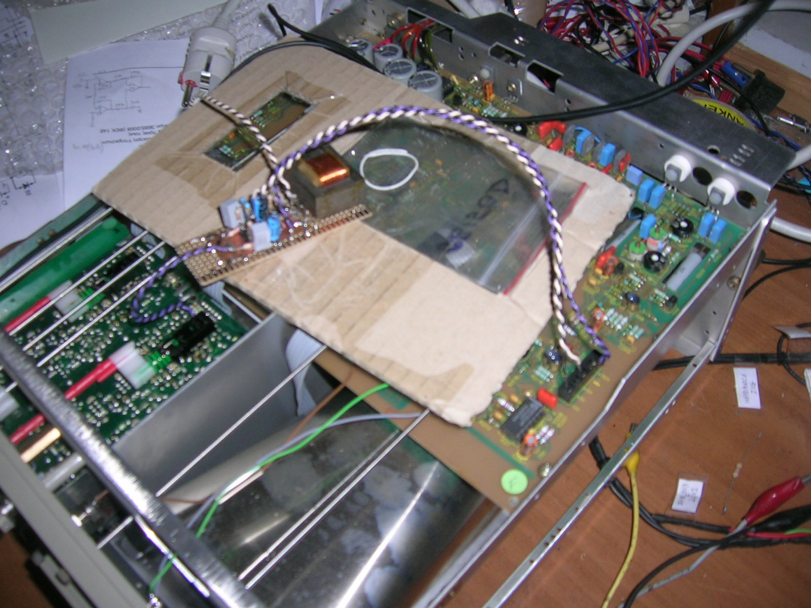

What are you using for the power supply for the TL074 if not off the oscilloscope circuit
I was using an adjustable regulated bench PSU. It has voltage and current displays and a current limiting mode which is handy -safety wise- when testing circuits or operating them in a “lots of leads flying around” mode, which was the case here.

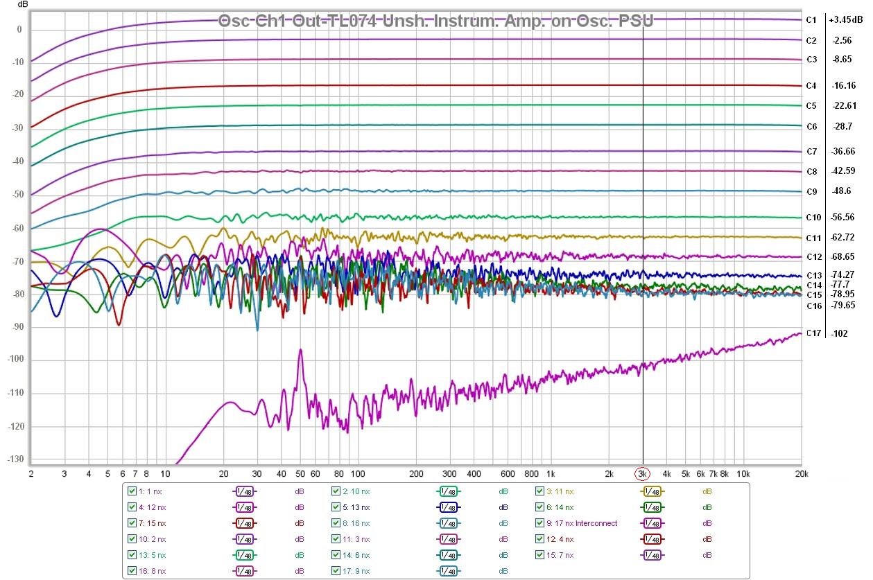

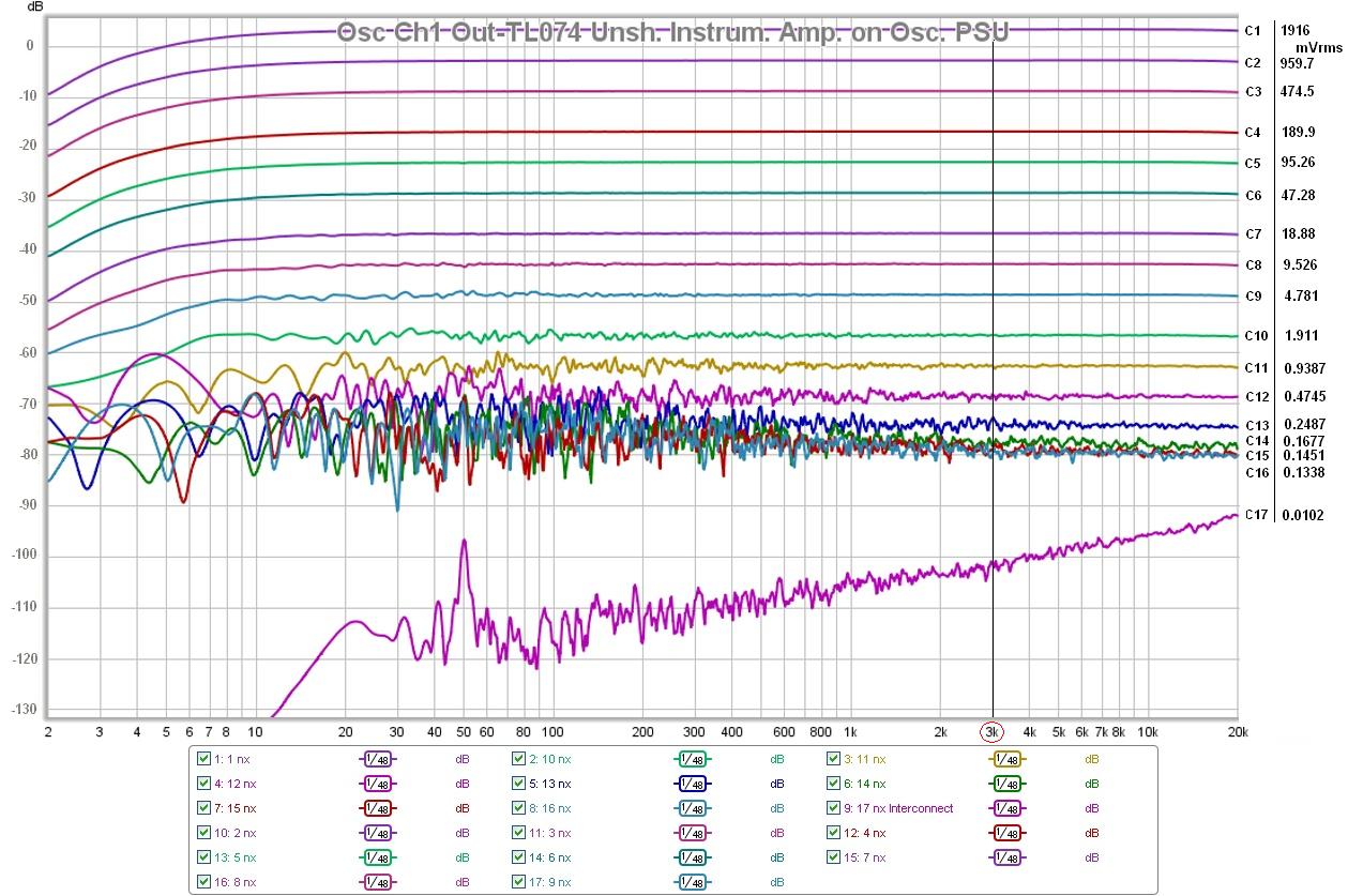

The next step was to power the TL074 circuit from the Oscilloscope PSU.
I found a convenient pick up point for +/- 12Vdc plus ground (att.1) and here we are.
Att. 2 &3 are measurements with the TL074 circuit powered from the Oscilloscope PSU.
They are noisier compared to bench PSU measurements (att. 5 &6 of post # 64).
Probably, the bench PSU is stiffer and cleaner.
Anyway, it is clean up to C9 curve. Therefore, all the bla bla of post # 57, is applicable here too. http://www.diyaudio.com/forums/equipment-tools/189545-implementing-y-out-oscilloscope-6.html#post2607115

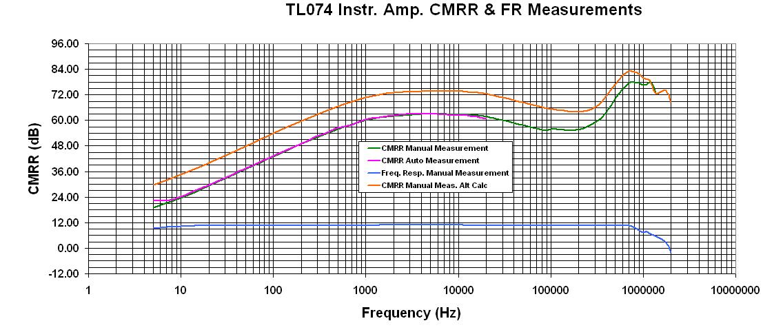

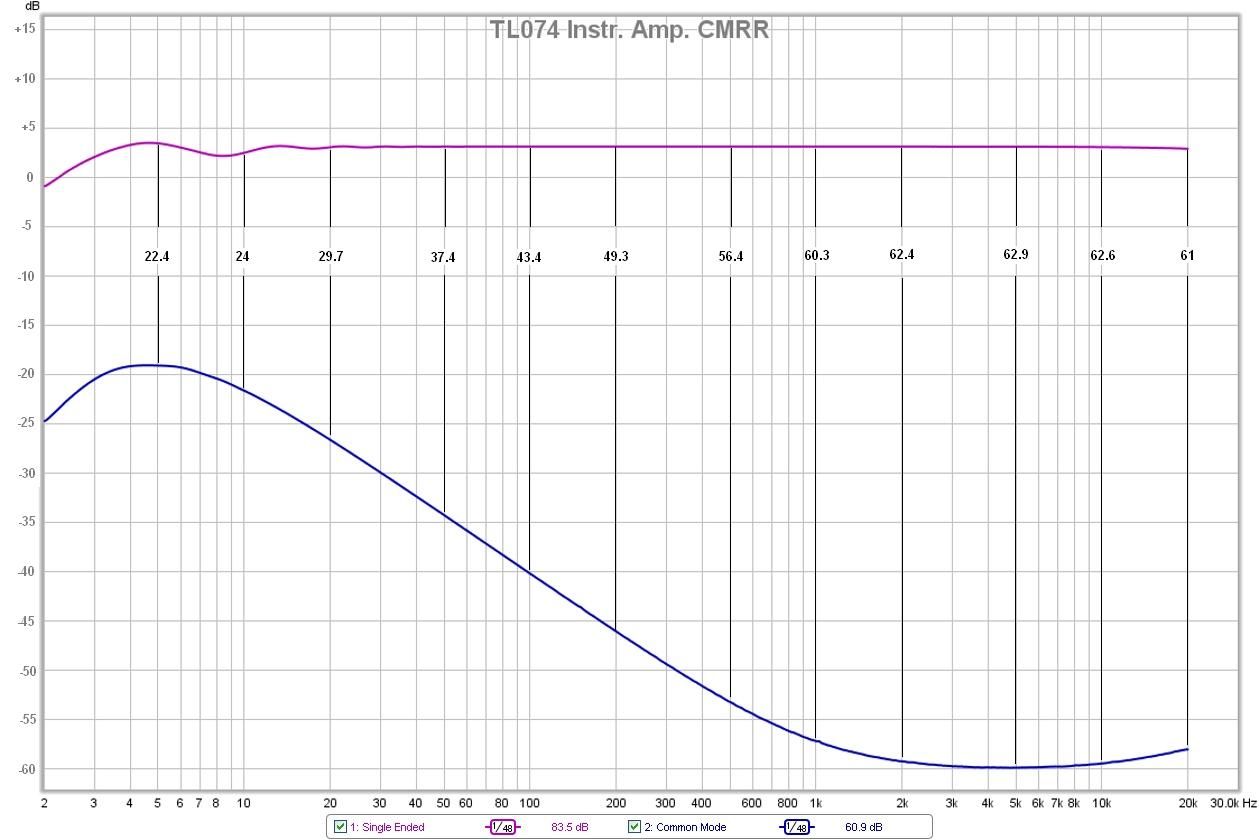

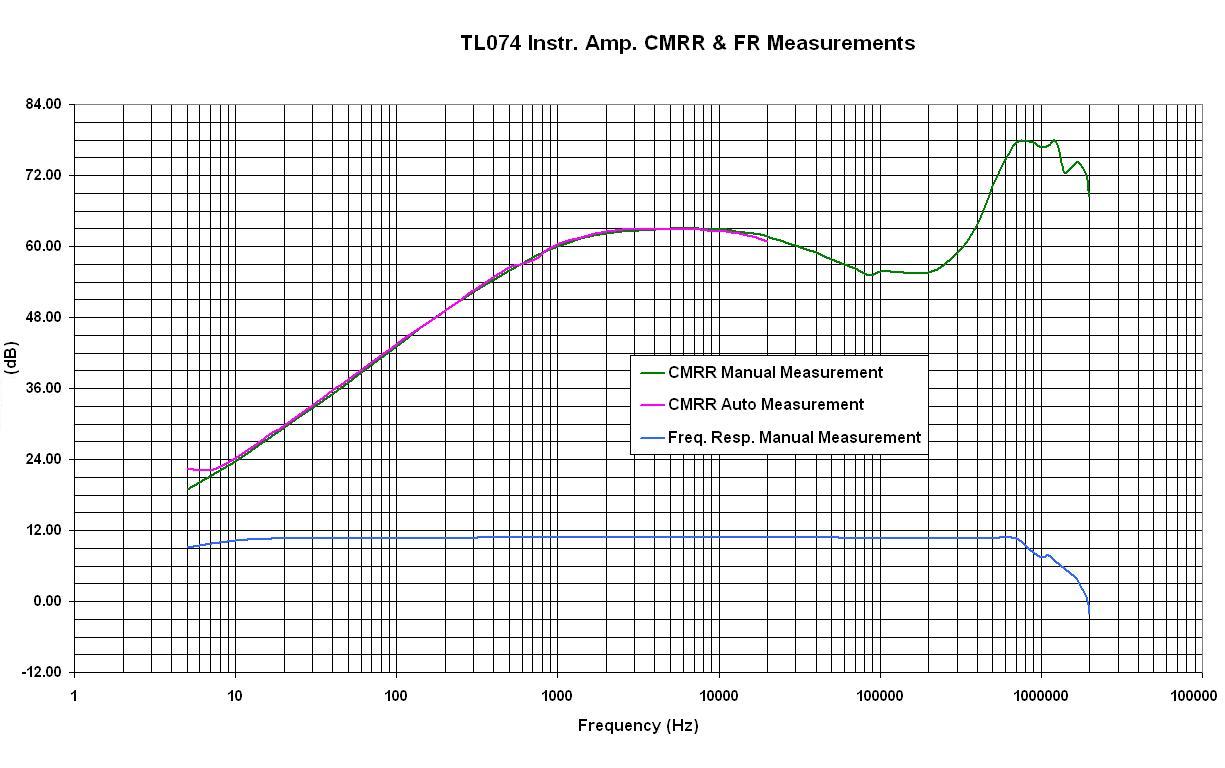

One more measurement that has to be done is the one to test the Common Mode Rejection Ratio (CMRR) of the TL074 circuit.
I did an auto (software assisted) measurement up to 20kHz. (att. 4)
As I wanted to see what happens above 20kHz, I did a manual one, up to 2MHz.
As you can see on att. 5, results from auto and manual measurements are in agreement up to 20kHz. This give me some confidence that measurements at the higher frequencies are valid.
(Note that both measurements are with the TL074 circuit in single ended input configuration, because both the soundcard as well as my signal generator provide only single ended output.)
The reduced CMRR at the very low frequencies, may contribute to the noisy curves.
Unfortunatelly, I don’t have a true instrumentation amplifier to test it against.
I would like to hear from any member that has an experience on CMRR / frequency variation with real (Special IC) Instr. Amps.
I finally put my SC preamp into a metal box. The reduction in noise was substantial.
I saw the measurements. Congratulations
Regards
George

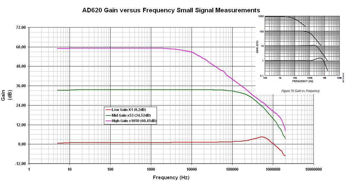

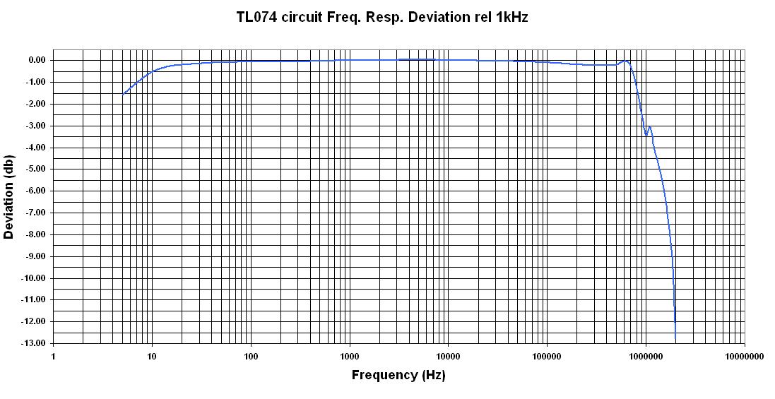

The frequency response of the circuit is also very impressive! flat out to around 600Khz!!

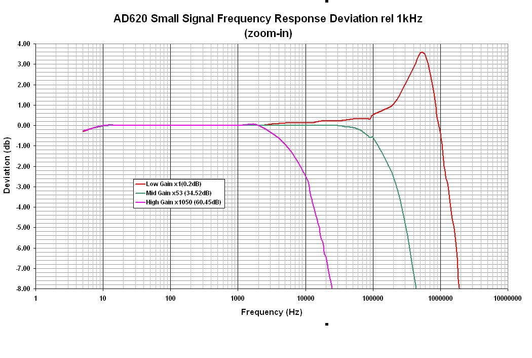

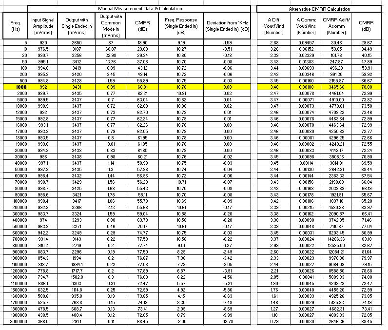

Almost! Att. 1 is a detailed view of the FR deviation relative to 1kHz response.
...how did you do this? checking the amplitude on the scope for stepped frequencies up to 2Mhz?
Yes. Att.2 is the data. More detailed at the HF range. 45 freq. points, 27 of them above 20kHz. 135 discrete measurements ( column 2,3 4) with the mV meter in parallel to the oscilloscope.
The rest columns are calculation results.

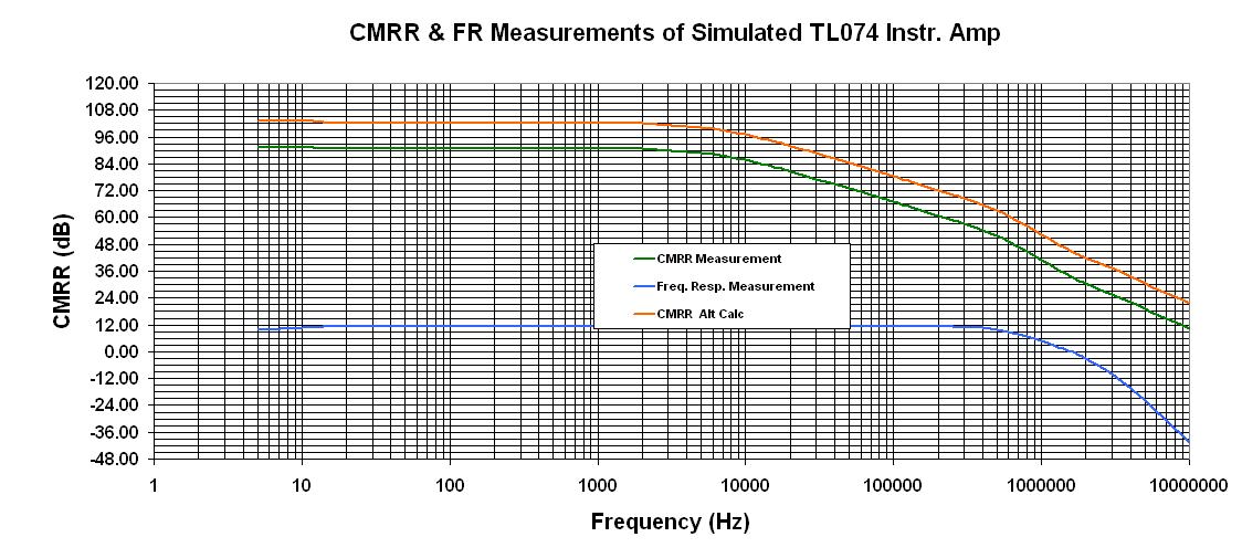

I feel uneasy with the CMRR results.
From what I have read, CMRR is normally high at low frequencies, dropping off as freq. goes up, the opposite from what I’ve shown.
Have I’ve done something wrong?

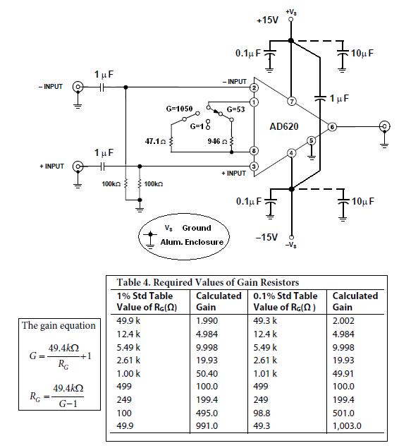

After reading this
http://www.y-kalsbeek.demon.nl/EC1_H2_0801.pdf
I did again the calculations (columns under the “Alternative CMRR Calculation” heading) and I drew a new curve (the orange one on att.3).
It has the same shape with the green one but it is displaced higher by the amount of the Diff. Amp. Gain.
This gain I had subtracted in the green’s curve calculation.
I don’t know which is correct.
But if gain in dB should not be subtracted, this means that the higher the Diff. Amp. Gain, the better it’s CMRR. I wish some informed member chime in

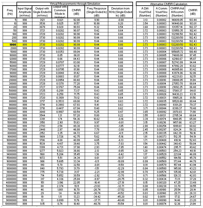

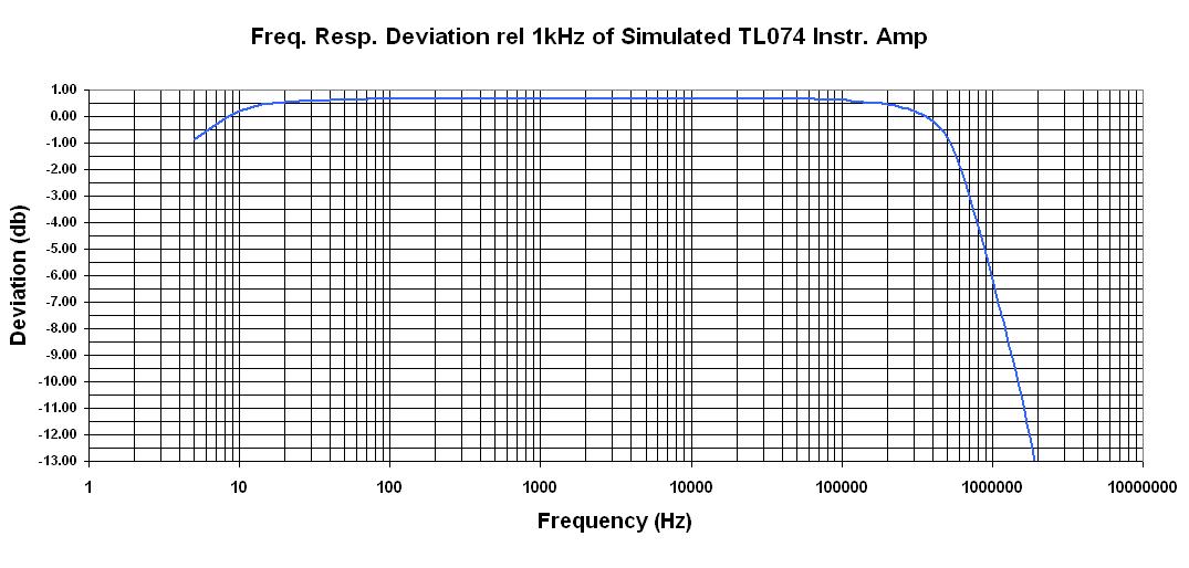

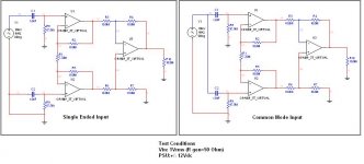

I simulated the circuit.
Using the virtual signal generator, Oscilloscope and AC voltmeters, I took the same measurements as with the manual measurements in the previous post (plus I extended the freq. up to 10Mhz).
In the virtual world, the CMRR curve looks normal.
The same calculation formulae were used as with the manual measurements.
It seems that the problem with the peculiar CMRR curve of the manual measurements has it’s origin on the noise of the very low output signal when the inputs are connected in Common Mode.

Quote from post #68
Attachment is from the link http://www.analog.com/static/imported-files/design_handbooks/5812756674312778737Complete_In_Amp.pdf
It answers both of my questions:
1. The gain should not be subtracted. Therefore, the orange curves are the correct ones.
2. The CMRR goes up with the gain.
It also points out that CMRR is a ratio, thus expressed as a number, while CMR is expressed in db.
Thus up to now I was wrongly using the term CMRR in place of CMR.
I did again the calculations (columns under the “Alternative CMRR Calculation” heading) and I drew a new curve (the orange one on att.3). It has the same shape with the green one but it is displaced higher by the amount of the Diff. Amp. Gain.

Yes they are all very helpful the comment about SY made me laugh harder than I have in a long time
Glad you worked out the situation with the CMR vs CMRR (and which calculation was right) I knew what the acronyms stood for but that was about it

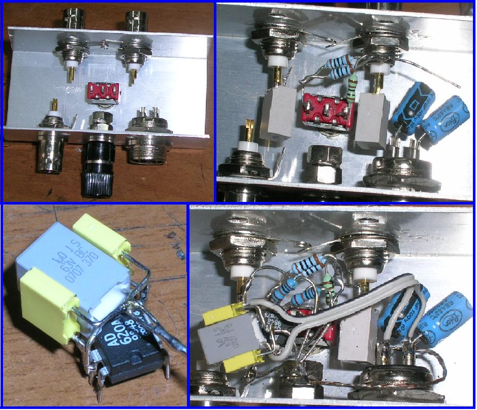

I decided to build an one IC (AD620AN) Instrumentation Amplifier http://www.analog.com/static/imported-files/data_sheets/AD620.pdf
AD620 is the only Instr. Amp. IC I found locally. It costs 5.3 Euro plus VAT
I housed it in an aluminum enclosure, for to do descent low level measurements on it.
If it will perform satisfactorily, it will be be used as a stand alone unit.
DC power supply is provided through a 4 pin plug.
Three gain steps selection is through an On-Off-On switch.
Below you’ll see the schematic and the first measurement

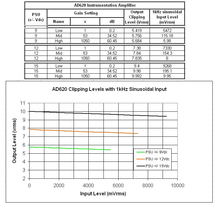

I did some initial overload measurements with 1kHz sinusoidal Input signal.
Fate has it, this to be my first amplifier implementation which has a variable (stepped) gain.
Therefore, this is the first time I noticed that slew limit varies with gain.
Although I trust intuition, it is not enough to deal with the subject.
Some deeper understanding is required.
So, before posting what I’ve done so far, here is a 3 part article dealing with Slew Induced Distortion (SID), which was an eye opener for me.

Here is the "Gain versus Frequency" manual (45 freq. points) measurement up to 2MHz. At the upper right corner, I've dropped in the same measurement from the datasheet.
Then, is the deviation from 1kHz response.
Signal Input: 1mVrms sine wave
PSU:+/-15V
Output dummy load:10kOhm
PSU:+/-15V
Hi George, It looks like you have been busy!! Once again nice dead bug work!
I haven't looked at the slewing articles yet, but will have to do so. So many things to learn! The measurements showing the frequency response changes with gain are very telling! This is what you were telling me right back in the beginning when I was thinking of upping the gain on the LM324!!
Looks like your results pretty much match what the datasheet shows too!
Tony.
Tony.
