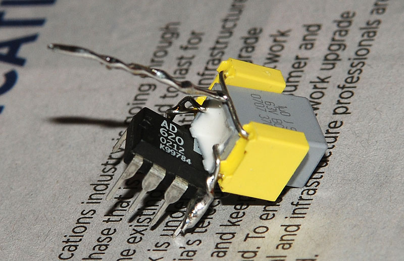

I decided to build an one IC (AD620AN) Instrumentation Amplifier http://www.analog.com/static/imported-files/data_sheets/AD620.pdf
AD620 is the only Instr. Amp. IC I found locally. It costs 5.3 Euro plus VAT
I housed it in an aluminum enclosure, for to do descent low level measurements on it.
If it will perform satisfactorily, it will be be used as a stand alone unit.
DC power supply is provided through a 4 pin plug.
Three gain steps selection is through an On-Off-On switch.
Below you’ll see the schematic and the first 😀 measurement

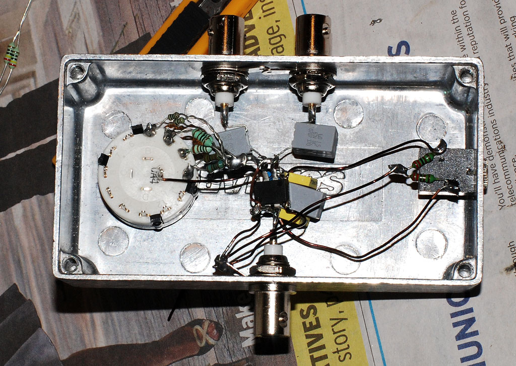

Hi George, I finally started today. I'm going to have to get myself a small aluminium box and a switch and I should be set. I think I'm going to run it off a 12V battery (same one I use for the original preamp. I'll just put a voltage divider to get +-6V I think it should be ok since the AD620 only draws 1.3mA!! I wasn't sure why so many resistors, but I could see that there were at least enough for 50 X 100 X and 1000 X gain and possibly some other values.

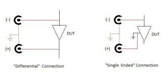

The only thing I'm not sure about is using two bnc's for the input + and - I'm not that familiar with using opamps, and don't really understand how that is to work. do I only use two inputs when looking at the difference between two signals or is it for balanced input? sorry for my stupid question 🙂
anyway here is a picture of the first steps 😉 familiar but not quite the same 😉

OK I've slept on it, and figure the way to use the two inputs is to only use the hot of each for connecting to the circuit under test, and only use the sheild on the box end. +ve one to the point of interest, -ve one to the zero volts or earth of the circuit under test. I guess this should remove the possibility of any ground loops between the DUT and the device which is taking the output. 🙂

I've finished the instrumentation amp tonight 🙂 I haven't actually tried it out yet, but I did perform a rudimentary health check. I hooked up the battery (which needs a bit of a charge) and checked for dc offset on the output with the multimeter set to 200mV DC. My voltage divider is not giving totally symetrical readings, but it is pretty close.
1X 0.0 mV
10 X -0.1 mV
50 X -0.8 mV
100 X -1.6mV
1000 X 16 mv
So it looks like the gain settings are pretty much spot on (except for 10X which I was expecting because my resistors didn't work out exactly to 5.49K.
It would appear that I have about -16uV offset on the input. Measurements were taken with both inputs floating.
here is a picture of the guts 😉
Getting too late tonight to try and measure something tonight, but soon 🙂
Edit: power input is a bit dodgy in that I used a stereo 3.5mm jack, reason being I couldn't find an insulated dc socket (I need to keep the -ve of the battery floating and the virtual zero volts tied to the case).
Tony.

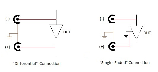

Hi Tony
Sorry for my delayed answer.
You've done a great construction. A very good alum. housing too.
About your question on how to connect the two inputs, you are correct. You can use the "differential" mode , as well as the "single ended" connection (see attached sketch).
Have a look at the AD 620 data sheet. If I remember well, the (-) Input is less noisy than the (+) Input. If this is so, the (-) Input should be connected to the weaker signal when you use the "differential" connection When you use the "single ended" connection, the (-) Input should be connected to the "hot" signal and the (+) Input to the GND.
Keep on working (and walking 😀 )
Regards
George
