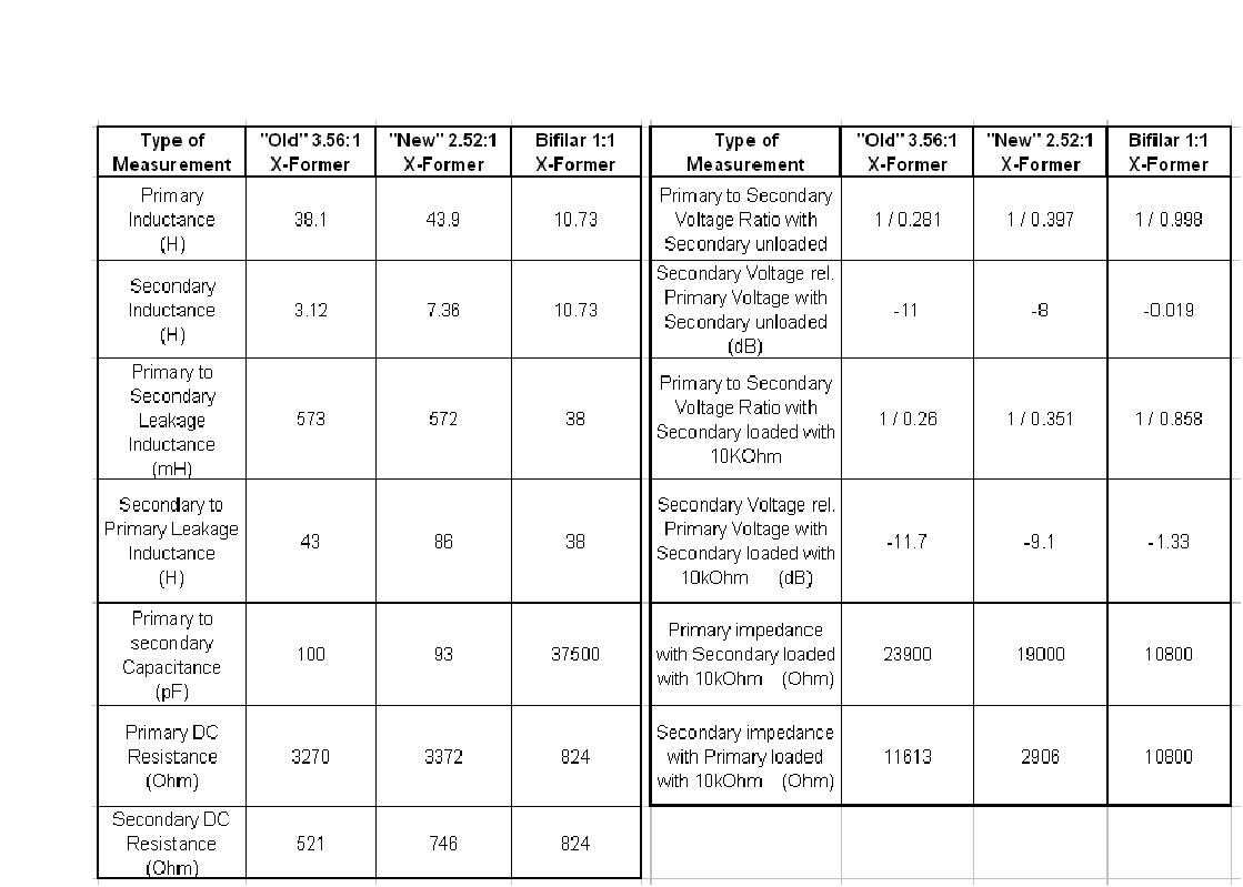

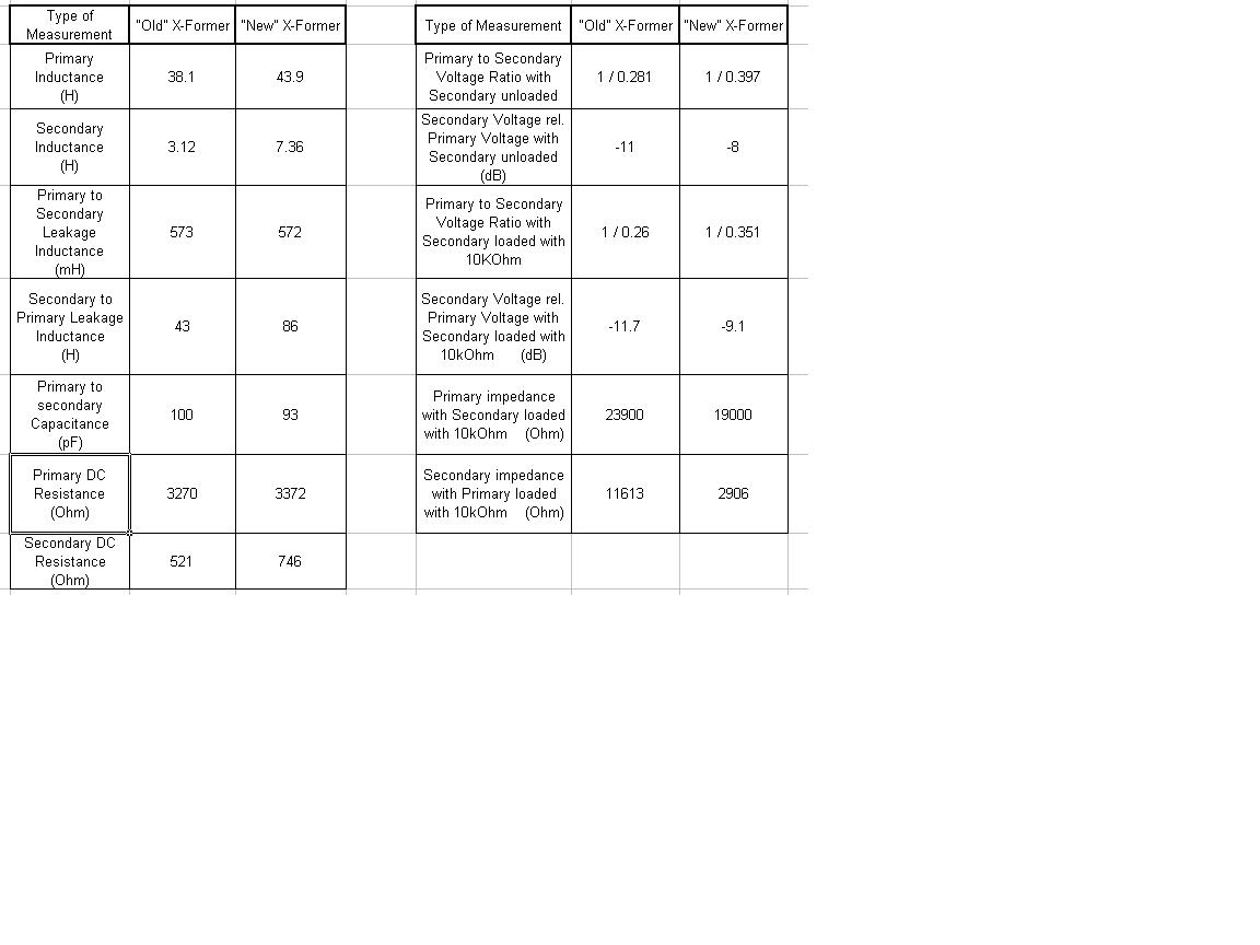

I should have responded to Tony a few days back, but I was carried away the last 4 days by many manual–some unnecessary-, semi and fully automatic measurements from two X-Former (self made) implementations of the Symmetric to single ended idea for the oscilloscope “Y Out”.
I have some very small (30mmx25mmx21mm plus 6mm for connection pins) 220Vac/7.5Vac E-I power (core is 12.5x10mm) transformers bought for experimentation.
The first one was built just to see what comes out by unwinding the 7.5Vac secondary (outer winding) and keeping the primary as is. I name this X-former as “Old”
Then, I built a second one, this time with as many secondary turns as the coil window allowed (primary kept again intact). I name this X-former as “New”
After measuring both, it was found that that the two primaries were not identical.
Measuring apparatus used:
Inductance digital meter: Honeytek H623
Capacitance & Inductance digital meter: Mastech MY6243
Function Generator: Hameg HM8030-3
Bench Multimeter Keithley 175 (with 150MHz (X1) probe
Resistanse Decay Box: General Radio 1434-N plus a single 10X10K General Radio Cylinder.
Attached is the result of manual measurements.
I hope to continue tomorrow.
Regards
George

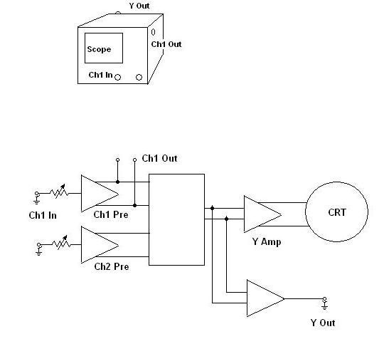

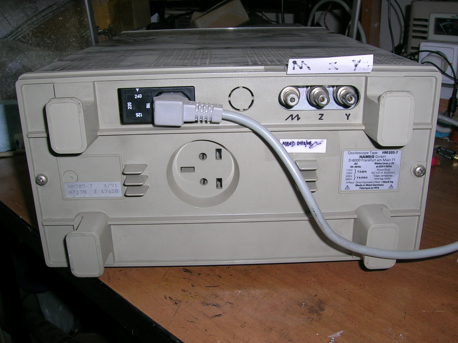

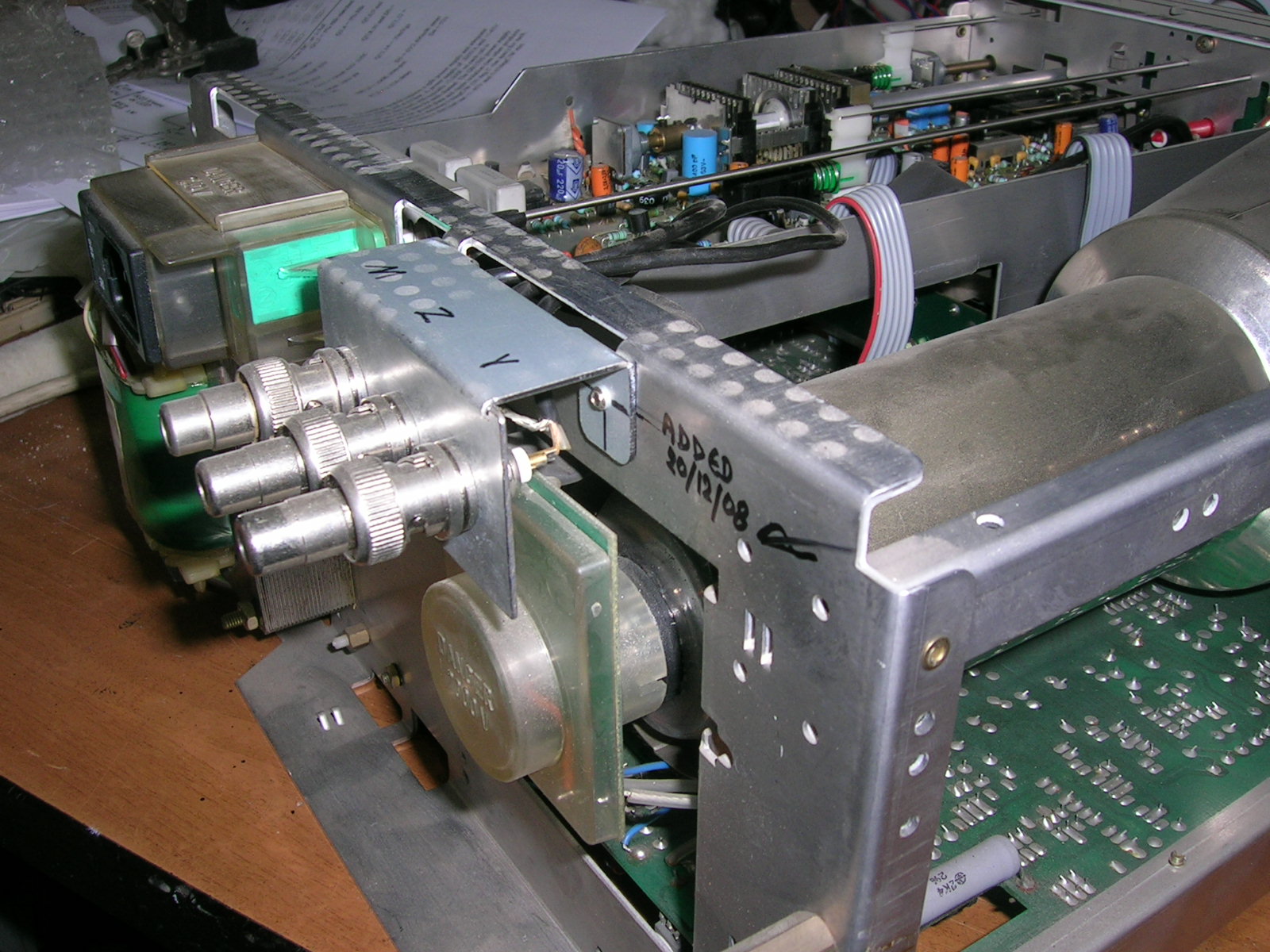

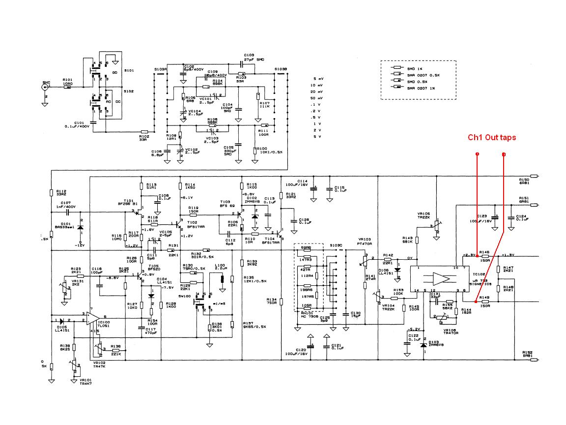

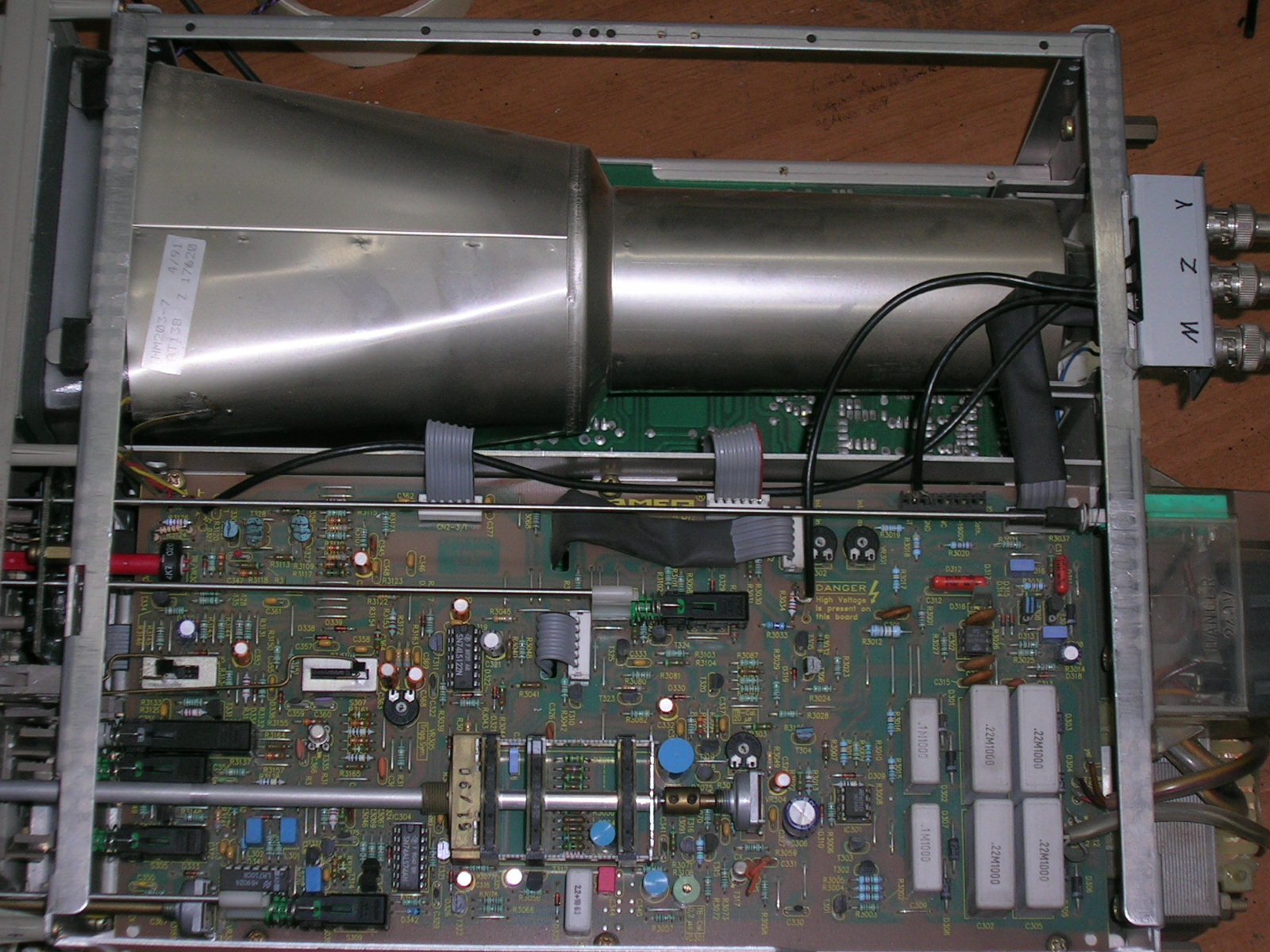

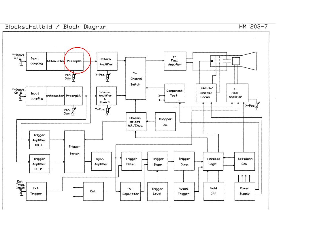

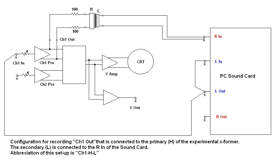

Now, here is one form of “Case 1” implementation of the “diy Y Out”.
This is implemented by using the diy x-former as the “differential to single ended converter” by connecting one coil of the x-former to the output of oscilloscope’s Ch1 Preamplifier Out and the other coil used as the single ended “diy Y Out”.
My oscilloscope (Hameg HM203-7) has already a “Y Out” . This, although I installed myself, it was actually per manufacturer’s specs and drawings (the pcb had the tracks ready, only the components were missing). It is not a great lie to say (for the economy of the discussion) that this “Y Out” is “manufacturer’s implementation”. :)

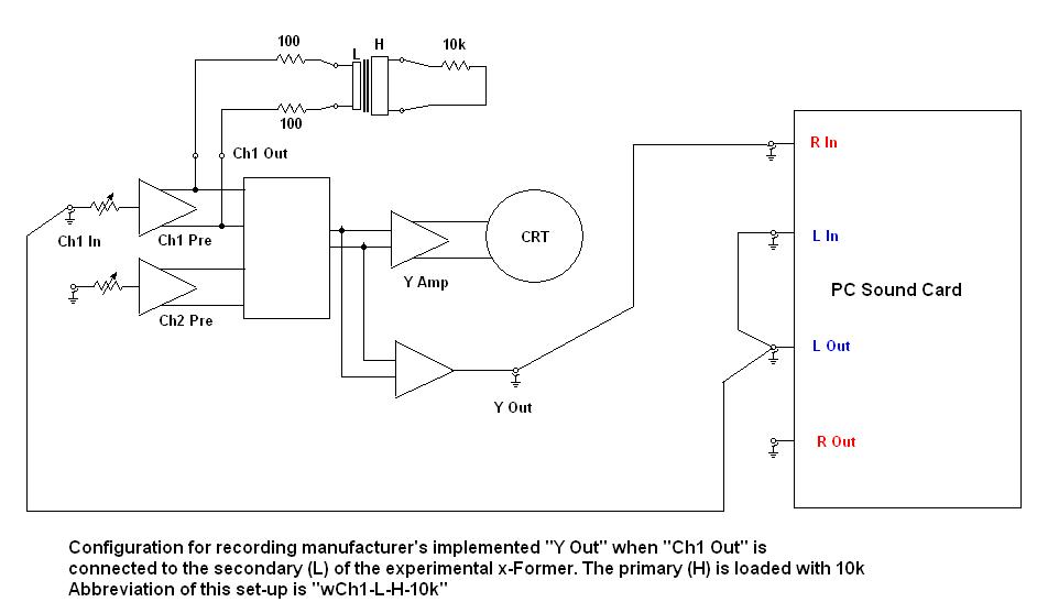

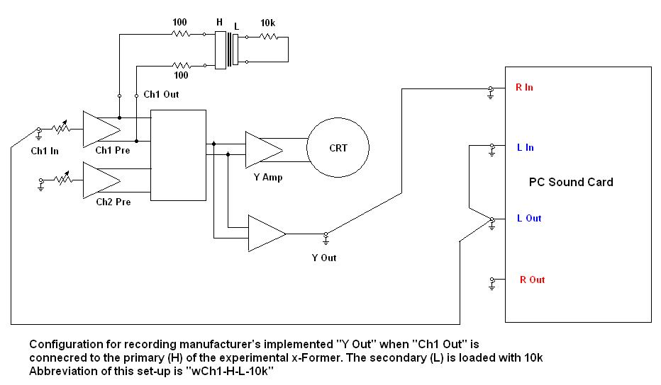

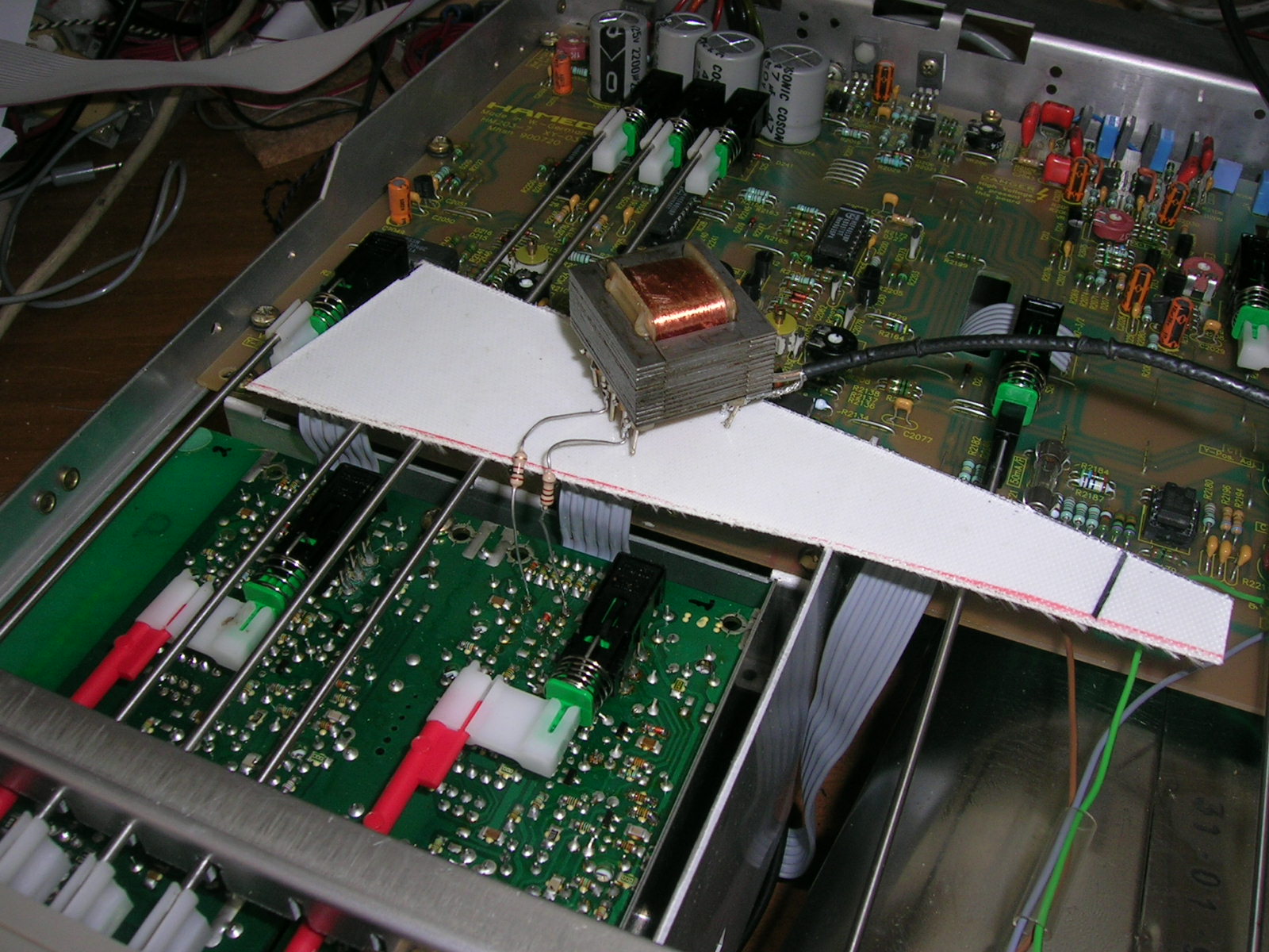

Having this “Y Out”, it is quite convenient to check how this x-former idea performs and if it degrades the performance of the oscilloscope when it is connected to the Ch1 Preamplifier Out.
So I opened up my oscilloscope and started testing.
The first set of tests had to test for possible degradation of the oscilloscope performance, when the x-former is connected to the Ch1 Preamplifier Out.
In the attached figures you’ll see what configurations were tested.

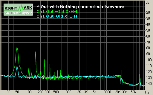

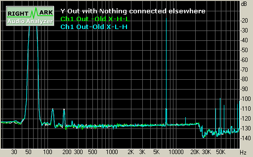

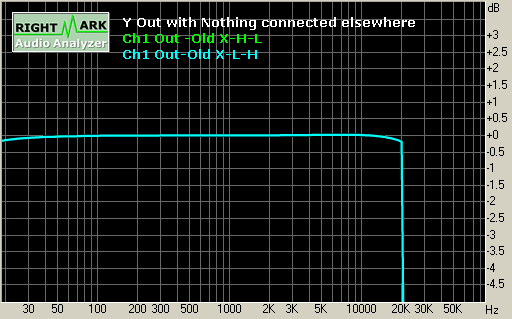

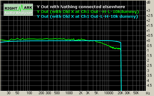

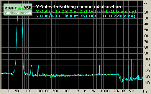

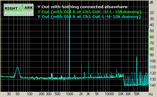

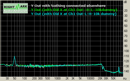

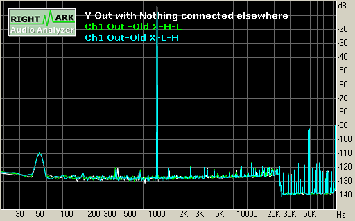

Joined 2002
These are with the "old" x-former.
First att.:frequency response
Second att.:Intermodulation distortion (60Hz & 7kHz)
Third att.: Noise
Forth att.: Total harmonic distortion

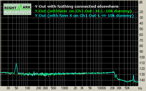

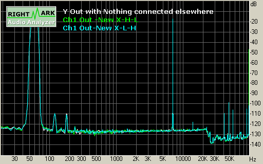

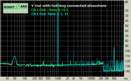

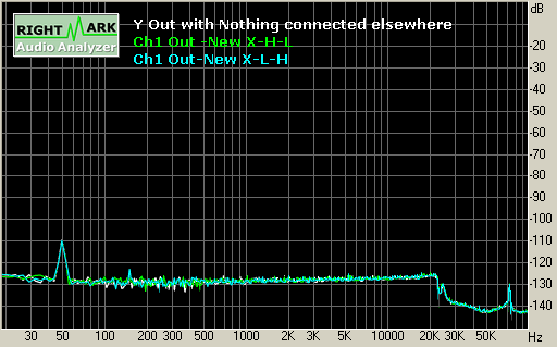

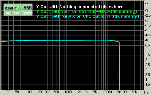

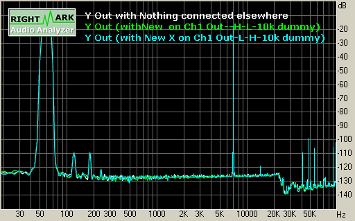

Joined 2002
And these are with the "new" x-former.
Third att.: Noise
It is really late. I hope I'll be here tomorrow.:)

Just another Moderator
Joined 2003
Hmmm big difference with the "new" transformer George, at least on the H - L orientation! It looks like it has minimal impact on the performance.
I'm not 100% clear on what you did with the old and new... old you reduced the number of turns on the secondary, and new you increased the number of turns on the secondary? Looking at how fine the wires are it must have taken a while!!

The “new” x-former seems to perform better. You will notice this on the following measurements.

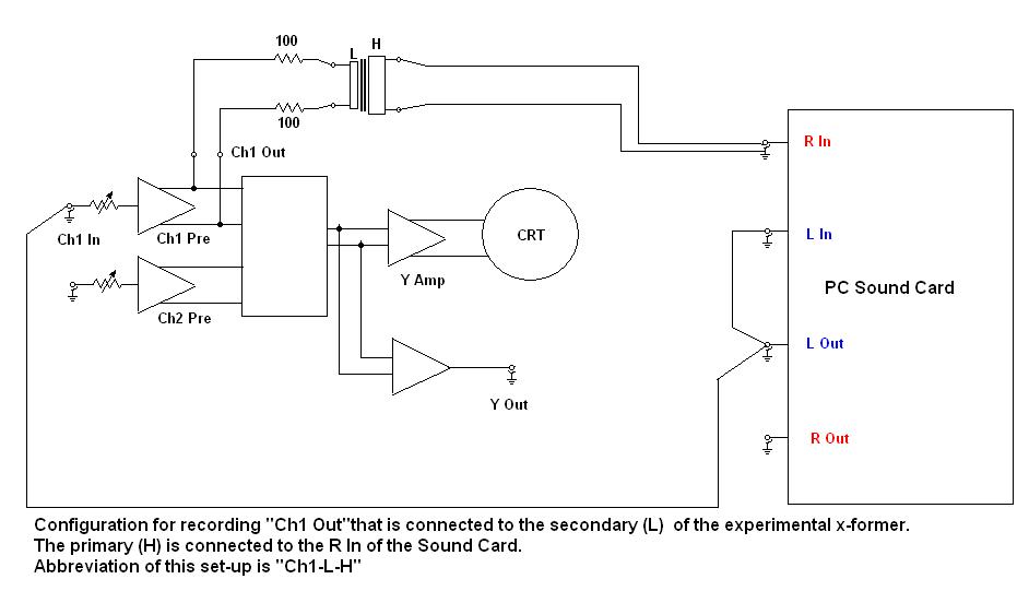

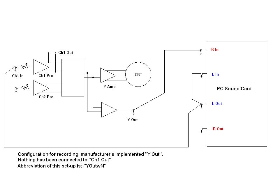

Now, the x-formers are used to feed the R In of the soundcard. Their output is compared again to the original “Y Out”.
Edit: My Sound card is an external "M-Audio Audiophile USB"
All recordings here are 16 bit, 192kHz

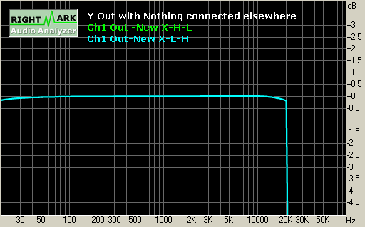

Joined 2002
“Old” x-former
Third att.: Noise

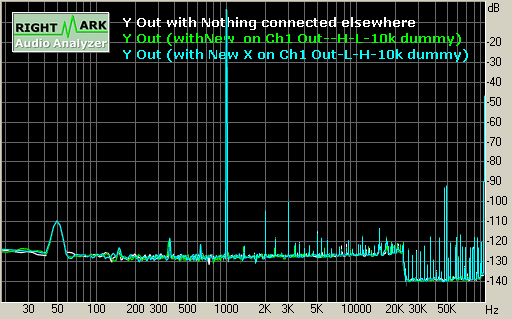

Joined 2002
"New" x-former
Third att.: Noise

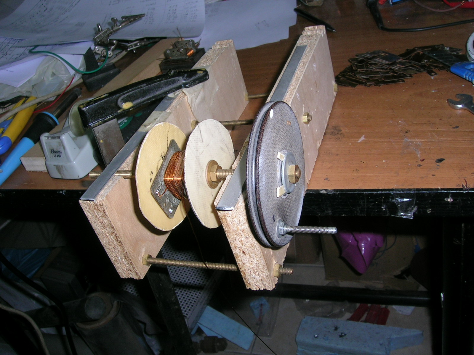

Joined 2003

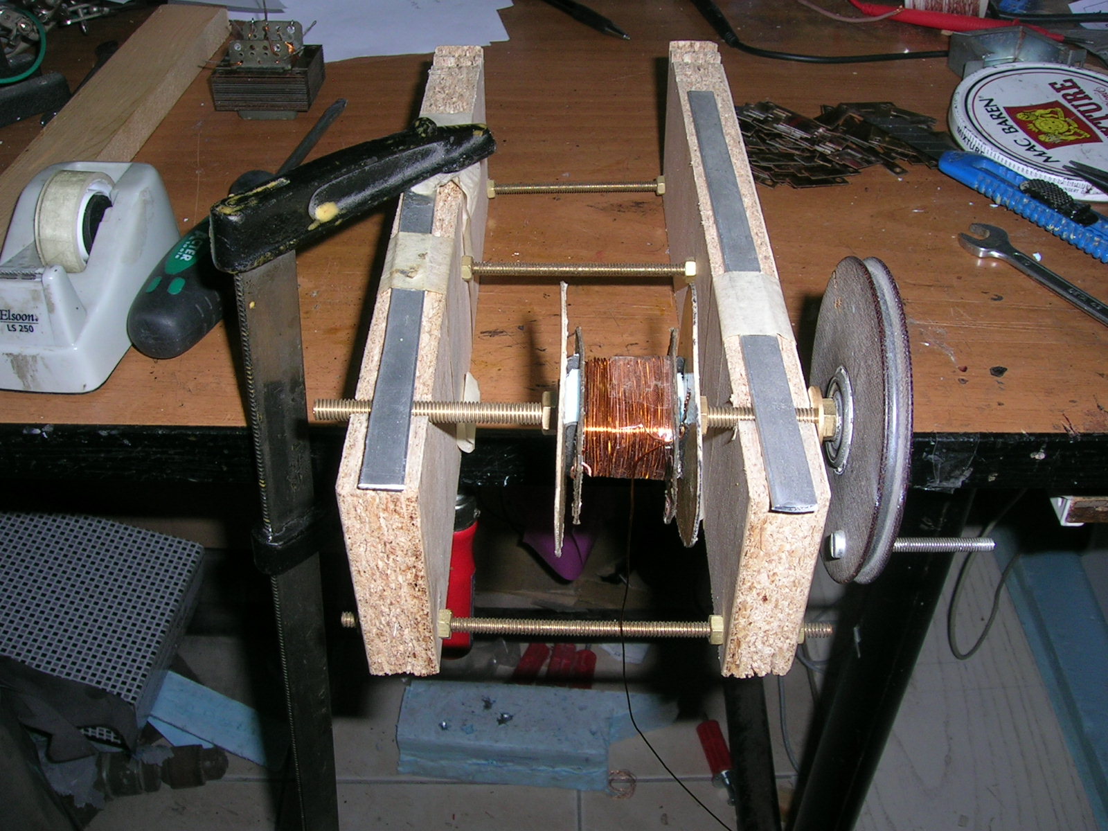

Hi George, I saw it along with about 6 others I got that day, some of the others were a bit of a surprise (in a different way to what yours was ;) ) and I've been a bit distracted for a few days ;) I'll return it now, I just completely forgot, I'm terribly sorry about that!
I like the transformer winding jig, simple but functional :) I've got to get myself some wire and wind some coils for my speakers, I hadn't yet worked out how I was going to do it, but now I at least have an idea ;)
The orientation of the transformer really makes a big difference to the Ch1 out with the old transformer, but with the new one the difference is minimal, does the new one have a 1:1 turns ratio?
Tony.
Joined 2002
Tony, I have no equal when it comes to forgeting :D No reason to be sorry.

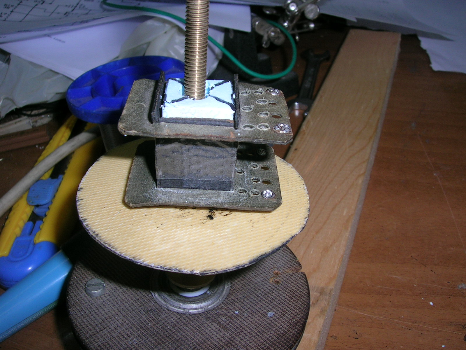

Thanks. I built it from scratch in an argent need to unwind-measure turns-rewind a burned out radio output transformer. It has provided a lot of service to me since then.

Old is 3.56:1
New is 2.54:1
But I already wound a bifilar 1:1 (same core as the previous two). Measurements are in progress.:)

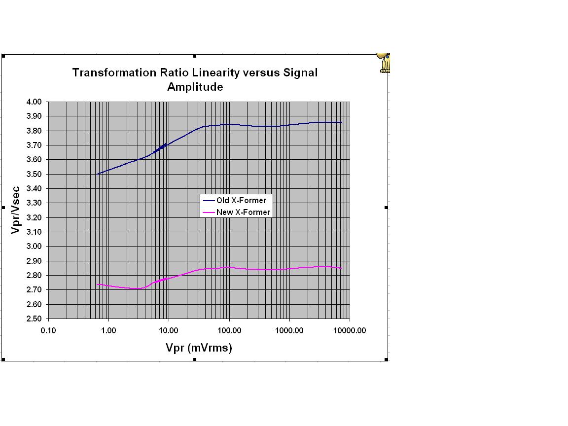

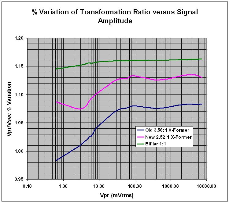

As I wrote above, I wound a third x-former using a same core.
This time primary and secondary were wound simultaneously (bifilar).
Turns ratio is 1:1. Each of them consists of 3110 turns on 66 layers.
Winding time 2 hours :D
Attached below are the results of manual measurements.
Two encouraging observations.
The –6db HF roll-off is at 250kHz and no resonance up to 2MHz, which is my signal generator’s limit. (This is not shown in the attachments.)
The Vpr/Vsec linearity versus signal amplitude is much better than the previous two x-formers.

Much more linear! also interesting is the primary to secondary capacitance, MUCH higher, I guess that is due to the bifilar winding the two wires together would be making one very long capacitor ;)
