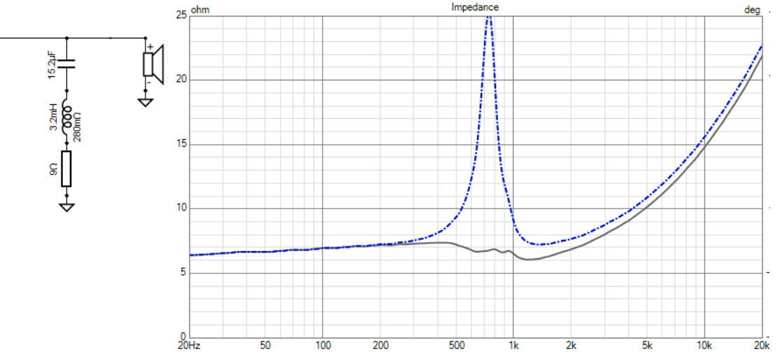

Some measurements. First, using the German filter posted here (I don't think the original is available online anymore):
I copied it blindly to save myself any nasty thinking, & it sounds OK, but measuring the drivers after not using them for a couple of years found the Fs is ~ 100Hz higher than factory specs so want to see If I can make any improvement.

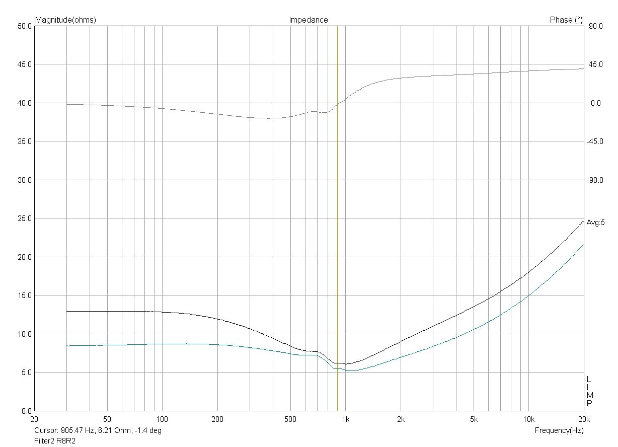

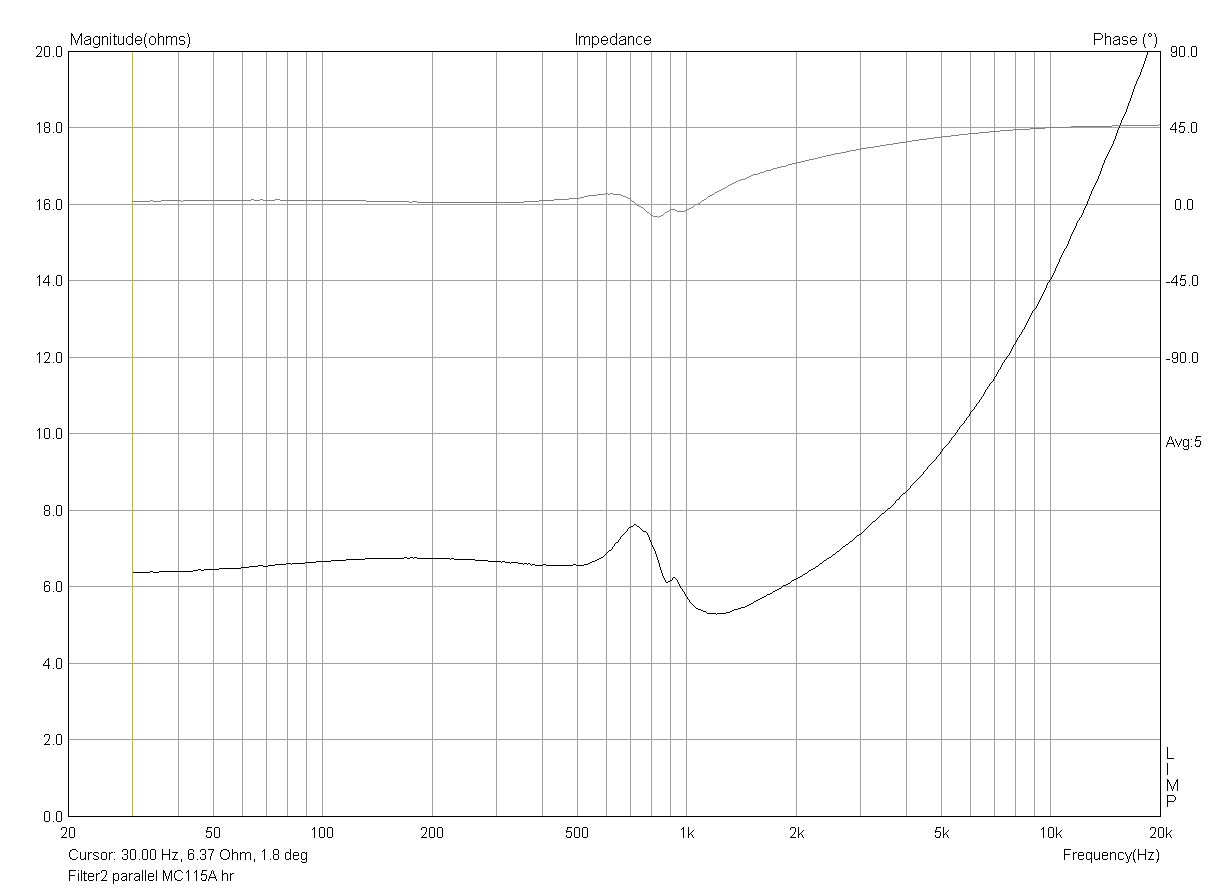

Next, cobbled together a simple 2nd order xover with parts on hand (3Mh & 12.3uF). It will need to be tweaked, and the cheap clip cables I used measured .97 ohms, so they would have affected the results.
First, connected in parallel config, and then with 10 ohms across the driver:
