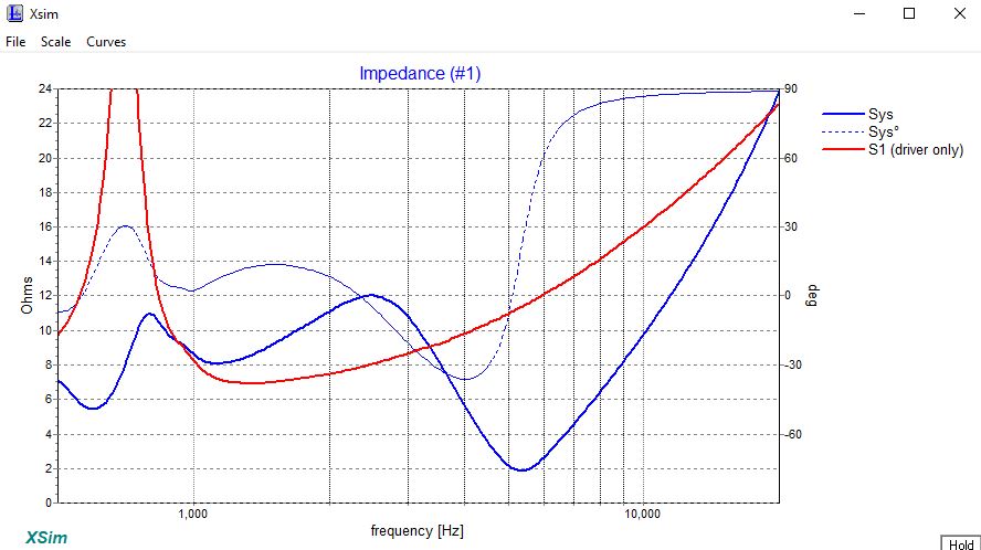

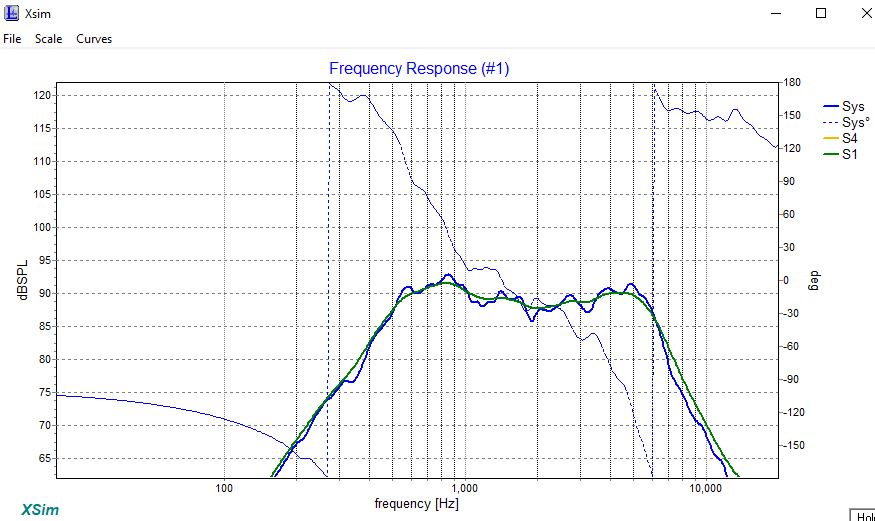

My own DATSv3 measurements don't line up with the spec sheet I found above, both drivers measured very closely.
My results are:-
RE=6.131
Fs=727.4hz
Qts=1.49
Qes=1.883
Qms=7.146
Le=0.2372

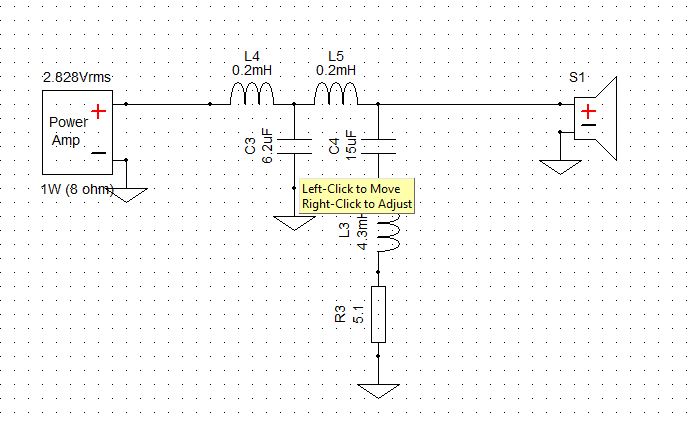

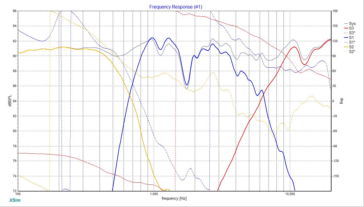

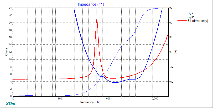

I've attached screen caps of xsim and the .frd and .zma files
How can I flatten this out?
Thanks in advance.

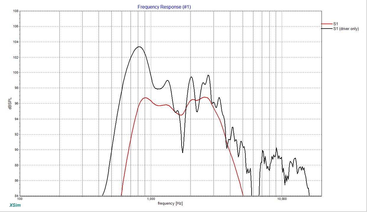

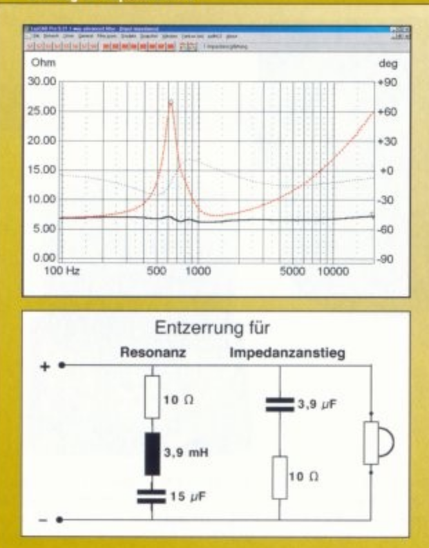

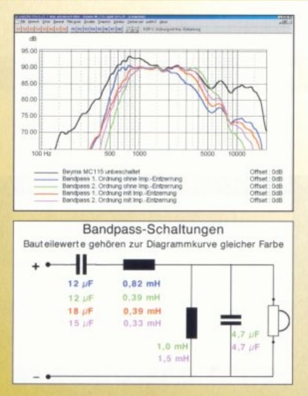

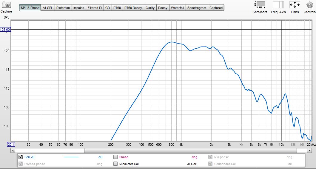

Here's a closer ( more permanent ) look at portions of that file.
attachment.php
The black line is unfiltered (raw) response.
attachment.php
BTW; ( lawofohms ) I don't think your ( zipped ) .zma file is very accurate.
- It doesn't match the one you've show within your first post ( the red line showing a minimum of @ 7 ohms in the bandpass).
925937d1614218022-help-crossover-beyma-mc115-2in-dome-midrange-xsimz-jpg
vs ( what you posted in your zipped file shows a minimum of @ 5 ohms )
attachment.php

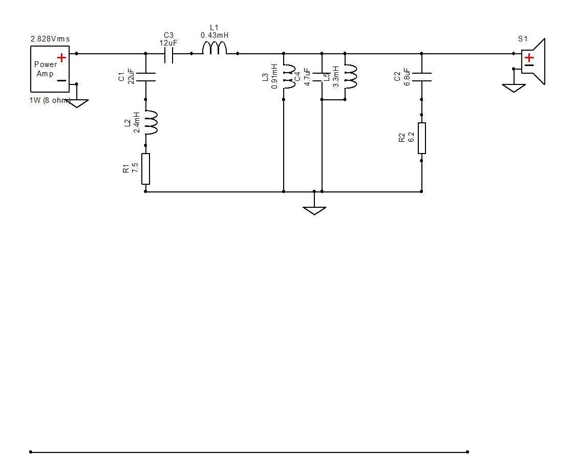

Thank you, everyone. I make adjustments to the simulation circuit. I adjusted values to match my measurements.
I smoothed out the response to ~2db ripple. but the bandwidth is narrow, well I think it is narrow or is this normal for a dome midrange.
These seem hard to control and require a lot of components.
Why are dome midrange like these used? they don't seem to be too common.

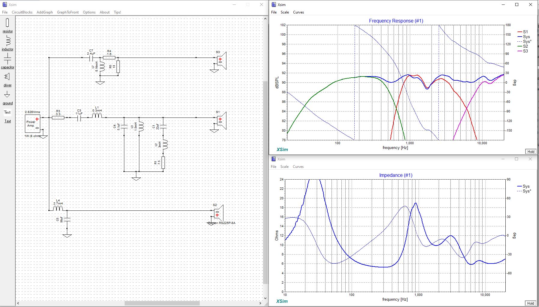

try putting the impedance compensation network on the other side of the crossover.
They aren't used much because there aren't many out there, which makes them expensive, which makes them not used much, which keeps them expensive etc, etc....
Displaying this way allows you to see phase, not of the system but of each driver. You can see when they work together or cancel, how the slopes compare and other things.
Keep in mind we're only working on one axis, but it's a start.
