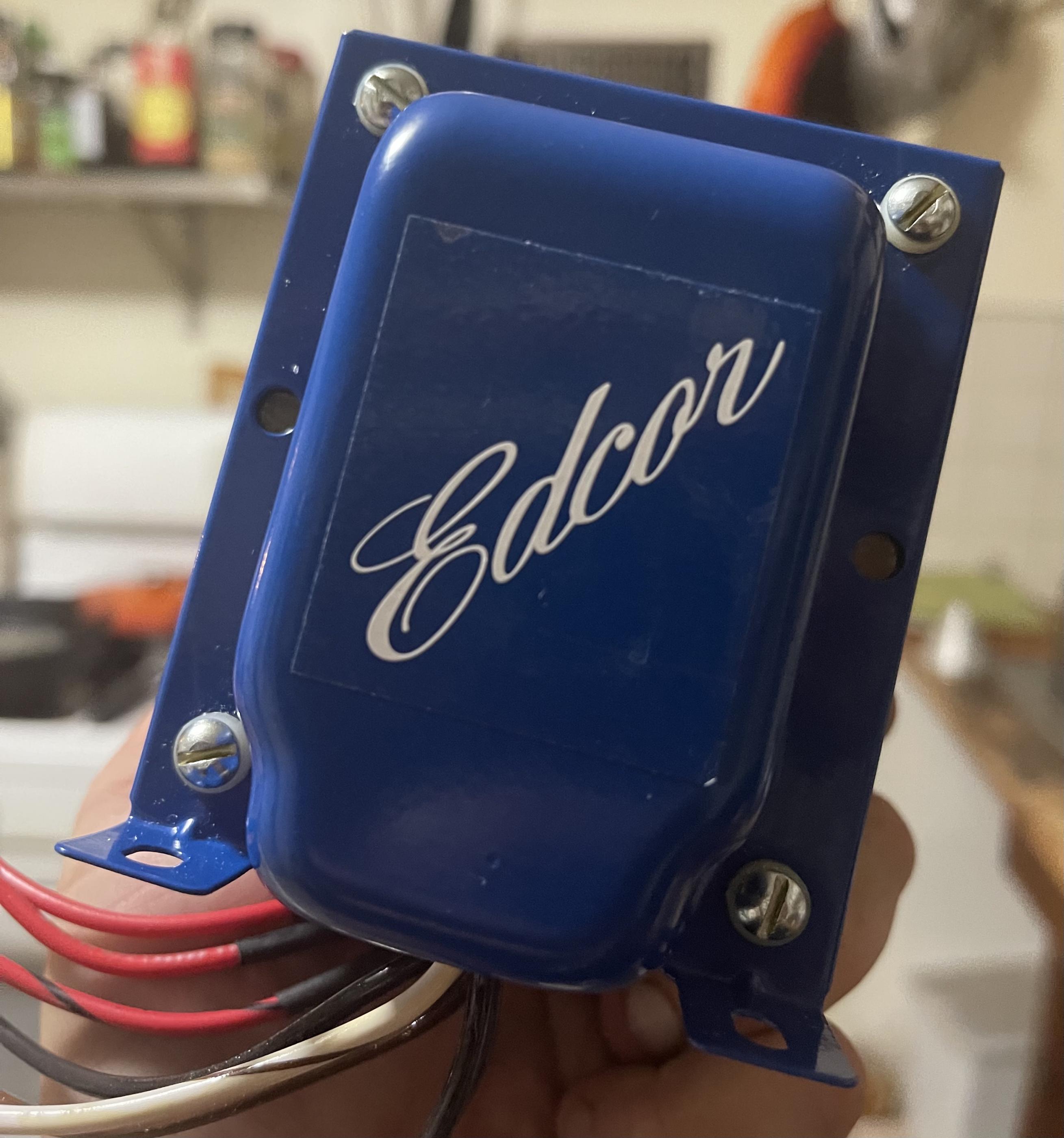

The 5 V is nothing. Also consider that the larger core and higher quality steel lowers the flux density, making a quieter transformer. Over sizing the power transformer is always a good practice in tube gear. So buying exactly what you think you need, you may be shooting yourself in the foot. Within reason of course!
-Chris
-Chris

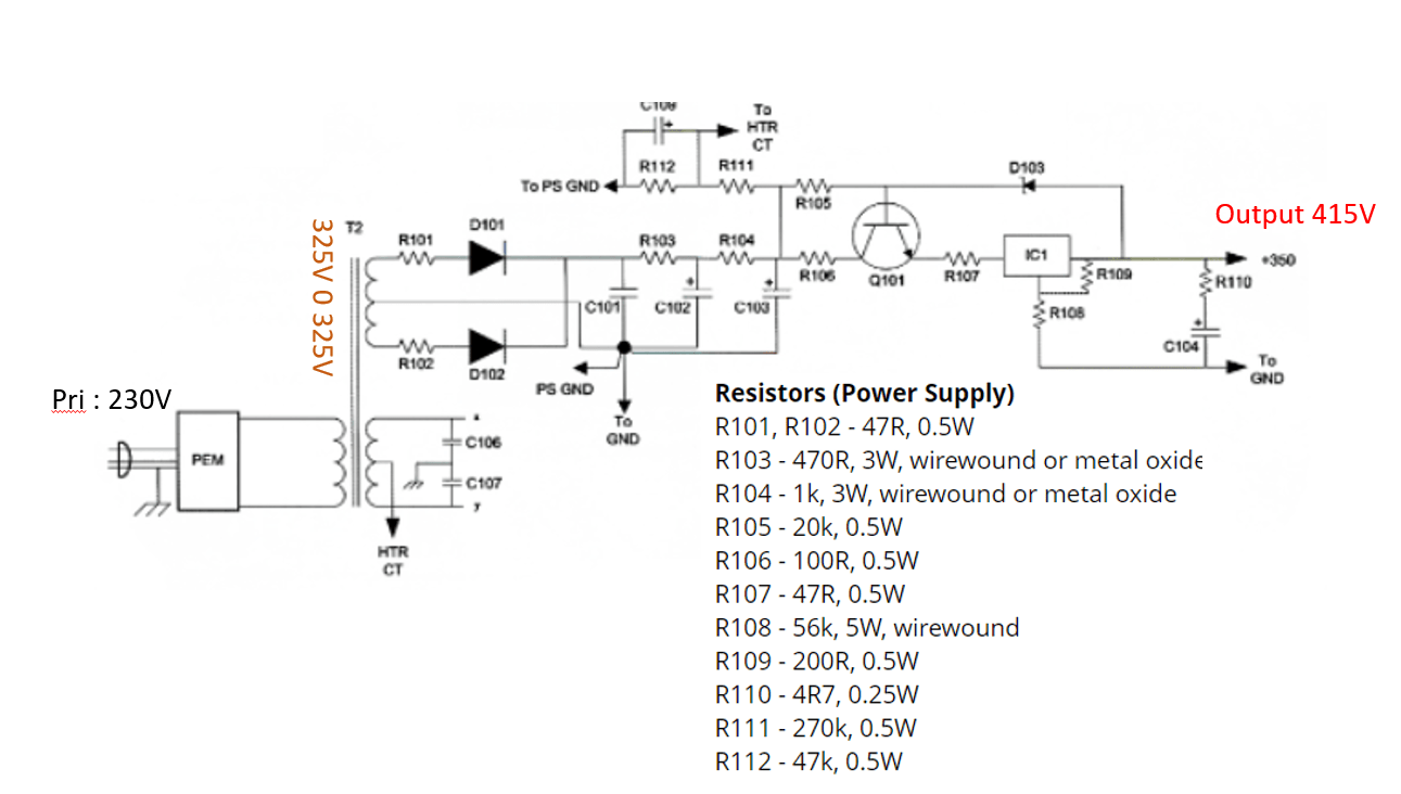

The specified TX from the impasse article is: 325-0-325V @ 40mA; 6.3VCT @ 2.0A
The Hammond 290CX is 325-0-50-325V @ 207mA; 5V @ 3A; 6.3VCT @4.5A and weighs 6.8lbs. Prices range from $80-100USD before shipping.
The Edcor XPWR051 is 330-0-330V @ 125mA; 6.3VCT @ 4.0A and weighs 6.0lbs. Price is $61.91USD before shipping.
The Edcor XPWR268 is 325-0-325V @ 150mA; 6.3VCT @ 4.5A and also weighs 6.0lbs. Price is $62.42USD before shipping.
I decided to set the Hammond aside for use with my Tubelab SE (which will actually utilize the 5V winding) and ordered the XPWR268 because its VA rating was higher than the XPWR051.
Great to hear that. The B+ of the Hammond is a bit high for my intended use of 45 tubes but I would like to change the power supply of my Tubelab SE to choke-input and hopefully that will eat up some of the surplus B+. Otherwise, the Edcor I selected seems sufficiently overspec’d for the Impasse.
Don't be too concerned about the higher B+. It won't hurt you. Back in the days of tubes, voltages were easily 20% from the stated value, and the test equipment they used wasn't a whole lot better. B+ measurements might have been 5%, but the AC supply varied a lot more than that. Your Edcor will be fine.

They're specified as ceramic discs. Not sure why they have to be rated so high voltage. Maybe good practice incase of catastrophic tube failure or something. I think there's about 60v on the centre tap with a fairly low ac current on the heaters.
The purpose of these caps is to remove high frequency noise.
0.01uf (10nf) is pretty small, so 0.047 would mean it would filter a bit lower.
A quick Google suggests the typical working resistance of a heater element is 80ohms,so
Cutoff freq = 1/(2pi*rc) which for 80 ohms and 0.00000001f is about 200khz.
If for three heaters in parallel, say 20ohm then your 0.047uf would have a cutoff around 170khz.
I see no reason why, value wise 0.047 would be an issue.
Is it ceramic caps you have of this value?
I can't see any reason why film shouldn't be used. I'm guessing that cost would be the most likely reason.
They have the voltage rating required and x or y caps havnt been specified here.
Thanks for the input. I have film caps, but I, too, can't find a reason film won't work. I'm just trying to avoid a mail order for nothing but a couple of caps.Is it ceramic caps you have of this value?
They have the voltage rating required and x or y caps haven't been specified here.
Finally got my Edcor XPWR268-120 power transformer for my imPasse today.
