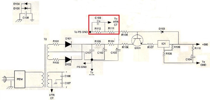

Hi John,
Sorry for dumb question, are R111, R112 and C109 the "heater lifter"?
I used your Maida regulator board and until now this still works well.
Roland

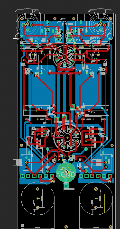

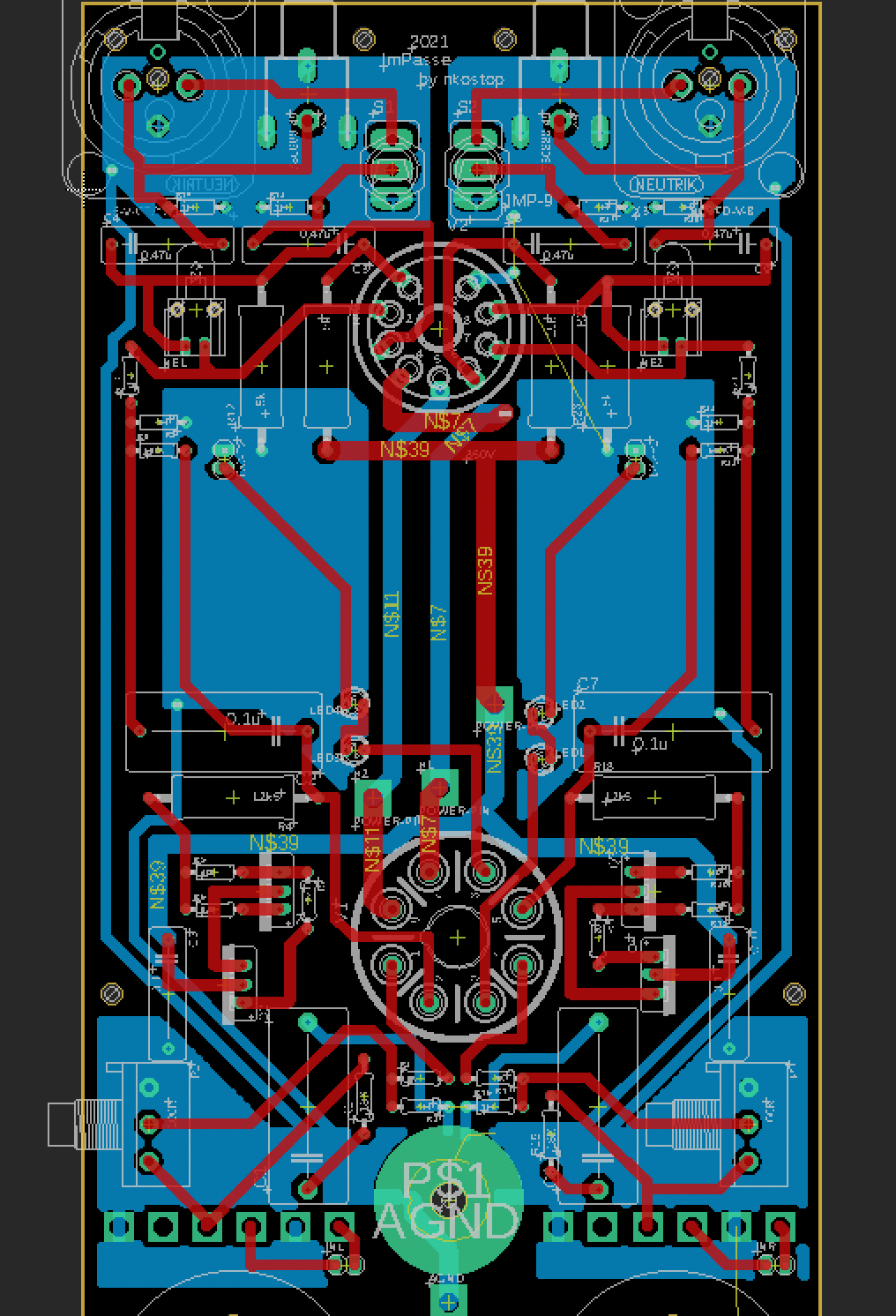

Hello everybody,
does anyone have schematics and gerber files for the ImPasse?
I am designing my own with Autodesk Eagle but I have not designed pcbs before. Is anybody interested?
I am attaching a screenshot of the current design. The Top is for signal and Power and at the Bottom i try to implement something of a star ground.
Does it make any sense? If it works I can post it here.
Hello everybody,

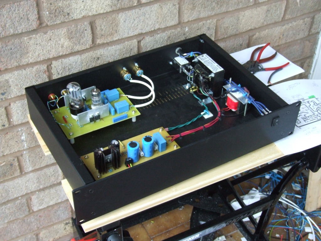

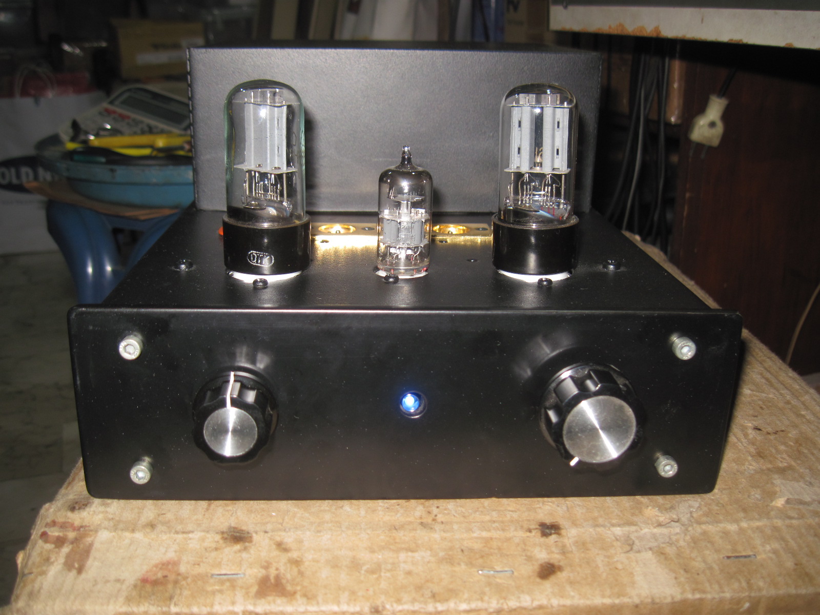

i have a design using 6sn7 and 6dj8, in case you are interested, a slight deviation from SY's Impasse but sounds very good..

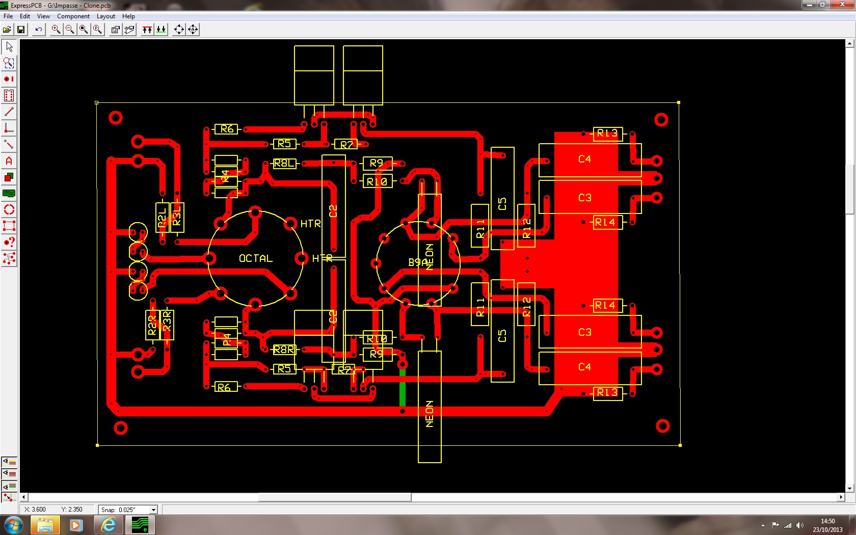

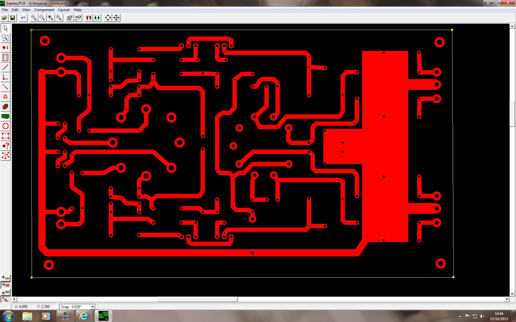

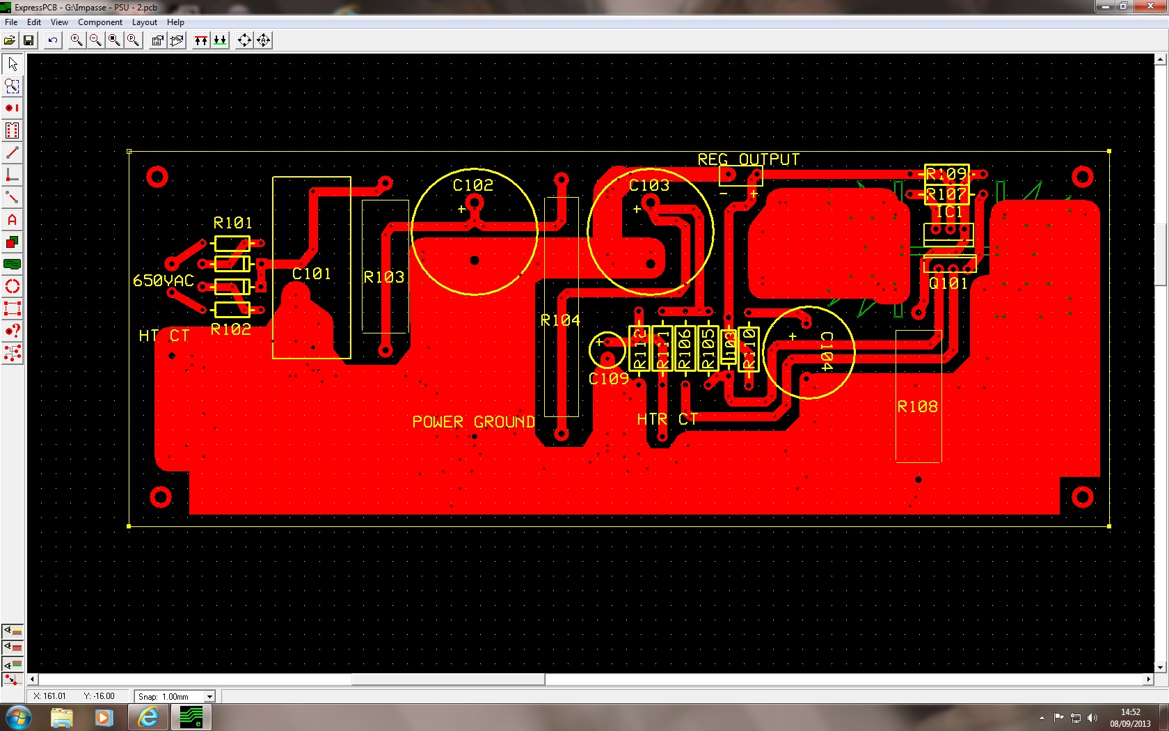

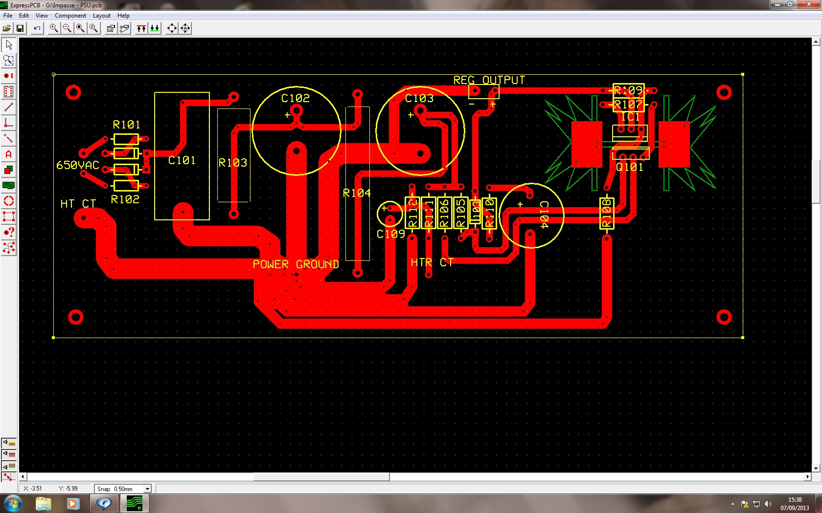

I've got these screen shots of the PCBs. I'm not sure which were the final ones ?
