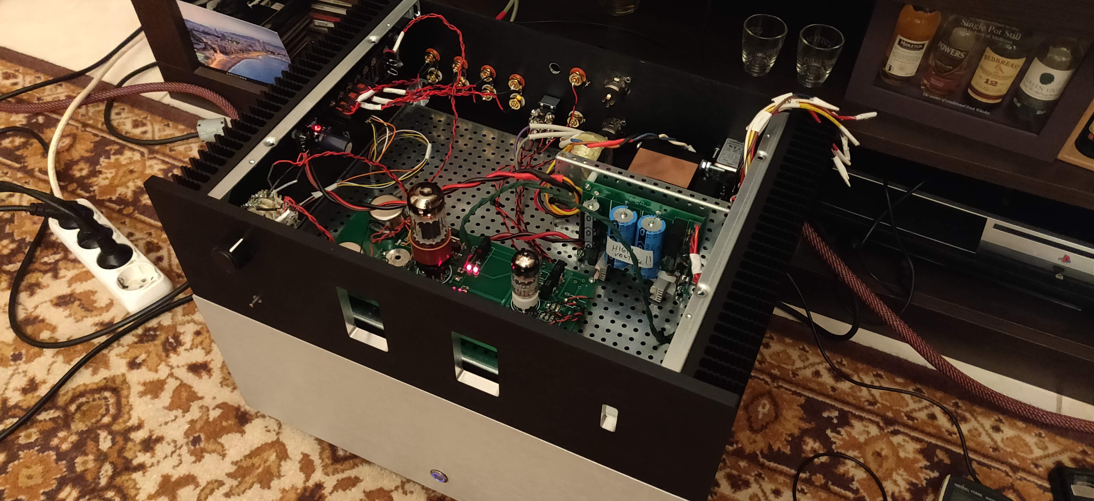

The pcb worked!
Here is the ImPasse with a Salas input selector and sowter 3575 trans on top of an F4!
The first of the DN2540N5 on every side seems to get too hot, I cannot touch it. The second one seems ok.
Any suggestions here?
For anyone interested on the PCB I haven't heard from SY so I do not know if it is good to publish it...
Yeah, wrt the heat-sinks note that the drains are at different potential so you MUST use an insulator and thermal compound

Added the heatsinks and everything seems ok.

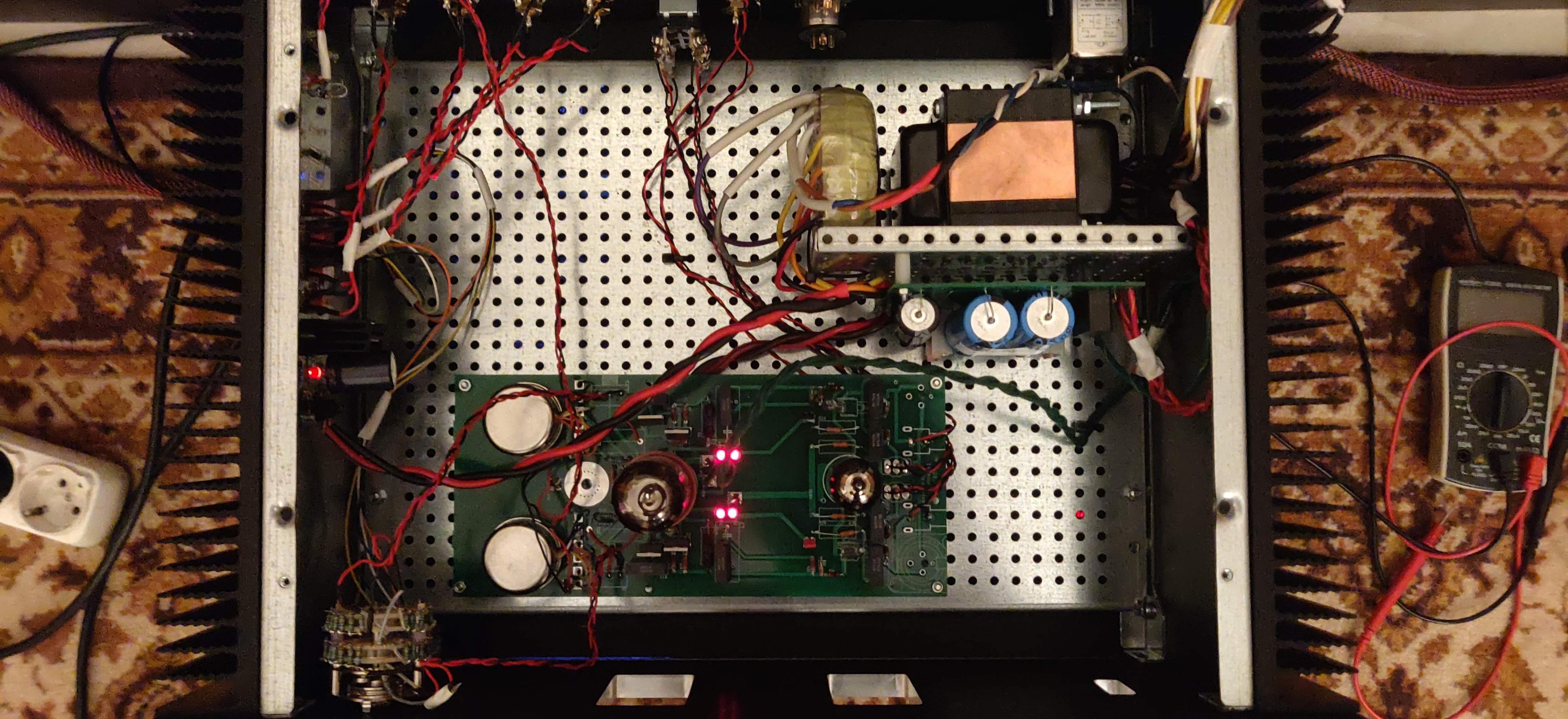

I am still puzzling my head how can I add one balance input with the salas selector or maybe a second selector. The goal is to use an arduino to change the the inputs and the volumes with a remote...
The PCBs worked fine with no hiss or buzz or anything! The sound is good.

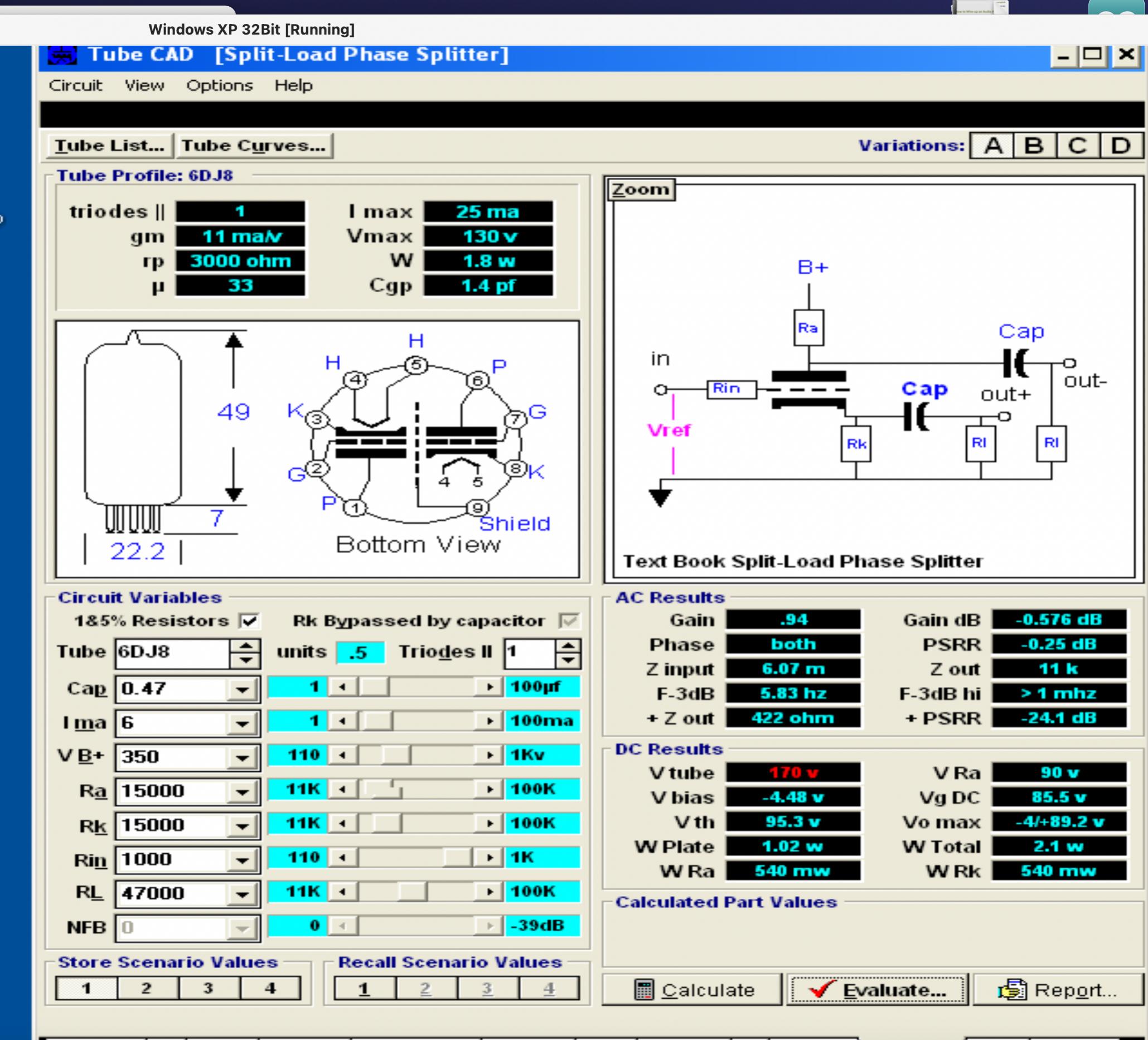

One issue that I cannot understand:
1) I measured the split load phase splitter voltages and found that with 15K for R11 and R12 the voltage drop on the resistors are about 90V and 170V on the tube instead of 120V and 100V as SY has said on his article.
2) I also checked with TubeCAD from glassware and seems that my measurements holds true.
What am I missing here?
Yes I will do that but trying to understand, why is there such a difference? It is tube related?
