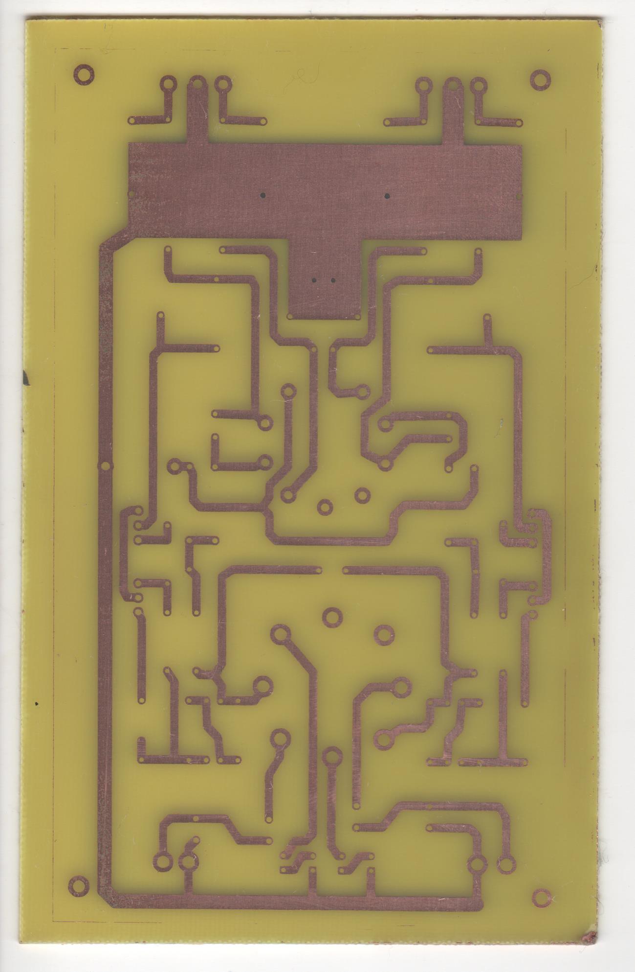

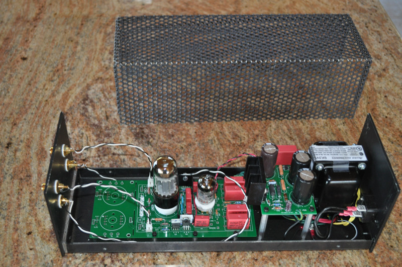

Here is my Impasse build. I added pots to trim R5 to 8ma though the current sources. After testing, I couldn't get the THD at 4V peak unbalanced, 1kHz below about 0.05%. I removed the LEDs and added a 500R pots with a 300R resistors in series between cathodes and ground to adjust the grid to cathode bias voltage. After adjusting the grid bias I was able to reduce THD to 0.020% and 0.016% in the left and right channels respectively, much worse than what SY reported in his article.
I also occasionally see a low level oscillation at 42382Hz 60dB below one watt with lower yet harmonics at 42382Hz+/-120Hz.
The vacuum tubes are Electro-Harmonix 6SN7 and 6922 purchased from PartsExpress. There are probably better tubes for this preamp. Any recommendations would be welcome.

I found that the THD would vary quite a bit with different makes of tubes.
Don't forget to bypass the resistors, the LED's have low a.c. Z.
Any particular tube that you would recommend that can be purchased?
Circuit analysis and SPICE simulations indicated that with cathode resistors on the order of 400 ohms, the difference in response with and without bypass caps was less than 0.1dB. I left them out.
Not to the level of expertise of SY -- but I plugged in several Raytheons and they were all over the lot.
The 6922 is not terribly critical since there's 100% feedback. The distortion is completely down to the 6SN7. I have only tried one sample of the EH and it actually was excellent, measuring similarly to the CV1988 I used in the prototype. Sample of one doesn't tell me much about variability!
Are you measuring distortion performance differentially? It is critical that both outputs be loaded identically- measuring one side only will not give you correct readings.

Hi there, I notice that you have put a small heatsink on the CCS MOS-FETs, is this necessary ?
Calculations and simulations showed that the MOSFET dissipated about 0.8 watts, so I added the inexpensive heatsink. not being sure about the free-air dissipation characteristics of the TO-220 package.Hi there, I notice that you have put a small heatsink on the CCS MOS-FETs, is this necessary ?

I figured out the low level 42382Hz oscillation. Florescent lights with electronic ballasts somehow coupled to the test lead of my Fluke multimeter. When I turn off the lights, the oscillation is gone. Surprising. At first I suspected a switching regulated power supply in a nearby computer or my Tektronics scope.
My hum measurements now look good: I measure about 0.5mV RMS noise on the cathode outputs to ground with the inputs shorted. In listening test, the hum is barely noticeable with the ear to the speakers.
