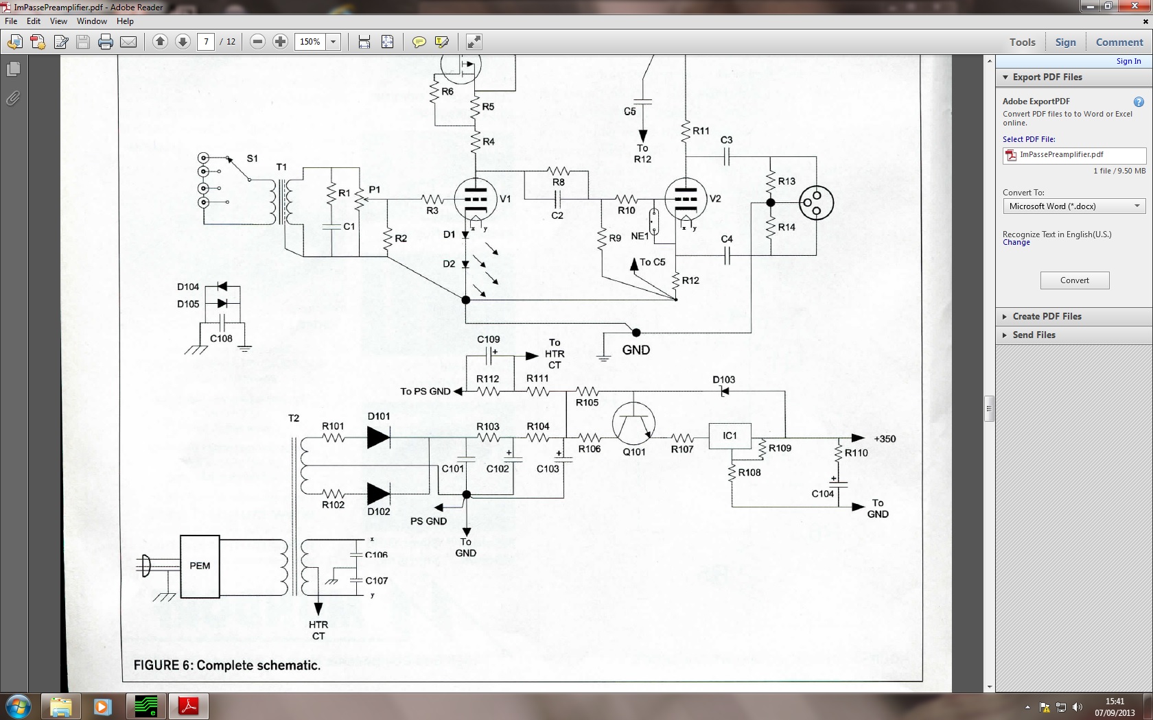

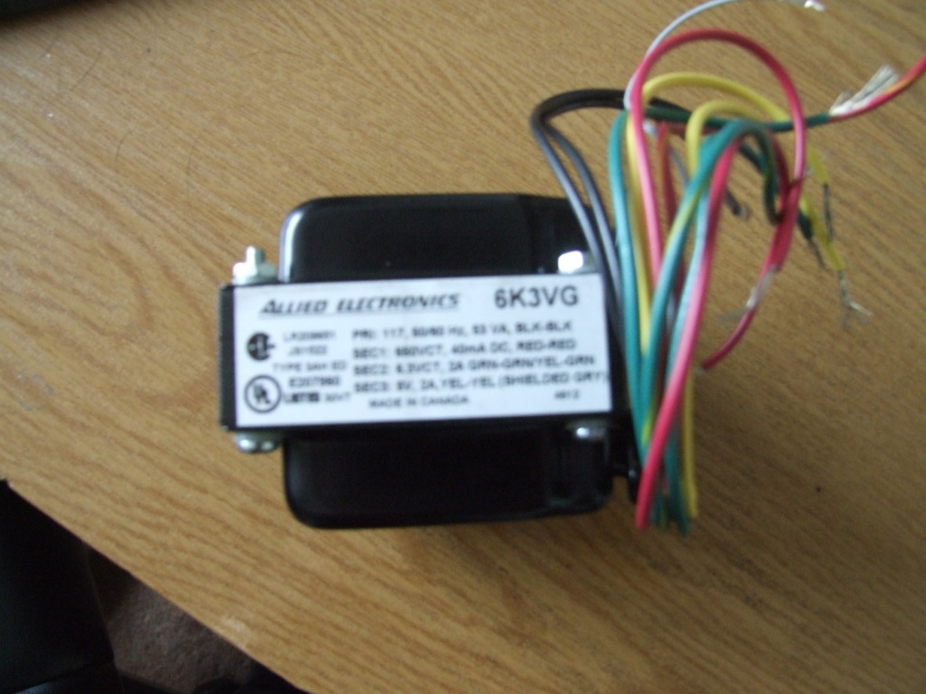

How about this one? It has 2 x 320V and even though it is rated at 50VA, it seems to be enough for the ImPasse.
Antek - AS-05T320
That should be a 1:1 drop in. It's got plenty of safety margin in terms of current delivery.

I still can't figure out how to get R11 and R12 within 0.1% of each other.
My DMM refuses to co-operate. It's only accurate to 2 decimal places.
I thought I was being clever by paralleling the 15K's with a 4K7 for measuring purposes thinking that the DMM would reveal a third decimal place, no, it's only good for two DPs.

Oh, by the way, after a bit of pressure, Allied Transformers are refunding me 50% of my postage. And for the guy who was told that they are out of stock, mine was shipped yesterday.

There's a Triad R 29A transformer for sale on the 'Bay -- you'll have to use a full wave bridge rectifier instead of half-wave. the filament winding is center-tapped.
As would an edcor including shipping even if it where a custom one . I would opt for the Sowter where you are.
Too many beers and too much haste. Mouser stock them, looking at the delivery time they probably import to order but at a fraction of the cost (eg £60).

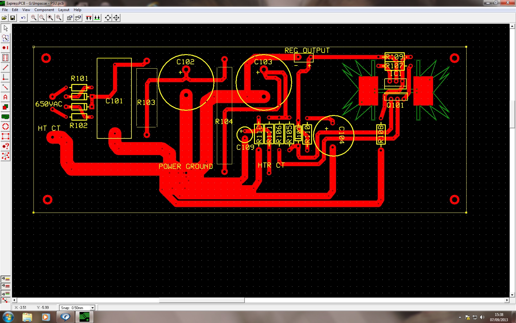

Gents, could you please peruse over my proposed layout of the Impasse PSU PCB to see if I have made any stupid errors or any possible improvements.
The copper is in RED. The Q101/IC1 Heatsink is in GREEN. The silkscreen is in YELLOW.
Make sure the heat sink is big enough, considering you are going to place both devices on the single 'sink...
Other than that I like it!

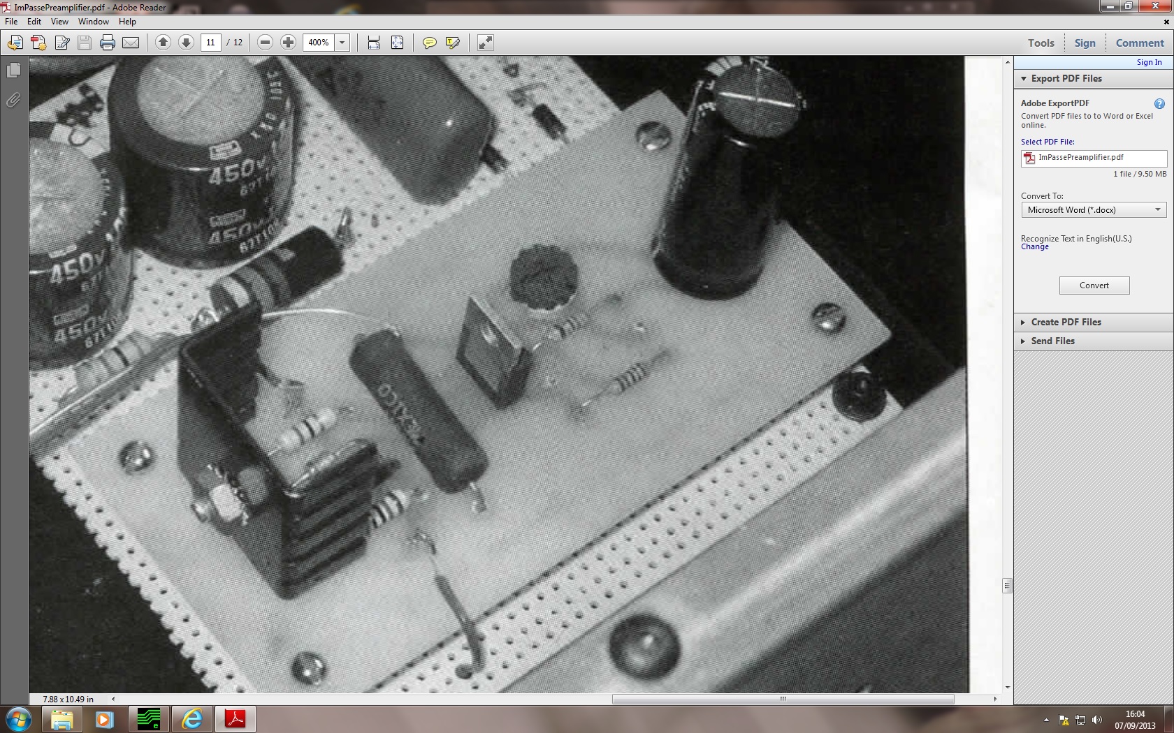

6L6 in the original article only one device, I'm not sure which, was on a smaller heatsink. So the heatsink should be adequate. I've got them sharing the same sink so that any rise in temp will trigger the LM317s temperature limiting.
