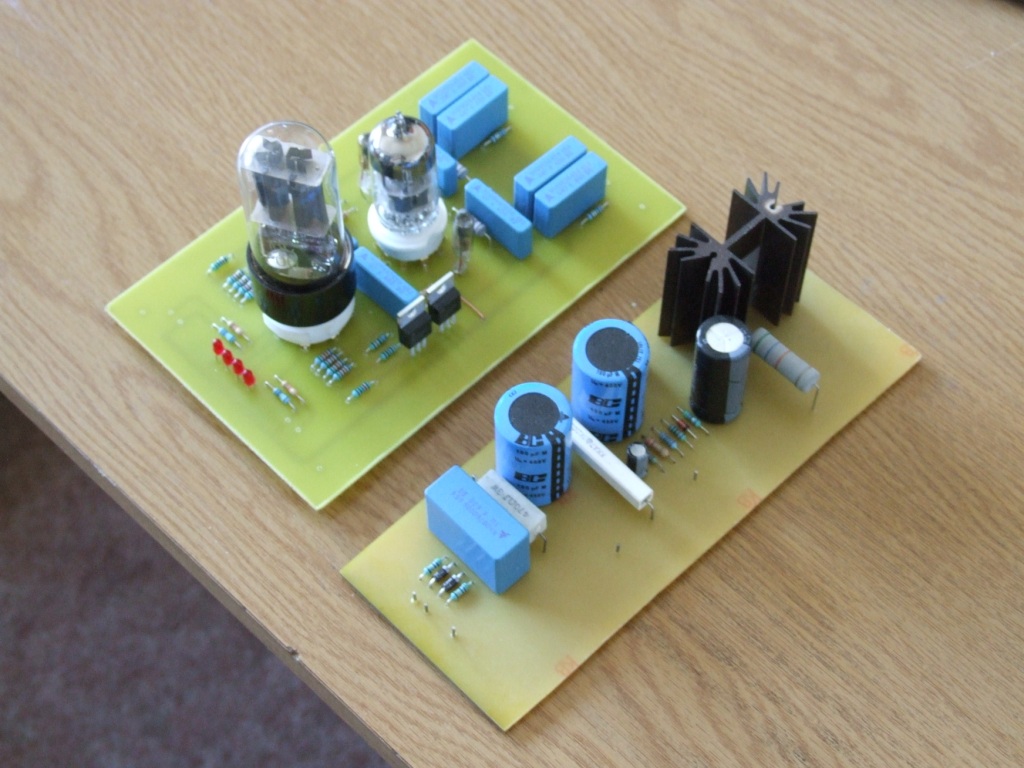

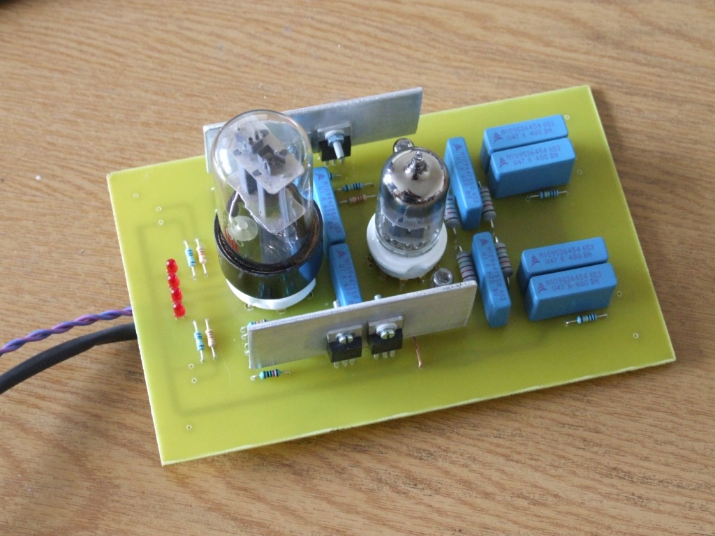

Ready for testing
Well after careful checking of the PCB I did find one small omission. HT(L) and HT(R) weren't connected together.
Not a problem, I've just linked them under the board.
Bowing to the experience of others I have also added a bit of heatsinking to the CCS MOS-FETs.
I'm still waiting for the chassis to arrive to put it together and test it.

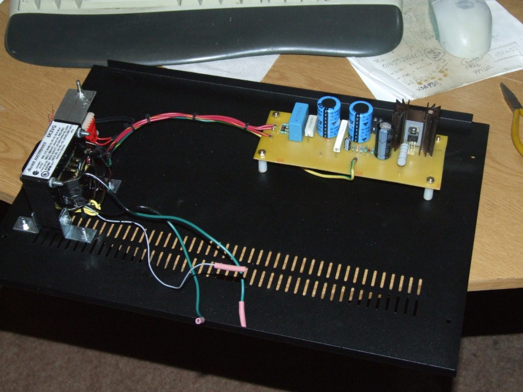

R105 was indeed burnt, caused by a bad track on the PCB. It's all working now regulating nicely at about 335V DC.
It's difficult to describe where the break was but effectively the pass transistor Q101 and IC1 weren't doing anything, the output current was being pulled through R105 and D103. My output voltage seems a bit shy of +350V but I am testing it at 35mA. I'm measuring 335V.
The Impasse is coming together
After the little hiccup above the build is now progressing. The second transformer hiding behind the Allied 6K3VG is just a 240V to 110V transformer because we in England use mans voltage. I had to disrobe the Allied transformer and mount it sideways to fit it inside the 2U case.
