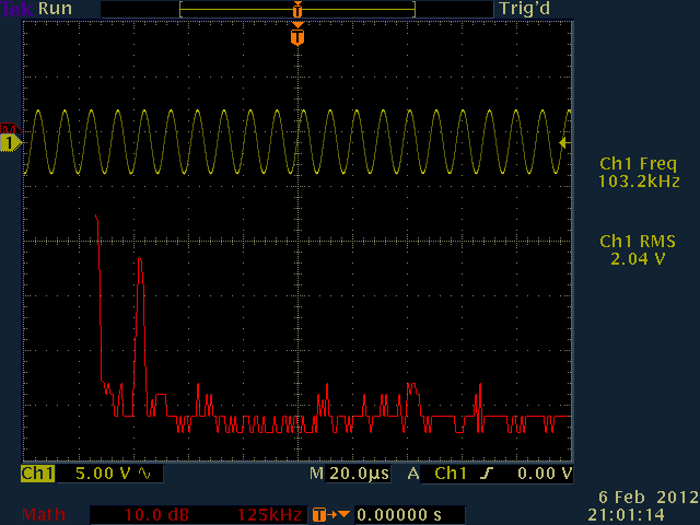

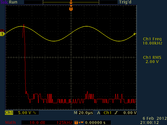

If I remember, 10kHz square wave wasn't pretty.
I believe I have the FFT software installed, at least I can hit Math and select FFT for one of the channels and it shows up as a red line on the graph.
So, what exact test setup would you suggest? Something similar to page 17 here:
http://www.cs.washington.edu/lab/facilities/hwlab/docs/mans/71034901.pdf
