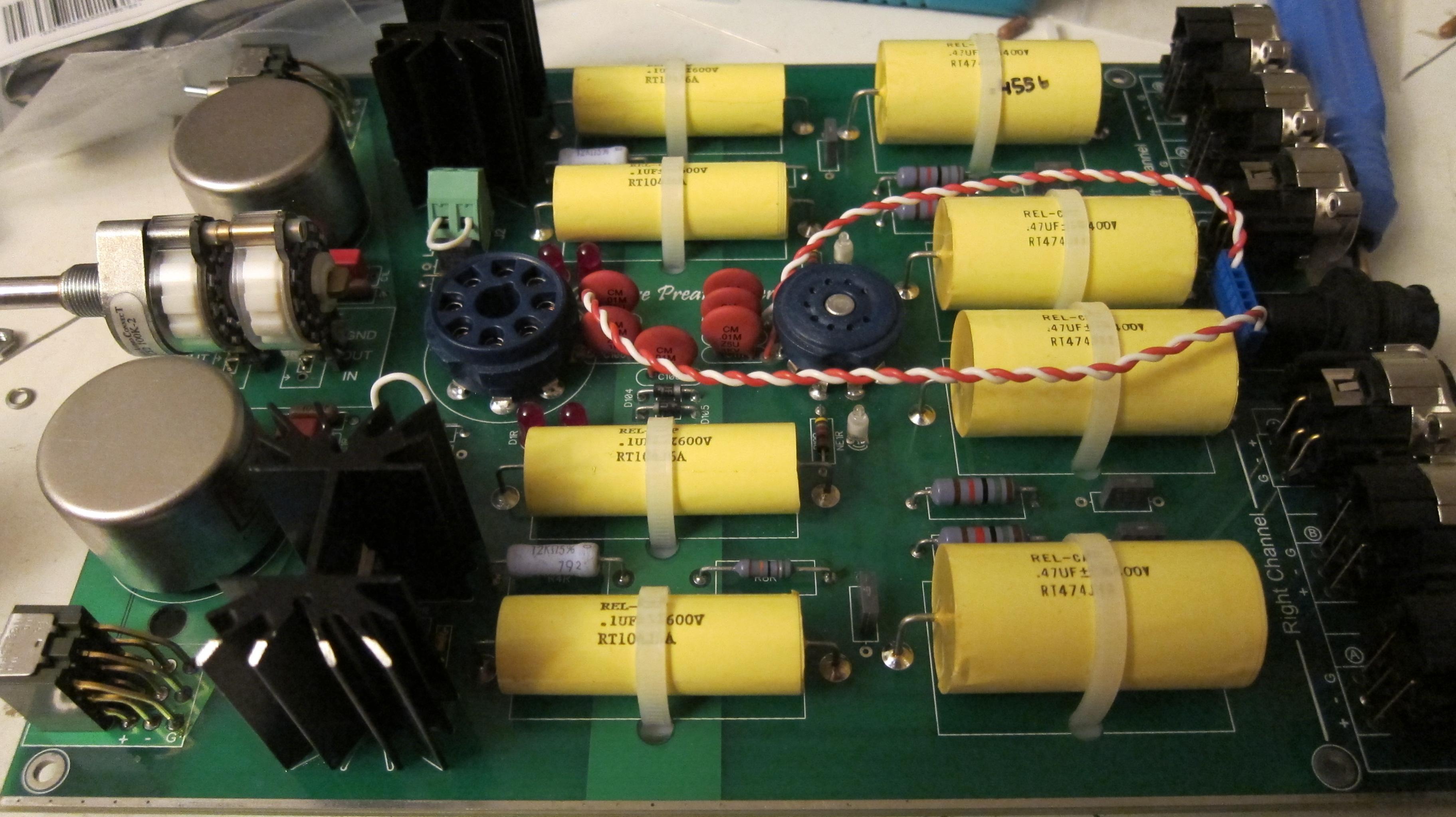

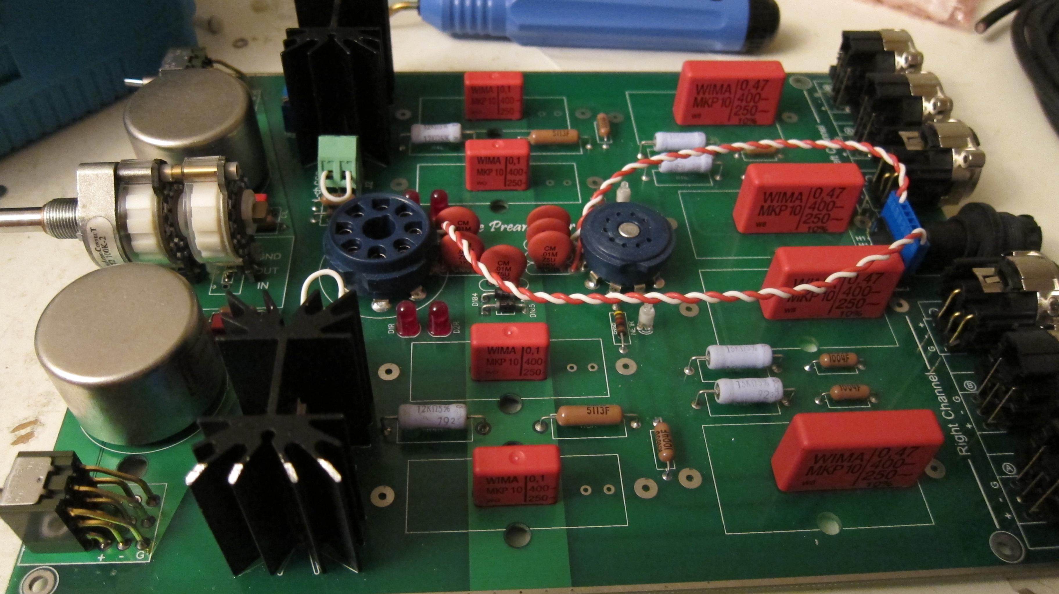

"That being said, I reworked the boards to amend the error I'd made with the Depletion MOSFETs and straightened out the layout a bit. The results are pretty good. In single ended mode with 10K load the THD% with 2.828V out is 0.0037%. (SY said in the article: "better than 0.01%). I found that Electro-Harmonix worked best, but YMMV. I also substituted 1u/400V on the output as I used the rest of my 0.47u/400V on another project."

The changes in the board were to allow utilization of the Cinemag transformer, (the original used the Sowter's), to correct the error on the orientation of the CCS MOSFETs, and to allow for easier insertion of a resistor to adjust the CCS to 8mA per side.
I also spent some time on the ergonomics of the ground returns which made them look a bit prettier.
All this being said, the boards are functionally the same -- you have the benefit that I personally soldered in the depletion MOSFETs and adjusted the bias resistors such that the CCS delivers 8mA.
If I priced out the time that I spent designing the boards and amortized the cost of my software, etc., etc. they would be much more expensive than the couple of bux I am charging for them. All I wanted to derive from the project was a couple of boards for myself and, by ordering in quantity availing all the group members of a knock down price on a pre which rivals those costing 3 or 4 kilo-bucks.

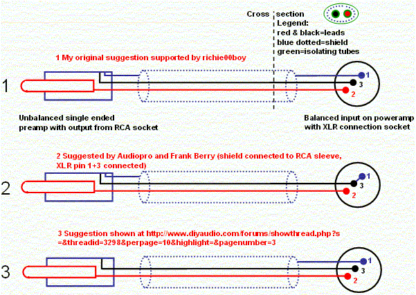

When you speak of single-ended outputs , do you mean using rca jacks as opposed to xlr's ?

If memory serves correctly, XLR Pin 3 on the PCB is connected to the cathode output cap. This would go to the center of the RCA jack, and XLR Pin 2 would go to the ground ring.
In balanced mode I've run the output over 40V pk-pk and nothing smoked. I would bet SY has run it up even more.
XLR/RCA
Here are a couple things I had found while looking into the using XLR preamp outputs with RCA inputs to a poweramp > http://www.rane.com/pdf/ranenotes/Grounding_&_Shielding_of_Audio_Devices.pdf
I believe that the first wiring you illustrate probably has best rejection or RF Interference. Best advice I can give is to keep you cable runs as short as practicable. It doesn't matter what the silkscreen is marked as long as you know that XLR3 is the cathode of a cathode-follower in single ended. I think that SY measured single-ended as he doesn't have a true balanced-in on his test apparatus.
