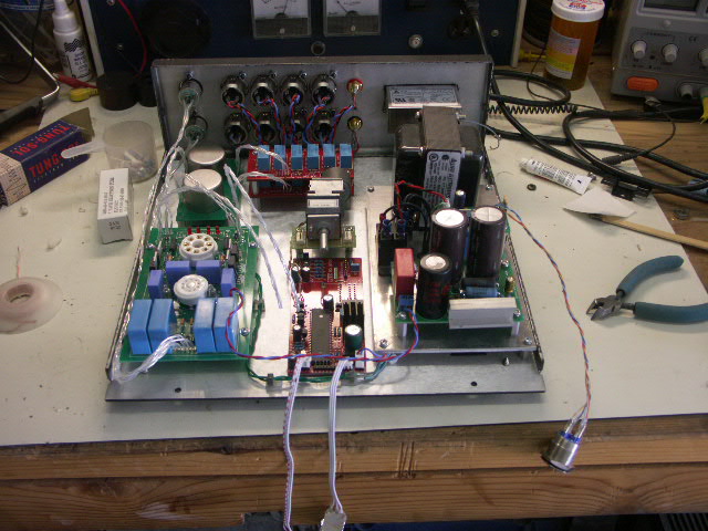

For the filament I had run a pretty heavy gauge wire twisted and used some plastic clips to tie it to the chassis. I have been using kester 2% silver solder but my local vendor cant get it anymore and the replacement brand Qualtek I have not been happy with it. What solder are you guys using? I may wire a single input and output with cat5 just to give it a listen to this weekend.

I have been using the kester for 30 years and happy with it, it was 22 ga the Qualtex is 18 ga a little big for delicate work. I think I will see if it is available from web sources, in the mean time I will give ratshack a try.

I have been struggling with this, one Chanel plays fine the other is louder with distortion and noise. looking at the output on the scope positive to ground looks good but negative to ground is a mess. Both channels like to oscillate and whistle on power up and settle down when voltage stabilize. I am using a 6922 but ordered a ECC88 replacement to see if the tube itself is the issue.

If you pull the 6922, does the oscillation go away? Also remember the requirement for equal loading on both sides- this will take two probes to verify. Otherwise, you can bypass the 6922 plate to ground, then look at the cathode and see if that's any better.

Always the simple things get overlooked, had the output jack wired wrong on the one channel. Listening to it now on my F4s. Still has a whistle on power up probably need to ad a time delay muting relay on the output. Sound is good slightly leaner than Pumpkin but to soon to really evaluate.

Ok, Its only been a couple of hours and I really like this preamp. I tried to listen to it critically but kept getting lost in the music. The F4s have come out as my clear winner of the last five amps I have built. When I upgraded my Xboz to the Pumpkin I was surprised how much more detail there was. This preamp has nice detail but is a little more relaxed, a nice addition to the F4s.
