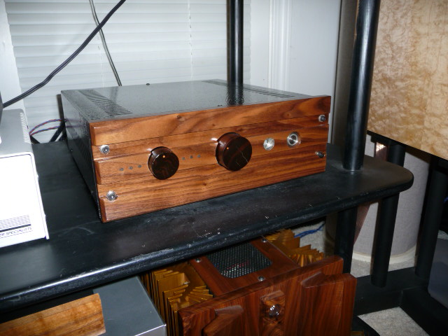

I have a common heat sink with insulators. It runs warm, ran it for 4 hrs last night little resister never got warm, so it must have been a fluke. I will add some power protection anyway, as well as a time delay to mute output for 5 or 6 seconds. This one has tested my patience because I was rushing to get it to BAF. I rushed the front panel but it turned out OK , made from walnut to match F4s.
