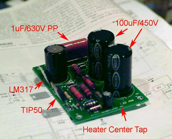

Here's my new power supply board -- with UF4007, TIP50 and LM317:

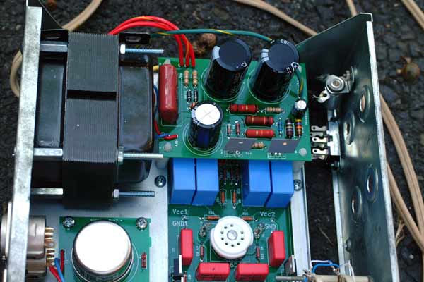

Here's the HV Board installed -- on 1.125" of nylon spacers. It's coming out so that I can put in some paralleled resistors for R103, R104. The initial heat sink for the pass transistor is just some aluminum stock.

Dave -- on my power supply boards I used the R016_7 -- 3 watt from either Xicon or Speer -- I would suggest that you use a 5W which has lead spacing of 25mm. It will run cooler. The resistor should also be mounted with some clearance from the board.
The BC resistors I'm using only seem to go up to 3W. Mouser part number 594-5093NW22K00J. I do have room for a 25mm LS resistor, but it will be very tight. I'm assuming you mean these:
