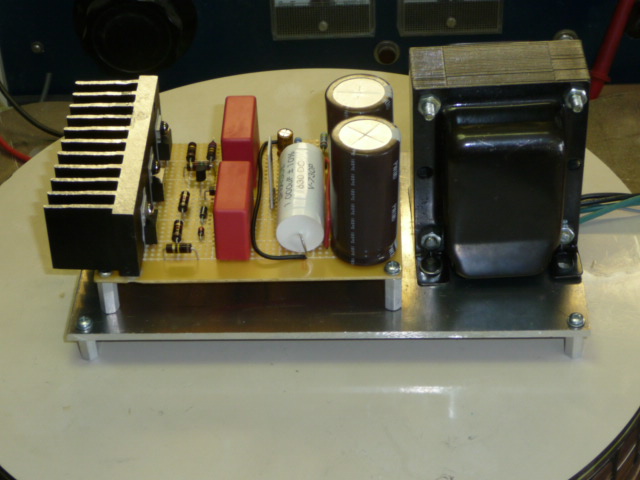

I have my power supply finished point to point, I went with the Temp compensated version. What would be a good load resister to test the power supply with ?
Bill
Read the article where it specifies the current load and voltage output of the PSU, then use Ohm's Law to calculate the resistor value, then again to calculate the power rating.
hmm, 8750 ohms by 14 watts at 350V nothing laying around the bench like that . I could hook it up to sparky the dog and see how high she jumps but I have grown kind of fond of her. I want to make sure the circuit is operating and regulating properly, I will bring it up on a variac how would you test it ?

Let's make it easy- we want to draw about 30 mA from the supply at 350V. Make it 35mA to ease the math. That's 350/35 = 10k. Power is (350)(.035) = 12.5W. For a short term test, a couple of 5k/5w resistors in series will do fine. 5k/10W is even better.
Thanks Sy

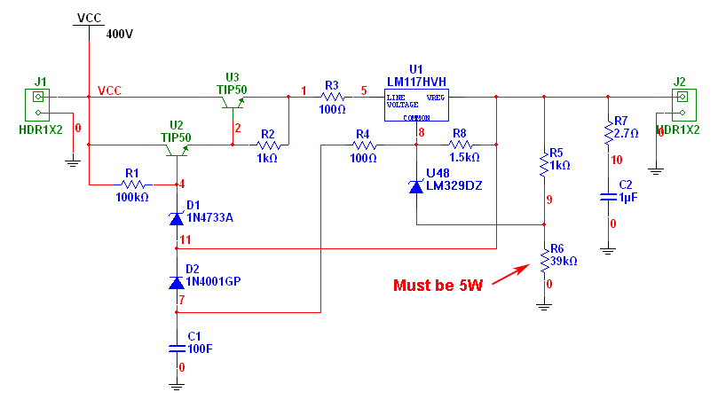

The power supply is only putting out 170V with 350 in. I put it on my test power supply (max out 250V) and here are a few of my readings input of U1 is 133V collector of U2 and U3 250V emitter 135V base 135V any ideas ?
Bill
Bill
Check your pass transistors, polarity of D1 as Jan mentioned.
The output of the regulator should be ~ (1 + 8.2) times the ratio of R6/R5 (R7,R6 in LB47). The 8.2 is the value of the LM329 plus the LM317's own reference voltage.
If you have a good idea of how much work the regulator is going to do you can change the value of the resistor before the LM317. I have shorted this thing and blown out the Darlingtons.
