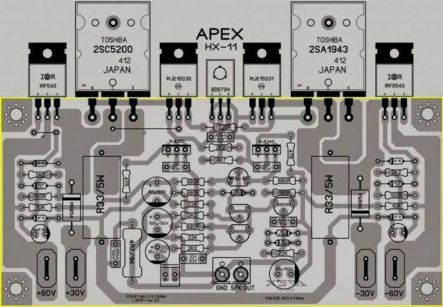

Apex, I was wondering, is there a specific reason or benefit why the input and output connections of your HX11 amp are located in close proximity to another ?
This PCB is not my design, it is designed by diyaudio member "willy"

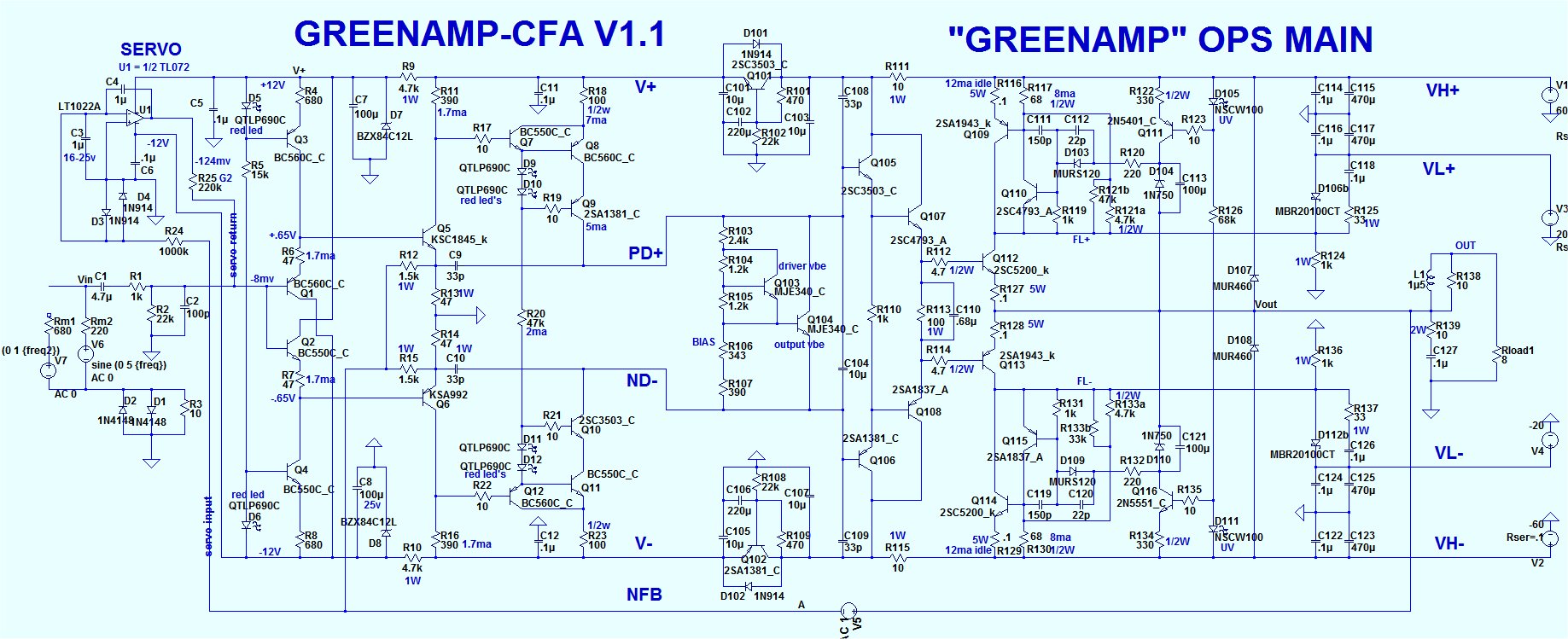

I would welcome any criticism of this design. I have actually built and
used most of it , except for the CFP trackers (Crest).
PS - output/driver devices will be faster Sanken's. Maybe even MT-200's ! 🙂
I looked at Self's class G kit (intensely) , in my opinion it IS that sort of "minimalist" design as you speak of now. None of the class H extra distortion
mechanism's are addressed. Layout and basic circuit is better , but not acceptable to me.

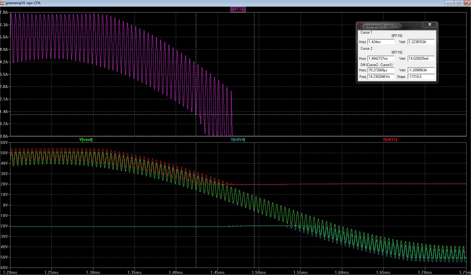

Havent really looked at the input bit, but the output stage looks very well thought out. have you got any waveforms showing the voltage on the output stage collectors? It’d be interesting to see how the 22p and 150p networks dictate rise/fall times of the supplies.
C111/112 allows me the "shape" rise/ fall with the bypass of diode Ct/driver Ccb.

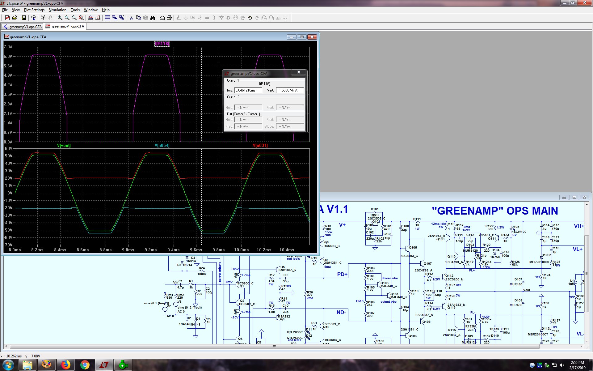

In the plot (below 2) is the R116 current (pink-no switching) , red and blue are the class H trackings.
I would most likely have to "tune" C111/112 and R121 to the specific devices I
end up using. Most models (even slow mje15032/33) work perfectly.
C111 even mitigates most of the reverse leakage "glitch' of D103 ,and R121 even
mitigates the much larger switching of the low rail diodes.
Using Infineon soft switching schottkey models for D103 and D106 - no "glitch' at all.
D106 will be a Infinion dual parallel 6A D-pak schottkey - like Crest uses.
Q111 refines impedance and voltage to give a superior reference. Reduces
D103 glitch , as well.
The result is worst case "difficult tracking' becomes quite easy (below 1) clipped 1k
with 200khz carrier .
The CFA's 200V/uS slewrate is also "easy" to negotiate. My goal was to
match or exceed my standard Sanken based EF3. The EF3 could slew to
almost 400V/uS with 60mhz Sankens ... could not match that . 🙁
But most is overkill. Also, Relatively simple for this level of performance.
Lots of pretty LED's ... too. Clips like a Valve ,as well.
Edit - full power 20Khz @ 42ppm. The EF3 was 20K@ 20PPM. The class G adds 20ppm , early effect +
imp. changes on the floating rails. But I was comparing this to a 10 device EF3 simulation.
