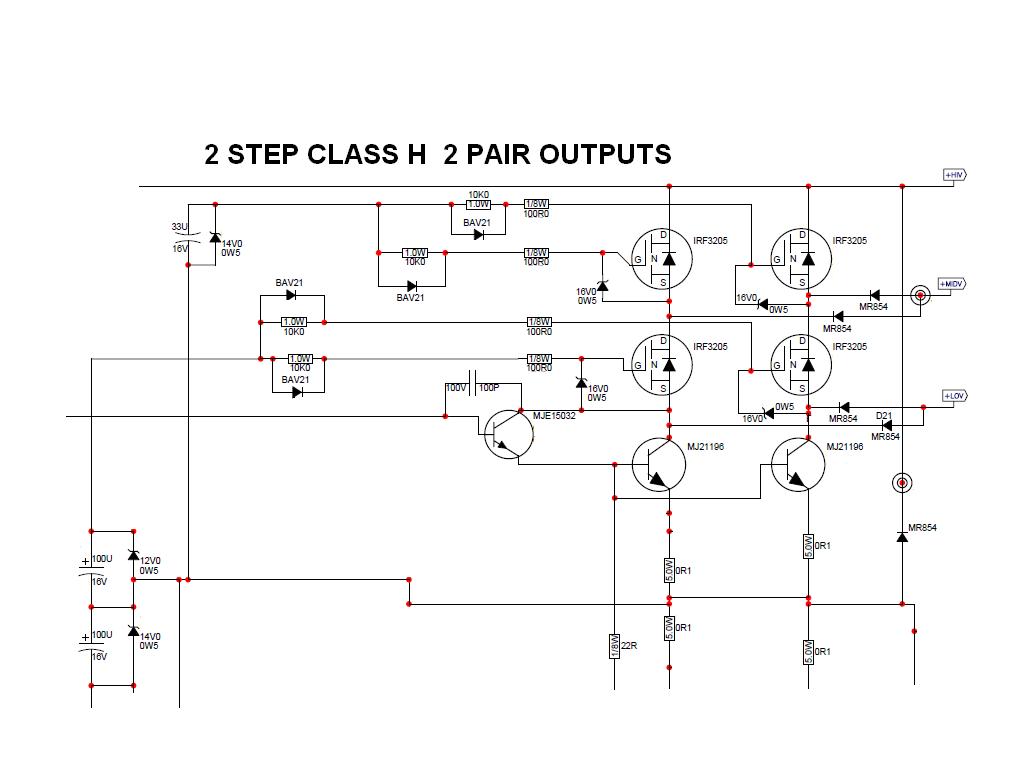

The clamp diodes either need to be eliminated, or the sources of the FETs need to connect to the BJT collectors thru a fast diode (same type as the mid rail commutator). I use the diode anyway on all modulated rail designs (ok to eliminate with switched rail which typically uses a drive circuit which minimizes the possibility of reverse or over biasing the gate-source). And the resistor-diode string needs to go to the rail, rather than being shorted.

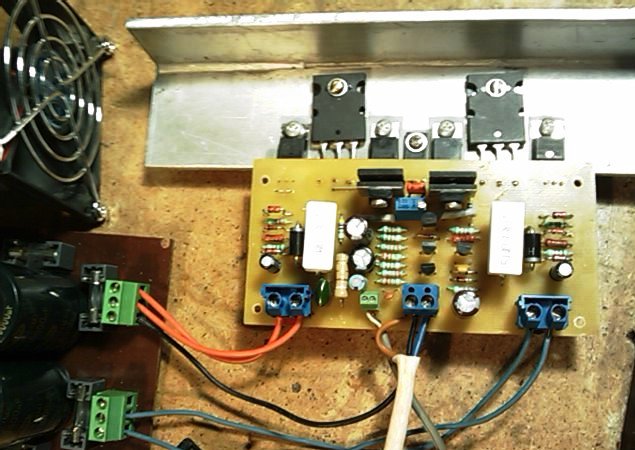

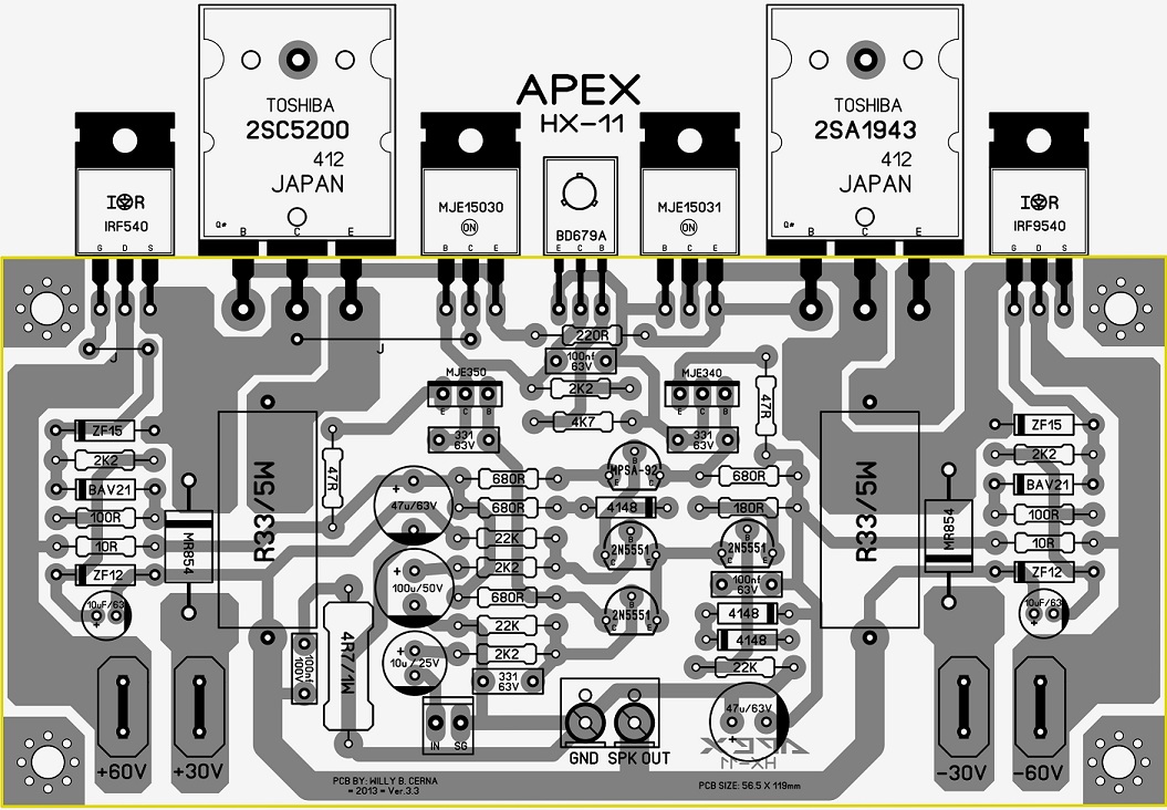

I can not find HX11 schematic, but this is working pcb measured 200W on 8 ohms load.
There is 2 step class H driver, can be use on any amp.

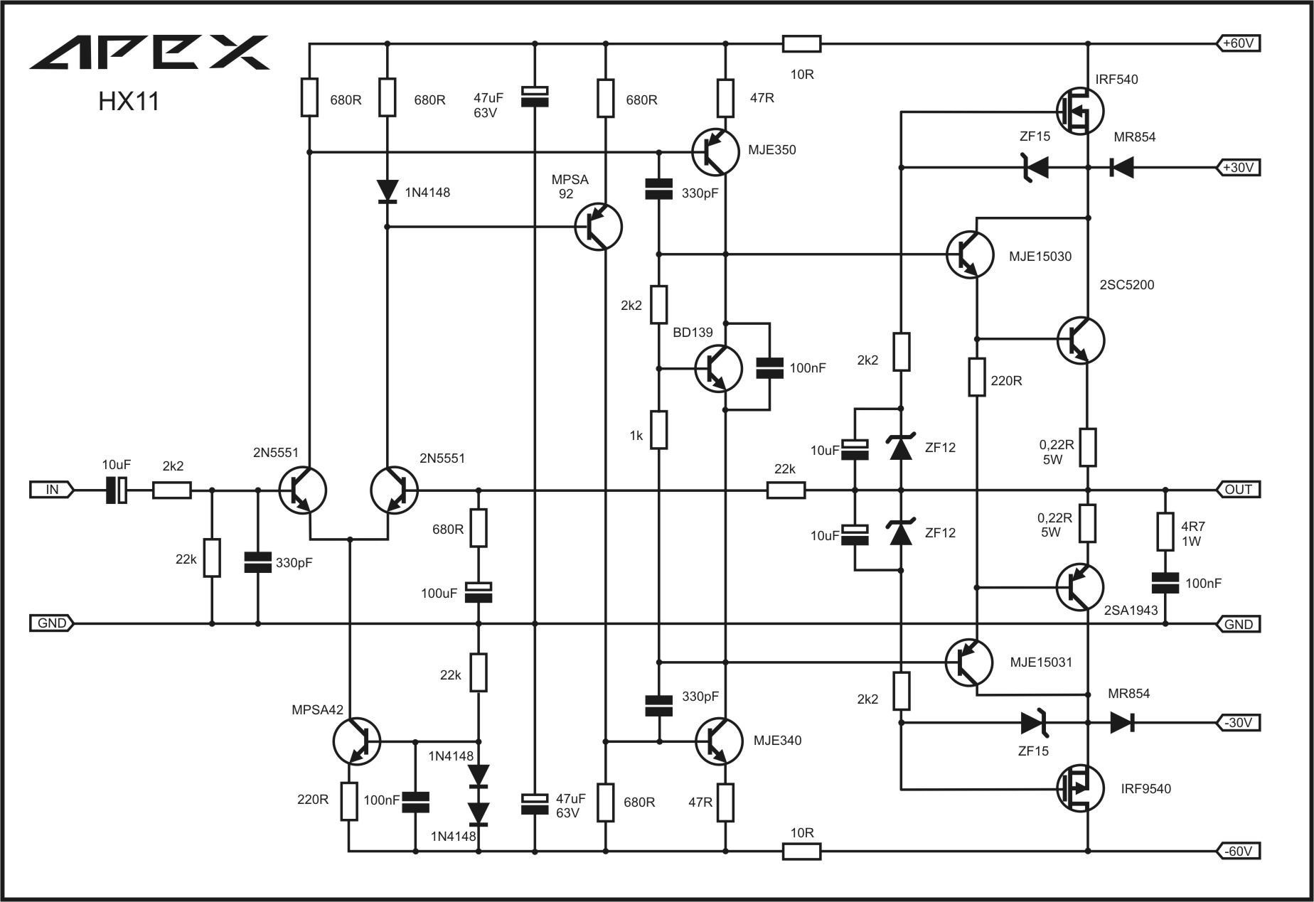

Sorry, but there are errors in APEX HX11 schematic.
Diode z1 is directly polarized while z3 is indirectly polarized. This will connect zener z3 to lower power supply probably completely destroying it in the process. Also, there is a bav21 diode in series with 1k resistor which is shorted.
Also T10/T15 have emitters swapped with collectors.
PCB is ok though.
There are still more errors:
- T8 emitter and collector swapped
- BC546B's at 80 Vdc rails?:eek:
- BC639's, BC640's, BD139's and BD140's at +/-80Vdc rails?? :eek::eek: (edit: as said by saijti before...)

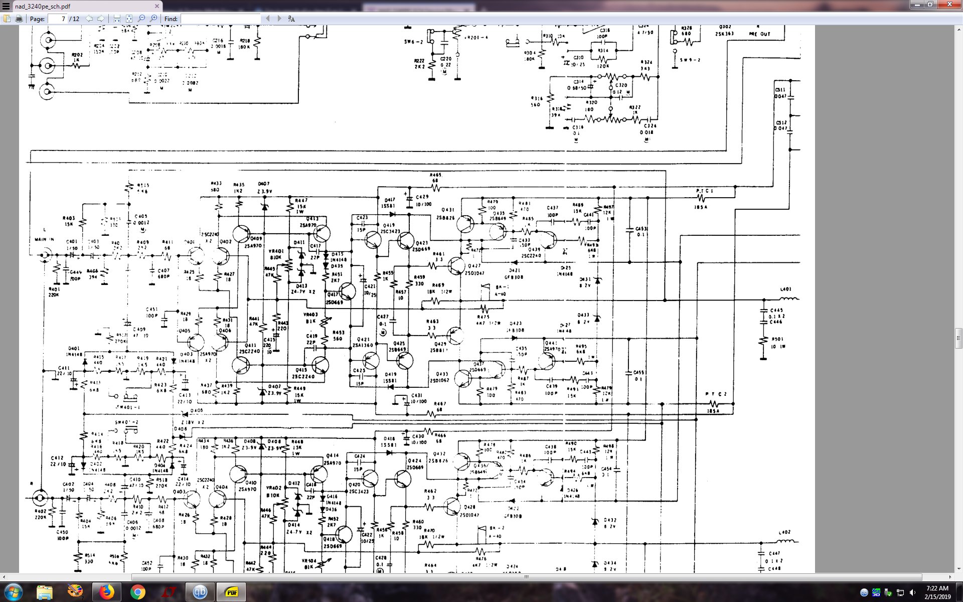

NAD 3240PE is a nice class G amp. I have one that I’m rather fond of, having fixed.
DIY includes repair? NAD 3240PE advice needed...
I am impressed. NAD actually stabilized the impedance of the tracker (Q439) ,
uses the EF3 for the inner pair , addresses Ccb (C433) at the tracker driver ...
They did not make Q431/435 non-switching or snubber the old /slow low rail
diodes.
Still , this NAD is the closest to "hi-fi" I have seen for a 20th century class
H. Definitely worth repairing. NAD could realistically do .01 -.03% THD.
Thanks for the "lead" (NAD schema).
Never seen/heard about this one.:eek:

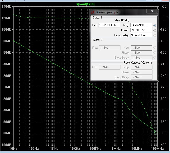

No NFB at ALL 330p @ 20khz.
Would be alright as a sub amp , with a wide margin - HX11's class H
would be audible at the mid/high's.
Even using my simulations , this would be true in real life.
14db at 20K is way short of the amps global gain , NFB does not "kick in"
down to 8 Khz. good sub amp ..

I use HX11 for subwoofer, it can work with 33pF miller for FR speakers.
As a sub amp , this is ideal.
The cheap MOSFET also makes this nice . Still , look to my H design ...
No switching , high 20K gain margin (10+db) ... unity gain out to 2.25mhz.
I would actually use an HX11 for my sub , but greenamp all the way for
full range or biamped use.
Just a few components could refine HX11 , even for sub use.
