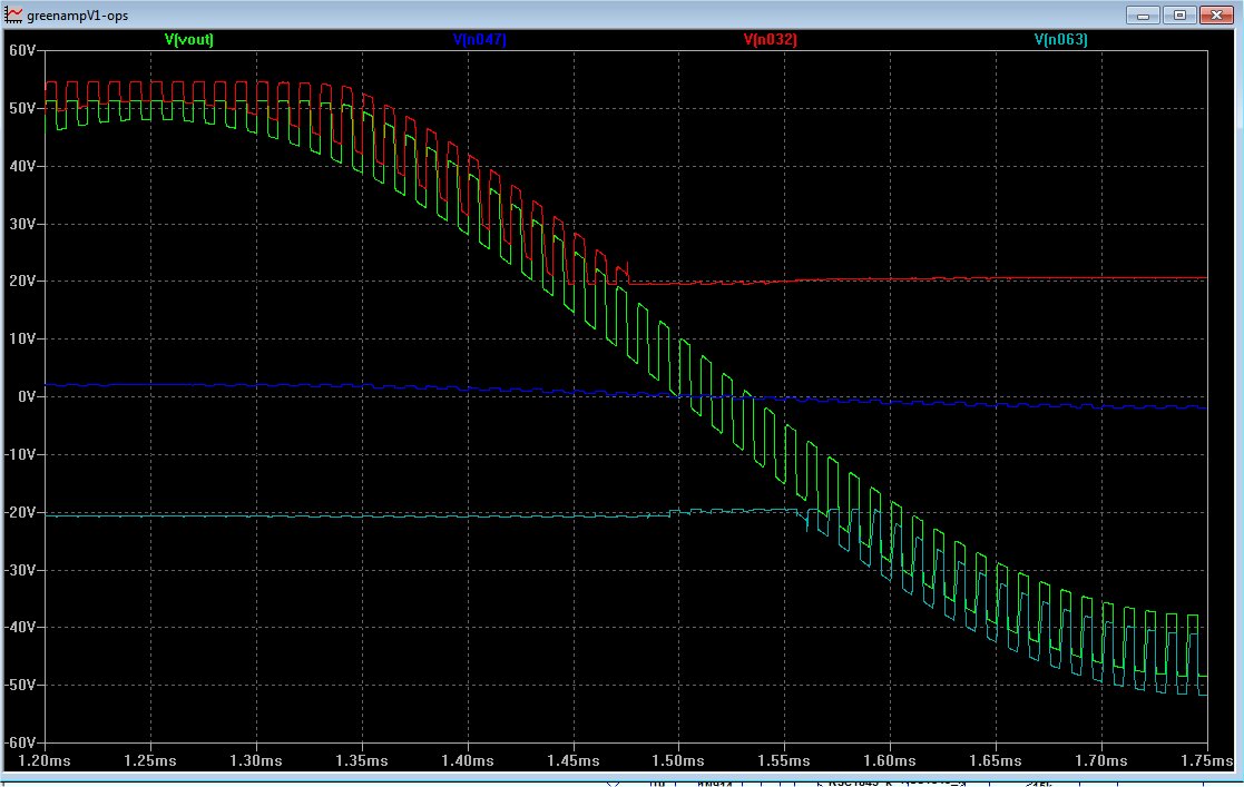

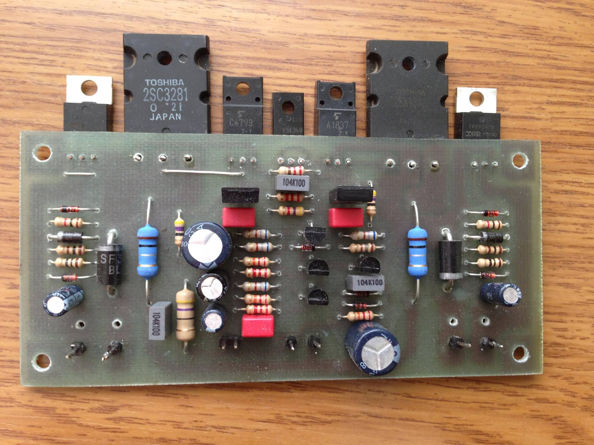

check out ostripper's eco version, with class G output stage. Looks promising!
GreenAmp ++ modulated Class G output
Sajti
Sajti

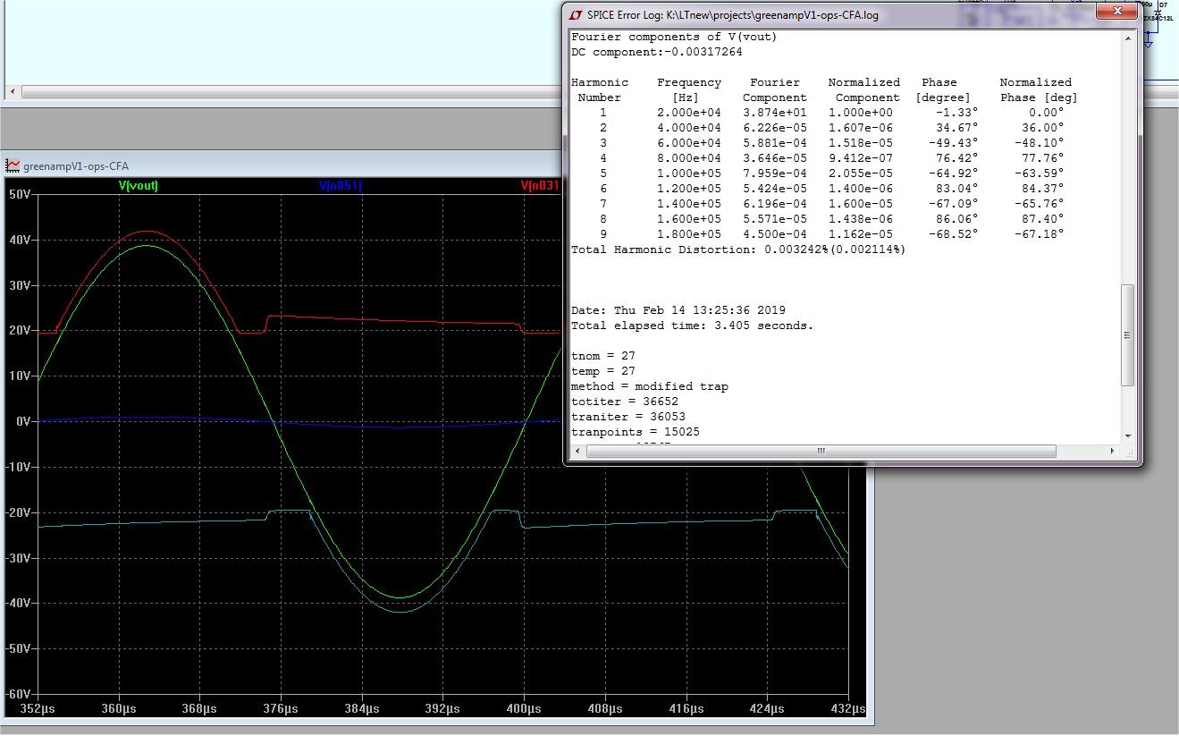

CFA + "modulated G" H ....
Ahh , This is better - with a CFA input stage.
-No outer stage switching
-Same PPM ultra-low THD as with a triple output stage
-Tracking up to 200Khz , soft clip , no saturation - period.
-Based on the slewmaster triple output stage with the refined Crest CFP.
The last distortion mechanism is the low rail diodes. Careful selection of
a soft switching schottkey eliminates this.
Scaled up to 8 devices , this design should match the Crest 400/700W
rating ... BUT maintain .003% THD20k.
- Input stage has been built , EF3 inner OPS has been built , Crest enhanced
rail trackers should work ... hit the simulations with every stress available .
OS
Sajti

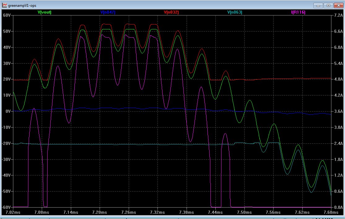

OS

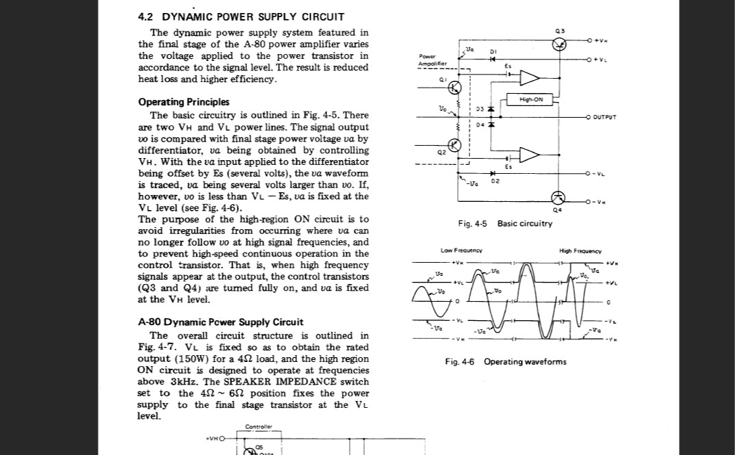

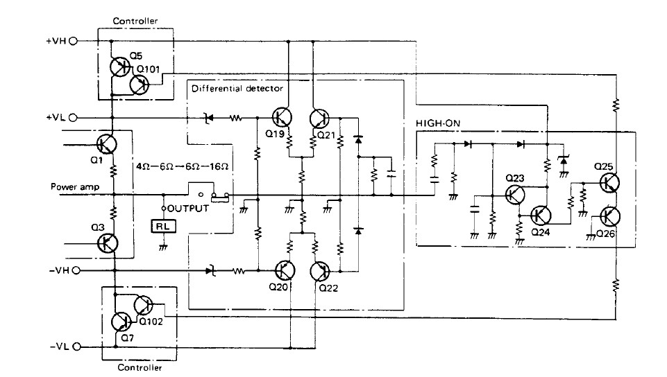

Have a look at the service manual for the Pioneer A80.
I agree with you , I just decided on "modulated class G".
Pioneer , toshiba , many other older Japanese designs tried
this design technique.
I actually simulated that pioneer and others. Not "transparent enough".
They also had 70's diode tech , no simulators to wrap a transitional compensation
scheme around the trackers.
Most of the old designs could not even come close to the plain EF3 that i compared
this one to.

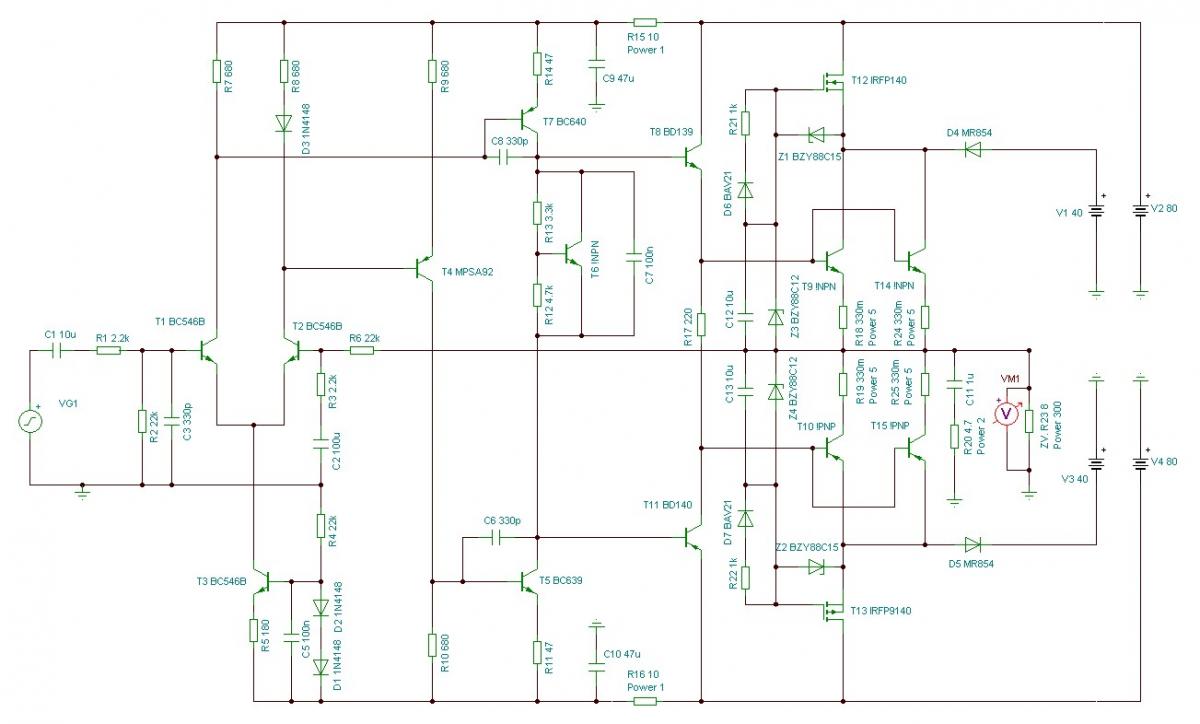

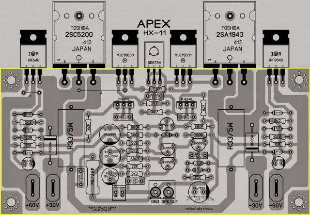

Sorry, but there are errors in APEX HX11 schematic.
Diode z1 is directly polarized while z3 is indirectly polarized. This will connect zener z3 to lower power supply probably completely destroying it in the process. Also, there is a bav21 diode in series with 1k resistor which is shorted.
Also T10/T15 have emitters swapped with collectors.
PCB is ok though.
