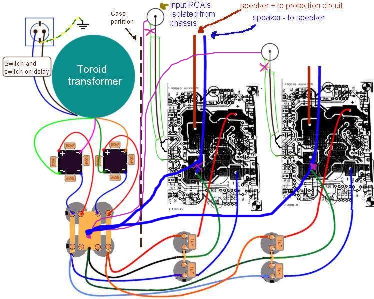

Hi Janne and Andypairo and others!
I have own filter capacitors for both channels too!
Can you Janne draw my schematic picture where that ripple current flows, because I'm not sure did I understand right your description. Anyway, its sounds reasonable to me.
I thinking that other PSU too, but its quite expensive cure for this hum problem.
But on the other hand, another PSU enable make this amplifier to double mono. 😛
Sorry Andrea , but what Krijstian site you mean?
Simboo:
I guess you should think also that double mono procedure because you have own PSU's for both channels, so you must fully separate those channels -> no common start points.
Below is my wirings!:crying:

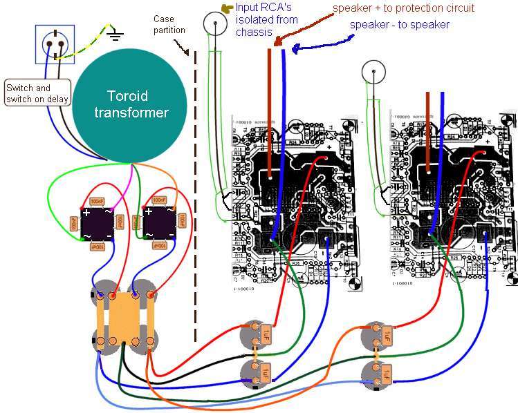

General rules (mine anyway)
Always twist pos and negs together..on supply rails, input of bridges, and speaker outs..can't tell if you did.
Using toroid, so it's not picking up roid hum..It looks like your oscillating because the input grounds are forming a loop and interacting with your outputs..
Try bringing left input shield at right angle to board, under it, over to right one..bundle both physically together to inputs jacks.
Cheers, John
Damn... Andypairo, your answers are quicker than my mind 😀
Andypairo said:
Does your drawing represent the physical placement of trafo and boards?
Yes, only right channel amplifier board should be rotated 180 degrees.
I do not have done that twisting thing. :xeye:
I must try it too, but I guess this hummm/buzzz comes somewhere else.
Anyway... I must change chassis for this Crescendo because those heatsinks are too small and they get very hot. Hurts when touch.:hot:
But anyway, all tips and hints are wellcome because someday I will change that chassis and same problems will be ahead.
I must try that Aleph wiring thing....:att'n:
But hey.... where is my starpoint anyway?
On main filter capacitors near bridges or centre piece of both channels bypass capacitors?
I guess.... no... I don't only guess, I know that starpoint should be separated from main capacitors centre piece with short and thick wire.
But is that zero line wiring from main capacitors to both channel bypass capacitors done right way? :scratch:
And how about that my earlier question about input filter or how it should be call ( I mean that parallel capacitor and resistor connected from input RCA ground to chassis)?
jahonen said:
Eccu,
This how I figured it out:
So as you can see, the ripple current flows thru RCA grounds to the another channel filter capacitors, and acts just like parallel unintended conductor.
Of course, this requires that RCA grounds are connected together at source end, where you plug them.
Janne

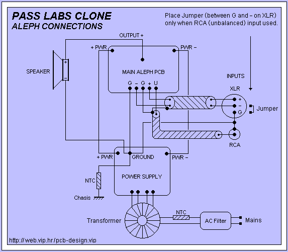

Eccu: I see that andy's schem has both single and diff input setups, where you are using the single..You draw the inputs as going to two points on the board, where andy has G tied to minus for single ended input..Are they the same circuit boards?

It does not, in special case that all ripple currents are exactly same and in opposite phase. But, if any deviations occur (f. ex. filter capacitors do not have exactly same capacitance, which is usually the case because of the tolerances), then the ground potentials will be slighty different between channels due to finite IR drops => loop current starts to flow, creating that hum.
That IR drop determines parasitic ripple loop current that flows through the RCA ground. Of course, much larger ripple flows in the loop you describe. But, as interconnect resistance is much higher in signal path (and signal path is not really suitable for large currents), relatively large hum is created.
To avoid that loop, separate signal ground is required to star points. Maybe point where power and signal grounds are connected together at PCB can be broken, and signal ground connected from there to central ground point (i.e. main filter capacitor ground point, where smaller filter cap grounds connect also) with separate wire. I believe this is the idea which is used in aforementioned Aleph ground scheme.

Thanks for everyones help, I have wired up the grounds again after reading Andypairos post, and all is good!
I am very happy with it now. Finally no buzzing when two RCA's are connected!.
The problem was that the 0V line from the caps to the PCB should have gone "caps 0V >> chassis ground >> PCB ground" now it works perfectly. yay!

Andypairo said:
Eccu, I'd re-wire this way.
Please let me know if it works.
Cheers
Andrea
Looking at that layout, I see a potential problem. The speaker current runs through the blue wire between PCB and supply cap grounds. That means there will be a voltage between PCB gnd and supply cap ground. Since there are other grounds (from supply and RCA) to the PCB gnd, there will be ground loops. They are not the cause of hum, but may ruin the sound and/or lead to instability. Route the speaker returns directly to the gnd between the supply caps. That way the current through the big blue one will be much less, making the supply cap gnd and PCB gnd more equal. Better yet, leave the speaker return as is, run each supply cap gnd with separate wires to the PCB gnd, that will give you true star ground.
