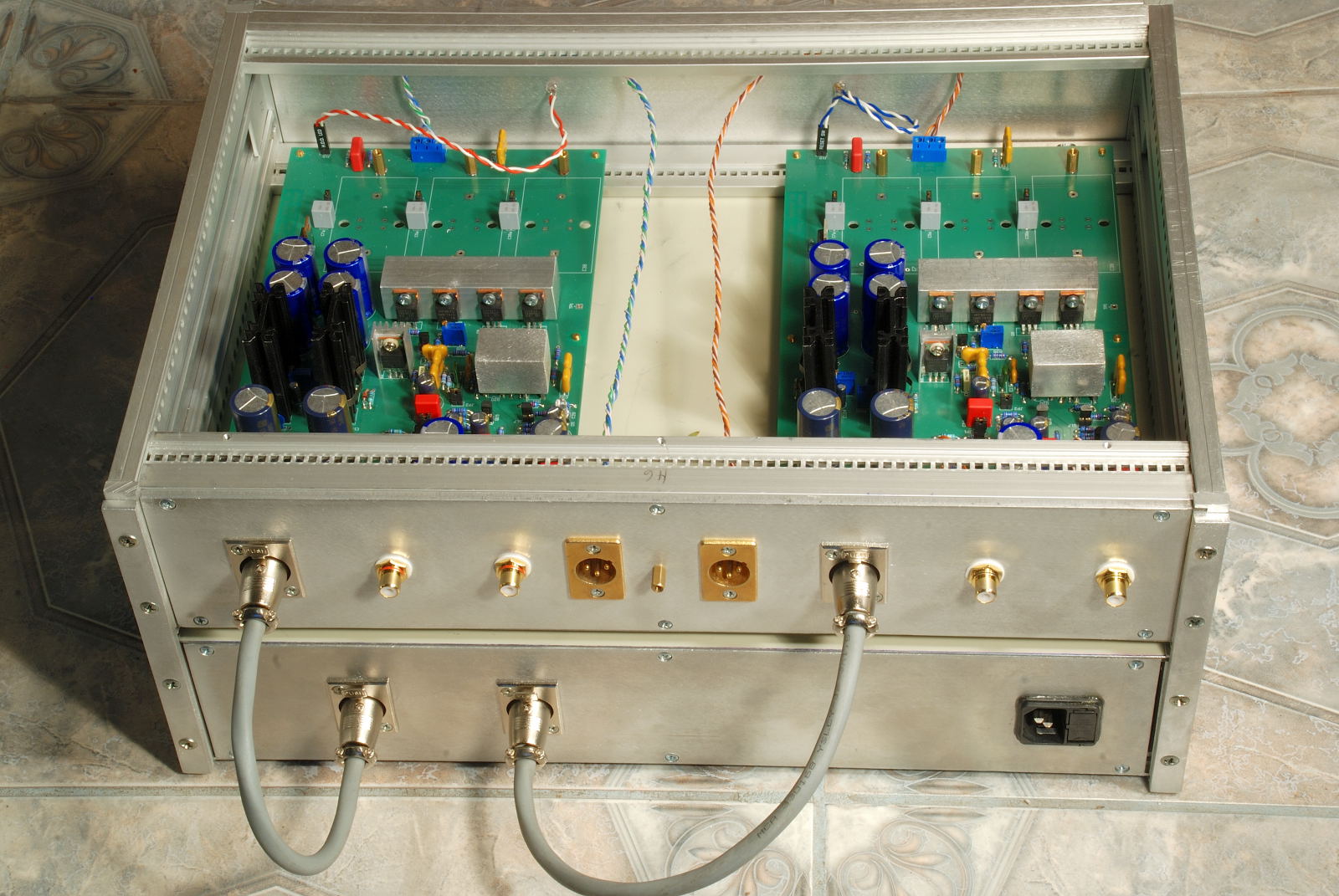

Before I forget it, there are no output capacitors at all.
What is your opinion about it, Wayne?
Eliminating caps at output is good. It is kind of a safety feature since we never know what our equipment will connect to.

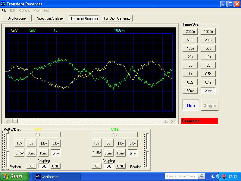

I was tried improving XOno DC offset further.

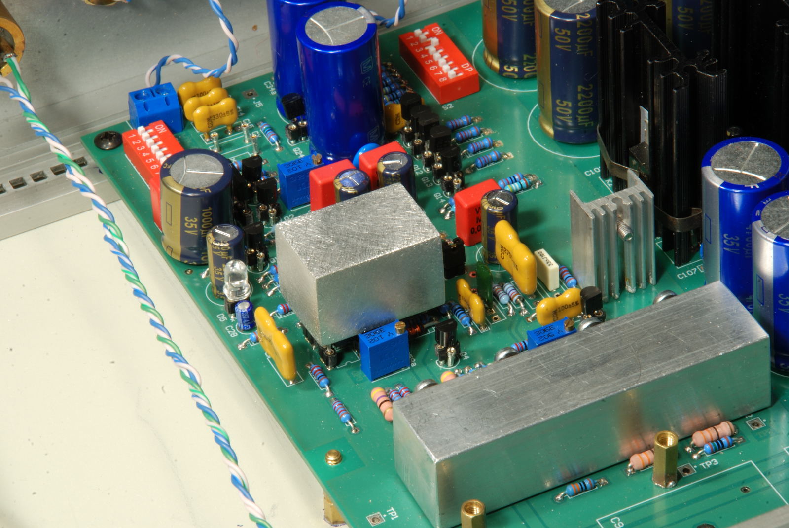

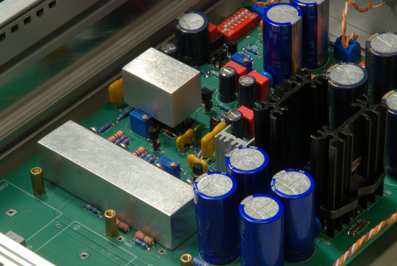

I glued an alloy brick on top of the 3 IRFD9110 fets.
I thought it will be good for two reasons:
These are quite hot. (Now surface of brick is about 67 C.!)
Because of better thermal equilibrum of the differential pair.
I think it was more or less success.
It was before about 100-140 mV, (either plus and minus) and now, you will see it in the attachments.
Yellow is + out, green is - out.
